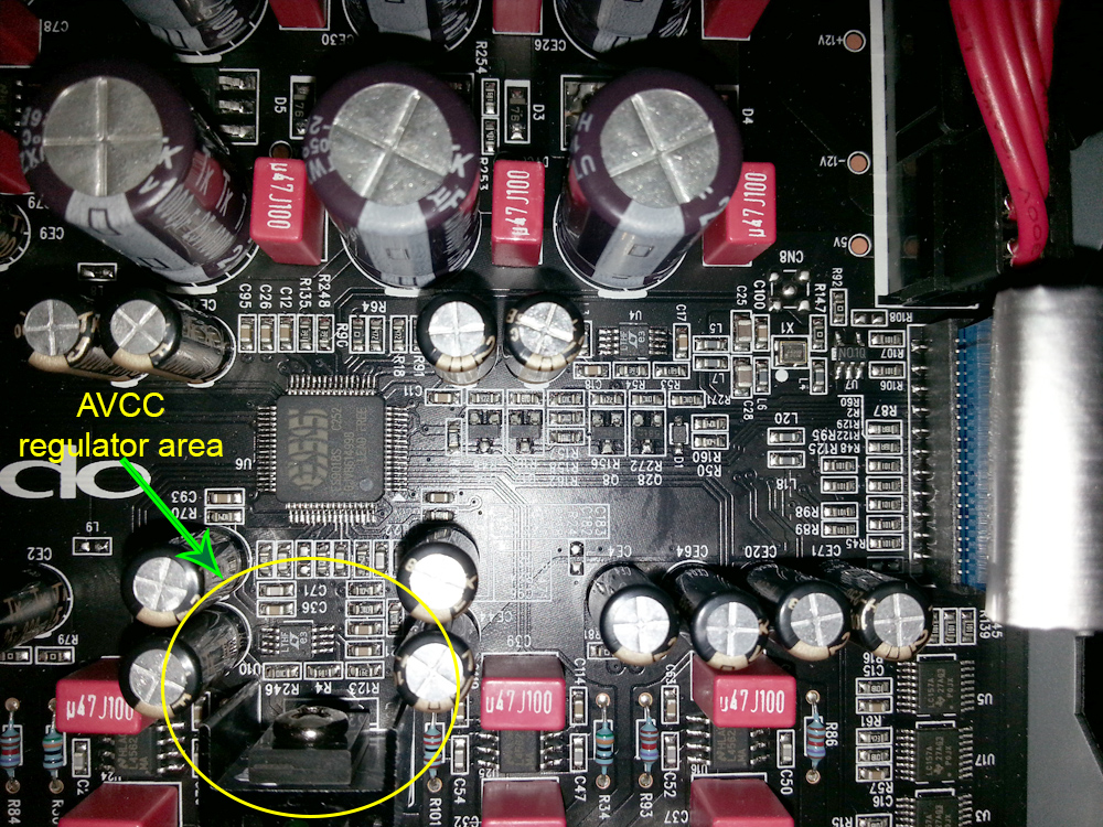

Here's the pic of how I mounted the rectifiers. As I've been using those MUR860 a lot, I tried them here as well and they sound very good.
As to the caps after regulators, I found that 1000/50V BG N sound the best. I tried some Panasonic for audio (6,800u), Technics for Audio (3,300) as well as Nichicon Pure Gold (4,700u) and I noticed that the absolute capacitance is not that much improtant for the sound, but the type of caps used.
BG N sounded best, followed by BG STD, then Technics, Panasonic and Nichicons were the last I would use from the whole bunch.

Hi Peter, the pic is missing.
BTW, what is the diode that you are using now? I am still missing how does the Vishey look like. Can you also post a pic of it?
Sunny
Sunny
Here you go; http://www.diyaudio.com/forums/attachment.php?s=&postid=390344
Those are the diodes I'm using now: MUR860
Here's Vishay/ROE caps pic: http://www.diyaudio.com/forums/attachment.php?s=&postid=427336

Thanks Carlos, does it mean I need to put two caps between 4 and ground as well as 7 and ground?

Sunsun22 said:Thanks Carlos, does it mean I need to put two caps between 4 and ground as well as 7 and ground?
Sunny
Yes.😉
And also a 0.1~0.22uf poly between + and -.
Of course, you need to put them under the circuit, as the circuit doesn't have place for them.🙄
Sharing electrolythic caps between several op-amps it not the way to do it, if you want to get the best out of the best op-amps.
When everything's ok, start testing better op-amps.😎

The rect. diodes I'm using are MUR860.
No need for fancy or expensive caps here.
The secret is how and where you use them.
Use good ones, but no need for BGs.

Whenever I experiment with bypass caps, I usually install those sockets, so I can try different caps without soldering.
The black stripe means outer foil (I measured them). The caps usually sound better when outer foil is connected to the ground.
