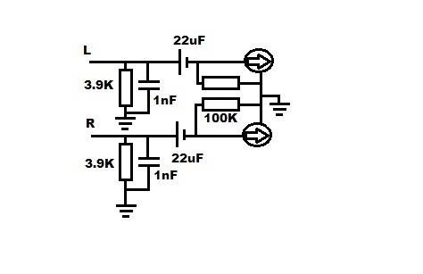

I'm stacking more chips today and see how it goes. My past experience with the Teradak TD1387 8x DAC directly on headphones is that it still needed around +12dB extra, so maybe at least 10x will be necessary. DC decoupling requires an extra resistor to ground between cap (-) and HPs? I see you suggested a 100k to someone with a similar question (see attachment). Is the 22u value of capacitor still correct in my case?

The schematic you're showing is for voltage output so isn't suitable for Iout into HPs.
For Iout you need a way to make the output current of the DAC chips bipolar. Meaning you need to have both positive and negative currents though the HPs when only positive currents come out of the DAC chips.
How I'd do that is arrange for a sinking current source from DAC output to GND and I'd sit the HP's GND terminal at about half the possible output swing, so ~1.6V in this case. To create a 1.6V reference is a little bit tricky - perhaps you could do it with a TLV431 though I worry about how noisy that'll be. Guess it has to be tried and listened to.

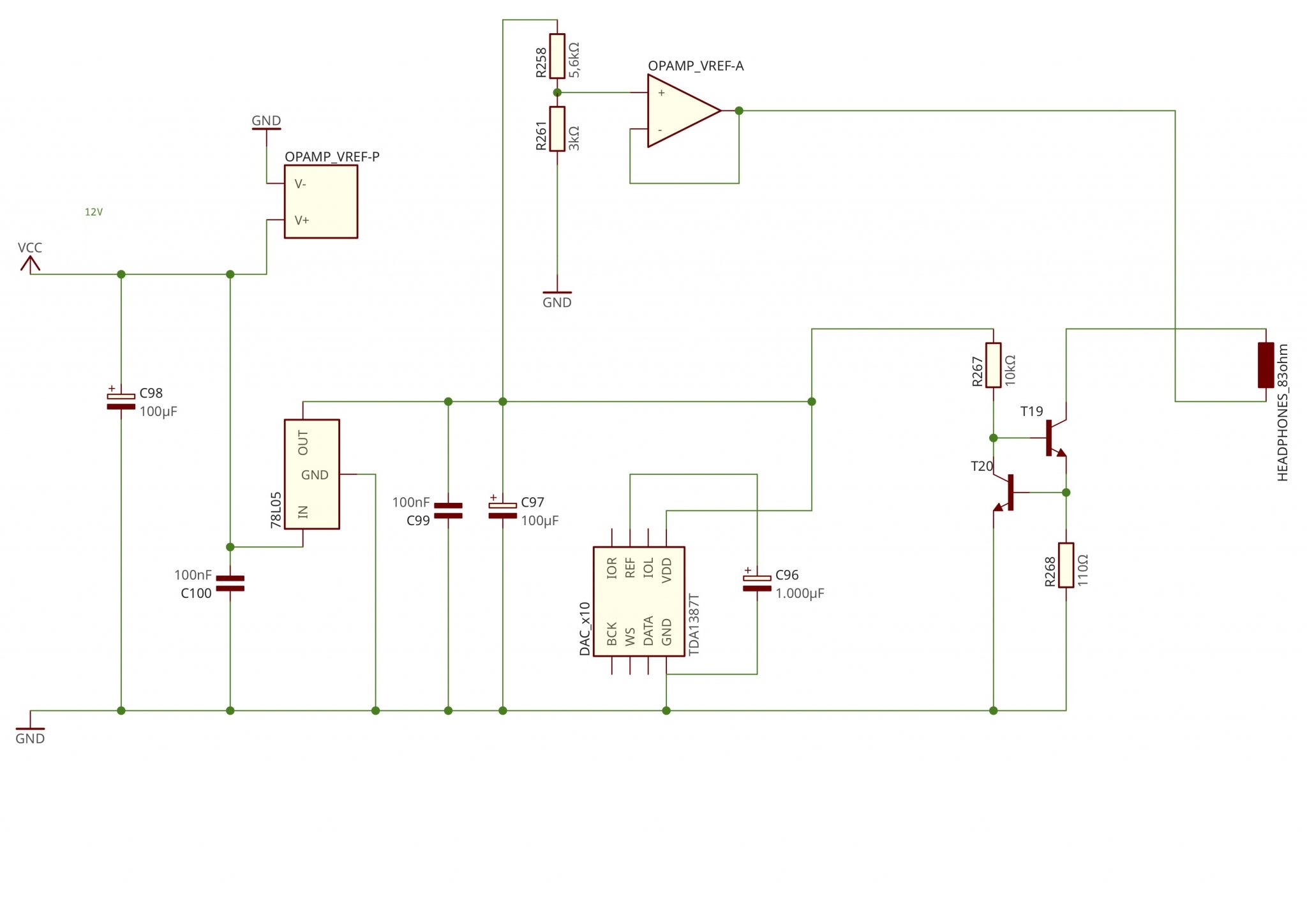

Here goes a preliminary diagram, I hope I'm interpreting you well!

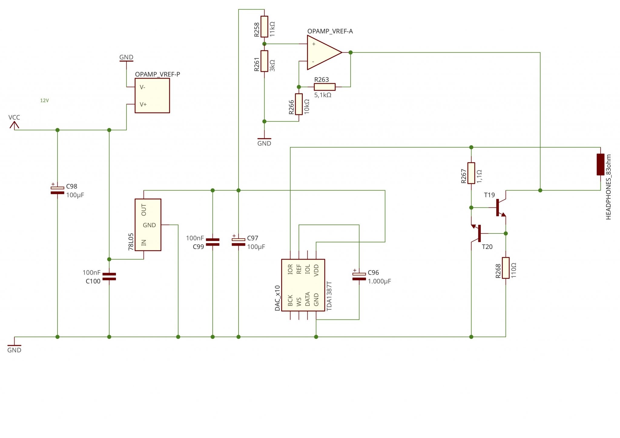

We go for the two NPN CS then... parts size is actually almost the same and easy to find. I adapted the CS to draw only 5mA though, for the 10x DAC experiment.
I've been wondering if the circuit will also perform well with headphones of a lower impedance. Say typical 32ohm earplugs... since their voltage and current draw will have another midpoint. Also, according to my maths the lower the impedance the higher the current draw (at a lower voltage).

A few corrections to make:
T20 is upside down (emitter/collector reversed)
R267 - bias resistor - too low value (suggest 10k) and needs to terminate on +5V (DAC supply) not Iout.
T19 collector goes to Iout
Headphone common (GND) goes to opamp output.
R266 - delete
R263 - turn into a wire (i.e. run opamp at unity gain)
R258 - becomes 5k6
You can still use 1.75V as the mid-point with lower impedance HPs.
