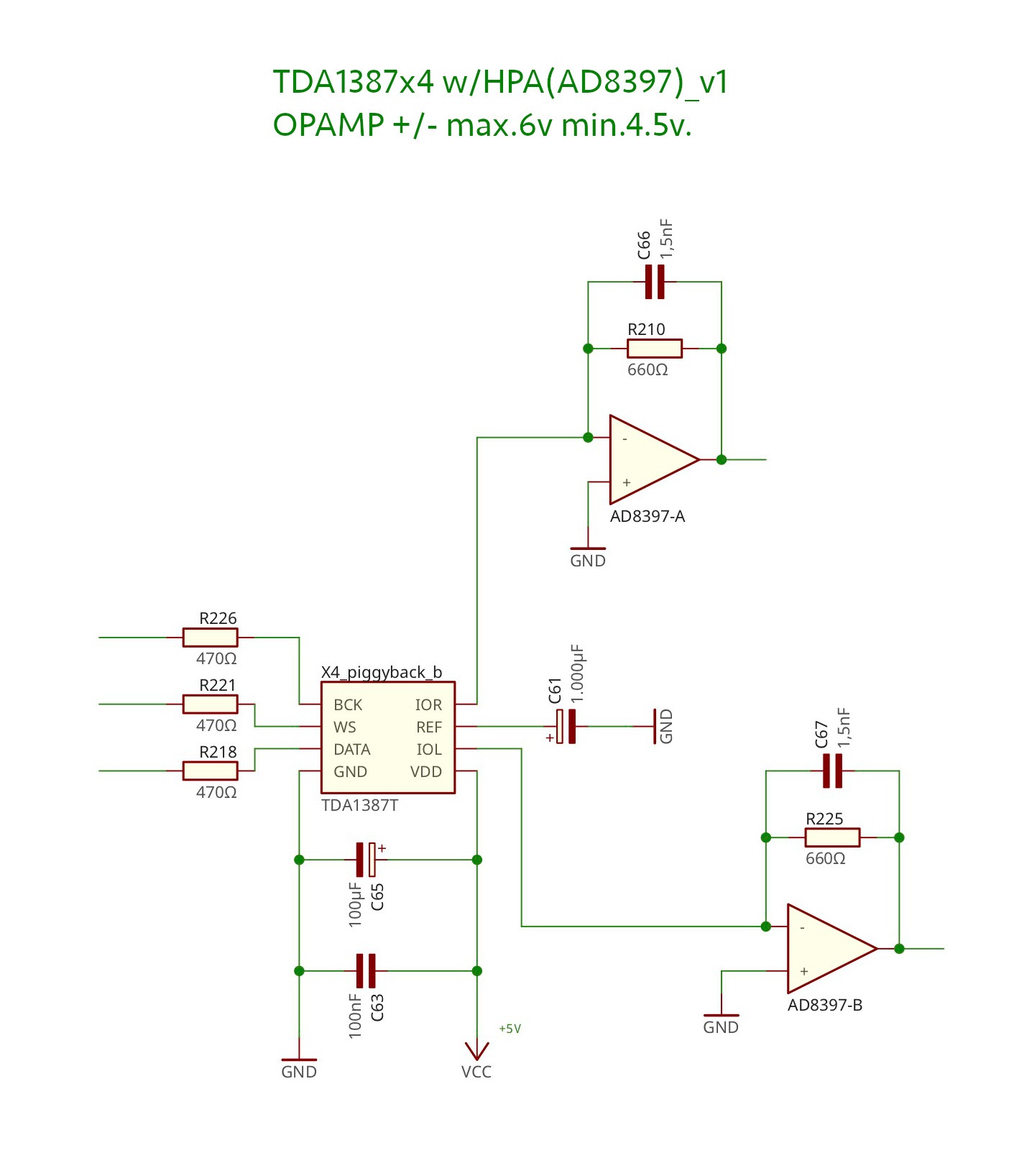

In the diagram below goes what I intend to do so far once I receive the parts. The idea (again) is to solve the IV stage with an opamp with gain of 10, so it can drive headphones as well. Feedback resistor in the diagram gives I guess unity gain. If I increase the value of R210/225 by a factor of x10, gain would increase to 10 or I would simply get a crazy distorted signal :s? Also, I've been reading an article on how delicate or 'cranky' high speed opamps are but couldn't understand fully yet the measures to take about it, particularly in this case.

The gain of an IV stage is most appropriately expressed as a transimpedance. That is volts out per mA in. With 660R and 4mA input you'll get an output swing (peak to peak) of 2.64V. If you increase those fb resistors by a factor 10 the output swing would in theory go to 26.4V which in practice it can't because you don't have enough volts on the supply. So you'll get clipping (i.e. distortion). Somewhere in between 660R and 6.6k you'll find a happy medium - most headphones are playing plenty loud at 2VRMS so perhaps 1k5? That gives you 6V swing and easily handled on +5/-5V rails.

There's one further thing that I don't think we've talked about, and that is offset. Seeing as the output of the DAC chip is unipolar, the output of the opamps will be the same unless a circuit is included to offset the zero point. Without a level shifting circuit, the 6V swing cannot be accommodated on +5/-5V rails.

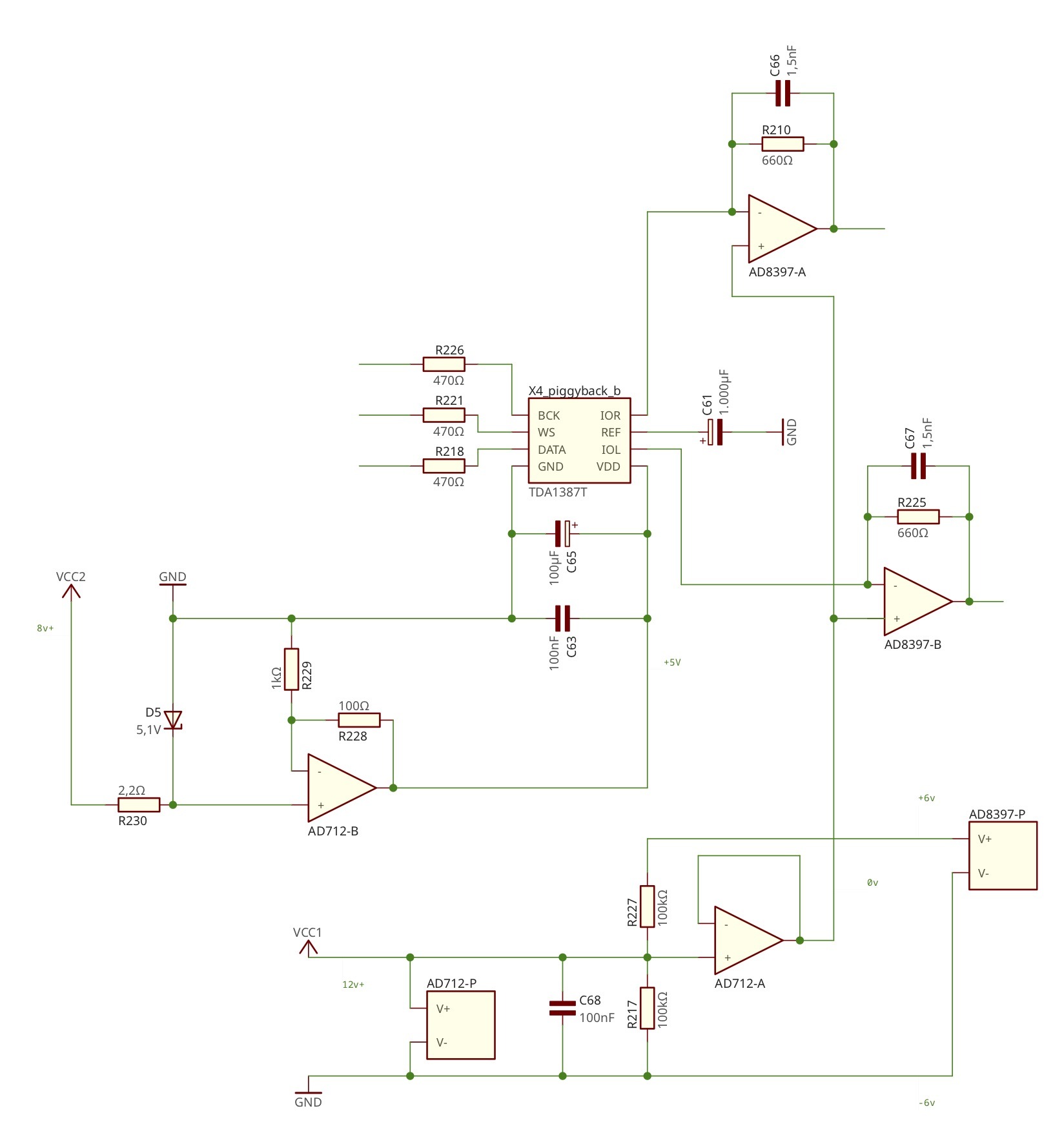

Here I share the general idea for powering both the DAC and the IV/HPA opamp. One amp of an AD712 is used to split the 12v rail into +/-6v, to feed the IV/Headphone opamp. The other AD712 amp is used as a linear 5v regulator using a zener, to feed the DAC.
The 12v power source (VCC1) are 3 x 4v lithium batteries in series. The 8v source for the DAC regulator (VCC2) is simply taken from the second battery in the series.

Is your schematic drawn as you intended? I ask because you said one half of the AD712 is a rail splitter but AD712-A has its +ve input connected to the V+ (positive power pin). I'd have guessed R217 & R227 were doing rail splitting.
I fear your scheme (even with the mid-rail opamp corrected) won't work because you have TDA1387 referenced to 'GND' which from the opamp's pov is V- - this forces the DAC's output compliance beyond its working range. AD8397's +ve input pin must be between GND and GND+3.5V for the DAC to function. There may also be a limitation imposed by the AD8397's common-mode input voltage range but the datasheet doesn't seem to offer any information on that.
I see what do you mean and think I start to understand. You are right with the rail splitter (AD712-A), I messed up with one connection VCC1 goes to the other corner of R227. :s
But also I see now why this is not gonna work. So to clear out things a little bit for myself (before drawing), the unipolar DAC will output a wave that can swing between 0 and 3.5v (DC output voltage compliance). Then we have to feed the inverting input of AD8397 from the midpoint of this wave, to comply with the bipolarity of the opamp. To do this I have to pull down the DAC output in -1.75v in theory... Correct? My intuition to do that is to put a pair of resistors of the same value before the inverting input of the opamp, as voltage divider. One resistor from signal to the opamp inverting input and the other to ground, this way the shift accommodates to the actual voltage at each instant. But this is just an intuition and a start, it is great to understand but wouldn't of course pretend to discover the wheel again.
The DAC outputs a current and normally wants to see a fairly constant voltage on its output as the current swings from +1.08mA down to +0.08mA. The opamp by action of large gain and feedback keeps its two input terminals quite close together in voltage. So we just need to choose a voltage between 0 and 3.5V for the +ve pin and that'll set the DAC output (on the -ve input) at the same voltage no matter the current coming out.

The voltage for the +ve has to be fixed? Should I for instance use a 3v zener (this is the lowest I have)? Or a voltage divider giving ~2.5v would be enough? I could place a pair of resistors dividing the 5v of the DAC power source confronting the +ve.
If the voltage at the +ve input varies it won't affect the DAC much but any variation on that pin will get passed on with a gain of 1 to your output (and hence your headphones). The challenge with this design is having the +ve pin at a voltage which suits both the DAC and the opamp. With a single supply arrangement I've solved that problem in one of two ways in various designs I've done.
1) Raise the DAC's GND pin a few volts (say 3V-4V) with a zener so that its output compliance range includes your mid-rail voltage.
2) Include 2 common-gate MOSFETs to cascode the DAC's outputs - effectively this allows a higher compliance voltage
There is also a 3rd way - reduce the total supply voltage below 8V and set the DAC's VDD to 5.5V, then the mid-rail voltage comes just within the 0 - 4V compliance range of the DAC at 5.5V supply.

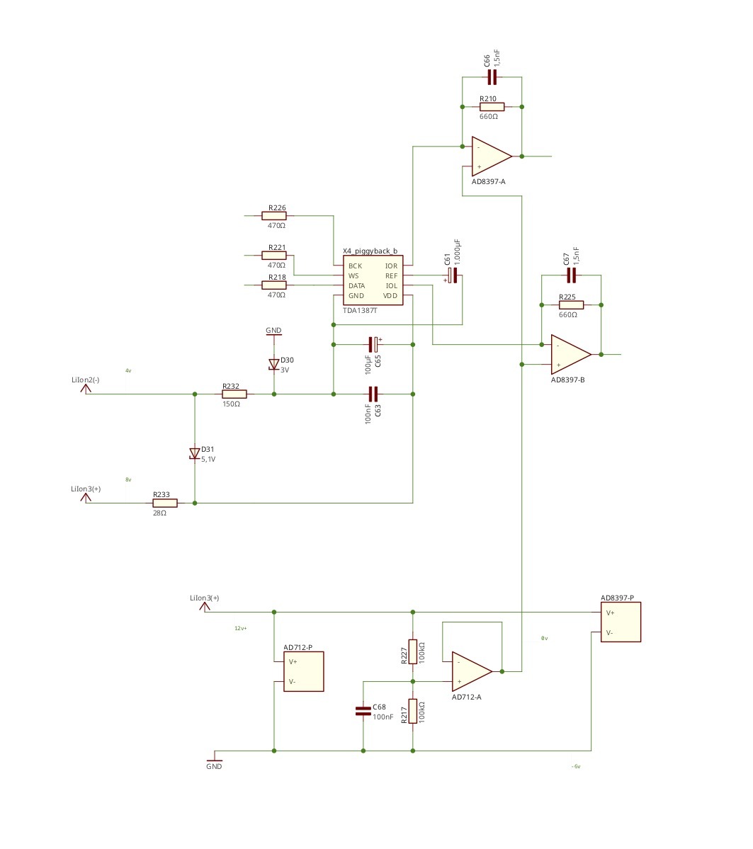

Thanks for your patience @abraxalito. After thinking about it and trying to find a simple solution, maybe the following circuit will work. It lifts up the ground of the DAC in 3v using a zener and the first LiIon in the series. 3v is the cutoff voltage of the battery so I prefer it to a higher value. The DAC's VCC is taken from the second and third batteries, regulated at 5.1v by a zener. I removed the opamp linear regulator because maybe it was not necessary, since the overall consumption of 4x TDA1387 must be around 22mA max., well below the zener's max. current. Although I'm not sure if they will introduce perceivable noise.

Do you know the 4V compliance range of the DAC at 5.5v by experience, or any other source? I don't seem to find that in the datasheet, where 3.5v max. is stated (p.8). But I like you 3rd way of going down to a 4+/- rail, it allows a fixed voltage for the AD8397 therefore headphones won't decrease gain as batteries drain. I'm afraid now that this is a problem in the diagram I just shared.
I can't quite understand the reason for a connection to intermediate points within your LiIon stack. Seems to me that'll lead to a heap of pain as the cells discharge at different rates.
You're right, a 3V zener will be fine at 22mA - you can delete R232 (replace with wire) and the connection to the internal node of the LiIon stack. To feed the DAC+zener in series you could introduce a current source set to 27mA - 22mA for the DACs with 5mA for the 5V1 zener. A current source will do better than a resistor as the LiIon voltage varies over its discharge. The opamp might not need a regulated supply but I'd replace R217 with a zener to keep the voltage at the DAC output constant against LiIon voltage variation.

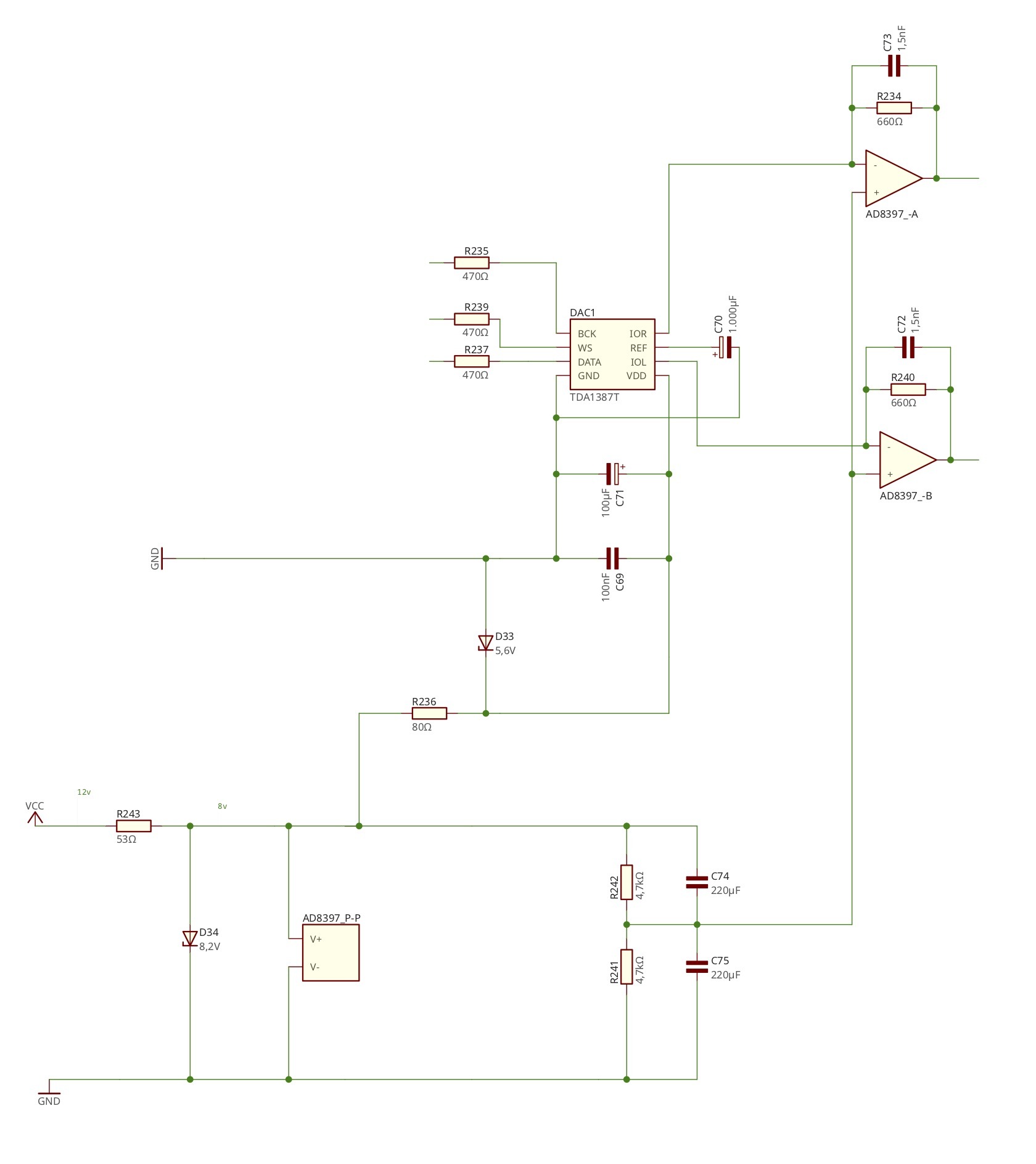

Do you think I can get rid of the opamp feeding the opamp, using a simple resistor divider (with caps) and overall voltage set at 8v? The main reason is that the opamp takes space and is current limited (so I guess I would need two half opamps or a pair of transistors after it to feed the 45mA @ 2.9vRMS drawn by the headphones).
In the following diagram I'm trying to get rid of the 'heap of pain', with no connections between batteries–which was based on my ignorance on how to properly regulate voltage noiselessly and wish for transparency, I'm recently getting into zener regulators. It is mainly based on your own idea of a 'third way':
