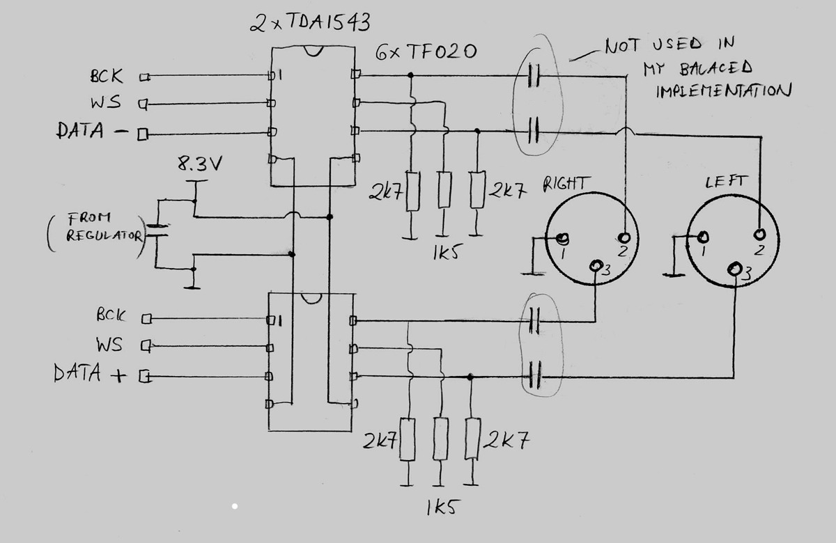

Alternatives are - a servo, but that always uses a cap though it can be a smaller value. A digital servo using an MCU can work without a cap though.
There is an old thread from Peter Daniel with a balanced passive I/V going to a stepped autotransformer preamp. I don't understand how a digital servo works.
So Peter Daniel was content to DC couple a TVC from a balanced TDA1543 DAC? In my experience trafos are very sensitive to DC.
A digital servo would be an ADC reading the output offset coupled to a DAC adjusting the offset. Software to be determined.

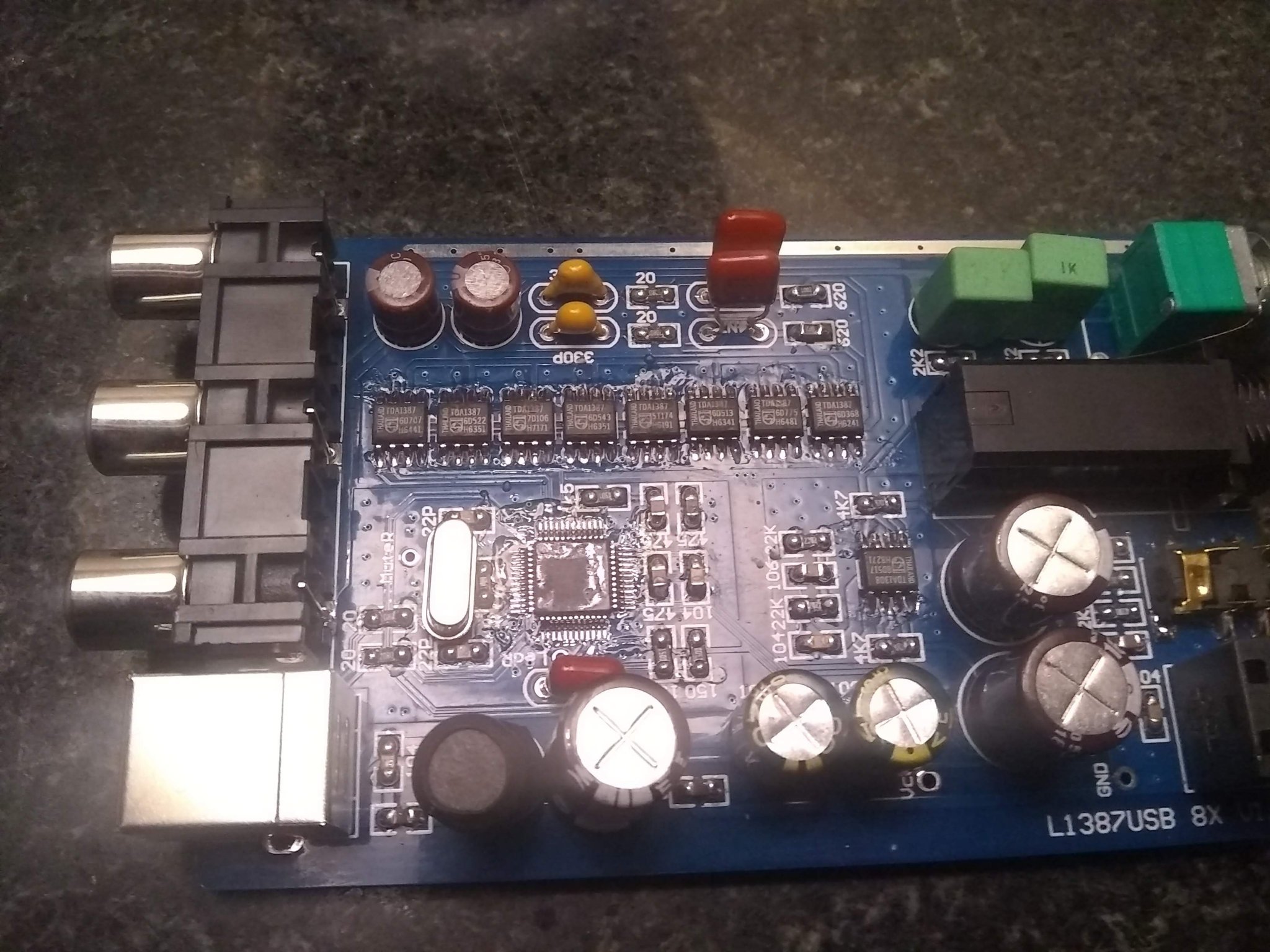

We had a significant improvement with passive I/V using TX2575 resistors. I think pure resistive load is best. The TX are pricey, but significantly better than AB carbon comp. I also measured THD vs resistance at 0dB for the 8x modules. H3 starts increasing at about 450R or so. I have a graph, but not with me now. I had 475R of the encapsulated Vishay metal foil, which sound excellent with classical music, which rarely hits 0 dB. Pop is often nearly continuous 0 dB, so it distorts. The advantage of passive I/V is simplicity.
Here is the raw data, THD and I/V resistance at 0 dB. 8x module, 5.04 Vcc. Best to chart as a scatter plot to best see the relationship. Output of course drops with lower resistance.
0.0070% with 114R
0.0080% with 223R
0.0097% with 322R
0.013% with 447R
0.018% with 460R
0.040% with 470R
0.053% with 474R
0.054% with 475R

From what @hifiamps shares, it is quite important to have good quality low I/V resistors (max. 460ohm in 8x version) to keep distortion low. But since headphones will require a quite high resistor, from what I understand, there will be a trade off necessarily.
