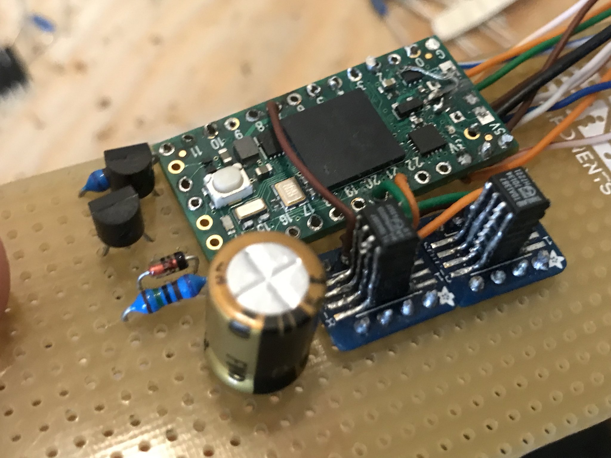

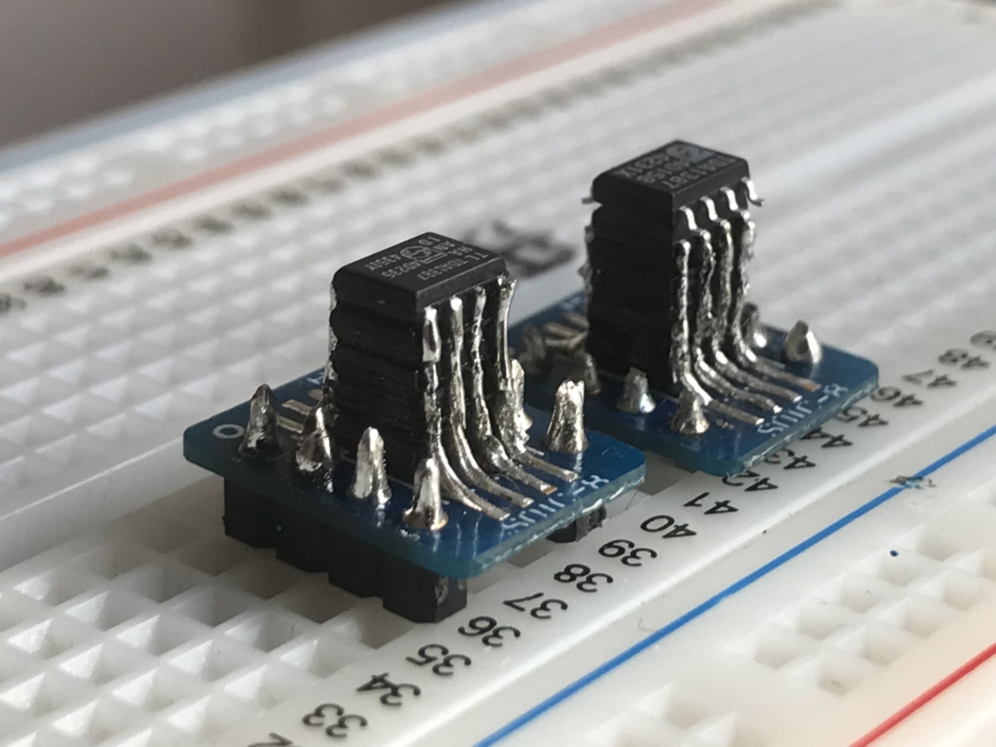

I soldered two towers, 11 chips in two groups of 5/6. I've only been testing in the last hours and the DC filter doesn't seem to be working yet. A scratching noise comes and go, same that can be heard when HP is connected directly to the DAC output.
Vref opamp seems to be working, I can read 1.76V stable while sounding. Connected to HPs GND.
Current sink also seems to be working. I increased the resistor to 150ohm because now I'm using only 5 chips for testing (so I don't go deaf with the noise). Multimeter between 150ohm sense-resistor and GND reads 4.4mA, half of the total estimated consumption -> (5mW / 63) squared = 9mA.
Common ground to digital source is not the problem, noise persists when unplugged.
I'll keep on trying and breadboard it all again, maybe digital lines are too long... Just reporting, maybe some ideas come.
Sharing pics of the towers they look good. Just glued them with epoxy first, then bended the legs down and dropped solder thought each rail.
There's no need to parallel all the pin7s, that may save you a little time on the next build. When they're unconnected they serve as a useful health check for the DAC, when that voltage is out of spec the DAC's normally a dead one. But there are other failure modes beyond that which could be the cause of your crackles.
Its a good idea to buzz out all the pins from top to bottom with a continuity checker to weed out dry joints.
I've been doing some process here, just needed some time and calm to plug everything correctly and source back the problems.
Noise was coming massively from the 78L05 regulator. I replaced it by a zener + current source and voilá, it sounds clean and quiet. I followed the circuit that you @abraxalito shared with me in page 3, which seems to be the proper voltage regulator for this. I've read that zener are noisy but I don't hear any noise from it–although I'm still at a very low level.
When I add caps to the VDD of the DAC they sound nasty, no matter what I put on. I can hear current fluctuating along the cap so I simply removed them. Only cap in use is the vref one (220u Nichicon). No caps at the output either. It works fine with an I/V resistor of 510ohm and a 220u output cap, but even better without any, DAC outputs direct on the headphones. Strange enough I don't hear any effect from DC current, if noise should be there I cannot perceive it and the sound is very crisp so I wish to leave like this.

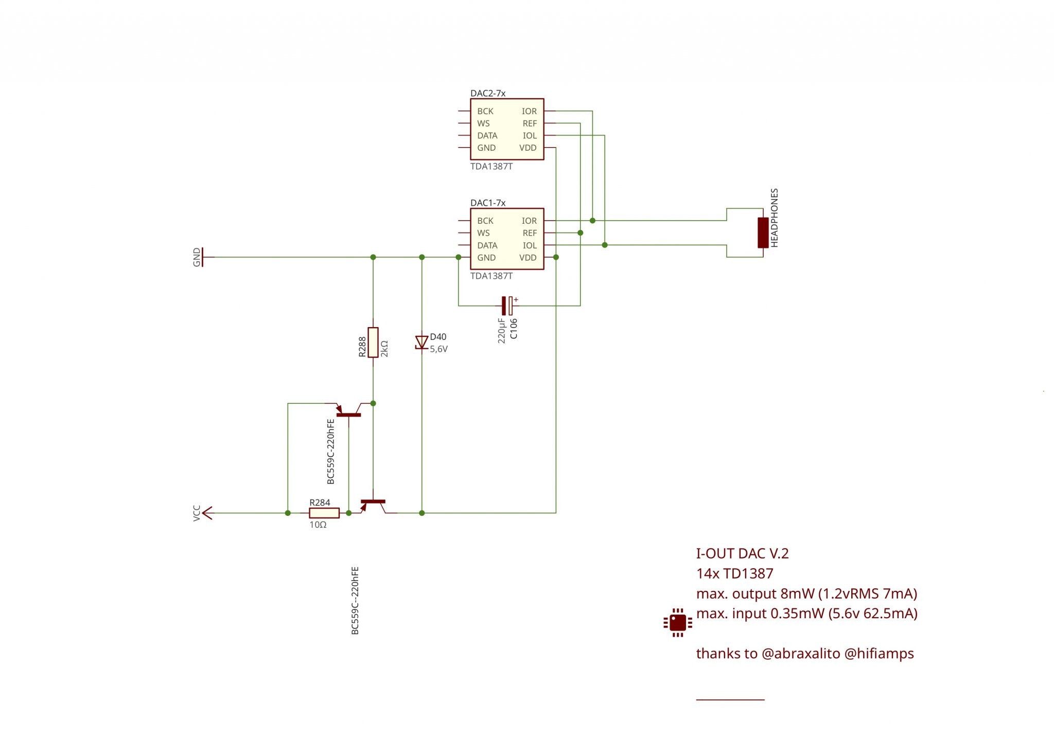

Here goes what I ended up going for, after much trials and learnings. Definitely I got the best results from a direct current connection to headphones. The drawback of the design is that the output can only provide headphones/speakers–not other devices, but that was the initial idea.
I found that no other caps than vRef are actually needed. But the constant current/zener voltage regulator circuit is powered directly from a battery stack and the I2S source (MC) has its own independent battery.
The output is loud enough for the specs indicated in the drawing. With 63ohm 106dB/mW headphones it is loud enough to be painful (112dBSPL). It sounds crystal clear, quite detailed and with an impressive beautiful soundstage. More 3D than anything I've heard, which is the NOS DAC effect of course but lacking an amplification stage adds detail to it. Compared to a 8xTDA1387 + JLH Class-A headphone amp I've been using over the last year, here you feel the lack of power of course but details can be perceived more precisely, in my (forgive the audiophilia) humble opinion.

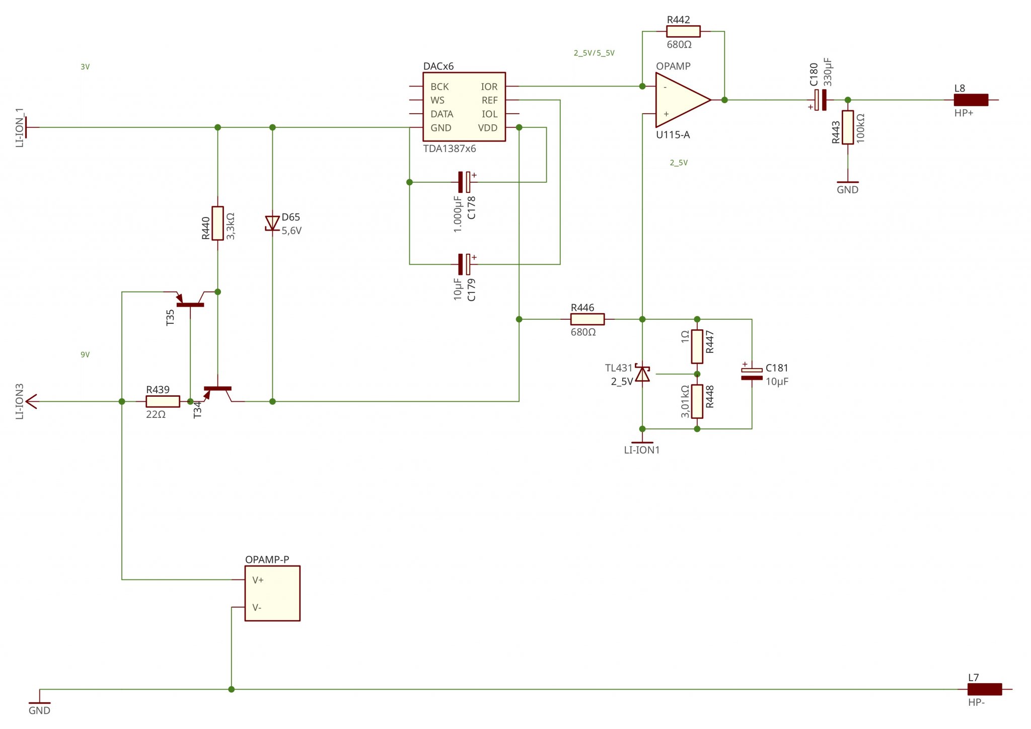

I've been experimenting again with this DAC design quite a lot lately, mostly because the last solution posted (#110) sounds great, but it consumes too much battery power and it is not loud enough for monitoring sound. So I went back to one of the designs with opamp I/V stage / HP amp...
Shifting the ground of the DAC with a zener worked to an extent. With the DAC at 5.6V and outputs at 2.5V I get a nice loud 1.5V swing–the opamp ve+ at 5.5V with a fixed reference. The problem however is the ground shifting zener. Voltage is inconsistent, with any zener between 3-3.9V I get 4V under load. It also gets quite hot, since I have an ADC running in parallel that has to be grounded on it as well, as you indicated me. In total ADC and 6xDAC are passing around 50mA through it and I'm afraid of the noise that this zener is actually producing, as ADC and DAC grounds meet there.

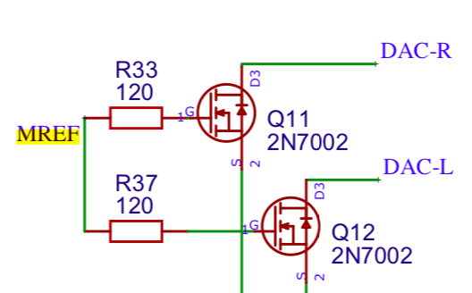

So I went back to your mention of Mosfets to increase the DAC's VDCC. Solving the source of the problem this way might mean avoiding all the troubles of ground lift and the power waste related to it 🙂 Surfing your blog I think to have found an application of this in your Dorati. Picture attached. I'm I correct? Does it suffice to add a Mosfet simply in this way to increase VDCC? I guess MREF is the desired VDCC... Up to what voltage is it then increased (supposing DAC VCC at max. 6V, with a min. 1.5Vp swing). A pair of 2N7002 are on the way to experiment.
I'm unclear what you mean by 'VDCC' in relation to the DACs. If you mean its pin5 voltage then that can't increase above 6V. Perhaps you mean the DAC's output compliance voltage, this is increased through use of MOSFETs.
The MOSFETs increase the available swing on the current output, which is moved to the drain terminal of the FET. The voltage at the DAC chips' outputs is (MREF - Vgsth) where the latter is the gate threshold voltage of the FET.
The tricky thing with using 2N7002 is the Vgsth varies a lot between different examples leading to choice of MREF being fraught with difficulty. So I have given up using that particular part, now I use Rohm RYC002N05 : https://www.mouser.co.uk/datasheet/2/348/ryc002n05-e-1873326.pdf This FET is a beauty and its consistency of Vgsth is impressive.
MOSFETs alone though can't provide a full solution, you'll also need biassing current sources (to 0V on the FET source, to VDD on the drain) to keep the FETs in their active region.
I'm sorry for the imprecision, with VDCC I referred as you guess to the voltage at pin5. Should I assume then that with a MOSFETs stage on the DAC's output I could set pin5 at 5.5V and still have a voltage swing from 4-7V? So the output swing of the MOSFETs can go even higher that the DAC's 6VCC?
Here is where I am (schematic attached). To avoid the ground shift zener's dissipation and noise, I use the + of my first Li-Ion as ground for the DAC instead. Batteries voltage are written at min. voltage (3V). A TL431 defines a 2.5V reference for the DAC's pin5. This shows as 5.5V to the opamp ve+, which I think is the ideal midpoint for some opamps limited to -Vs +4 input common-mode voltage.
The setup sounds good, plenty loud and clean. The only disadvantage I see is that batteries 2-3 will obviously discharge more than 1. My ADC is loading 22mA on them additionally... I will try with only 1xDAC so the load comes down to the bare min. at least.
Yes, with a MOSFET acting as cascode on the DAC's output, your output voltage swing limit becomes the MOSFET's breakdown voltage (50V for the Rohm FET) rather than the DAC's output compliance limit.
Thank you! I will have to study how to bias the MOSFETs then, cascode means at least two of them per channel as I see. If pin5 would be at 5.5V, which I intend, then the voltage swing would be too high for my headphones I'm afraid–since 2.5V seems already enough. How would you attenuate it then later? With an extra series resistor to limit current? The obvious thing would be to lower pin5 voltage but then I hit the opamp's minimum input voltage limit.
