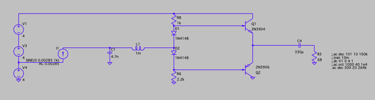

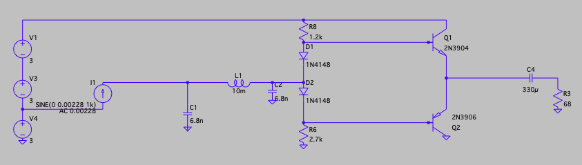

What is the reason @abraxalito an LR filter is not working when the inductor goes directly at the DAC's output–so biasing resistors R6/R8 can form the filter. With an effective resistance of 1k here I don't get (for testing purposes) the expected fc at 15k.
Is it rather recommended to include an "additional" I/V resistor before the inductor? Would that also avoid the inductor from increasing the output compliance of the DAC?

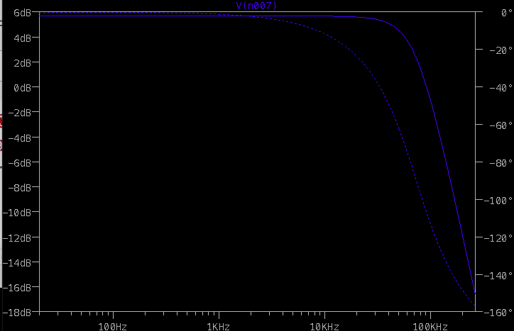

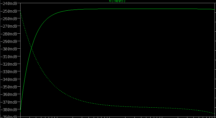

The AC analysis does show up that there's no attenuation at HF when feeding an inductor from a current source - I get that too on my (simpler) sim of CCS -> L -> R. Which is kind of surprising at first glance.
To see what's happening, look at the voltage on the DAC output as the frequency increases - it increases too. So from a voltage perspective there is attenuation - so the LR is operating just as you'd expect - but the input voltage increases and the output stays flat. Rather than the input voltage staying the same (as it would with a voltage source) and the output decreasing with frequency.
Just adding a cap on the DAC output solves this and gets you back to where you want to be, having an HF roll-off. Looks to me that 10nF (in parallel with your current source) is about right with R=1.35k. But that's without any R in the 10mH so you'd best find an inductor you like and get its ESR to plug into the sim.
Adding a resistor before the inductor will work but that wastes DAC output current (and hence battery in this application) so an inferior solution to a capacitor there.
Thank you @abraxalito, the small cap between inductor and DAC was extremely useful and the part I was missing. I noticed how the voltage at high frequencies increases DAC side without it, also that when the cap is not big enough a peak at the cut-off frequency is formed. I think this behaviour has been used in some of your applications before to compensate for the 'NOS droop' at 20kHz.

Yes - in filter terms varying the cap varies not only the fc (cutoff or corner frequency) but also the damping and damping is directly related to the 'Q' of the filter. We normally want a Q around 0.7 or so for a flat response. Increasing the Q gives peaking at the corner frequency and that is indeed used to correct NOS droop in some of my (and others') filter designs.

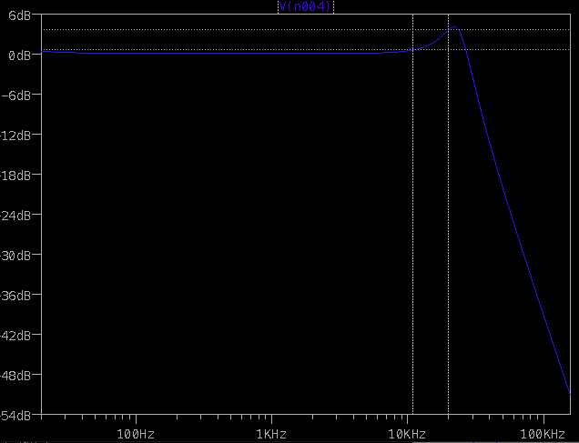

Bourns RL181S would have to be–I managed to make space for it. With Q 0.7 and "peak" at 20kHz, -3dB calculates I think at 10.92kHz on the hearable side. This seems to be achieved nicely by the following figure which also brings down the first images to -50dB, maybe the digital filter wouldn't even be much necessary > 68n - 10mH - 68n. Please correct me if I am wrong.I'm not fluent in C but from your link it looks as though you have a choice of linear or CIC interpolation. I'd not heard of the latter before so I'll investigate that somewhat. I was looking to see if he was using a traditional FIR and didn't see any evidence of that like an array of coefficients.
Ran a plot and found the boost at 20kHz is right (3.2dB) but the shape of the curve itself is too narrow, gain at 10kHz for example should be 0.75dB but only 0.25dB with this circuit. I made the shape wider and increased the 10kHz gain by reducing the cap values to 5.6n. Since my hearing goes nowhere near 20kHz I tend to pay more attention to 10kHz where I still have some left.
@hifiamps - there's going to be a difference in frequency response when going from NOS to 8XOS which makes the sound a tad more airy. At least it does to my ears but really not so easy to notice without direct switching back and forth.

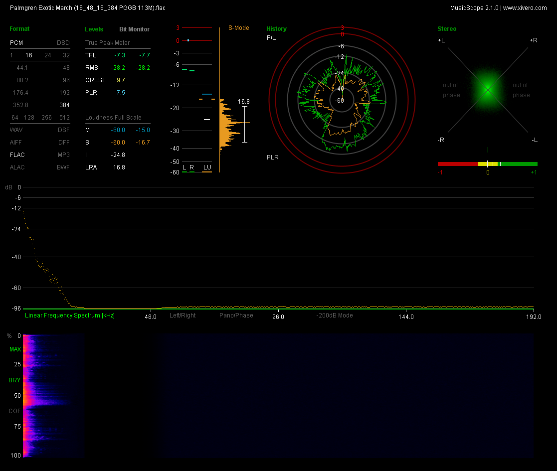

An interesting finding with the upsampled files is a very low level noise from 49kHz to 192kHz, maybe dither noise? Seen in the frequency spectrum plot and also in the bottom chart which appears as a field of purple on the black background.
Do you know @abraxalito how to achieve an accurate curve using more standard capacitor values? I'm using MKS and FKS from WIMA and 5.6n is not available. Only 4.7n and 6.8n around that value and very easy to obtain. Otherwise, any 5.6n capacitor type/brand you would particularly recommend?

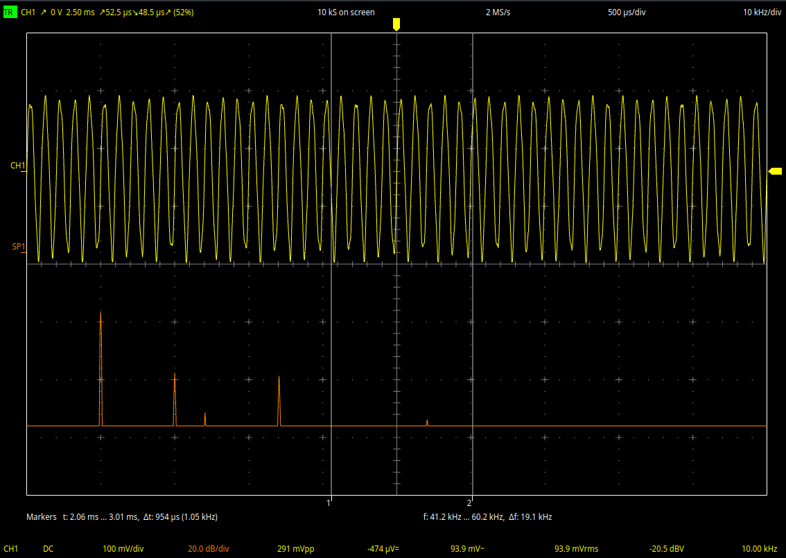

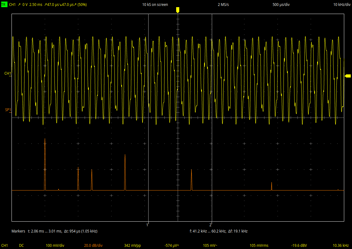

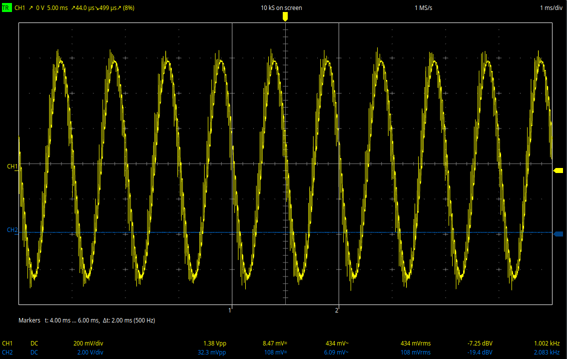

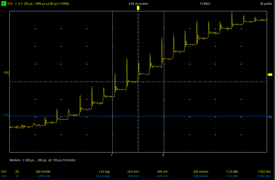

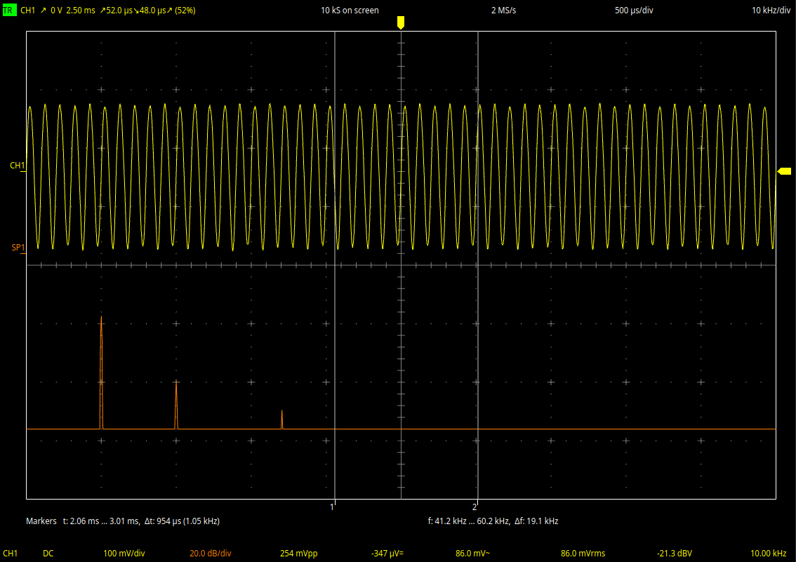

I made several experiments today that I would like to share.

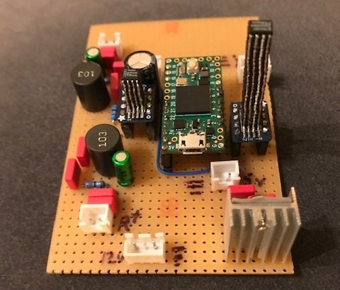

Test board is based on a Teensy that allows oversampling and has two I2S ports. On the first one I set 8x TDA1387 chips with a flat passive filter published by @abraxalito in post #12 of this thread. Only difference is I used an 82ohm I/V resistor instead of 100ohm, it fits better my amp. Also, I used a 2n cap instead of 3.9n at the end of the filter's chain, this way I got a very flat response with a -3dB droop going from around 5kHz to 20kHz.
Sampling rate was 44.1kHz, tested with oversampling alone and digital filter.
1. 8x TDA1387 / NOS @ 10kHz.
2. 8x TDA1387 / 4x oversampling @ 10kHz.
3. 8x TDA1387 / 4x oversampling + CIC filter @ 10kHz.
I noticed a mistake on the breadboard later that might be responsible of sinewave errors, but it seems to me that 4x oversampling and digital filter get rid very effectively of distortion. I'm not sure if that distortion is solely produced by sampling images or harmonics of a different kind, this is quite new to me.

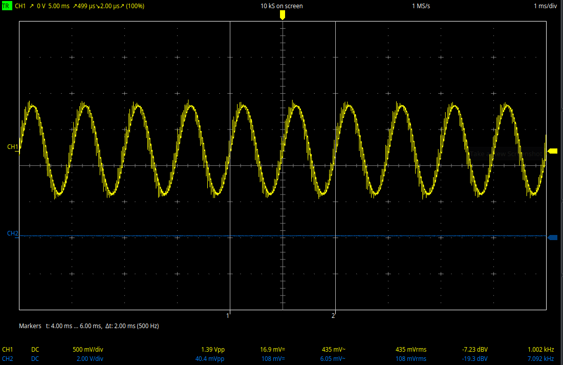

On the second I2S port I installed a 24x chips tower (got a bit hot) directly on some 63ohm headphones. No I/V resistor and all vref pins floating. Against my belief, the result was not very good. Quite a lot of noise, which I can attribute to DC current because of lacking an output capacitor or/and temperature of the tower. Also a ladder of samples can be seen when looked closely.
24x TDA1387 / I-out on 63ohm @ 1kHz
So the I-out idea is not as simple as pilling up many chips and using headphones as an I/V resistor. @abraxalito mentioned in this thread that for I-out a current sink to create a negative current swing is needed, but I'm not sure if that would also take care of noisy DC current or soften the ladder I'm seeing/listening.

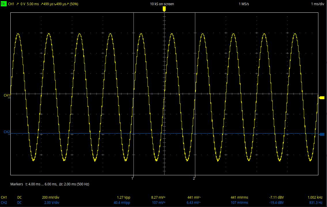

Hi Zoran,
I appreciate your remarks. I just tried as you suggested with a 75ohm I/V resistor instead of the HPs, which seems closer to their actual impedance. All that 'noise' is gone
24x TDA1387 on HPs
24x on 75ohm resistor
No idea what this reactiveness means. Maybe some kind of oscilloscope error, which it sees but one cannot hear, or the headphones are a bit bad?...
Anyways the ladder is still there. I tried next with a smaller 8x chip tower and the same ladder appears.
Do you mean decoupling the vref pins? If that's the case, it seems better to leave those floating.
