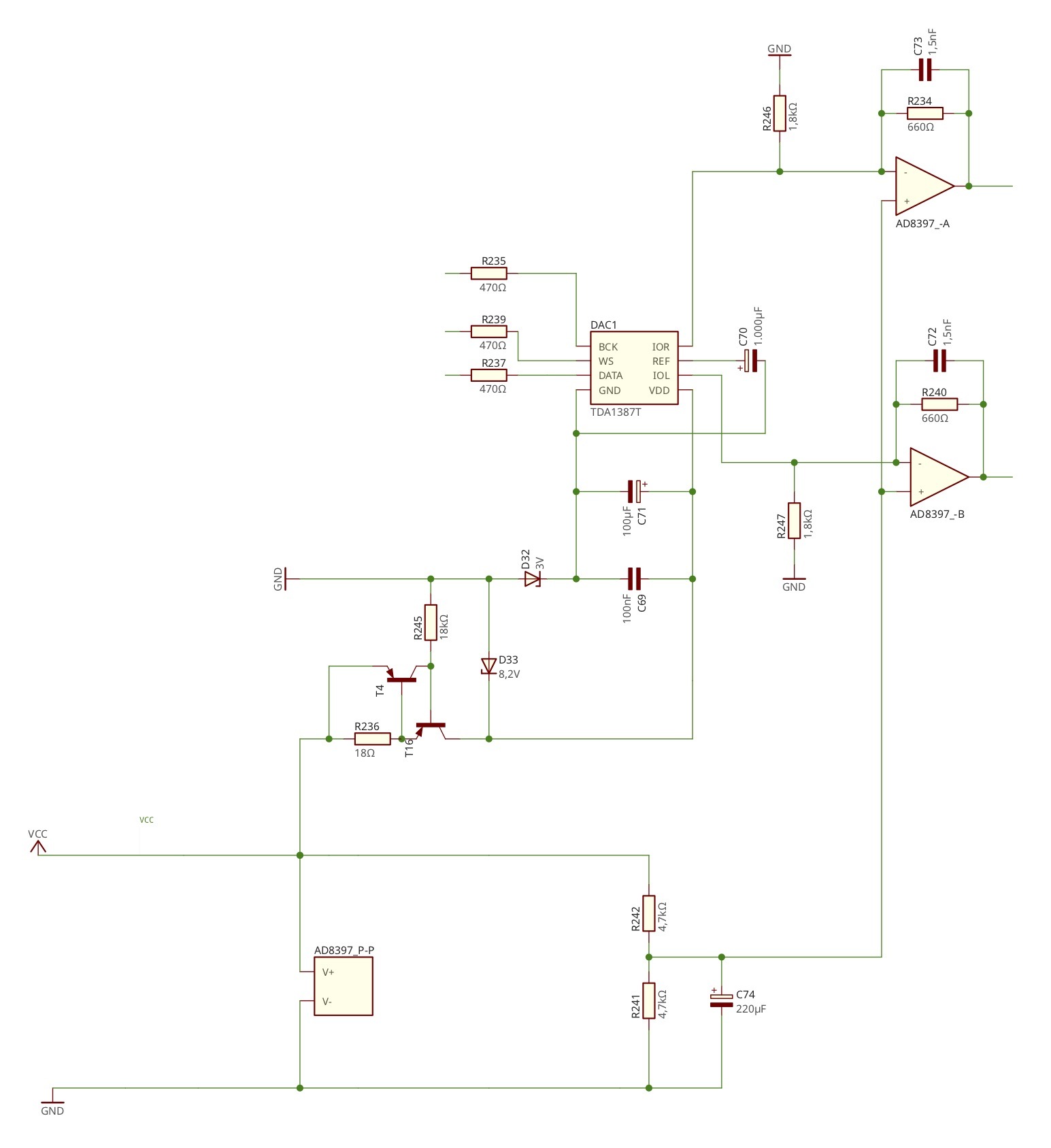

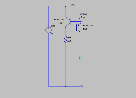

Current source schematic is attached. The terminal marked 'Out' goes to the cathode of D33, taking the place of R236. (D34 by the way is upside down).
Yes I think its a good simplification to delete the opamp. You can also delete C74.
Now we've gotten the DAC with appropriate output compliance voltages the last step is compensating for the offset. 1k8 resistors between both DAC outputs and GND should do the trick.

Thanks a lot for the schematic. Could I use a pair of BC559A as transistors for the current source?
https://www.onsemi.com/pdf/datasheet/bc559-d.pdf
If yes, resistor values would be the same?
I'll add the current source and your comments to the drawing 👍👍, but I'm slightly wondering what the actual advantage of a current source in this case would be. In theory the 5.6v zener-resistor voltage that feeds the DAC shouldn't be affected by battery drain, since it's source is a 8.2v zener regulated by a stable source (as itself is powered by min. 9v).
I wasn't intending you feed the current source from the 8.2V zener, rather directly from the LiIon stack. That's why I wrote 'VCC' on its power supply. I will check to see if BC559A are suitable and get back to you on that question.
I think the 8.2V zener scheme is problematic as shunt regulators (zener regulators are shunt type) always need to be biassed above the maximum current draw expected by the circuit they're powering. That circuit in your case is a classAB amplifier which draws a variable current depending on the music. If the headphones are 32ohm and driven by a max 2.8V signal that results in a peak current of 88mA per channel so 176mA totally. It will be a real waste of power to bias a zener at 180mA, not to mention a single 8.2V zener won't be able to sustain the power dissipation.
I was realising today the situation with using different headphones, while trying to bias the 8.2v zener. Also, I see now that biasing the 5.6v zener will be also wasteful as voltage runs down, so the current source is more than welcome!
What would you recommend to power the opamp then, if not the shunt regulator? A linear regulator I guess but I was also trying to avoid it, if possible.
Should I maybe then go back a bit to the previous design maybe? Where the DAC GND is raised in 3V by a zener (directly from VCC), DAC VDD fed by a 5.6v current source (as per your scheme) and run then the divider/opamp directly from the 12v VCC.
Biasing the 5.6V zener is only wasteful to a small degree as the maximum current is close to the typical operating current.
You could try feeding the opamp directly from the LiIon stack and see how that works out. If that turns out no good then yes a linear regulator is the next best solution.
BC559s should be fine for the CCS. The max dissipation is just under 200mW at the highest battery voltage (12.6V).
Hi Abrax. Do you think the following diagram will work? The zener for the CCS is 8.2v, so with the addition of the 3v zener at the DAC's ground we meet 5.2v VDD. Since the opamp GND is -6v max. /-4.5min., the DAC's output voltage should be set between 3-1.5v.
I don't fully understand how your CCS circuit works internally, but I think I was able to tweak the resistor values using a simulator to provide 25mA @ 5.2v at the load. 20mA for the DAC, 5mA for the 3v zener. Extra 5mA for the 8.2v zener are also considered.
If you see any problems to it, or any component that could be reduced in size (ie. the 220u cap. for the resistor divider), please let me know.

Now you've arranged the DAC's output voltage to track along with the discharge of the LiIons, the 1k8 resistors no longer act as current sources because the voltage across them is changing. I'm not sure whether this will turn out to be an issue in practice - your HPs will be AC coupled so it won't concern them.
Your version of the current source has 18R to determine the current, I'm getting ~33mA output current (0.6V/18) and wonder why you'd want it so high? Your DACs are taking ~22mA and the 8.2V zener needs a few (2-5) mA to regulate. The 3V zener's current doesn't enter the equation - that'll be whatever the DACs are drawing.
Apart from these minor points, everything else is looking good now. Remember the GND for the I2S input needs to be DAC GND (TDA1387 pin4) not battery GND.
When you say GND for I2S input do you mean the source of the digital signal? If that's the case I would be in real trouble, because the source is an ARM that produces a lot of noise and is therefore powered by its own single LiIon, so no way I can raise its ground voltage in 3v as well. Unless I would integrate the MC to the 12v stack and isolate it somehow. Also the clocks are generated by it.
I can go back to the values you suggested for the CSS, I thought the 3v zener needed it's own extra current :s
The source's GND needs to be connected to the DAC chip's GND (pin4). I can't see why there would be any problem when both are powered by their own LiIon cells. You're not raising the source's GND voltage, you're raising the DAC's GND relative to its own power source (which is isolated).
I understand. Relief. Got confused because I have at least an ADC and a 12v preamp behind the DAC and thought for a moment all that had to be lifted up on their own as well. Very important tip anyways. That ADC GND will be on the 3v by default, since I'm planning to use the same 5v of the DAC for it. Therefore–and by the way, I'll have to rise the CCS in about 30mA or whatever that ADC will consume...
How do you calculate the output current of the CCS? I know for instance that 0.6v/18 is 33mA by ohm's law. But where do you take the 0.6v from? And what's the relation with the 3.3k resistor? I tried to find this topology of CCS online but couldn't find any alike, very effective for the few parts on it. I cannot expect a full explanation here anyways of course.
The 0.6V is a number arising from the properties of a silicon diode, or here a base-emitter junction in a transistor (T4 in your most recent schematic). When T4 conducts there will be about 0.6V across the resistor between its base and emitter. Where is a 3.3k resistor appearing from?
On the CCS, here is a very useful resource : https://sound-au.com/ism.htm#p5 Note he's using 0.65V whereas I use 0.6V.
Oh that resistor is normally calculated to supply a bias current of 5-10% of the CCS output current. If we go for 5% then with the CCS putting out ~30mA it should carry a current of 30/20 or 1.5mA worst case (lowest supply voltage). Which results in a value of 4k7.

The diagram above (V6) is then definitely to try, but I'm still hesitating about the effects of battery discharge on the opamp, now that I got more into it and different possibilities
In the previous design (v5), where the 12v stack was reduced to 8.2v and from there a stable 4+/- rail was produced, the problem was excessive power consumption by the zener resistor (particularly when batteries were full, if the zener was calculated at the minimum voltage). Would a linear regulator build with an opamp and a zener voltage reference solve that problem? I'm supposing that, if a zener would only provide a vf on the non-inverting input, power consumption should be proportional to the variable load (ie. different headphones). But maybe the intrinsic power dissipation of the opamp, stepping down from 12v to 8v itself will also be significant? Just wondering to give a chance to the other design as well, I'm realising that that would be a safer design and possibly I'll have a spare opamp to use.
