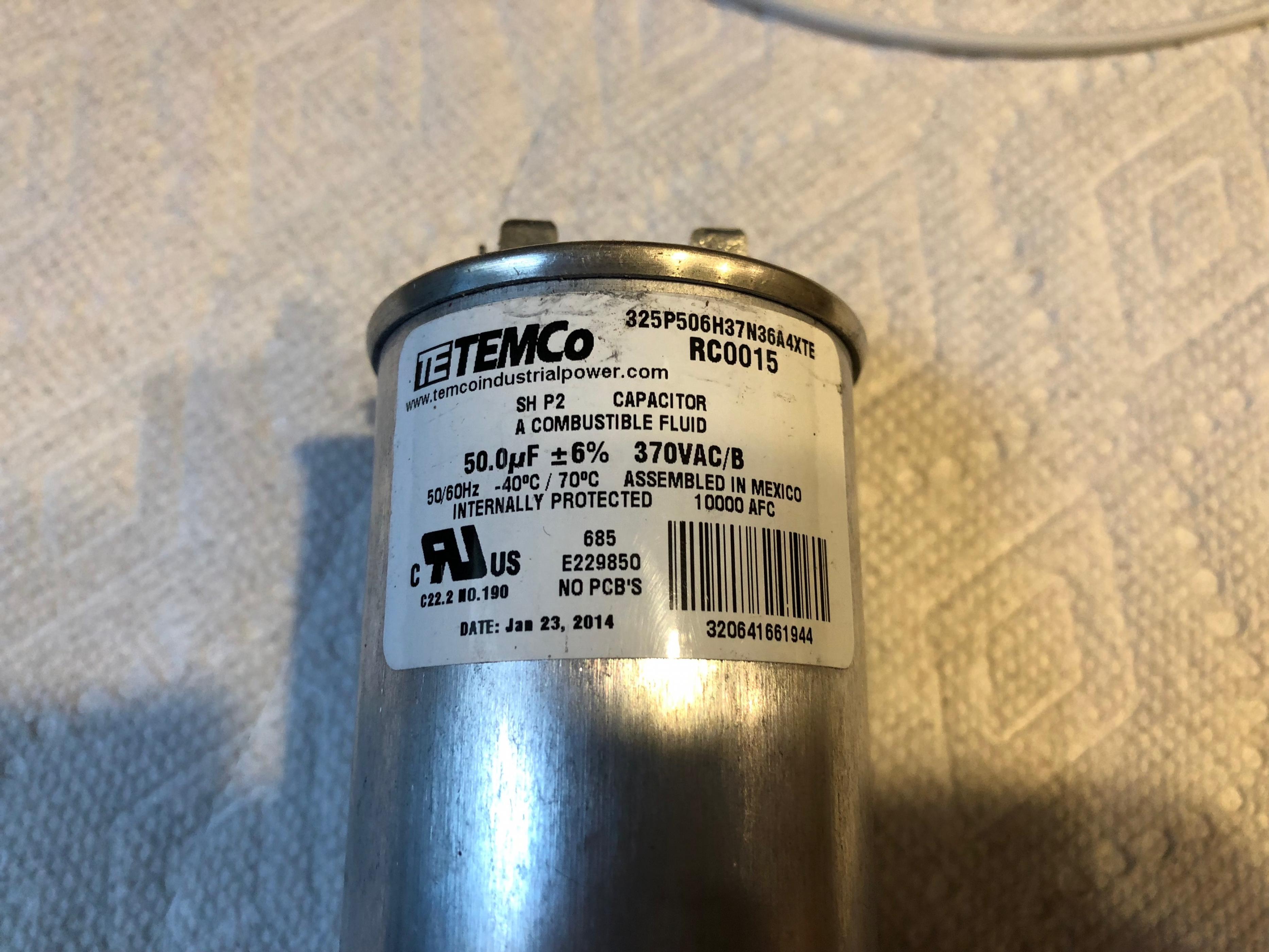

Out of curiosity, what uf and voltage rating are the motor run caps?
I've been using motor runs in my tube amps for some years now but I have shifted to Dc link film caps which are much smaller. Here is an example.
B32778P6506K000 EPCOS / TDK | Mouser

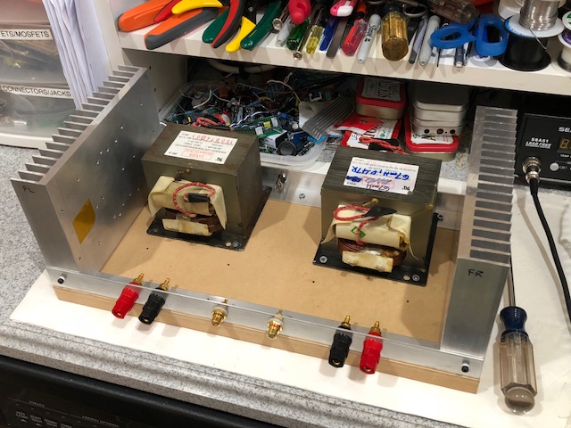

I have started to build my mofo but I am just going to use a couple of 19.5 volt Dell bricks.
ray
Like the size of what you are using ;)

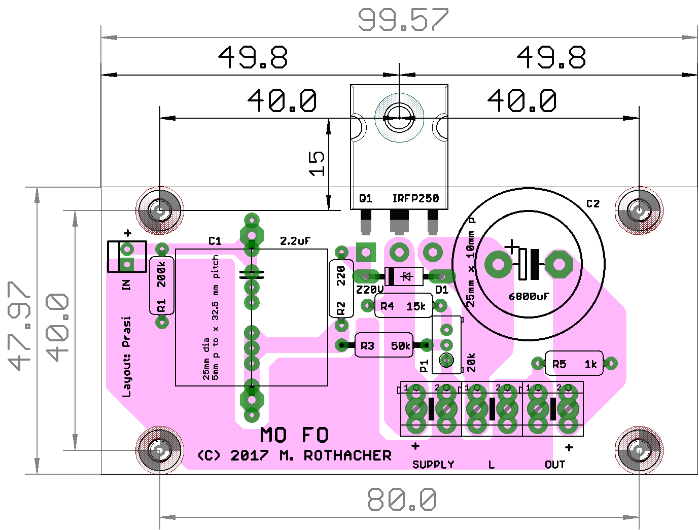

Continuing, here is the revised layout that follows UMS guidelines (80 mm x 40mm mounting holes and Mosfet mounting at 15mm away from mounting hole.) Also included cap pitch options for C1.
regards
Prasi
641925d1508827991-build-mofo-mofo-ums-png
Hi Prasi,
Nice layout. I think UMS says mosfet mounting hole is 20mm away from PCB mounting hole.
https://cdn.shopify.com/s/files/1/1006/5046/files/universal-mounting-specification-v2.1.pdf
If you have the time or inclination, if possible, I would suggest making one with a Juma cap Mx on same board, using underhung MOSFETs directly underneath board and clamped by screws through PCB. Then avoid separate PCB screws altogether. The two MOSFETs would sit on ends left and right at 80mm spacing which fits on 100mm long by 50mm(or up to 100mm to have room for caps) PCB, add two 22mF 25v caps (35mm dia, 10mm pitch snap in) and 3W axial 0.47R (on +ve and -ve or GND sides) for CRC between the cap Mx and the MoFo. This will allow use of 24v smps to get 20v Vcc and very low noise as I have measured. It’s so quiet it can be used as a headphone amp even.
