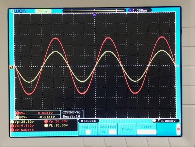

Speaking of bigger hammers, several members with MoFo’s or planning to build MoFo’s have participated in the Aksa Lender 40vpp Preamp Group Buy (GB) to drive their MoFo. GB#2 (second installment of 30 pre-amp sets) has closed and GB#3 has been initiated to cover the additional demand. It’s really an ideal preamp and the build is very easy with just 5 actives and choice of through hole or SMT construction. Lots of flexibility for different input and output coupling caps too.
Here is the bigger hammer driving MoFo to 26.8vpp with a 19.5v Vcc.
649235d1512320583-build-mofo-max-output-unclipped-oscope-jpg

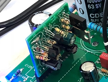

This was the verification build before shipping out preamps PCB sets. Notice the choice of TH or SMT amp core modules. Motherboard is all TH.

Can the daughter boards be made with through hole components or are they smd only?
If you look at the photo above, both TH and SMT daughterboards are shown operating on the same MB. The nice thing is that it is interchangeable plug-n-play. So you can buy the lower cost daughterboards and roll transistors (2SA1837 for example), have different gain settings (3x, 10x, 12x,...), use one as a headphone amp with higher bias current, etc. There is additionally, a metal core SMT board that will allow much higher power dissipation for the headphone amp. I have not ordered those yet due to lack of demand. Certainly, the TH daughterboard can be fitted with local heasinks on the two output transistors (DN2540 and use 2SA1837 biased at 100mA and lower Vcc to 24v).
The daughter boards distill the essential amp to a handful of components that are low cost and easy to build.
If you have more questions please refer to the Aksa Lender thread.
Here is TH board closeup:
