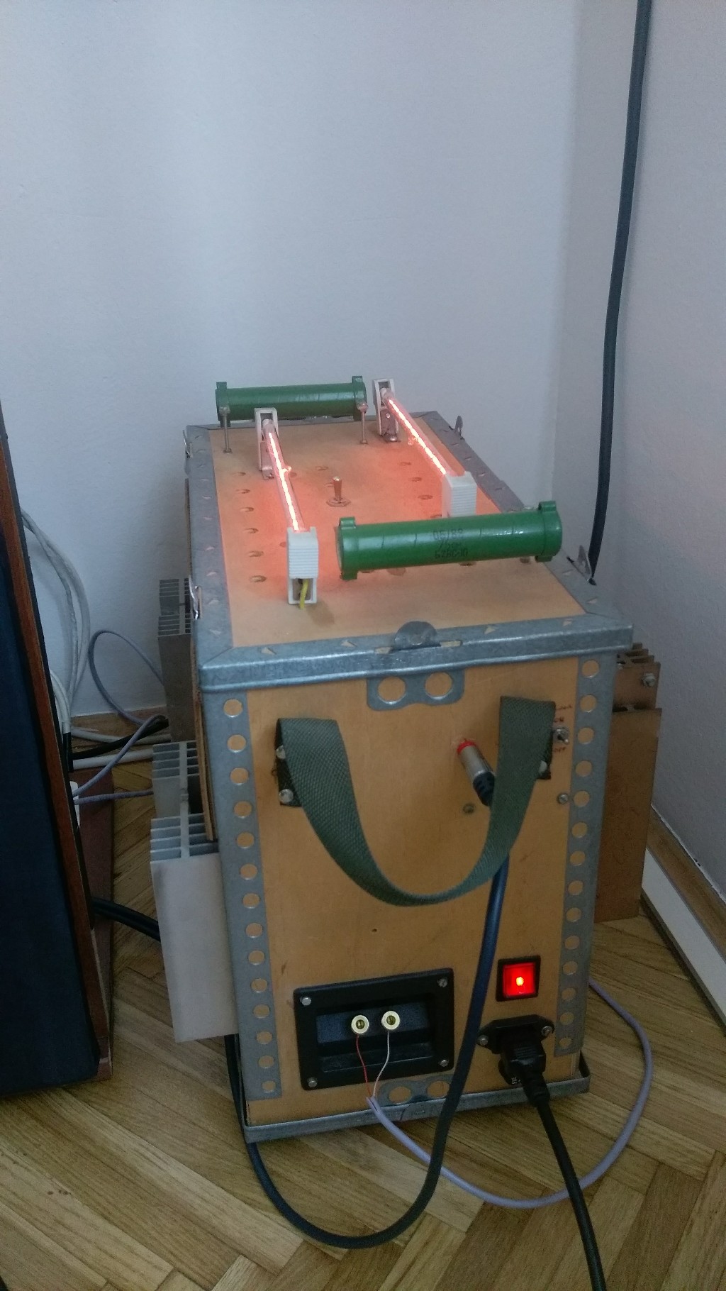

Yes I understand that it is a different Amp. With inductor is better. But I have the bulbs for 1€ each already at home. Will it sound really different? Less bass?
with choke - rails can be lower and swing is almost double rails, due to inductive charge,spoken in peasant way
for bulb instead of choke , you need to increase rails , for amount wasted on bulb resistance , and possible swing is then determined by rail
As I need 1w I don't care about efficiency and max swing.
I build it and drive it directly from DAC 2vpp
No preamp. Volume is sufficient
Do i gain in sound quality if I move from bulb to inductor?
And going from 1A bias to 2A?

Have you built it yet or will build it? It’s not clear from how you describe it in present tense. If the volume is good enough and you are happy with the sound that’s all that matters. If driving a tweeter you don’t need much of an inductor, maybe 20mH tops. It will increase headroom, so for same swing the amp is not working as hard, and distortion goes down.

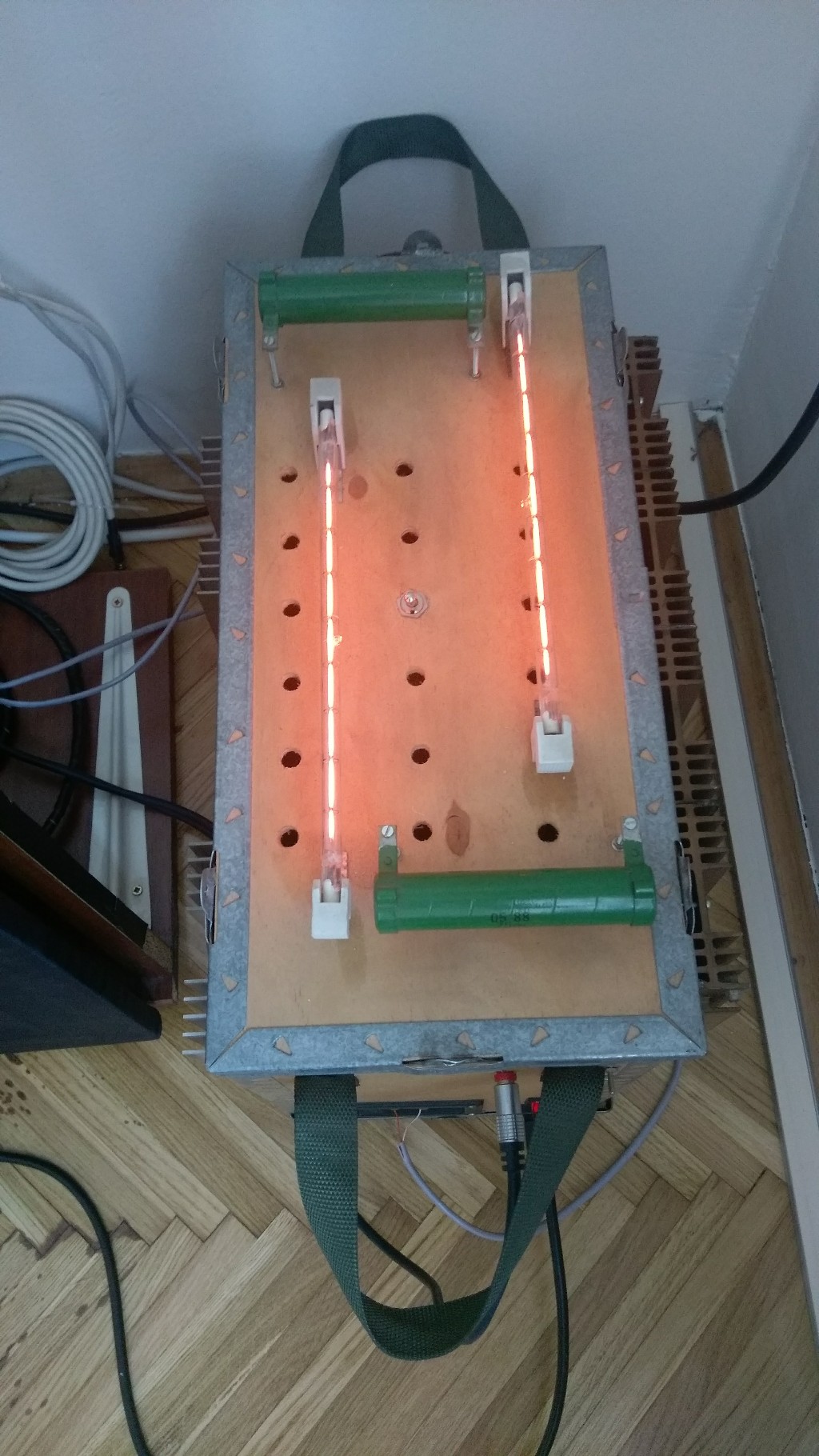

I build a prototype with 19v psu 0.8A bias and 1000w lamp. Volume was OK, sound still to evaluate.
For the compression tweeters starting at 600hz I plan to use 2.5mH air core is this enath?
For bass 1.6A 2000w bulb as I don't have any 50mH choke. In any case my swing can't go over the 2Vpp of the DAC as I don't use preamp

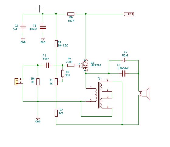

I was greatly inspired by Michael Rothacher’s MoFo. I like its simplicity and the fact that you can get almost the double voltage swing, dude to the inductor at the output, I also liked the fact that he was using laptop power supplies, wish makes the build much simpler.
Now I don’t have a pre amplifier that can drive it, since it requires a large input signal, so I had to think in alternatives. I did manage to redesign it to get some voltages of about 16 dB gain out of the circuit, with very small changes.
I build a mockup with the parts that I had in advance, just as a prove of concept and it dose work. Under the build I measured the transformers, and was surprised that the transformers that I had, works as a perfect inductor up to 12KHz (not bad for a 350VA 50Hz transformer). I only use the secondary side of the transformers; the primer side is well isolated to avoid electric chocks.
Now I am driving the amp’s on 15V, so the power is limited, but I don’t want to invest in new supplies until the amp’s has proven their worth. It is to early for me to comment on how they sound, I need to spend more time listen to them and they have to compete with my Single ended triode amp’s based on 845 tubes.
Anyway, I posted this in the hope to inspire people to experiment with this circuit, and make some measurements… I do not have the proper equipment to do so.

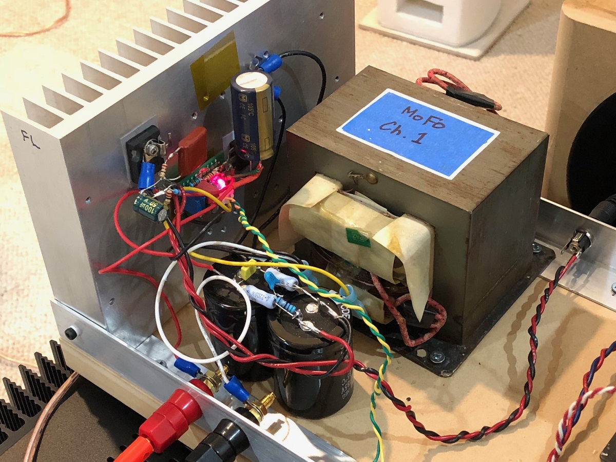

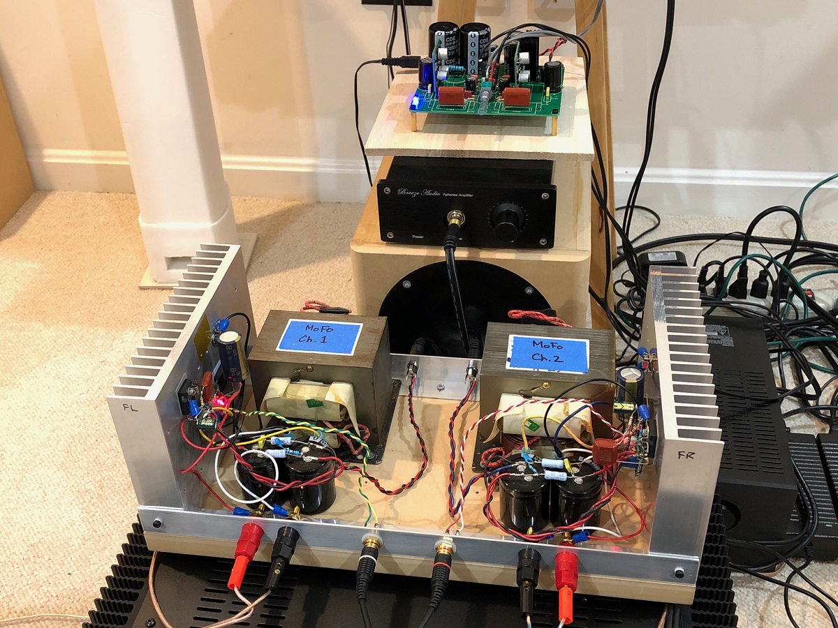

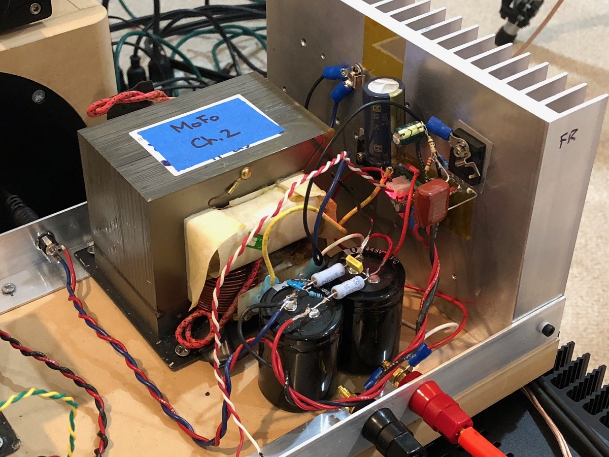

I finally finished the case work - always slow and tedious even if this is an "un-case" (no walls, just a baseplate). Both channels running at 1.7amps provided by a Juma's Easy Peasy cap multiplier which takes 24v from 5amp SMPS down to 19.5v and provides a soft-start for the 22mF//0.22R//22mF CRC before the amp. I am driving it with the Aksa Lender preamp at 22dB gain (can put out 40Vpp). Measured noise at speaker outputs is 0.1mV rms using Fluke 101. Ears pressed to the speaker cone, absolute silence. No hiss or hum. I did not do anything special with grounding and hoped for the best and luck was a lady tonight. The 2-way speakers are rather insensitive (true 82dB/2.83vrms at 50Hz) ScanSpeak 10F/8424 and Dayton RS225-8 FAST with transient perfect 1st order XO.

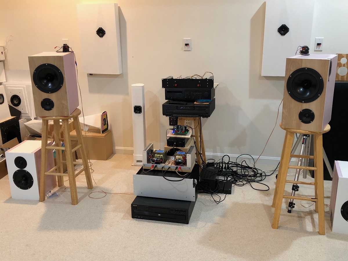

Here is the MoFo connected to my main speakers (the ones with the wood baffle on the stands) in the speaker lab:
Here is a closer view of the MoFo sitting on top of the Aleph J's case, with the Aksa-Lender preamp behind it:
Closeup of left channel:
Closeup of right channel (at 1.7amp bias the heatsink temperature is exactly 55C):
Well, how does it sound? Fantastic! Really surprised by the power I was able to get using the Aksa Lender preamp - the Fluke was measuring 8vrms on the loud passages and it sounded clean with nice articulation. Superb clear as a bell highs, and supple and smooth mids. The bass authority is really surprising the heck out of me. The 8in RS225-8 aluminum cone woofers are really dishing out the kick drums well. But what is special is that I have never connected a zero global feedback amp to these FAST speakers before. The phase coherence is incredible and the imaging and soundstage depth and width has never been better. On live ambient recordings, the realism is very very good. Transients like guitar, rimshots, clapping, bells all work well together with a transient perfect speaker and a zero global feedback amp. I am quite pleased how well this all worked out - the match with these speakers is excellent. Thanks to Hugh Dean's preamp design (which I had the MoFo in mind as the use case when designing and building), JPS64 for the preamp layout, and thanks to Michael Rothatcher for a superbly simple yet brilliant sounding amp. Bang for the buck is through the roof. 😀
