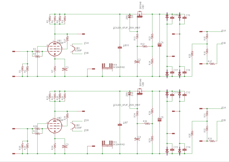

After the good result obtain with EF180 instead of 6072A in Power Follower I am using now a new driver for the Inpol / Mofo using the 6Z51P.
The 6Z51P is near to the D3a and it is tested on the article of Bartola about russian pentode.
I will update you on result.

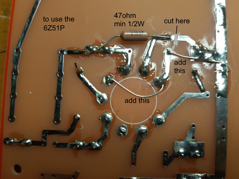

The sound is very good with the 6Z51P but remember to change the pins on socket because are different from D3a and EF180
I have use 290V, 4x39K 2W on anode and 100ohm on cathode with 470uF
I can share pcb files and the complete components list

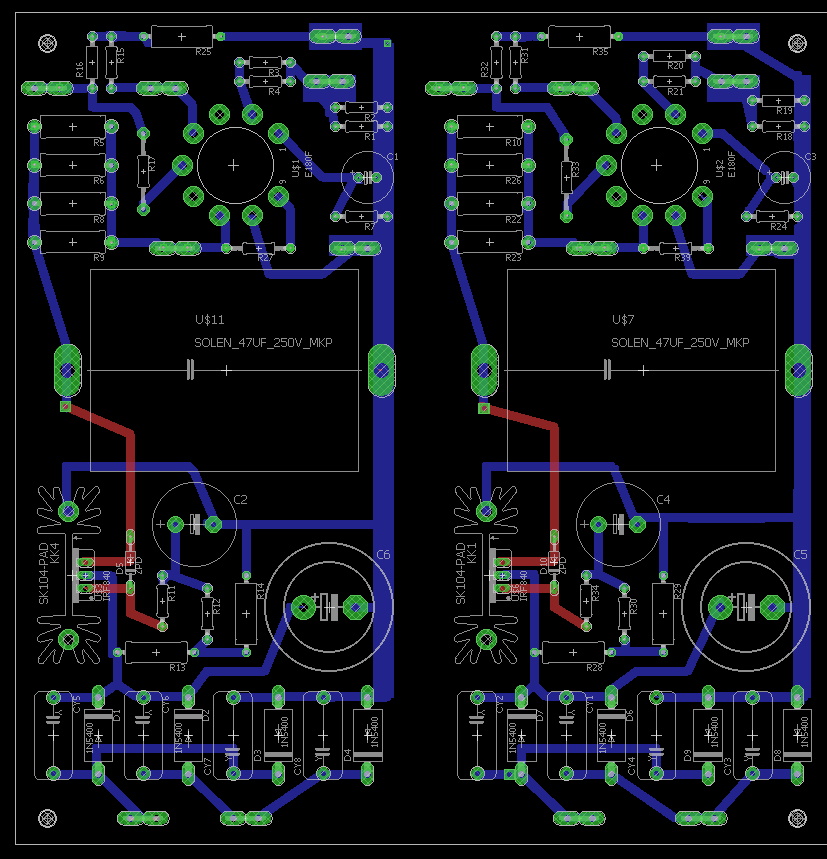

Here the pcb, some little modifications are necessary to use the 6Z51P instead of D3a / E180F
Would be awesome if you could share the component values also.
Current amplifier stage
R1,R2,R4,R5 1800ohm 1/4W 1%
R3 10Kohm 2W
R6,R7 220K 1/4W 1%
R9,R11 0.22ohm 5W Mills RMA5
C1 4700uF 16V Nichicon model UKA1C472MHD
U$1 0.68uF 400V Clarity Cap CMR or other audio grade MKP
R8 10Kohm multi turn
Q1,Q2 IRFP240PBF (it would be desirable to make a selection based on current)
D1,D2 zener 15V 1W
D3 zener 10V 1W
F1 fuse 10A FAST with fuse holder Mouser 534-4628
Cout min. 10000uF 50V Nichicon KG Mouser
Isolators Bergquist SP400-0.007-00-104 RS RS541-0856
Voltage amplifier
R1,R2,R18,R19 22Kohm 1/2W 1%
R3,R4,R20,R21 2200ohm 1/4W 1%
R5,R6,R8,R9,
R10,R26,R22,R23 39Kohm 2W
R7,R24 100ohm 1/4W 1% https://www.mouser.it/ProductDetail/71-RN60D1000F-R
R37,R39 47ohm 1/4W 1%
R11,R34 4700ohm 1/4W 1%
R12,R30 2 x 100Kohm 1/4W 1% to have 200K
R13,R28 4700ohm 1/4W 1%
R14,R29 150Kohm 3W
R17,R33 3.3ohm 2W
R25,R35 0ohm
R15,R16,R31,R32 220ohm 1/4W 1%
C1.C3 220uF 6.3V
C2,C4 33uF 400V https://www.mouser.it/ProductDetail/647-UVY2G330MHD
C5,C6 100uF 400V https://www.mouser.it/ProductDetail/647-LGU2G101MELZ
CY1-CY8 10nF 440VAC https://www.mouser.it/ProductDetail/80-R474I210050A1K
D1,D2,D3,D4,D6,D7,D8,D9 UF5406 https://www.mouser.it/ProductDetail/625-UF5408-E3
D5,D10 zener 10V 1W https://www.mouser.it/ProductDetail/78-1N4740A-TAP
U$3,U$6 IRF840
U$11,U$7 33uF 400V Solen MKP
KK1,KK4 Extruded Style Heatsink for TO-220 Mouser: 532-513102B25
Isolator Bergquist SP400-0.007-00-54 RS 169-2177
Isolatos TO-220 nylon platstic Insulator hole size M3
