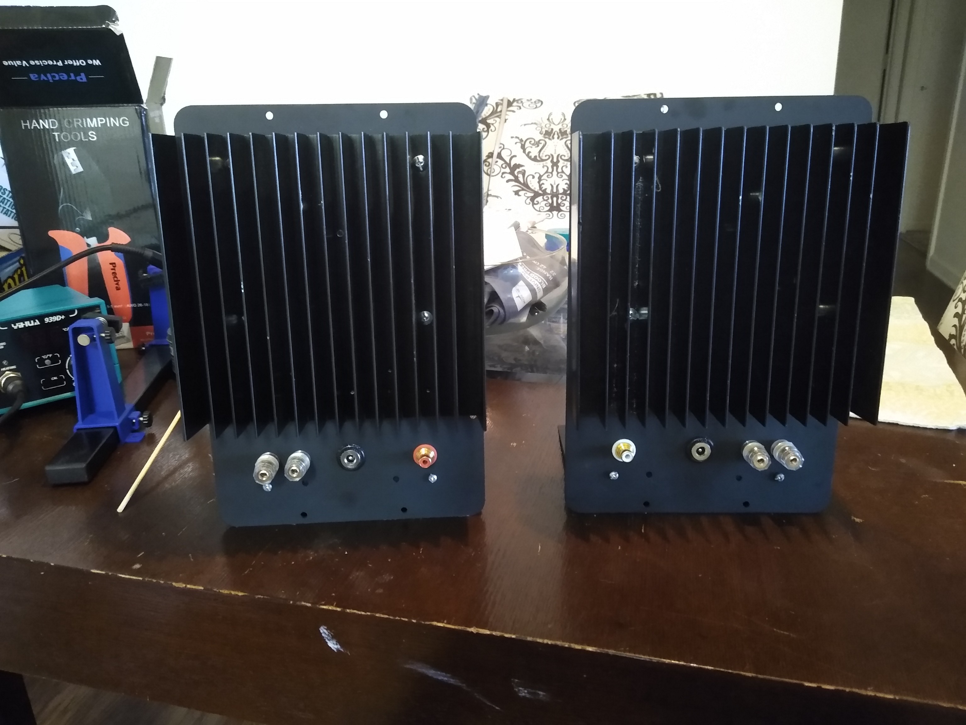

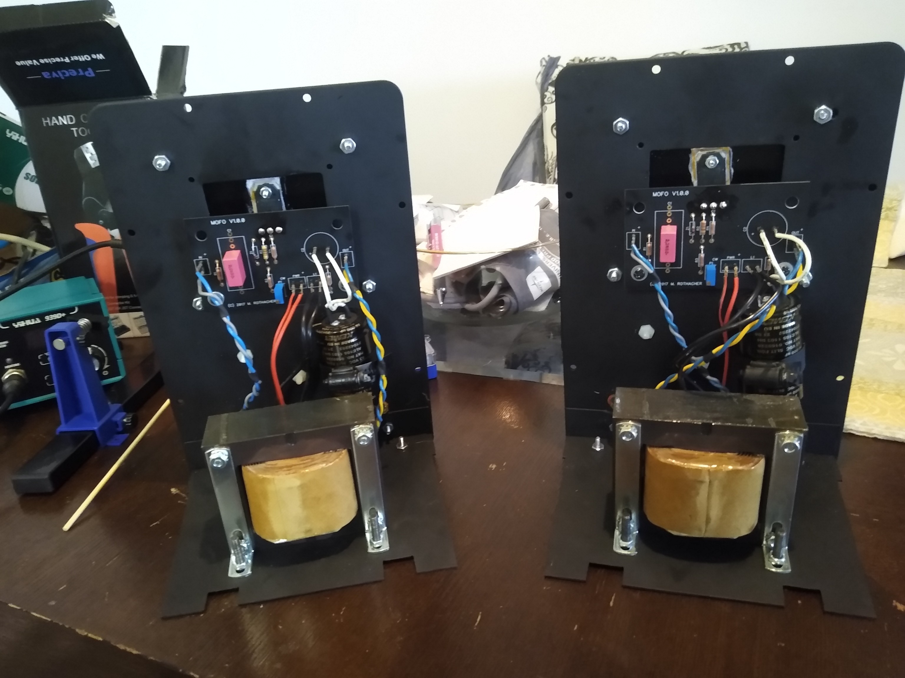

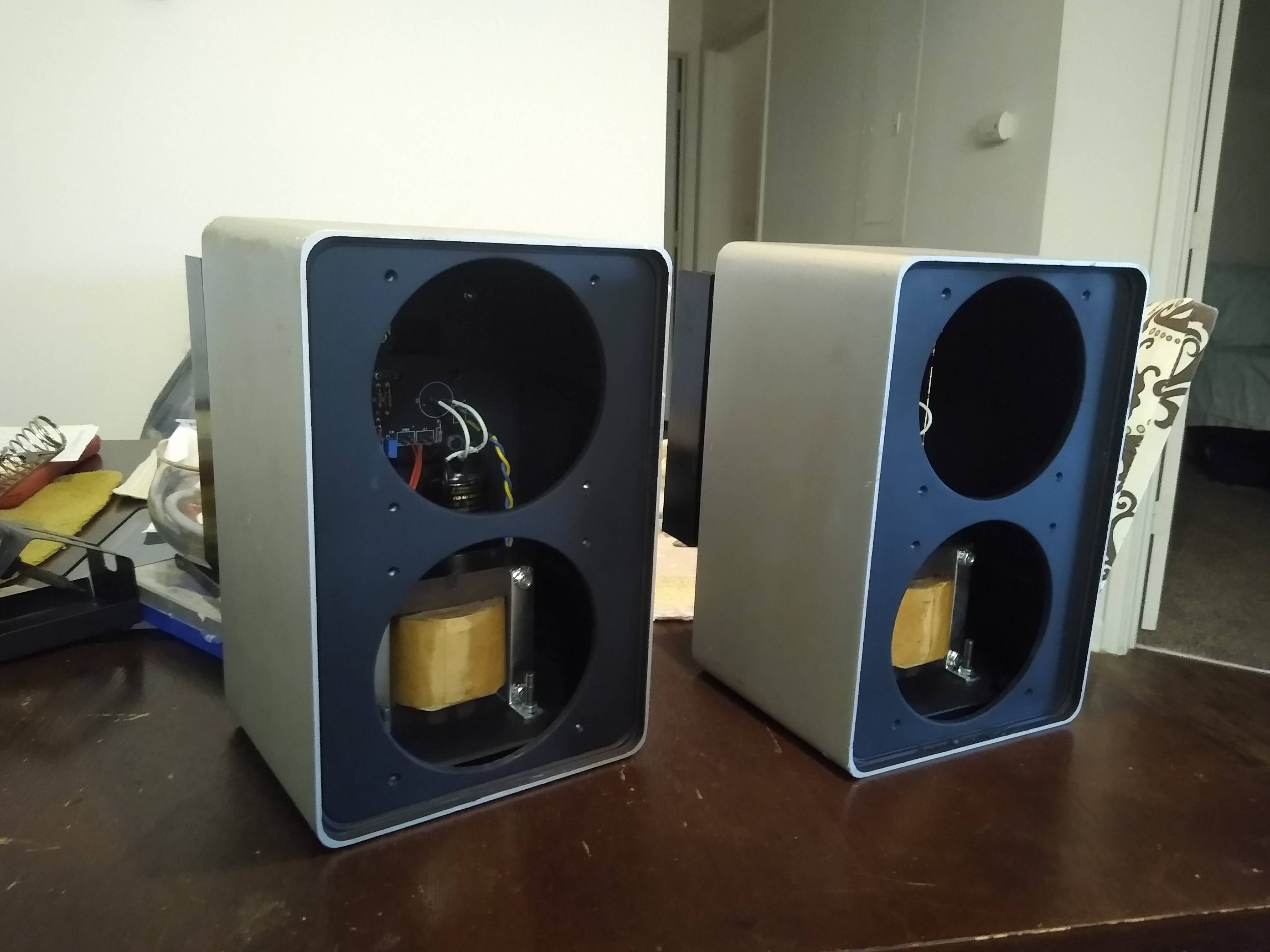

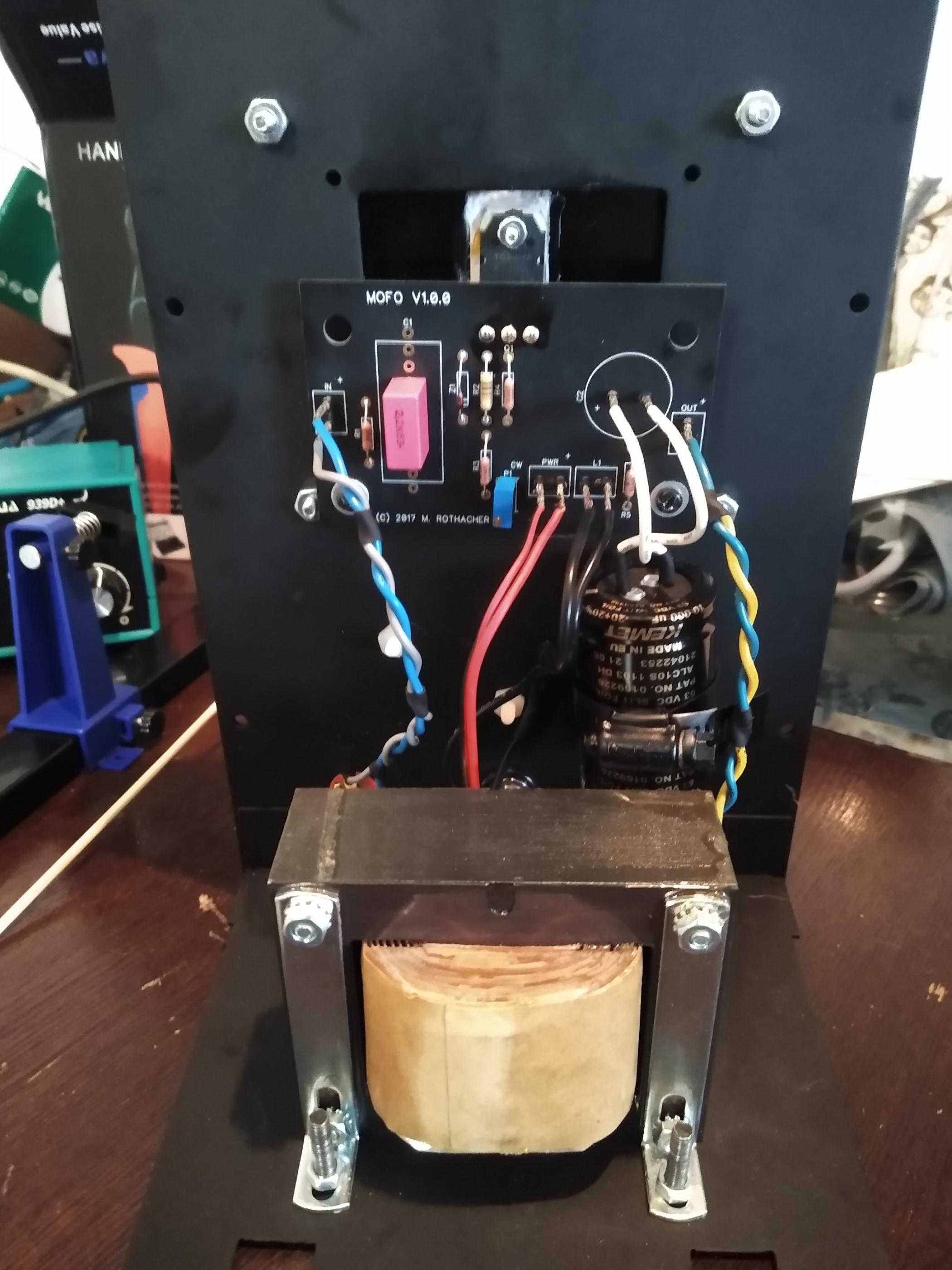

Finally joining this Mofo party. I reused a pair of Realistic Minimus 11 speakers as enclosures. Heat sinks are from a pair of Dell ADA995 subwoofers. I thought I was going to have to settle for 15V power supplies given the size of the heatsinks. But they seem to handle 1.8A at 19V just fine. I used Kemet ALC10S for the output caps. As you can see they were a little too big to fit on the Mofo boards. The chokes I used are from here 19C1 Power Choke . I measured a 0.5 ohm DCR and they don't list a current capacity. But given it's both physically larger and heavier than a Hammond 193T, I think it was a good buy. I went with the Toshiba TK7J90E fet for it's low COSS and CRSS. The datasheet doesn't list a transconductance figure though.
I actually finished these a week ago but was having trouble with my WBA2018 linestage so couldn't really listen to them. I fixed the linestage yesterday and after a listening sesh I'm very happy with my monoblocks. This is my first foray into class A, so don't have a lot of reference. But compared to my class AB or D amps, the Mofo has a fluidity that makes me want to just keep listening.
I've got a few more preamp builds in mind. I want to try some tube preamps next. Namely Salas' 6V6 preamp, Eric Barbour's Brute Force in a Linestage and an Aikido. Then maybe some SS preamps such as Salas' DCG3 and the Aksa Lender.

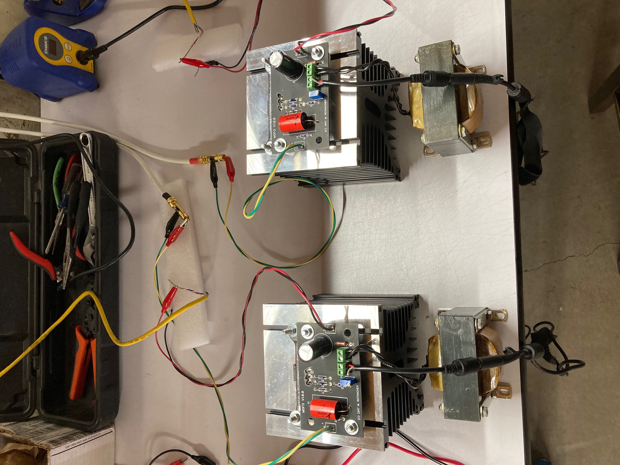

Thanks to thirdicomplex for the tip on the surplus 50mH chokes, I bought a pair myself and built up two monoblock MoFo's using Vgs matched Vishay IRFP240s (my IRFP250s have been on backorder over a month) and salvaged HP 19.5V (measured under load) laptop bricks for power.

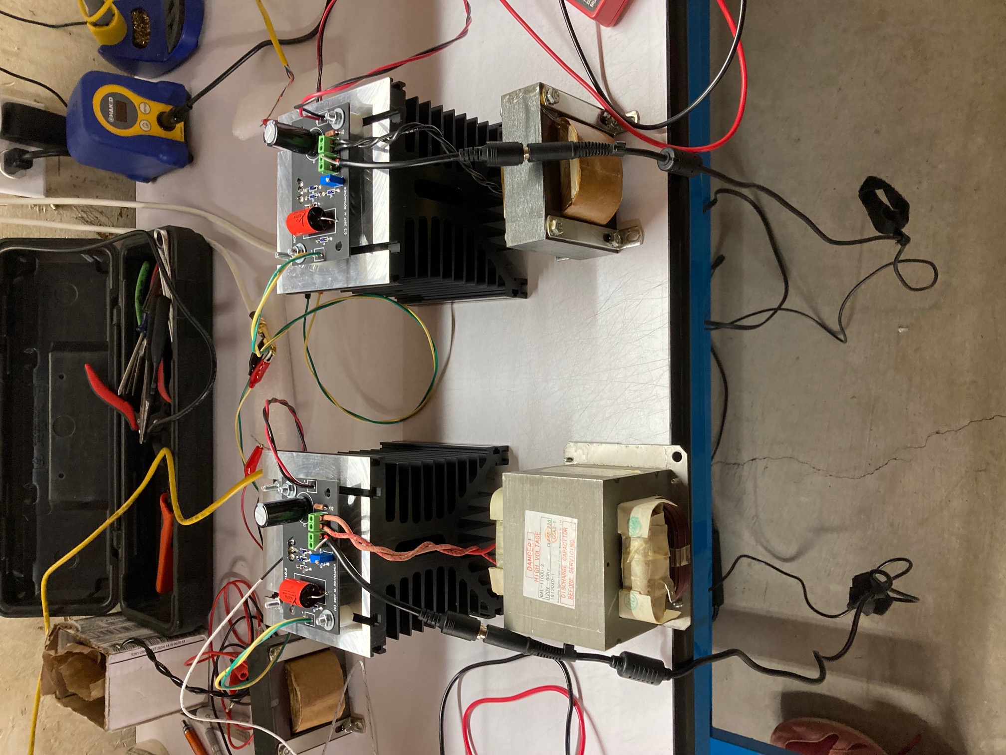

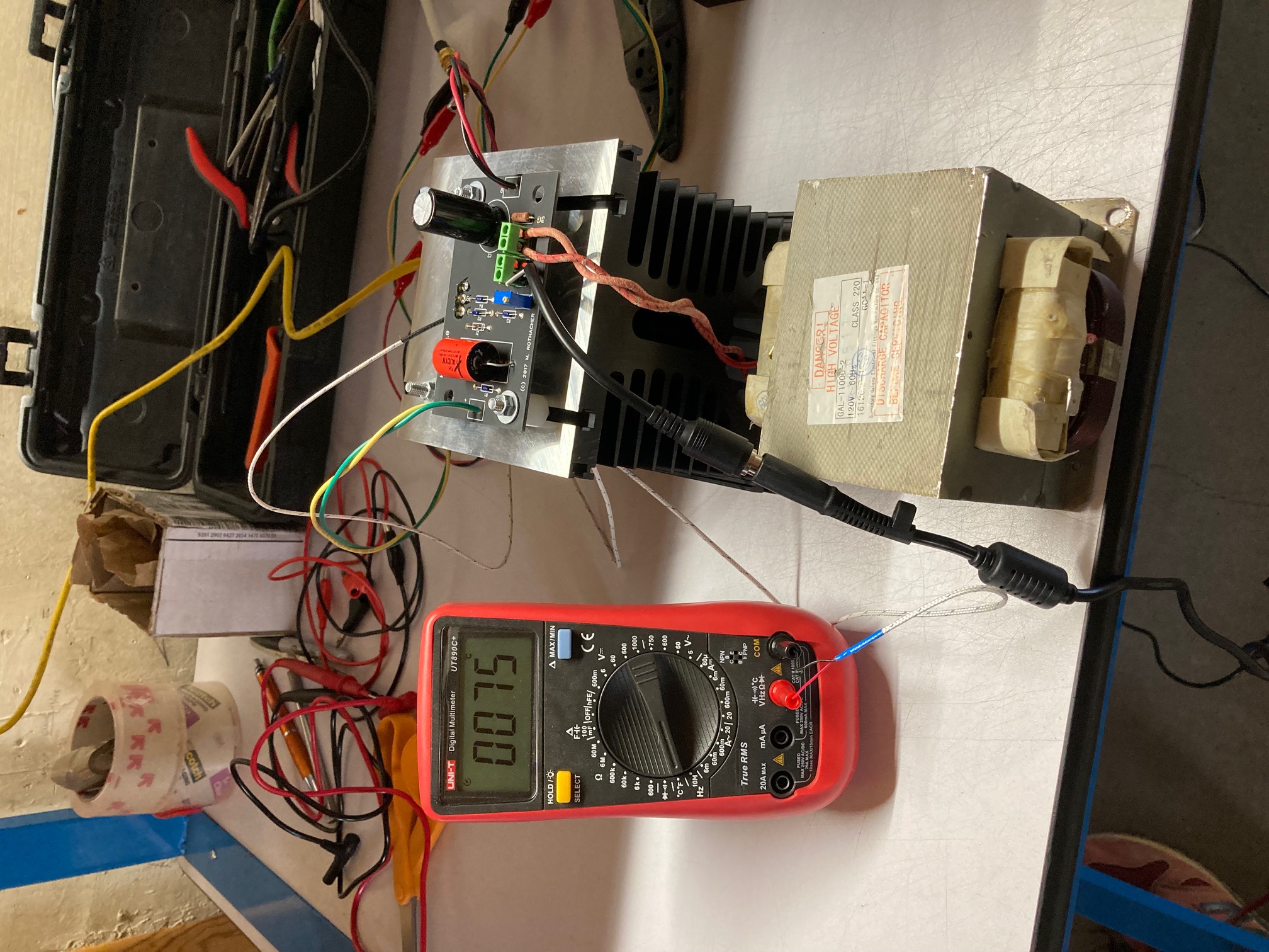

I was curious as to the effect of differing choke inductances on the sound. I have 3 different MOTs I wanted to compare to the 50mH "Nebraska" choke. Using a B1K as a preamp and some Klipsch bookshelf speakers as monitors, I swapped out the choke/MOT in the left channel and kept the Nebraska choke on the right channel and did some listening and measuring. I deliberately kept the pot setting on the swapped channel the same for each choke/MOT.
Device DCR Vdrop Icalc Temp
12mH MOT 0.7R 1.09V 1.56A 68C
50mH choke 0.6R 1.02V 1.7A 69C
89mH MOT 0.45R 0.98V 2.18A 73C
"89mH" MOT 0.4R 0.91V 2.27A 78C
The temps were measured with a thermocouple bead right up against the MOSFET. It's clear that currents much above 1.7A are hard on them.
I can't say I really heard a difference in the sound, though the big MOTs may have sounded a tiny bit louder. Of course this was an unblinded test so obviously biased. The relatively low voltage swing of my B1K preamp is probably hindering the potential of the MoFo.
