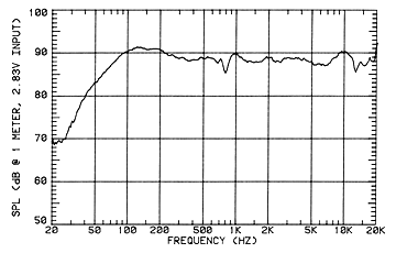

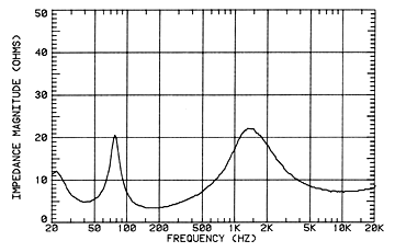

I have Paradigm S2 Signature Reference speakers which state Sensitivity: 88dB/2.83V/m Impedance: "compatible with 8 ohms." or combined resistance of 5.2 ohm?
Attaching the plots I see that 3.6 ohms is the lowest resistance seen at 180hz F#3/Gb3
What changes or considerations do I need for my speakers? DO I just treat them as 8 ohm speakers?
My final question is will 10A 24v power supply adequate for both channels?
I don't needs gobs of power but since I already have the power supply I figured I would use it. Someone mentioned that if I turn my PSU down to the minimum (22.5 vDC) and use a CapMx I can consider the 19V version?
Any insight or suggestions are appreciated.

Those look like 4 ohm speakers to me. To get better power delivery out of the amp into a 4R load, just push the bias a little higher, if you find it necessary.
Your 10A PSU will be fine for one or both channels.
Edit: See this link for some details: Bias Levels, PSU Voltage, and Speaker Impedance from PRR:

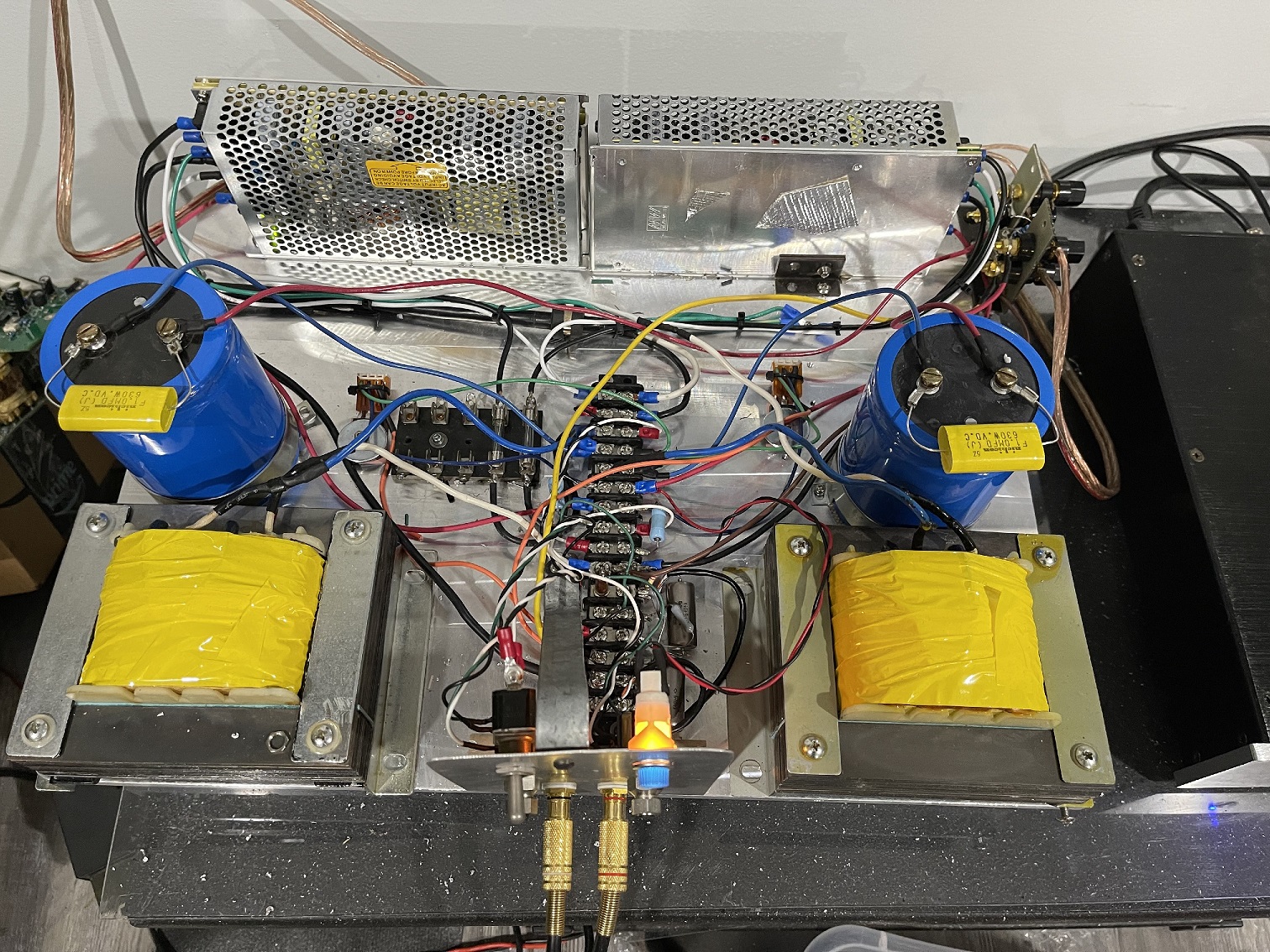

My Big MoFo ProTo-Type
Built a while ago, it has probably 100 hours on it. Next step is to put it in a proper enclosure. Parts are what I mostly had on hand.
I'm driving it with a Aikido pre-amp I've had for a long time. Speakers are Klipsch bookshelf models. It's a keeper.

I've noticed that the current across the chokes creeps up as the MoFo's heat sink gets hotter. This is counter intuitive to me as there's a plot of R(ds-on) vs. temperature for the Vishay IRFP240's and the slope is positive, so the drain to source resistance of the device should be going up as it heats up. Is the resistance of the choke getting lower? In fairness it does seem to plateau after an hour or so, but I'm curious what drives the plateau point, as I don't want these things running away from me if they're unattended.
When I turn them on the chokes are dropping about 0.97V and an hour later when I can no longer touch the sinks for more than a split second (call it 60C), they're pushing 1.04V. With my measured choke DCR of 0.6R, the current is going from ~1.6A to ~1.73A. I don't trust my DMM at this level, and these chokes are spec'd as 0.3R, so the current might actually be more like 3.2 to 3.46A. The bricks are rated to deliver 4.7A so this is possible.
The heatsinks, which are rated at 0.41degC/W, are getting too hot to touch so let's call that 60C, or ~40C above ambient. I don't think these things are burning 97W though, the heatsinks aren't properly ventilated sitting on my bench. I'm measuring a drain to source drop of 18.5V under these conditions, so the MOSFETS are burning somewhere between 32W to 64W, depending on which DCR you believe. Yes I know I should get a half-ohm power resistor and put it in series with the chokes to measure the current exactly, but I wanted to see how far I could get with things as they are. Thoughts? I tried dialing down the bias when they were hot before but it seems like a moving target.
I might be wrong, but I've understood that as chokes heat up, their resistance increases. This will likely drop more voltage, as you've noted. This might have the tendency to cause bias current to increase. 60c is getting pretty toasty.
In my MoFo amp, I have one sink for each channel and they are physically isolated from one another. Because of this, I mounted the mosfet directly to the sink using only some thermal paste and ran each channel at 60w dissipation. This makes things toasty, but still within my comfort zone. Images are in my signature link.
Hm! If that's the case then the current draw shouldn't be going up as the chokes heat, it just looks like it does from the pt of view of the increasing voltage drop across them?

All the popular metals have positive coefficient of resistance vs temperature.
We know this from PA speakers. After a loud set at 100 Watts average the voice coil resistance may double.
And of course it has been known far longer in precision measurement. Low-tempco alloys for wirewound resistors are a hundred years old.
Constantan - Wikipedia 1887
If your chokes get more than slightly warm, you can't read current better than a few percent. I believe most standard resistors are better, or can be cheaply OVER-sized to stay cool, so a 0.1 or 0.05Ω in series may be useful.
