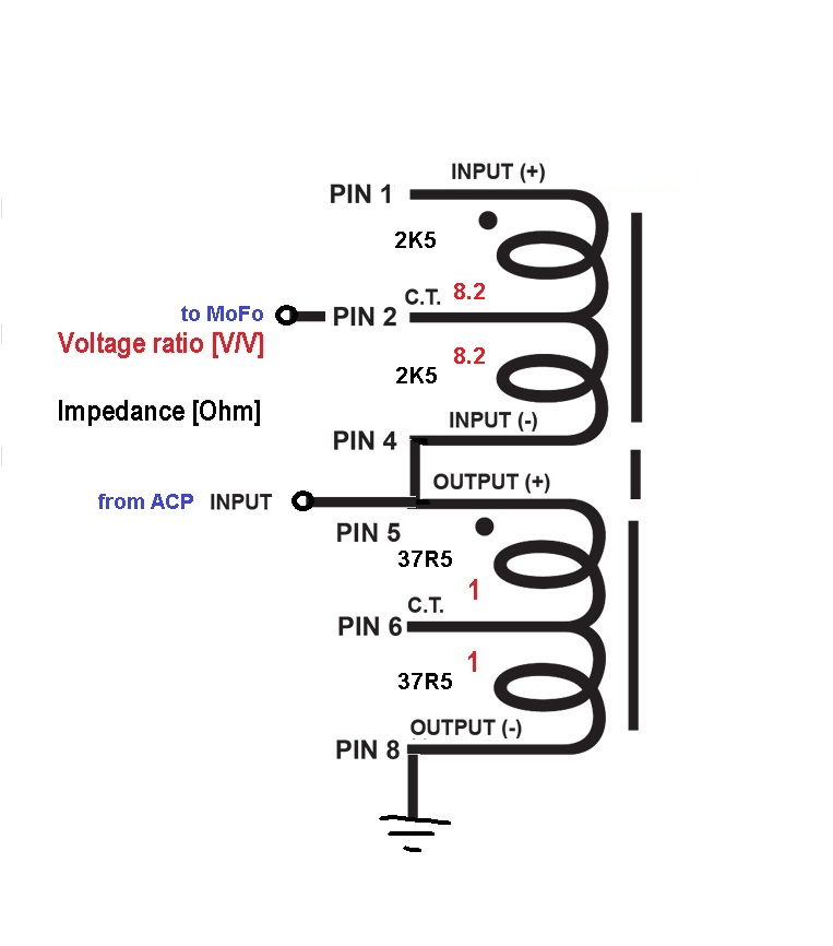

Upon further listening, the tone is off. It's missing a warm, full, lower mid-range. There's plenty of detail, and it sounds great for lighter, acoustic content. But anything rock - Dire Straits, Santana, Jethro Tull, Rolling Stones - it sounds somehow anemic, flat, no body or oomph.
I tinkered with the wiring on the Edcor without any luck. Using the full primary, which raises the DCR to 60, made a clear difference for the worse, which I believe is a function of the ACP+ being tuned for 30R. Taking the gain from 16x down to 8x didn't improve things.
A white noise test with my phone's RTA app didn't show anything wrong with the FR. Next chance I get, I'll try wiring the Edcor as an autoformer, as well as bringing the ratio down further.
Hi autox, I suggest that you take a look at Papa's Official M2 Schematic
The tranformer as shown in his schematic is wired as auto-transformer for 15dB of gain (all you need is the transformer and R5 and C1 for freq comp). Your ACP+ would easily drive it with MoFo as load.
ACP+ gain of 9dB + autoformer gain of 15dB = 24dB gain total.
With 1V source that's over 15V. About 28Wrms into 8ohms.
It's not the DCR that determines the transformers impedence, it's the turns ratio, output Z of amp driving it and input Z of the load...
I learned lots from ZM about this stuff and in particular autoformer ins and outs.

With the XSM10K:150 transformer, here's what I would try for auto-transformer wiring.
Since you chose a step-down transformer, notice the input goes in the output and the output goes in the input. Not ideal but may still work ok.
Luckily your ACP has less than 1 ohm output impedance.
By taking output from pin 2, you'd have a 2:8.2 + 2 (about 1:5) ratio, about 14 dB gain.
Compare from the HP out then the line out and see which one you prefer.

Cinco, thanks for the suggestions, especially the autoformer circuit.
Turns out my mid-range issue was a symptom of low bias current - I was only running ~1.5A.
I re-wired the Edcor as an autoformer but it didn't make much of a difference. It definitely sounds better using only half the input side, regardless of the rest of the wiring.
I considered buying the M2X kit for the front end boards, but I think I'm going to take a crack at figuring out the Mini MoFo. The ACP+ with the xformer works fine, but this isn't my final system. I'm building an LX Mini with the Analog Crossover Network, and that wants a minimum 10K load.

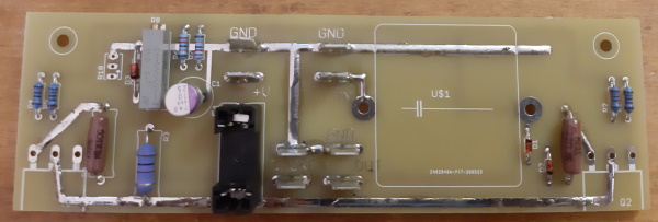

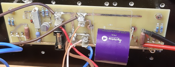

pcb in testing phase

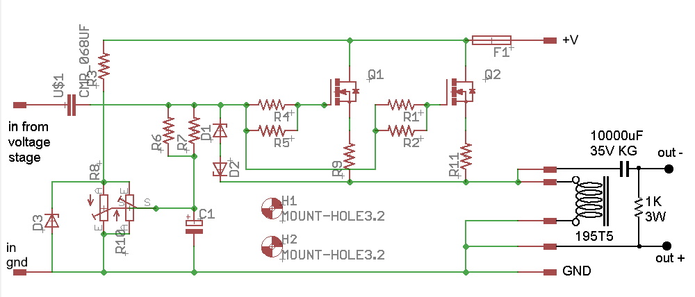

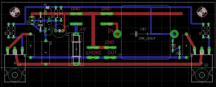

Here the pcb for the output stage.
In rome it's high summer so it's not the right time to try class a amplifiers but having some time I couldn't resist the temptation to go on with this project.
Actually the resistances on gate are 2 x 1800ohm in parallel so 900ohm for each mosfet and I have a frequency band more than 300KHz (-3dB) with 2 x FQH44N10-F133.
Bias point set 30V 4A.
