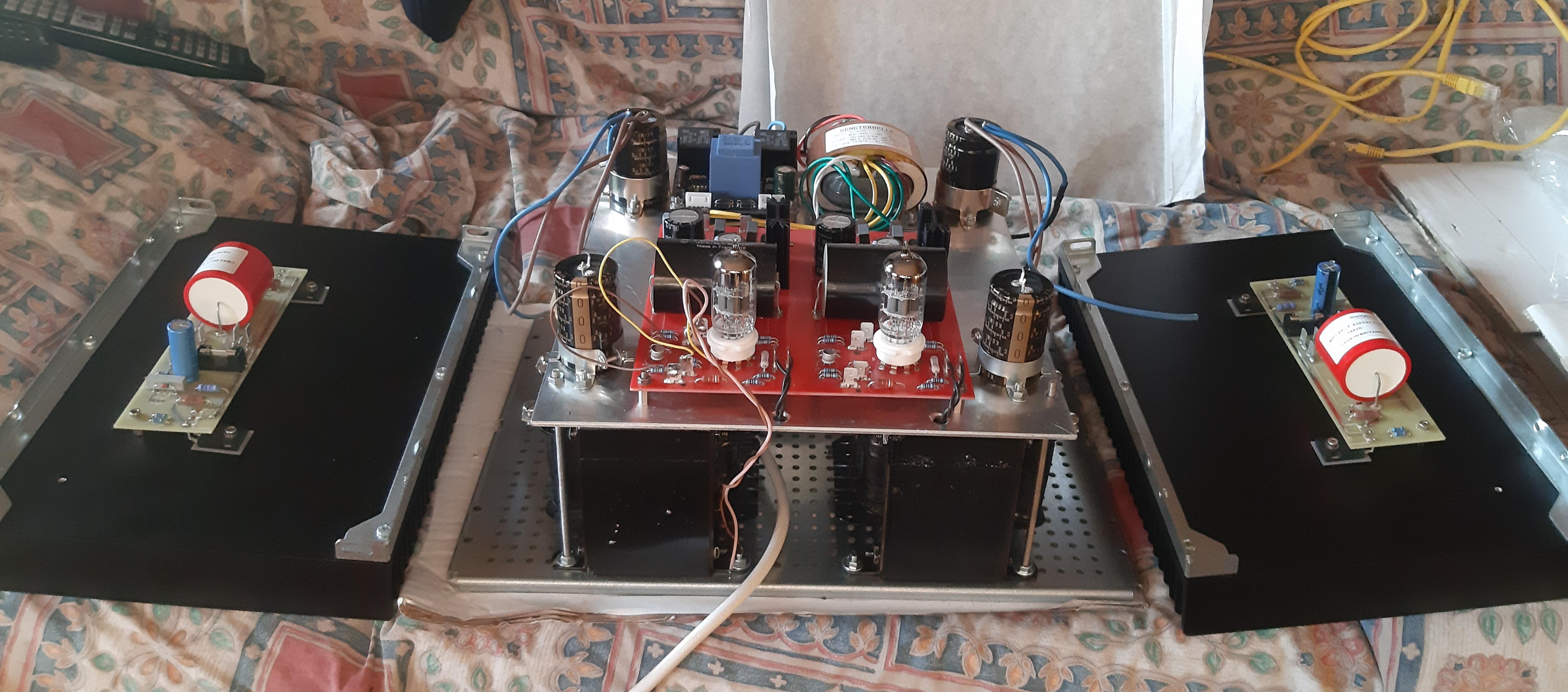

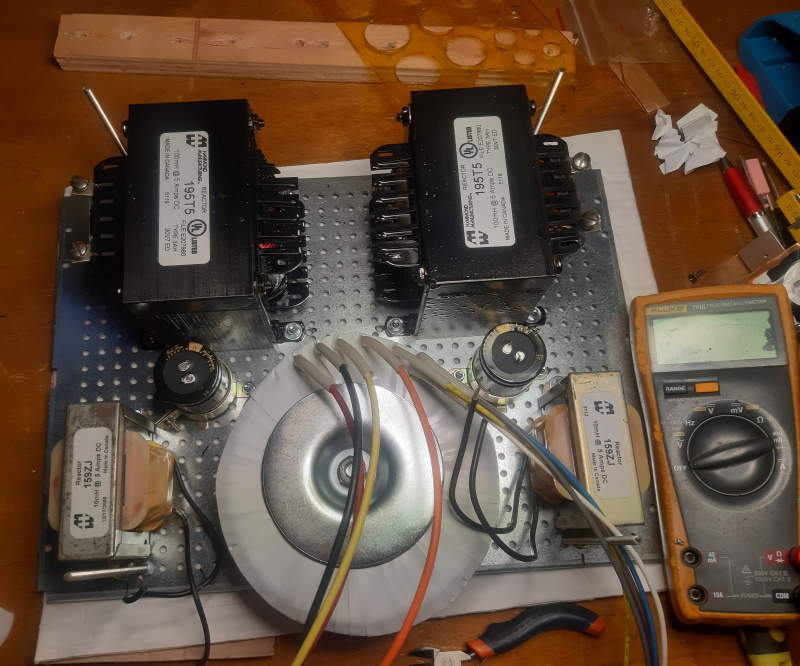

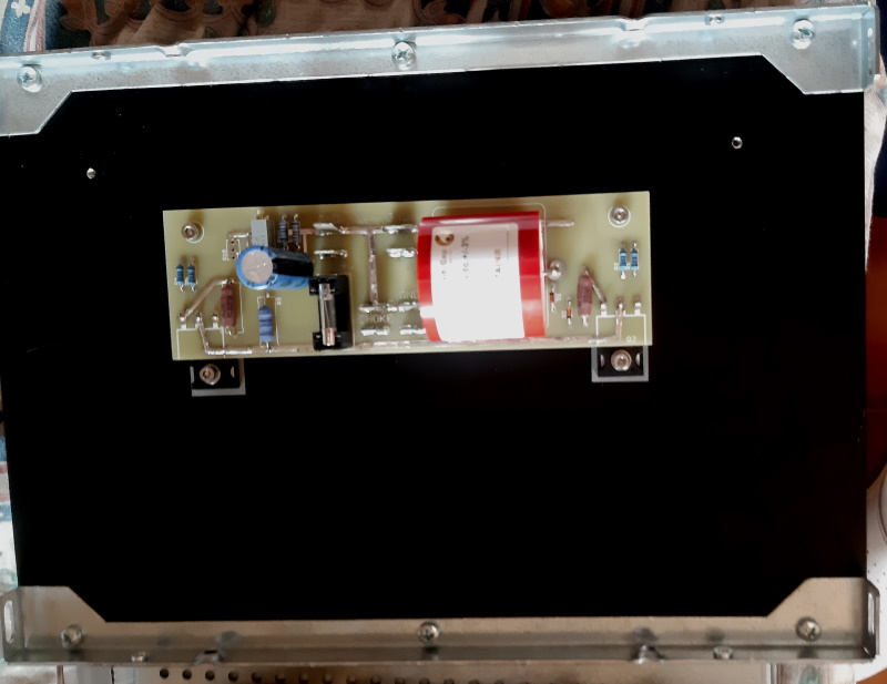

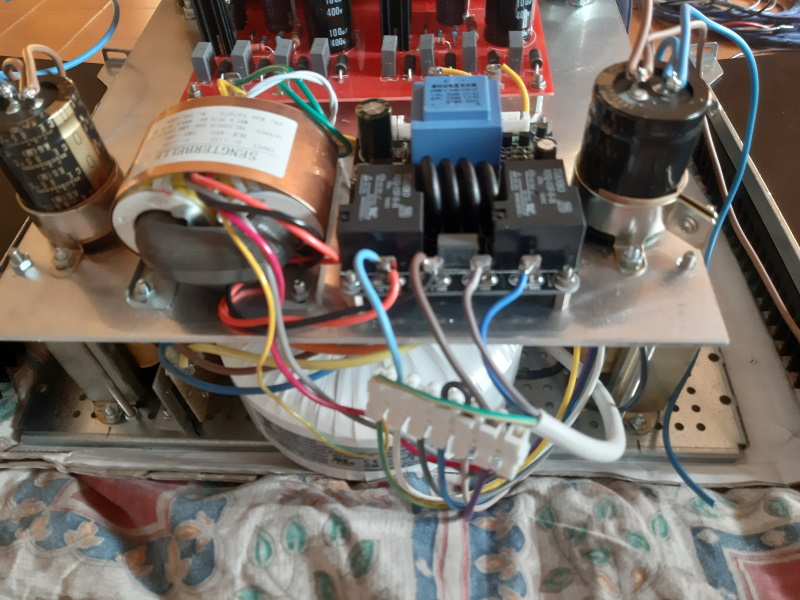

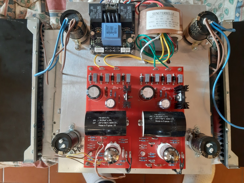

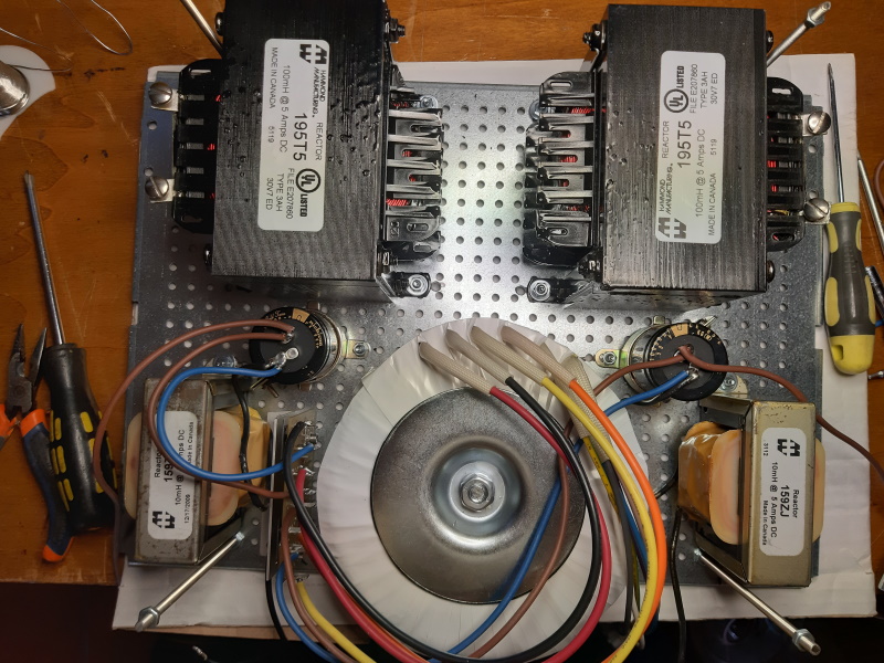

Mofo/Inpol with 195T5
Here the first photos of my Mofo/Inpol with 195T5
