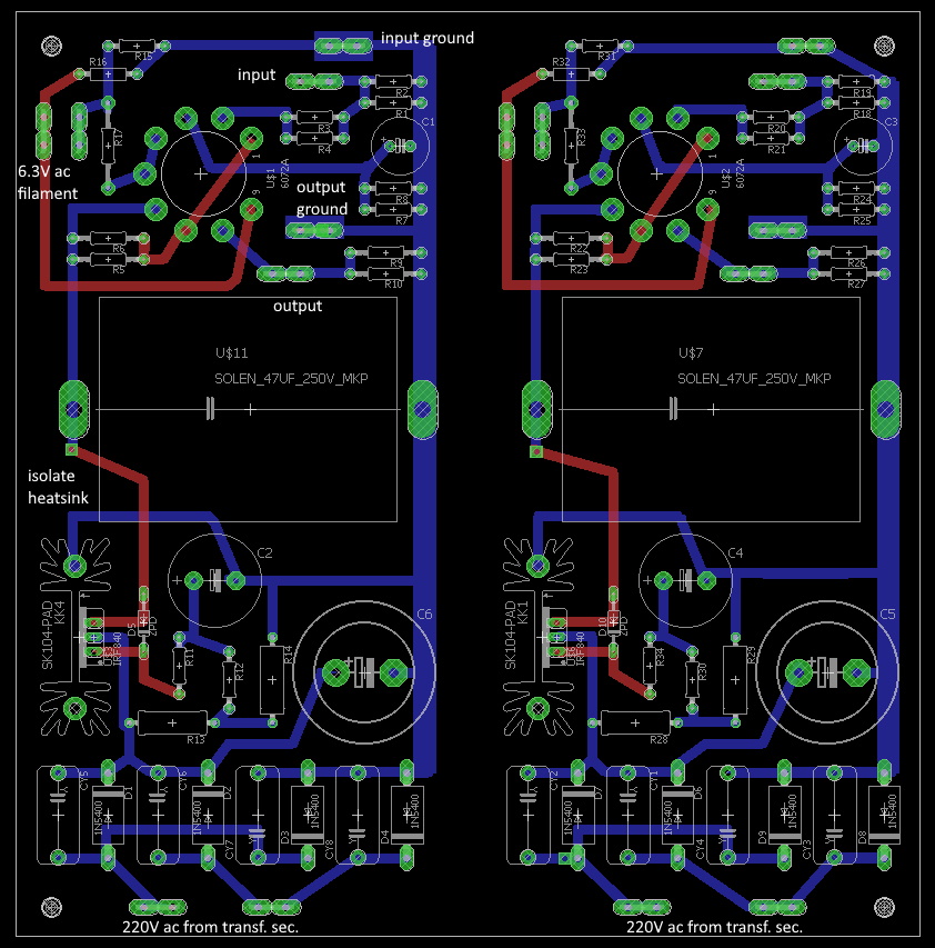

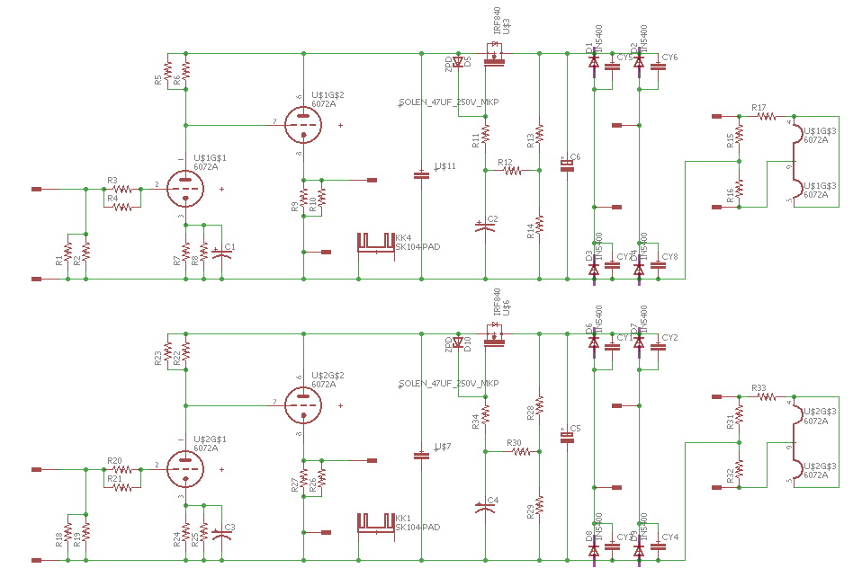

my simple voltage stage

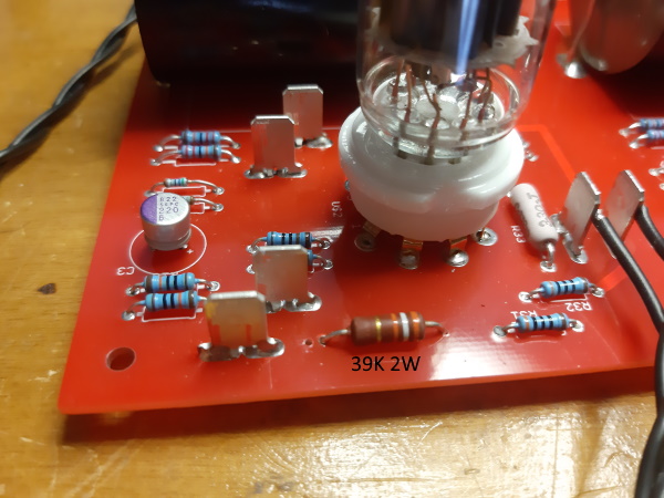

This is the complete schematic of the my voltage amplifier used also in the PF2019 including the power supply section allocated in the same pcb.
Mount the resistances in parallel configuration in opposite phase / direction.

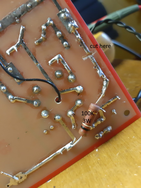

The heat sinks have been grounded to avoid receiving radio frequency so these must be isolated from the transistor.
In order to keep the Vkf under the max value it is necessary add 4 resistors 2 x 100K 2W and 2 x 39K 1W (6072A) or 2 x 47K 1W (12AX7), see photos.

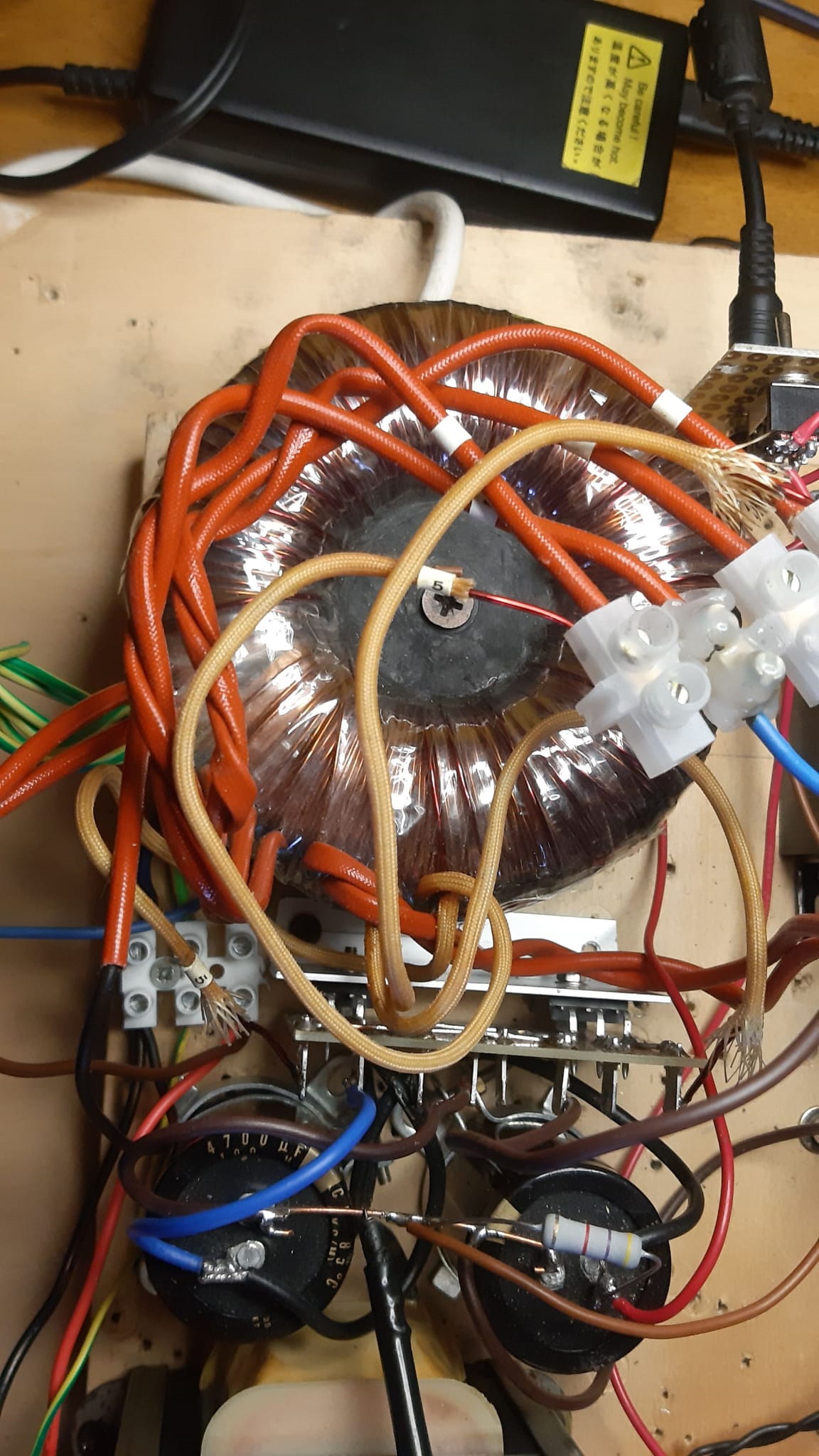

Yesterday evening a direct comparison between a power supply created with:
- toroidal transformer about 12.5V-0-12.5V
- diode IXYS DSA70C200HB Soft Recovery Schottky 200V 2 x 35A
- 10000uF 50V Nichicon KG
- Hammond 159ZJ
and a HP 19.V 160W SMPS
The first problem is that it is not possible to use large capacitors at the output of the SMPS because this goes into short circuit protection so an SMPS should be created with this protection disabled.
So I have used only a 470uF 63V Nichicon Muse on the mosfet module.
In a direct comparison the timbre of the sound is identical but there is a greater naturalness and a better bass frequency in the version with traditional power supply (my friend speak about a + 5%) therefore in a system that accepts limits an SMPS can be used.

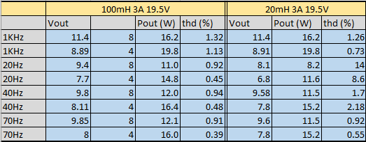

yes, a 0.1ohm 5W is enough to use the my HP SMPS with 10000uF.
Here some data to compare a 100mH to 20mH so if you are not interested to a full range amp. from 70Hz also a 159ZE with 28mH 3A will be perfect.
Vin = 319mVrms for the 8ohm
Vin = 254mVrms for the 4ohm

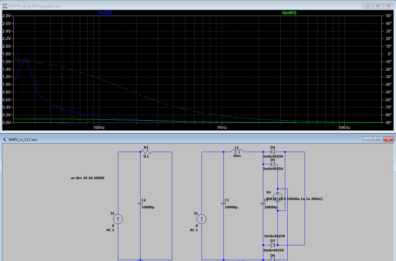

Here a fast simulation of the output impedanze of these power supply.
CLC give 0.5ohm at 40Hz and should be add the transf. secondary impedance
in both cases should be add the impedance of the output cap and mosfet.

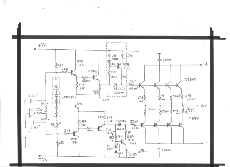

one query , little off topic,
Can we have a "class AB or class B power buffer (with less heat and more efficiency)" like we have "class A power buffer".
didn't found any examples for power buffers other than class A.
yes
for example this design HP-REN-OS - Solid state Hi-end current amplifier by Bartolomeo Aloia with an innovative circuit to avoid the switching off of the transistors (here the simplified schematic)
but this is another thread so we shouldn't talk about it here

yes, the output voltage of both power supply SMPS and CLC are very similar 19V and 19.5V DC because the 200VA toroidal have more than nominal 12.5VAC with 3A bias.
In any case the semplified simulation show the limit of CLC on low frequency with 0.5ohm at 40Hz is obvious to hear a difference with 4ohm speakers.
The output capacitor will increase in both cases the output impedance on low frequency.
