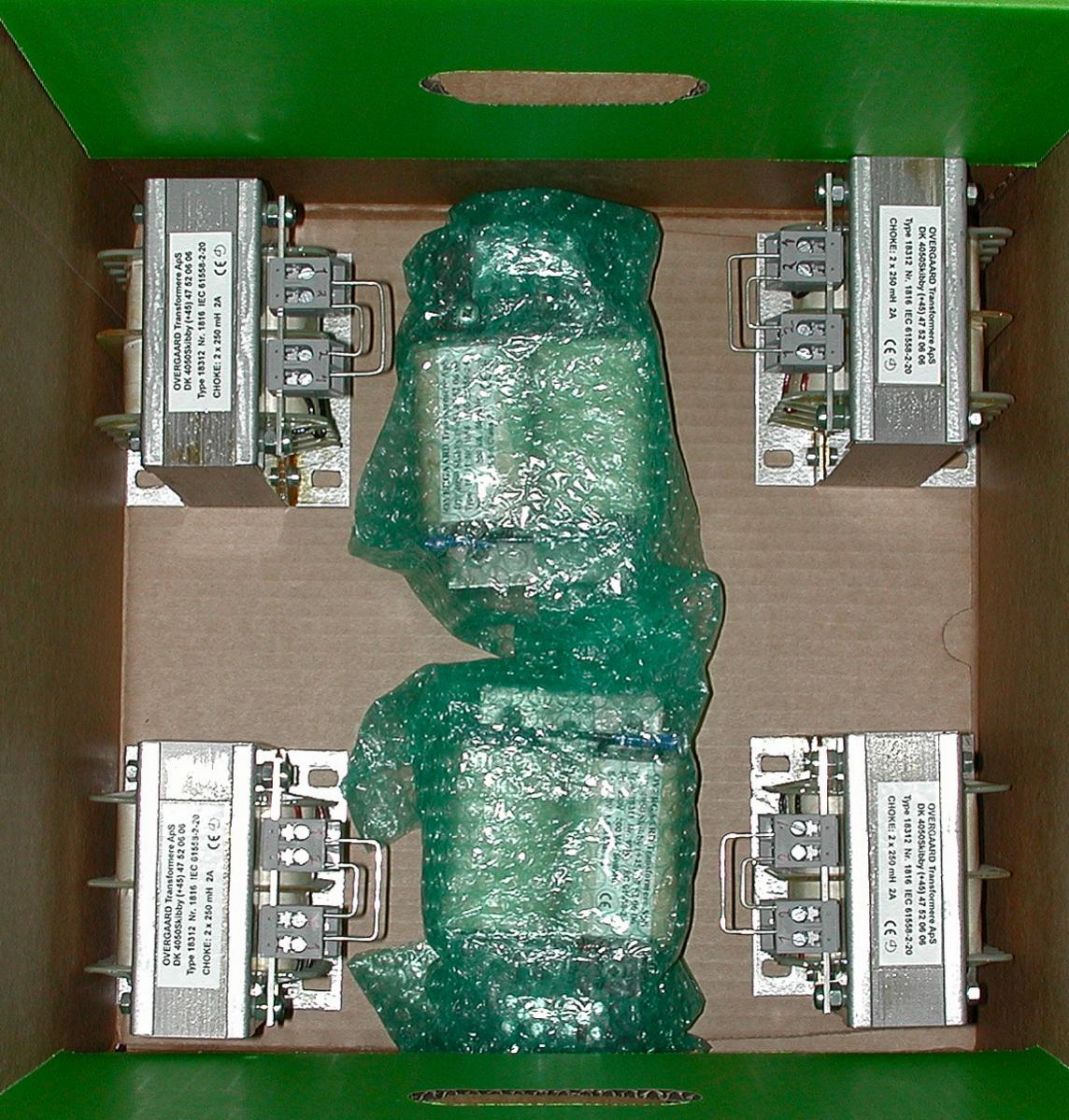

You could use it in a CLC supply for this 50w Single-Ended BAF2015 Schade Enabled or the SIT variation.
Yes, for a low loss high current filter choke they could be used (up to 28A as far as I remember).
I also disassembled the PSU for the MoFo's and the filter chokes used are more appropriate for such use I think. They are dual chokes (on same core) so I can couple them serial or parallel depending if I want up to 2 or 4 A current.
It may be good to have some iron on the shelf 🙂
