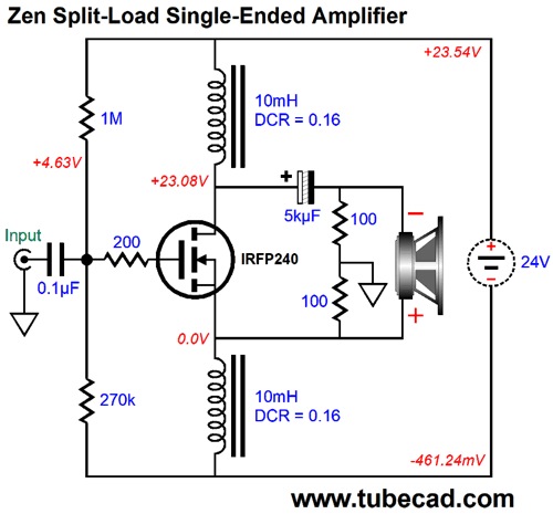

what about putting one inductor on the drain and another on the source of the mosfet?
output taken at source and drain of mosfet
if the 2 coils are bifilar wound on the same core, the opposite DC current cancel the flux
It is done on LAPS SLAPS for SLAM!
This circuit is not a follower because there is voltage amplification factor and the non linearity of mosfet are compensated by a feedback.
The low value of the choke is not compatble for a full range amplifier infact at low fequency the distortion is very high.
Coils could be 2 secondaries of psu transformer since the DC current Flux are canceling?
The coils are in series so the DC current Flux does not cancel. It will add.
You don't need to couple the coils, but there is free feed forward error correction to be had by coupling them tightly, so I can't imagine why one would not want that.
The feedback is more of a feed forward error correction. Not very different from Nelson Pass SuperSymmetry.
His bifilar coil only had a few mH of inductance which is not enough for a good bass response.

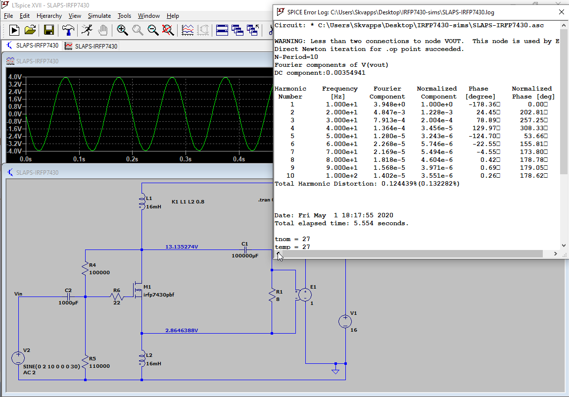

With 16 mH in each winding you get a very nice low distortion even at 10 Hz as in the simulation below.
2 x 100 meter of pvc-coated coupling wire was not enough in a aircore bifilar coil. Once he rewinded them on a steel core the distortion got back down to reasonable levels.
Once he got the coils up to 21 mH then he wrote this:
There was no significant difference between the SPL nor distortion from 20 Hz to 1000 Hz comparing the Trimodal with SLAPS

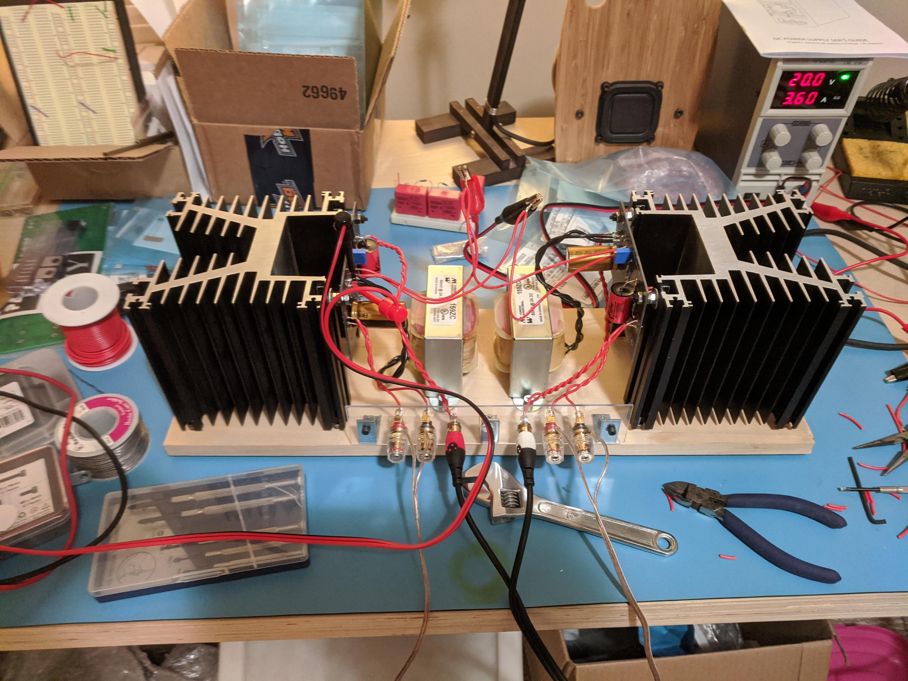

And a question. While I was adjusting the bias, the current on my bench supply didn't match the expected voltage across the chokes. My chokes measured 0.9 ohms, aiming for 1.7A - that works out to 1.53V. When my supply was reading 1.7A, I was only seeing 1.2V. When I dialed it up to 1.5V the supply was showed 2A.
To calibrate things, I have a 0.5 ohm, 50W resistor, which my DMM measures accurately both hot and cold. Ramping up through 5V across it, my supply reads ~10% below expected current. That doesn't explain getting a higher than expected current in to the MoFo.
I measured the chokes (Hammond 159ZC) before soldering, and gave them a minute or so to settle.
My sinks can handle the extra heat, but I don't want to overload my power brick.
Any ideas what might be going on here?
Fresh batteries - brilliant!
Now the chokes measure right at their spec'd 0.7 ohm, and, accounting for my supply's measured current error, the voltage is dead on.
I tried with a series resistor, but all I have is this 0.5 ohm which made too big of a dent in the numbers.
Thanks for the help, and thanks for the Mofo!!
