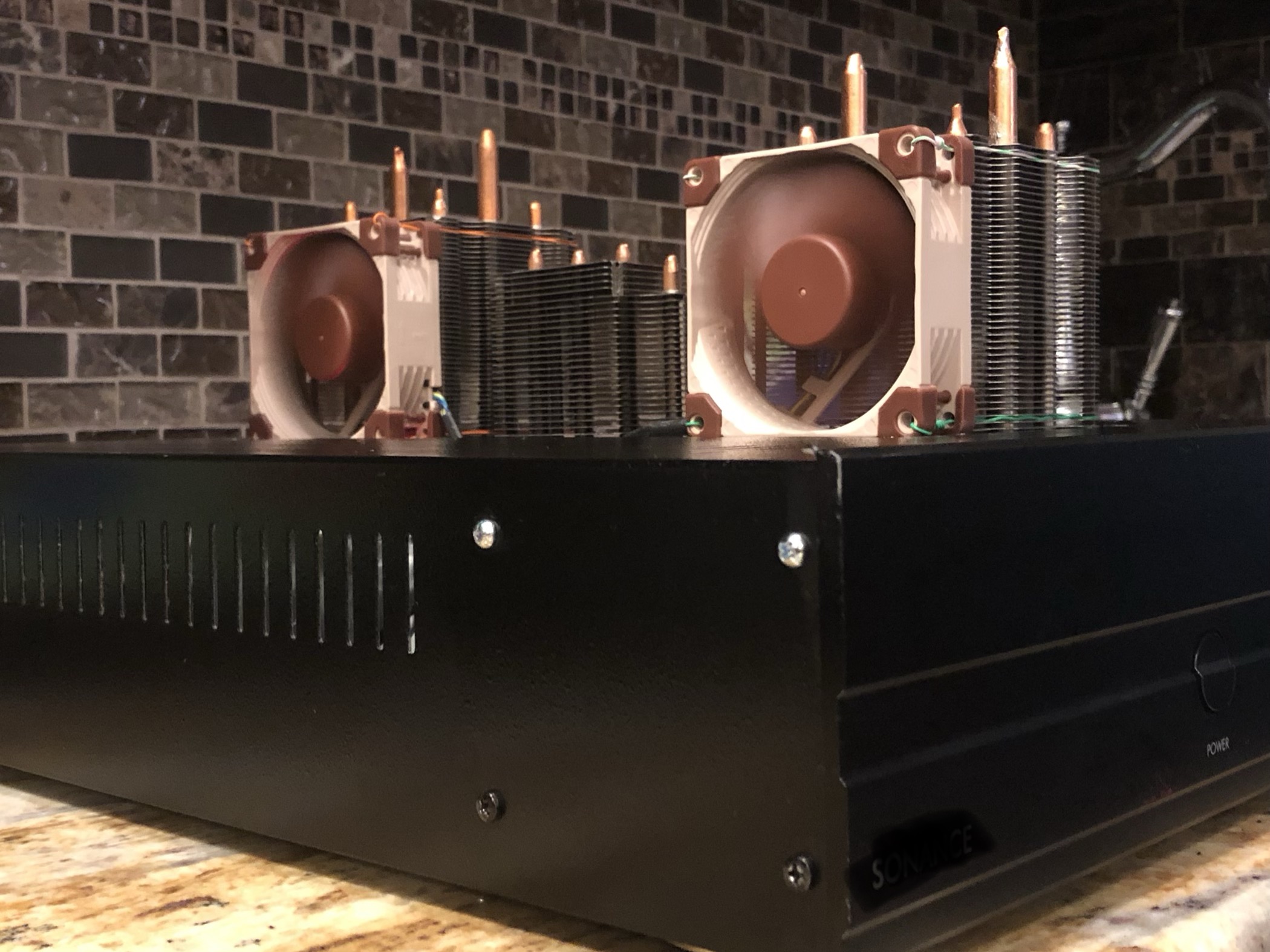

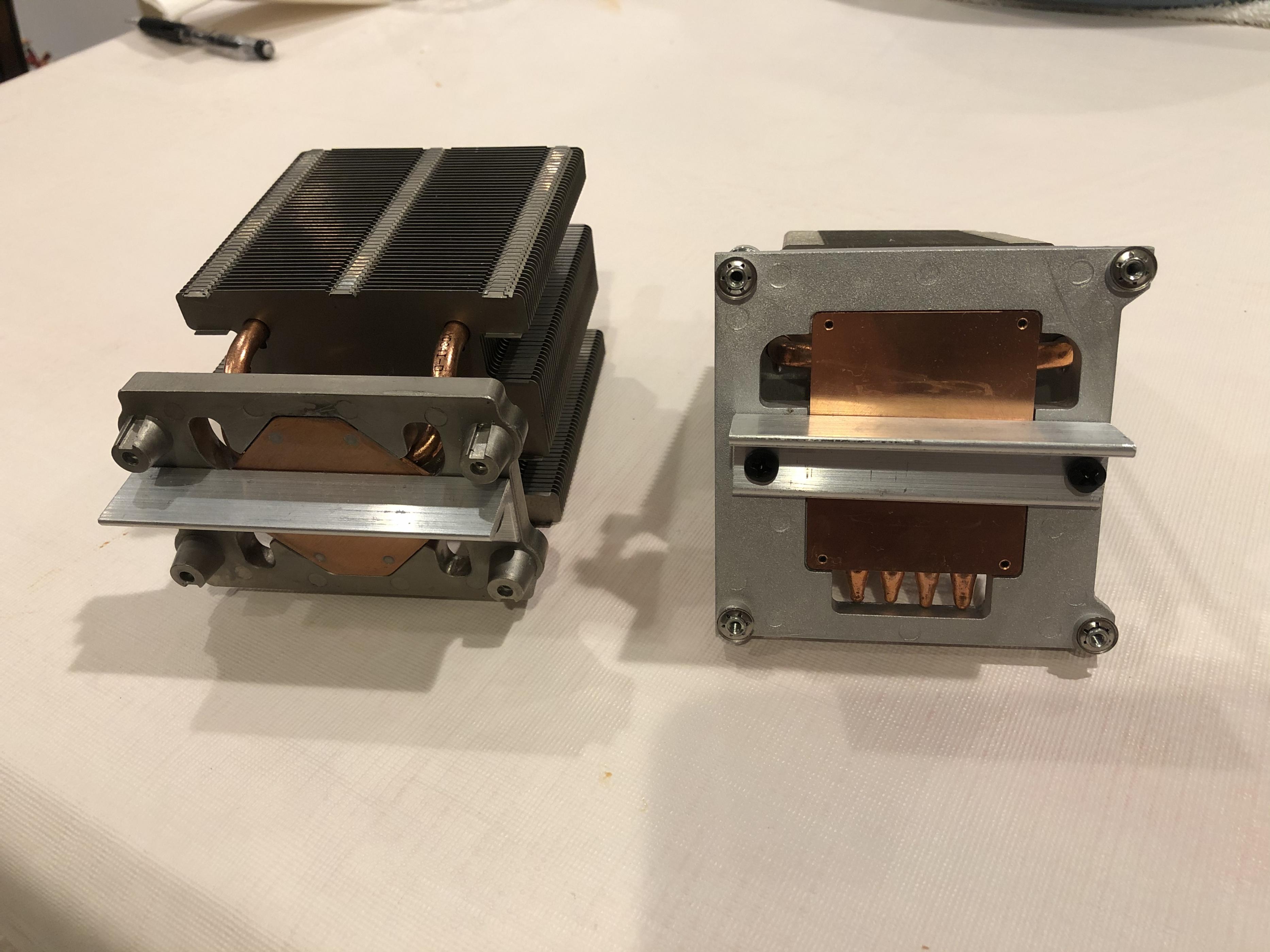

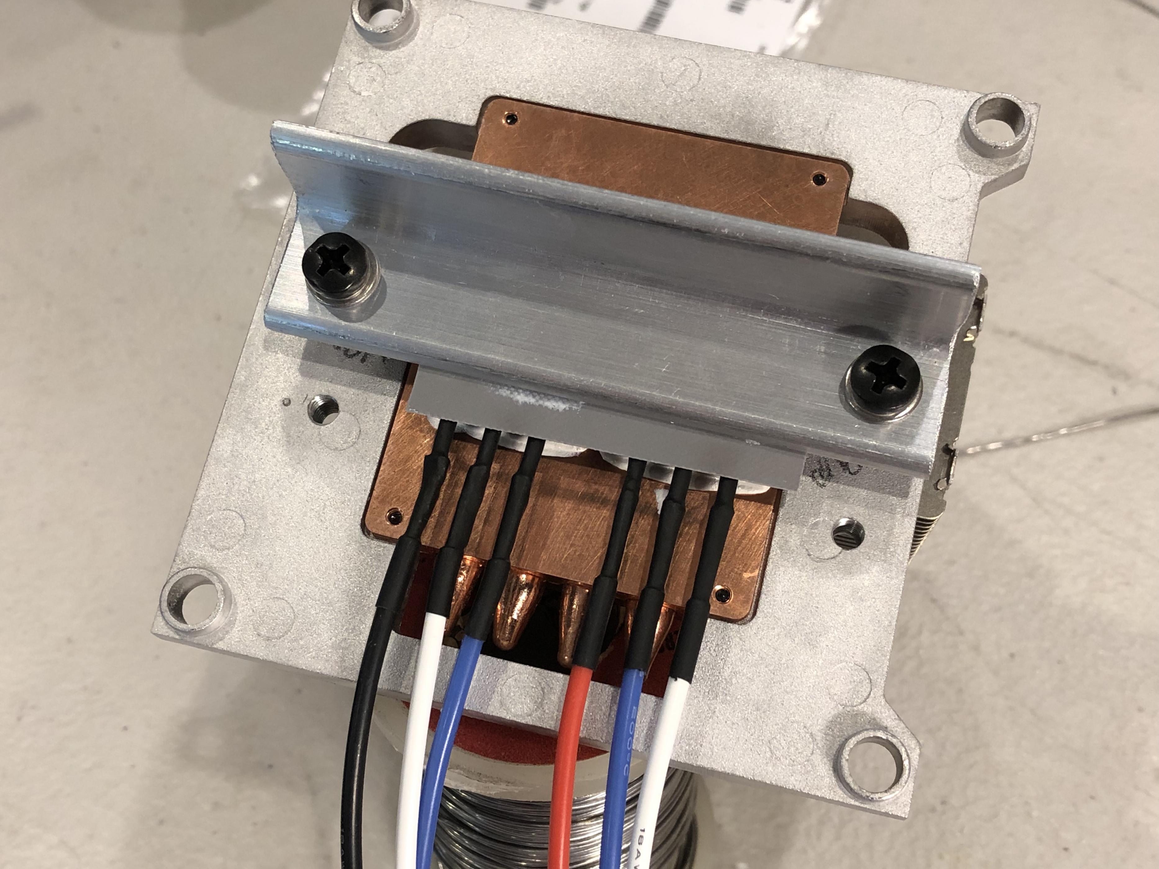

I would like to explore the idea of using a cpu cooler. I see that various have shown promising results, but I cannot find anyone talking about how one physically attaches the Mosfet to the cooling plate. Do you just drill and tap a hole in the cooling plate of the cooler? Also, how do you attach the cooler with fan to the chassis?
Finally, do you use flying leads with the Mosfet or do you connect the pcb to the cooler in some way?

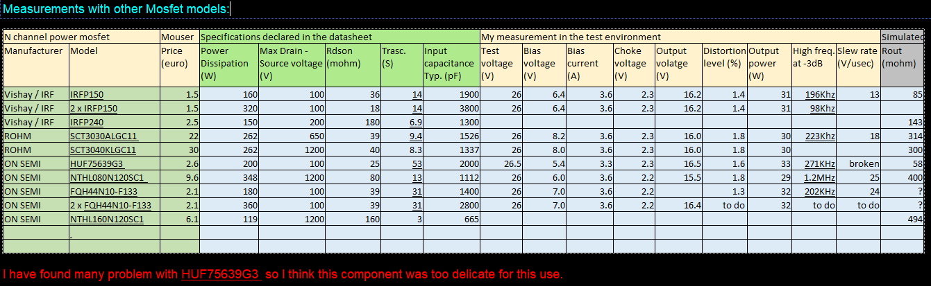

Hello I am here with new measurements using ADALM2000.
I don't know why the slew rate is low in both the amplifiers, Pathos declare value of 38V/usec here.
Transconductance?
The transconductance of the IRFP250 at these voltages is not at its best.
Maybe the reason why i like the irflb3813 and its bigger brother. The input capacitance can be dealt with a beefier preamp

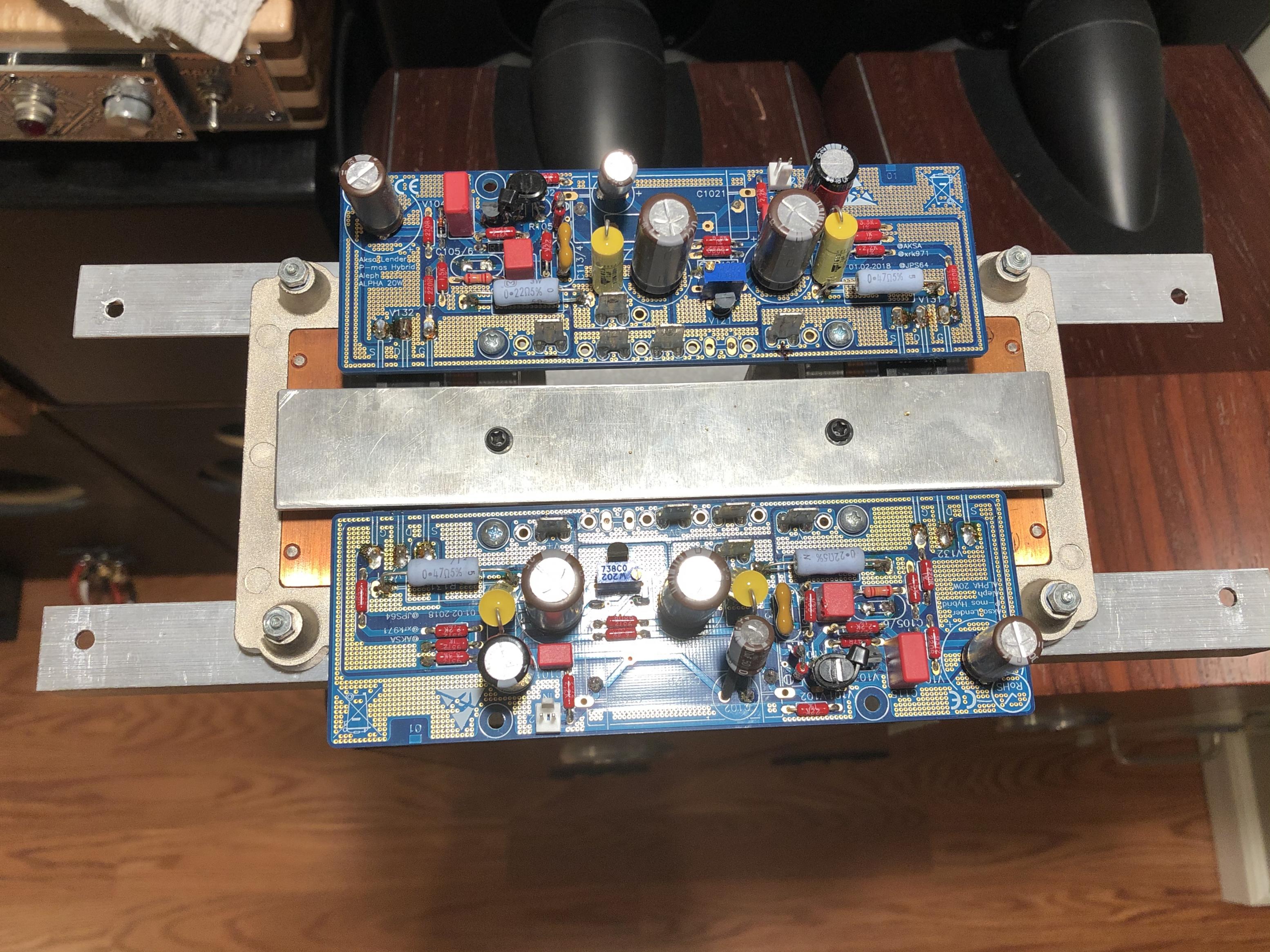

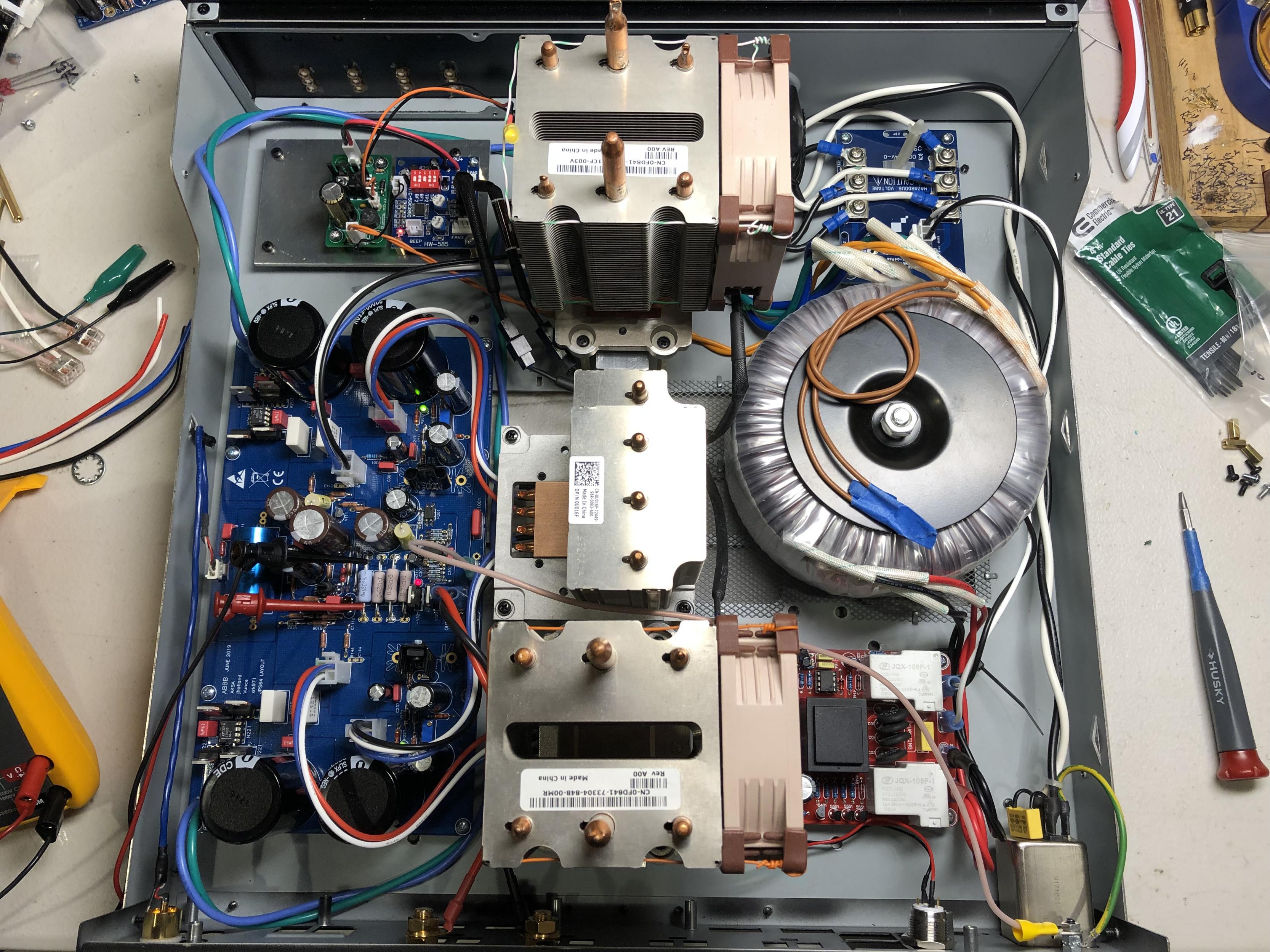

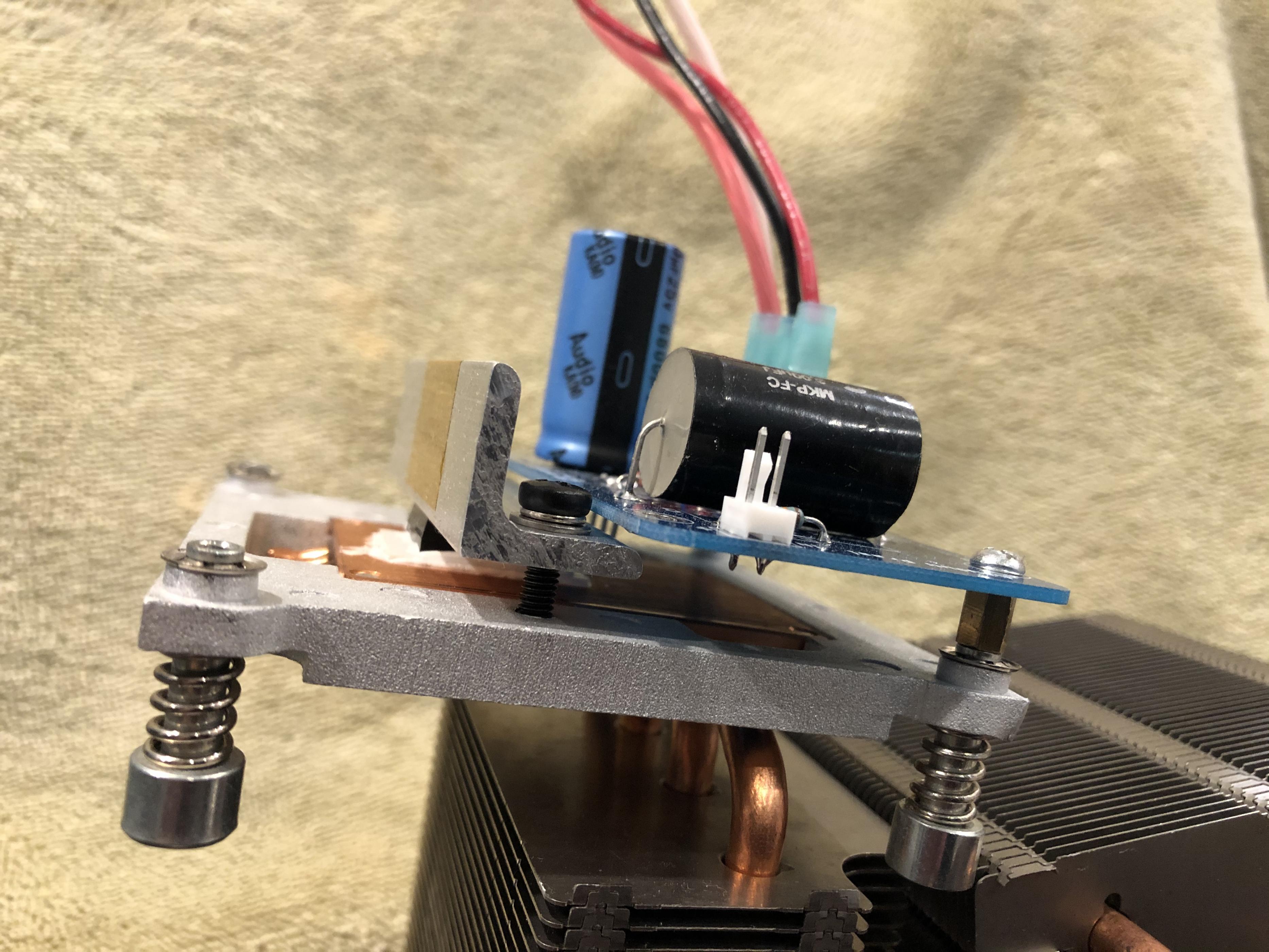

Hi Jazzzman,
I have used cpu coolers and Noctua fans for several builds with great success. They are a bit awkward to incorporate into an attractive chassis, but they allow you to build extreme projects not possible with conventional aluminum finned heatsinks. Like 4A @ 37vdc for example, Monster MoFo!! 😀
You need a separate 12vdc source to power a PWM fan control board, get them on eBay. Automatic speed control by temperature sensor and dip switch setting. Builders are resistant to use fans because they are “noisy”, but Noctua fans even on a medium speed are just about silent.
The heat sinks of choice are dell OEM units with large copper bases. You drill and tap into the aluminum that surrounds the copper and use an angle aluminum clamp bar. I’ve used both the flying lead methods and also mounting the PC board directly on the CPU unit. The MoFo is absolutely perfect for this setup, single output device and a small pcb.

Vunce, after studying your pictures a little more, I do have a couple of questions, if you don’t mind. In photo 4, it appears in the upper left you have the fan ps and controller. What is the pcb in the lower right corner? How tall is the Dell cooler? Also, which inductor are you using. Finally, does the transformer have dual voltages? Which transformer did you use? Thank you again.

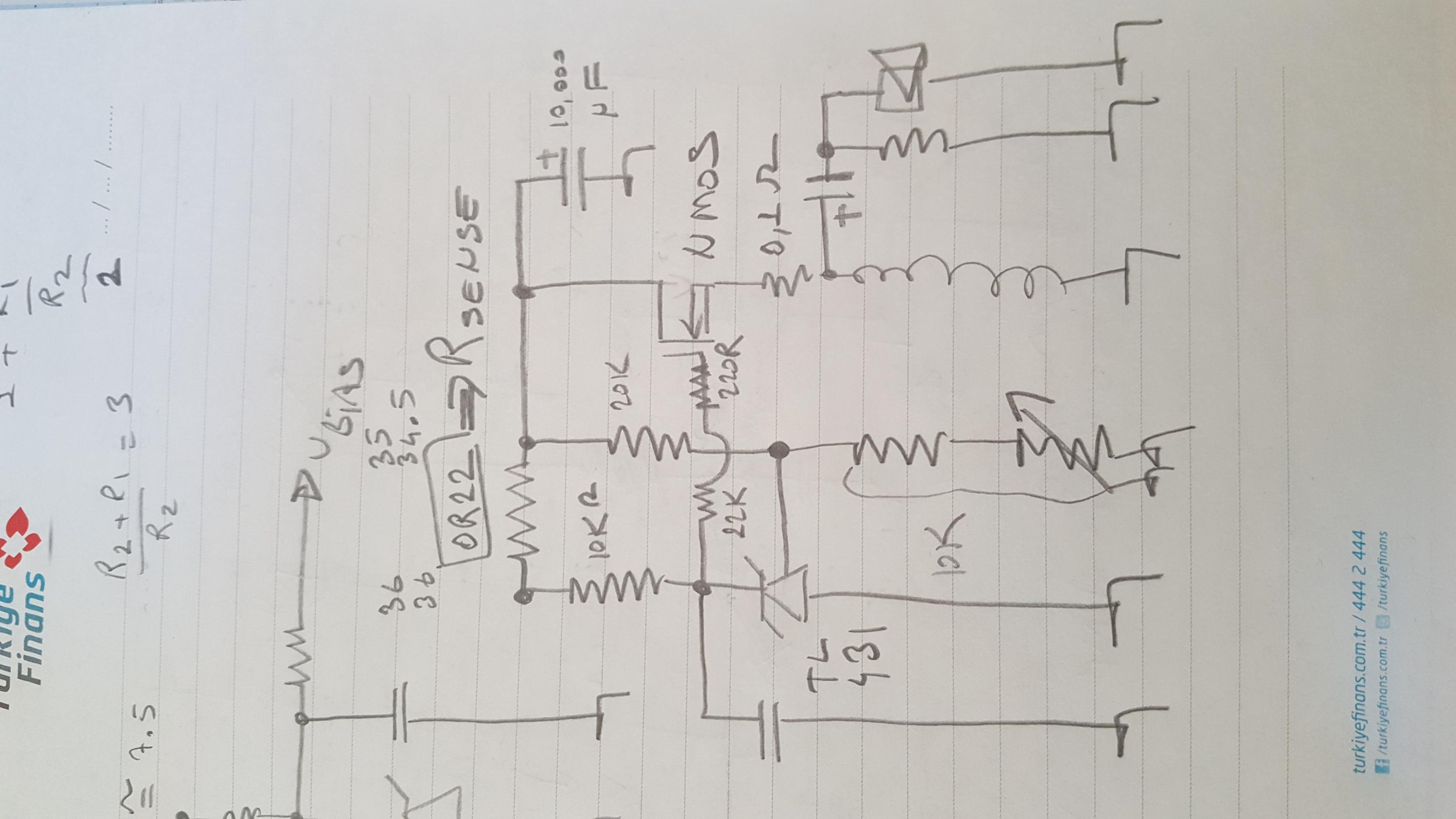

After frying some verticals due to thermal runaway, found the idea to track bias inversely climbing bias.
Using TL431 biased after a sense resistor.
After ZEN warned me about laterals, decided to use verticals.
Comments please.

At the end of Rsense, voltage drop increases from 0.99V to 1.32V when bias from 4.5A to 6.0A. Thus Vref (38V-drop/3) 12.22 from 12.33, and anode voltage drops. Bias voltage decrease somewhat alters Vgs downward.
Will it not work ?
Or help bias down ?

Here more data about mosfet choice, the FQH44N10 is better than IRFP150NPbN aso if I cannot simulate the Rout because there is no spice model available.
The thd level is refered to the complete amplifier with 6072A driver.
Also the NTHL080N120SC1 is an interesting device with a band of 1.2MHz but there is a very high Rout and the slew rate is only 25V/usec.
Obviously I have to measure also the slew rate of the driver to know the limit of this. http://www.audiodesignguide.com/Inpol/NTHL080N120SC1-D.PDF
