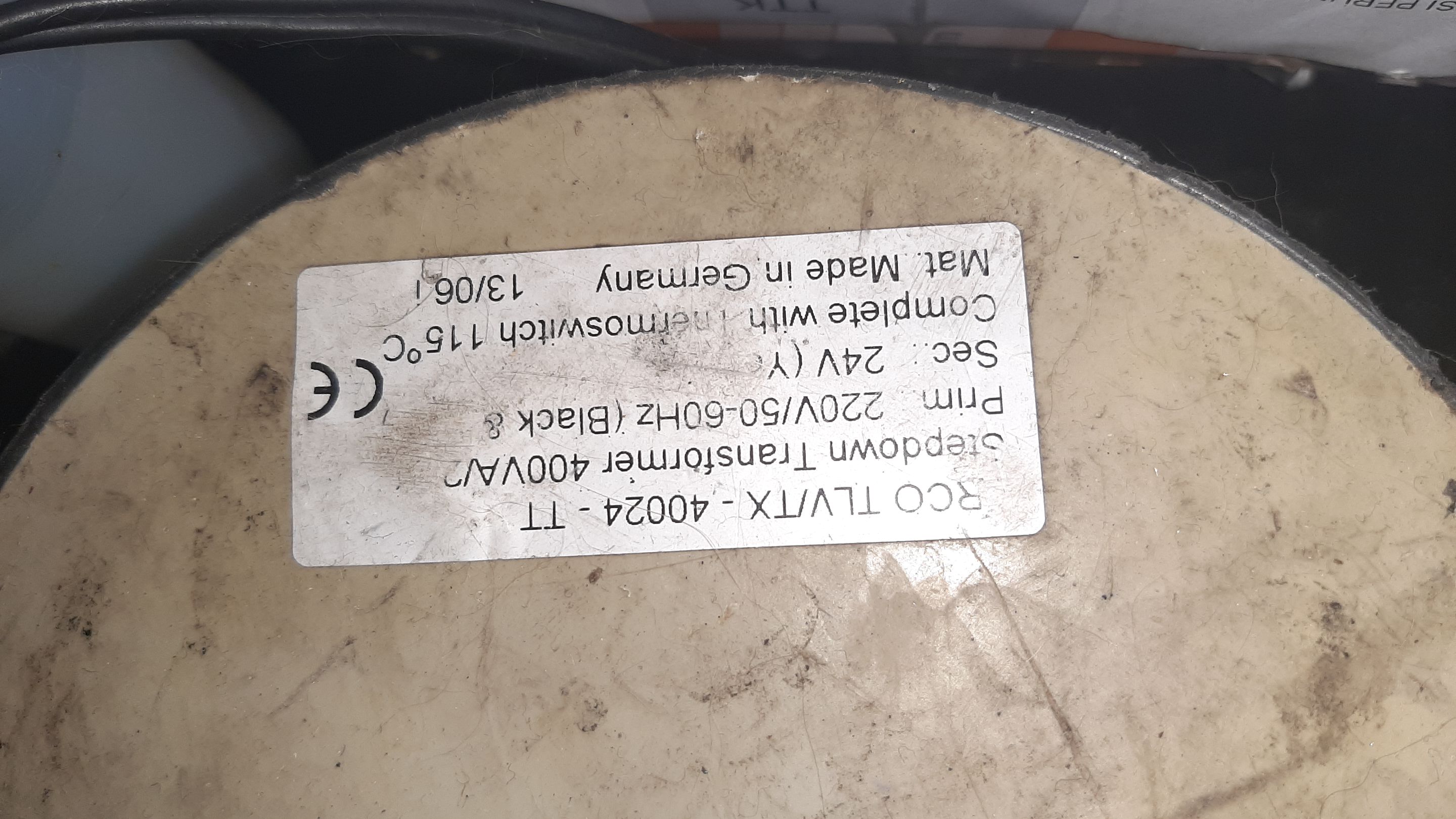

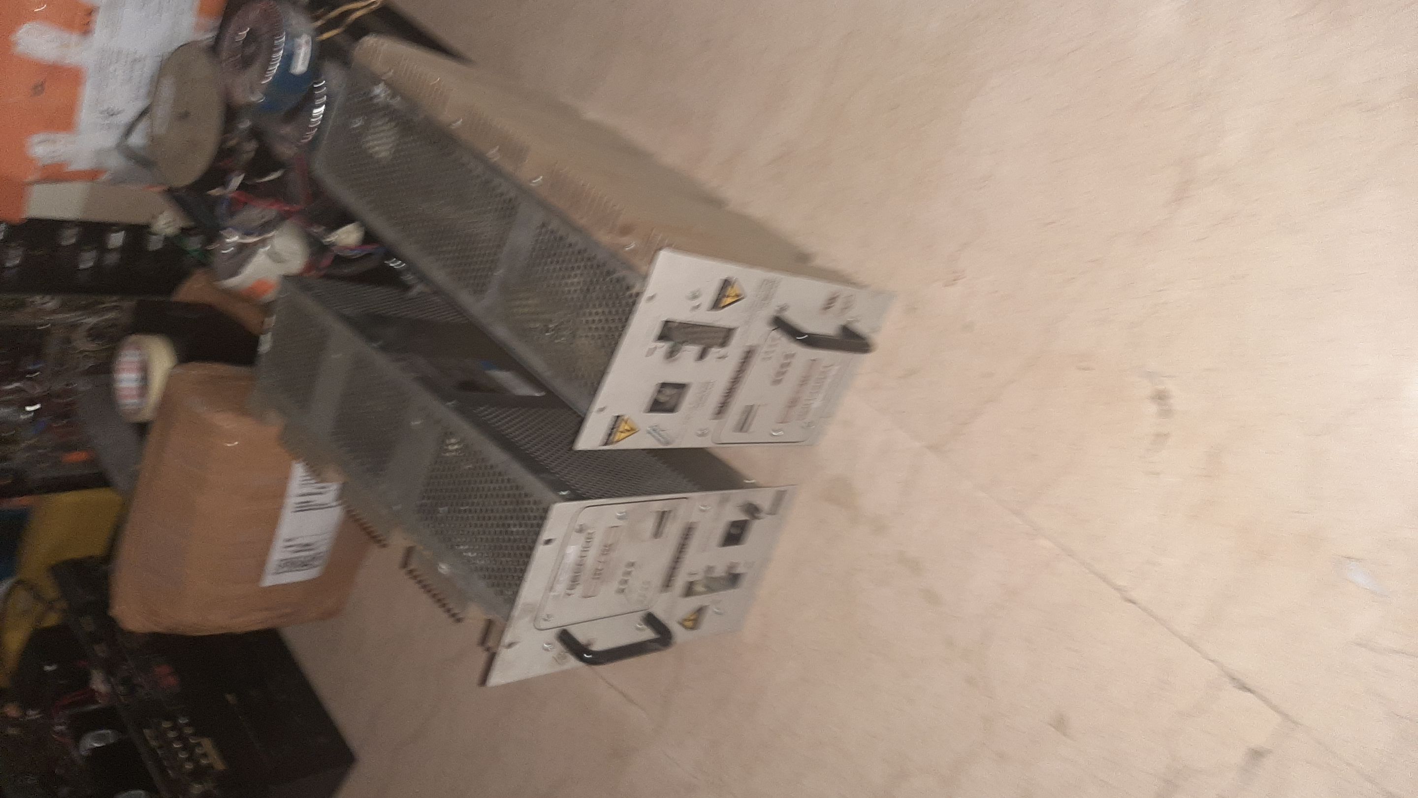

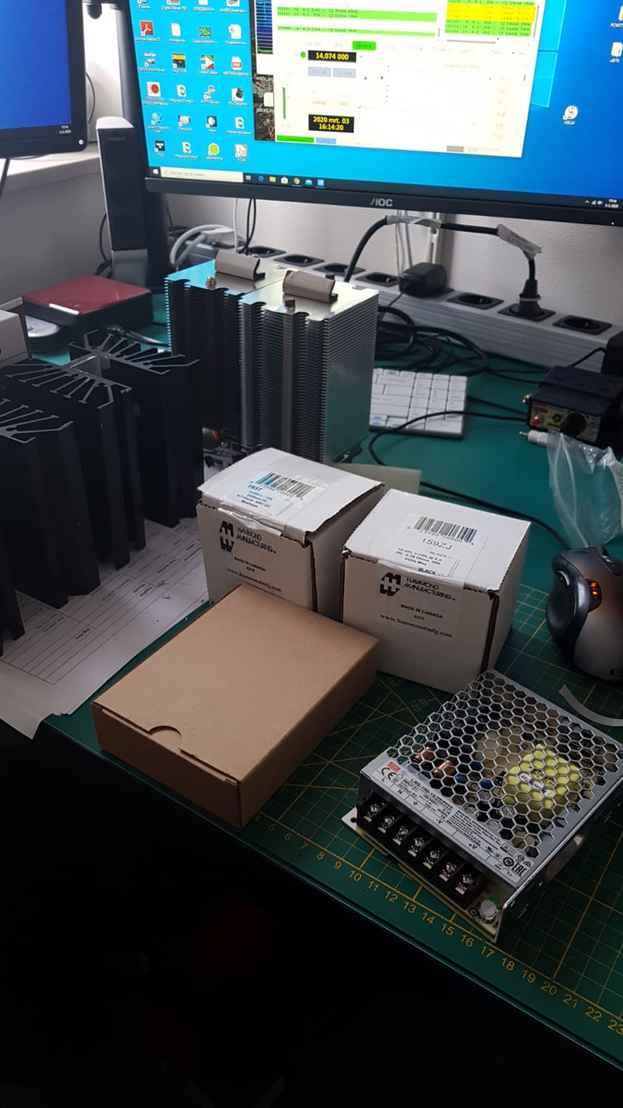

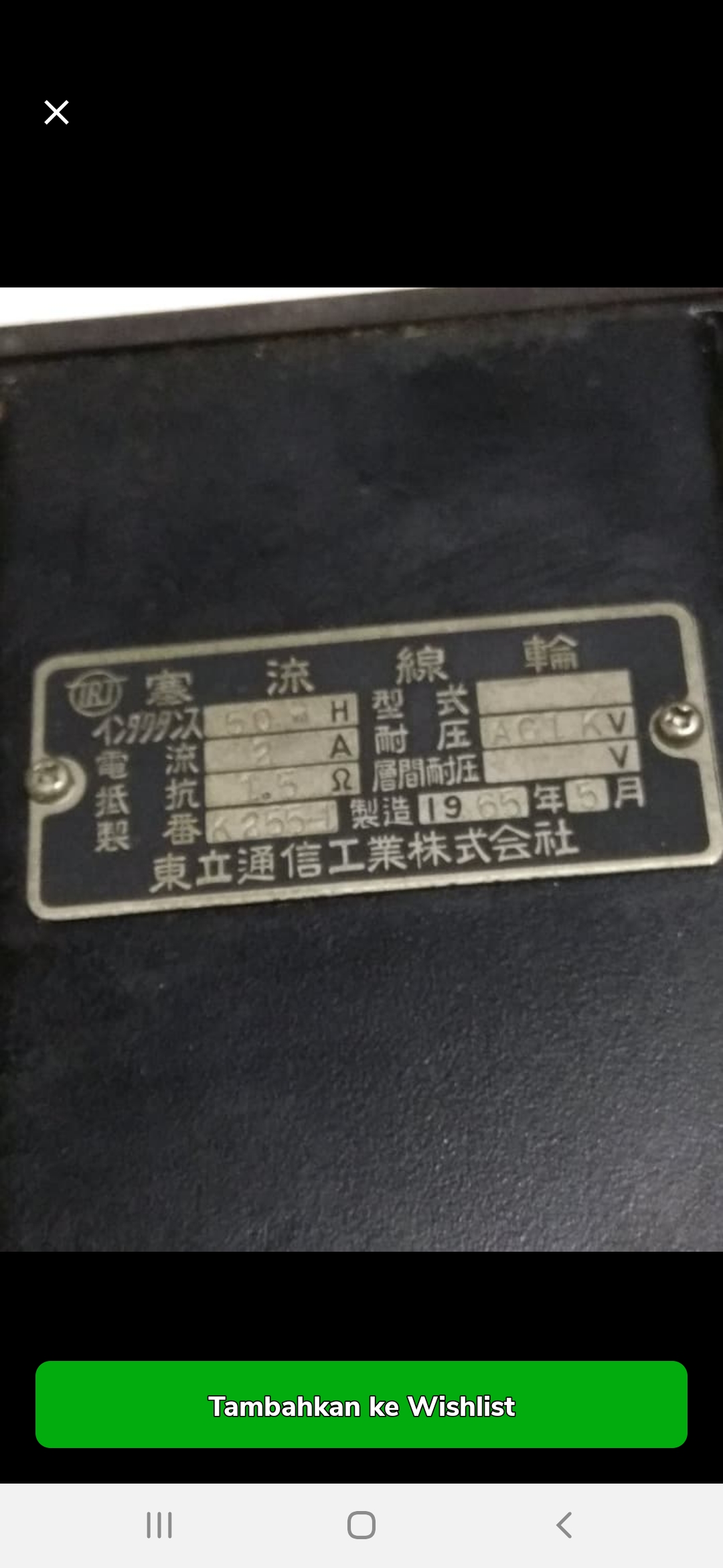

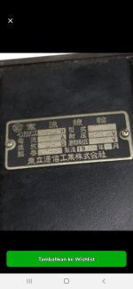

Will this work?
6kg each side heat sink
it'll work
choke - slightly higher Rdc than I would like - but - if it's big enough to dissipate heat (2A^2*1R5=6W) , it'll do the job
heatsink - more than good enough , if I'm seeing right how huge they are
24Vac xformer , little on high side ( will most likely result in 24Vac *1.25=30Vdc

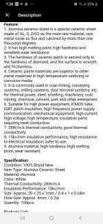

you need to keep dissipation in mosfet up to 50W , but only if you're using bespoke thermal interface and big heatsink
heatsink you have , so use either Keratherm from Store ( if buying somehwre else , take care to buy exact type - 86/62
there are some other ones , less costly , but much worse conducting heat
yes , you can use cap multiplier to shave 4 or so DC Volts , being closer to prescribed rail ....... again - strictly dissipation issue , not that Mosfet doesn't like higher voltage
