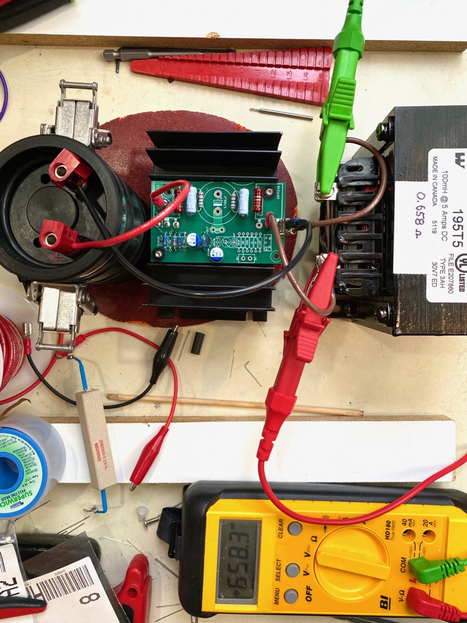

I needed a better way of measuring the DC resistance of my chokes. So with a little extra time on my hands...
The PCB is from a spare custom ACA set that I was working on a while back. The ACA current source is easily adaptable to 1.0 Amps from a 12V battery. The Mosfet is an IRFP044. From the ACA 1.6 schematic, I lowered R7 to 3.32 kΩ and set R1 through R4 for a total of 0.653 Ohms. It was also necessary to set R15 to 10k to get an actual 1.01 Amps from the current source. Output is taken between the Drain and Source connections of Q1, which is otherwise unpopulated.

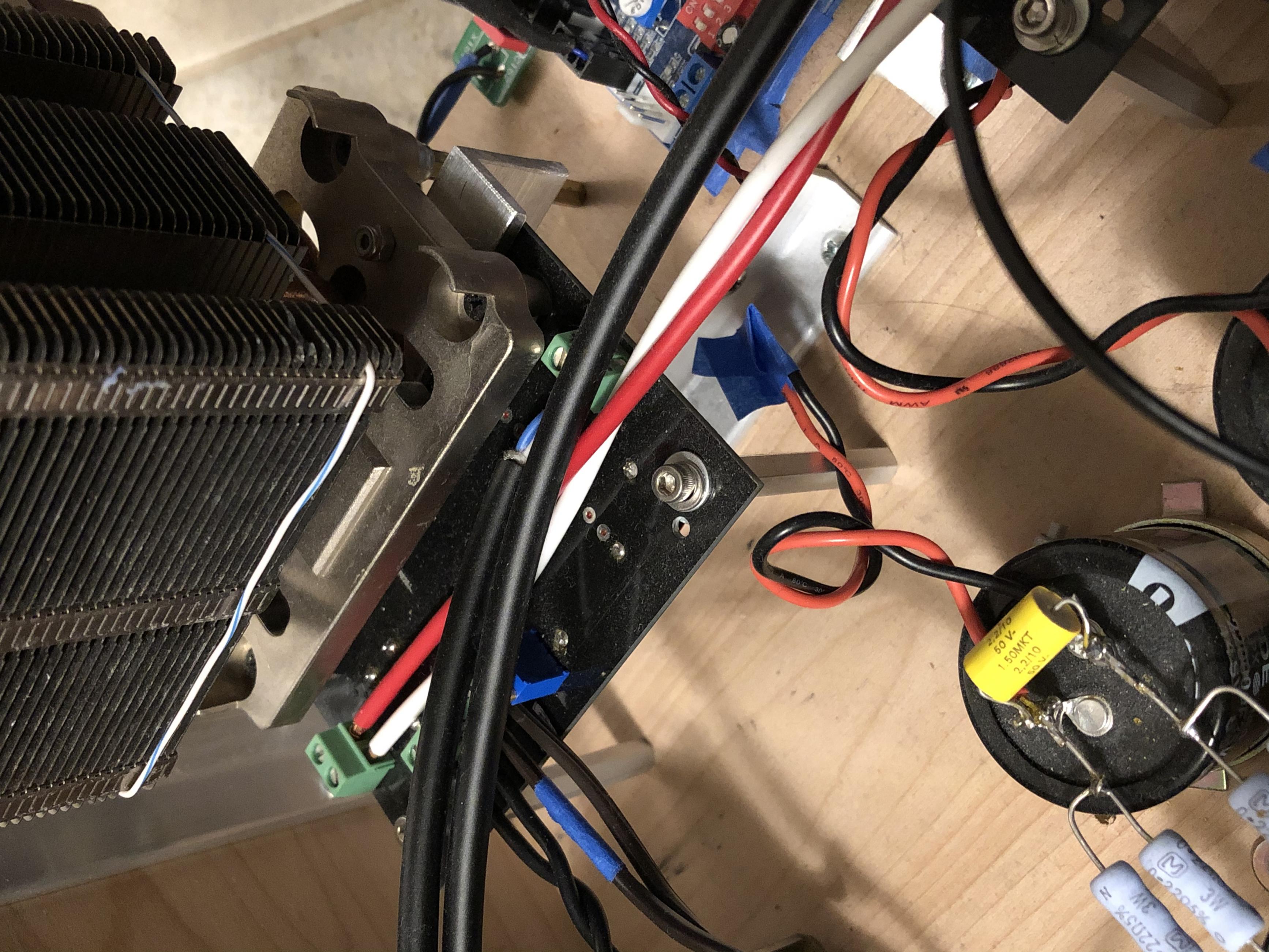

has anyone played with the output cap C2? Does higher quality caps makes a big difference with this amplifier or it is not worth exploring? Right now I have the one suggested in the BoM (Nichicon UFW 25V 6800uF) but was thinking of upgrading to Mundoef M-Lytic AG MLGO

I am also starting with the recommended output cap, and have some other options to try as well. I have some Mundorf 68 uF RAW E-caps to try in parallel with the Nichicon KW. I also plan to try the Nichion KS series 8200 uF, 25V. It is said to be similar to the KG series that I prefer for my ACA builds.
Of course I will also be trying different Mosfets on a second set of boards. I have a few of the FQH44N10 left over from my F6 build.

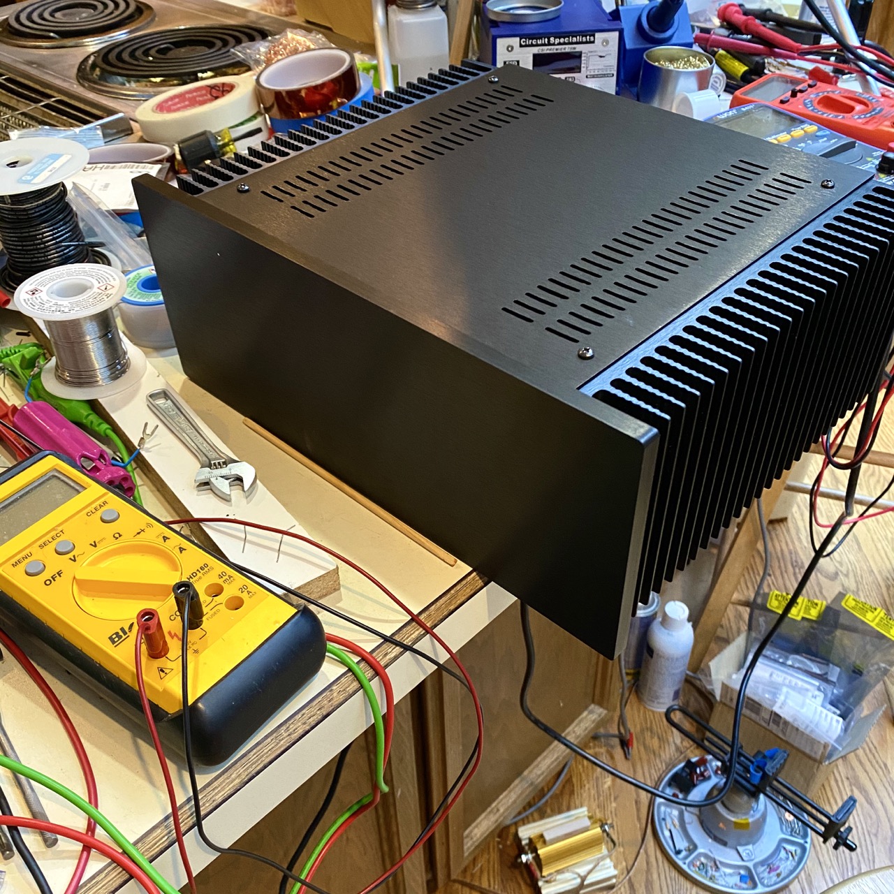

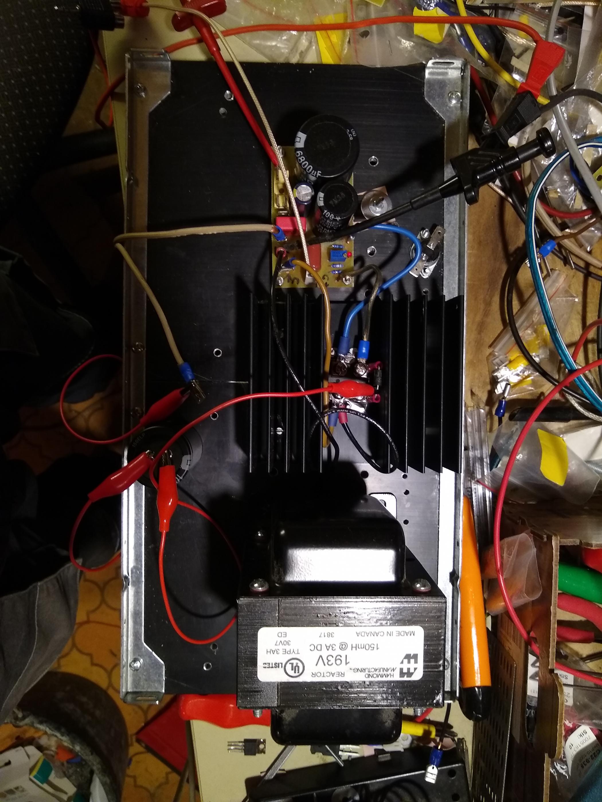

I finally got the most basic version of my MoFo wired up. This doesn't have a gain stage or a power filter / regulator. The Meanwell RSP-150 has been dialed back to 25.5 Volts. Bias current is just over 2.93 Amps. With the lid screwed on and left to soak thermally for about an hour, the side with the MoFo PCB and IRFP250 is right on the edge of being too hot to touch for more than 10 seconds. So, right about where I expected and hoped it would be. Not bad for dissipating 74.7 Watts.
The chassis is a Mini Dissipante 3U, 250 mm deep. I bolted 1/4" thick slabs of copper on both sides. The SMPS didn't need the thermal enhancement, but was easier to attach to the inside of the heatsink that way. The IRFP250 no doubt benefits from having the copper heat spreader.
This amp can be dialed up and down considerably, especially if I include the CapMx after the SMPS. The original plan was a filtered 25 Volts at the amp boards, and 3 Amps bias. Still in excess of the usual ‘big’ MoFo running at 24V and 2.5A.

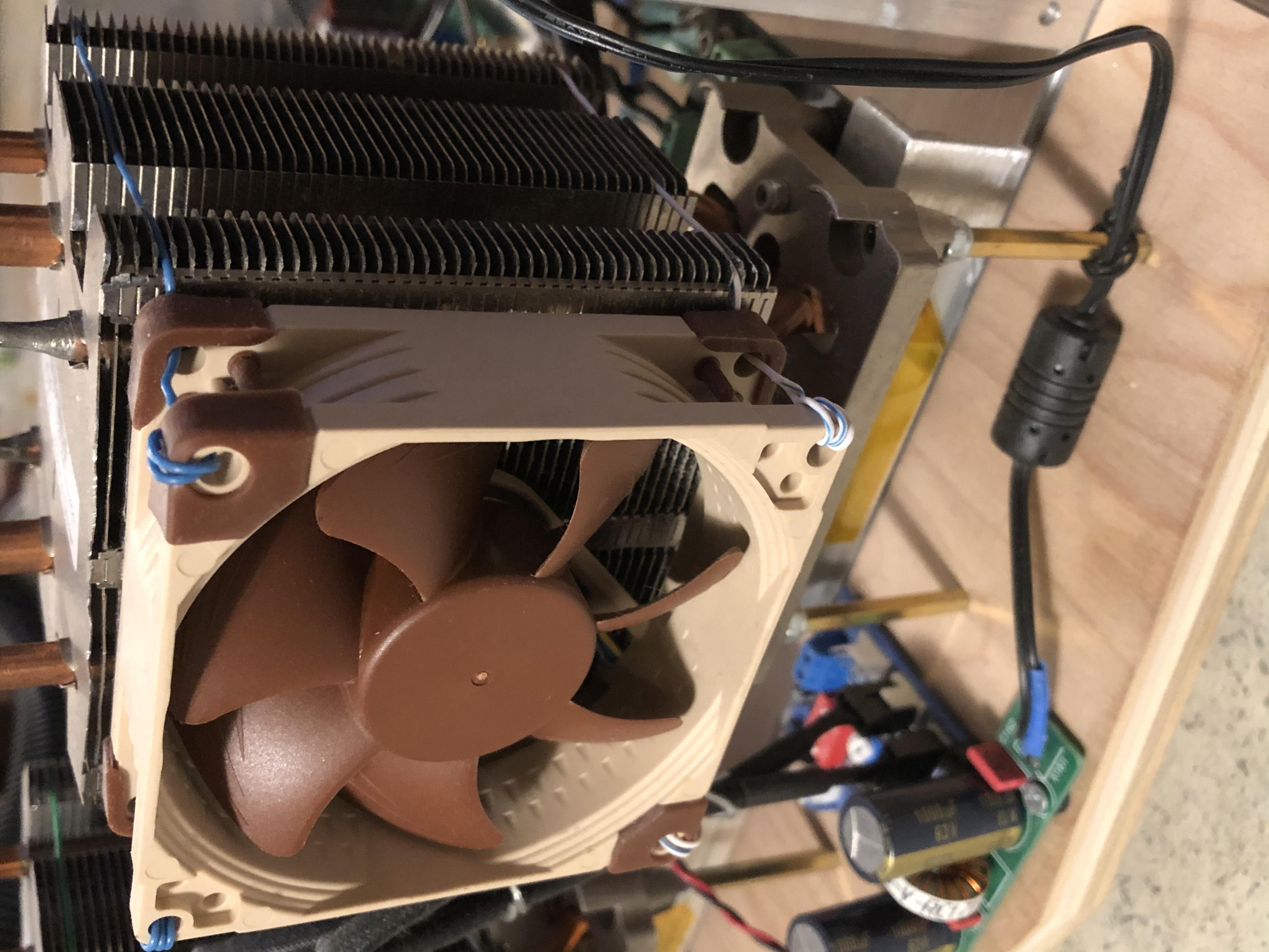

With its single output device, a High Bias MoFo is a perfect candidate for a cpu cooler/Noctua fan combo. That setup is capable of well over 120w of heat dissipation.
There are a number of big MoFos that are continuously pushing 53.75 Watts through the IRFP250. That is assuming a 24V supply and a Hammond 193V choke. This seems to be the upper region for passive cooling. The big fan cooled heatsinks extend the working range well above the 55 Watt mark.
I’m interested in pushing the boundary of what can be achieved without resorting to a CPU cooler. This is partly because I want to eventually add a tube gain stage on the top plate of my case. Maybe that’s just me being my FAB self. I prefer the look of some nice transformers and large glass tubes to a block of thin metal fins. I can also try a small fan inside the case. Even a little airflow makes a big difference.
This is also an ongoing experiment in power dissipation. I’m gathering data for the next big amp build or two.
I just did another thermal soak with different settings for the power. The SMPS voltage was increased to 26.0 Volts, and the quiescent current was lowered to 2.4 Amps. No other changes were made. This results in 60 Watts being dissipated through the IRFP250.
The thermal performance is much better and in line with my other FW clone amps. The heatsink is fairly warm to the touch, but not hot. I don't notice any hotspots, and can leave my hands in contact with the area closest to the Mosfet indefinitely. Bias current reaches a stable value within 15 minutes, and the heatsinks reach their thermal equilibrium after about a half hour.
This lower power dissipation seems to be much better managed. The thermal performance of the 3U x 250 mm heatsink looks to be confirmed at 0.41 °C/W. Given that the 60W is being dissipated by a single device, use of a copper heat spreader is advised.
I will use this as the baseline power setting for the remainder of my exploration with the MoFo. I need to determine if the SMPS is sufficient by itself (as many here have done), or if it needs help from a larger reservoir capacitor. There are different options being considered for a gain stage. Several forum members have been helpful in suggesting alternatives. I will select one of the tube preamps and have a custom acrylic top cover made to hold that as a self contained assembly. In the meantime, I will also work with Juma's Gyrator loaded Son of ZV9 as a solid state gain stage.
