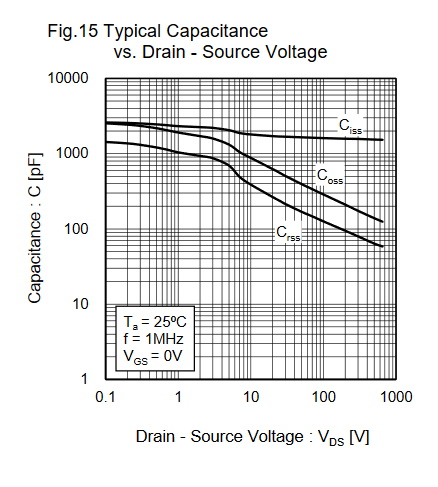

First test on different mosfet, the distortion is only on the 6072A driver stage if the drain voltage is enough and the source current is enough.
IRFP150 1.5euro 160W 1900pF
=> 26VDC 3.6A Vg=6.4V Vl=2.3V 1.8% thd 16Vrms load 8ohm 30W
SCT3030ALGC11 22 euro 260W 1500pF
=> 26VDC 3.6A Vg=8.2V Vl=2.3V 1.8% thd 16Vrms load 8ohm 30W
SCT3040KLGC11 30 euro 260W 1337pF
=> 26VDC 3.6A Vg=8.0V Vl=2.3V 1.8% thd 16Vrms l
oad 8ohm 30W
oad 8ohm 30W

The SCTs remind me of the Semisouth 120R100. This proofed to be of big advantage in the second version of the Firstwatt F2. But in follower mode there is apparently no advantage
I wonder about the difference between a vertical and a lateral especially designed for audio. Btw I had very good results with four 2SJ162 wired parallel and polarity reversed also.
Your comments ?
Regards
Mehmet
2SJ162 P channel used in this project ?
I would like to test the IXFN50N120SK with SOT-227 package and low input capacity 1850pF
