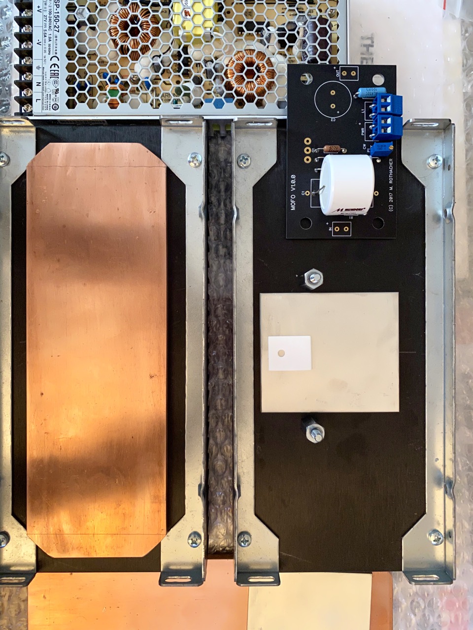

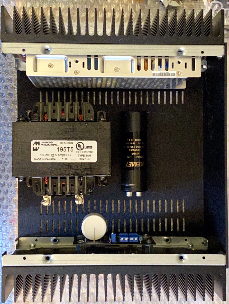

Here is a new pair of MoFo monoblocks in progress. These are being built with a mix of available parts, along with some new ones. I already had a pair of 27V MeanWell RSP-150 SMPS and Mini Dissipante 3U chassis on hand from a set of ACA monoblocks that are being re-directed. These will use the store PCBs as a platform for the amp, and a new pair of Hammond 195T5 chokes. I will be building new veroboards for a CapMx and input gain stage.
The target power rail voltage is 25V, with a quiescent current of 3A. I have enhanced the power dissipation capacity of the heatsinks usng 1/4" copper plates. With these, the heatsinks should be good for about 0.41 °C/W temperature rise. Given my normal ambient room temp of 22 °C, heatsinks will hopefully stay below 55 °C. That's going to be hotter than my other FW clone amps, but still reasonable.
Here are a couple pictures of the main components and trial fitment. The veroboard locations are still being studied.

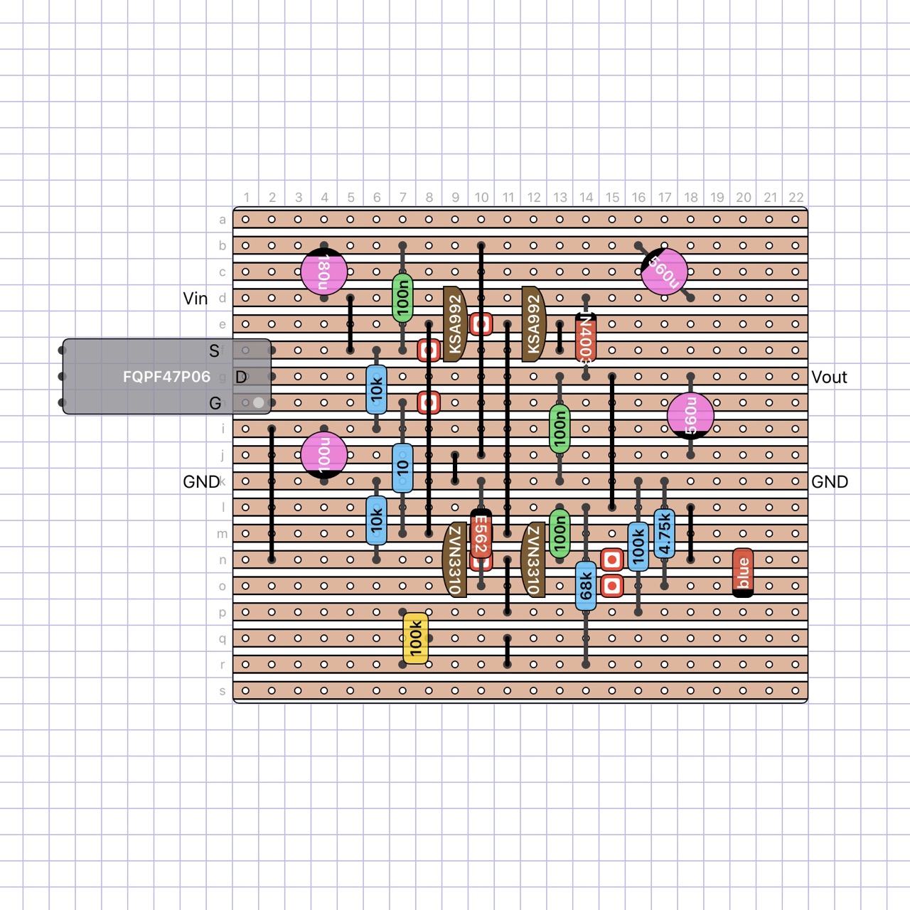

When I tried the RSP-150 SMPS as a substitute PSU for one of my Hafler chassis ACA builds, I found that it needed better support for the lower octave or so. To that end I'm planning to use a capacitance multiplier on the output of the SMPS. In addition to lowering the ripple, the CapMx will be used as a softstart for 24,000 uF of capacitance at the power input to the MoFo PCB. I chose the MrEvil version for its low dropout capability. This is important with 3A as the target current. The adjustments on both the CapMx board and the SMPS will let me dial in an exact voltage. I expect this may also be helpful to find the "sweet spot" for the IRFP250 Mosfets. I also plan a second pair of MoFo PCBs with the FQH44N10 Mosfets for comparison.

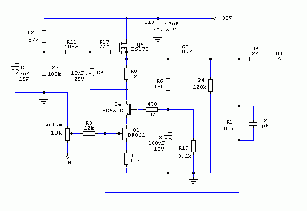

An input stage is needed to provide some gain, as neither of my preamps are particularly happy driving 20V p-p. For solid-state, I've put together a Juma style gyrator loaded Son of ZV9. It's nice and small, and will hopefully complement the MoFo well. It will also give me some time to enjoy the basic amp while I'm planning and building an octal tube based gain stage. More on that later.
