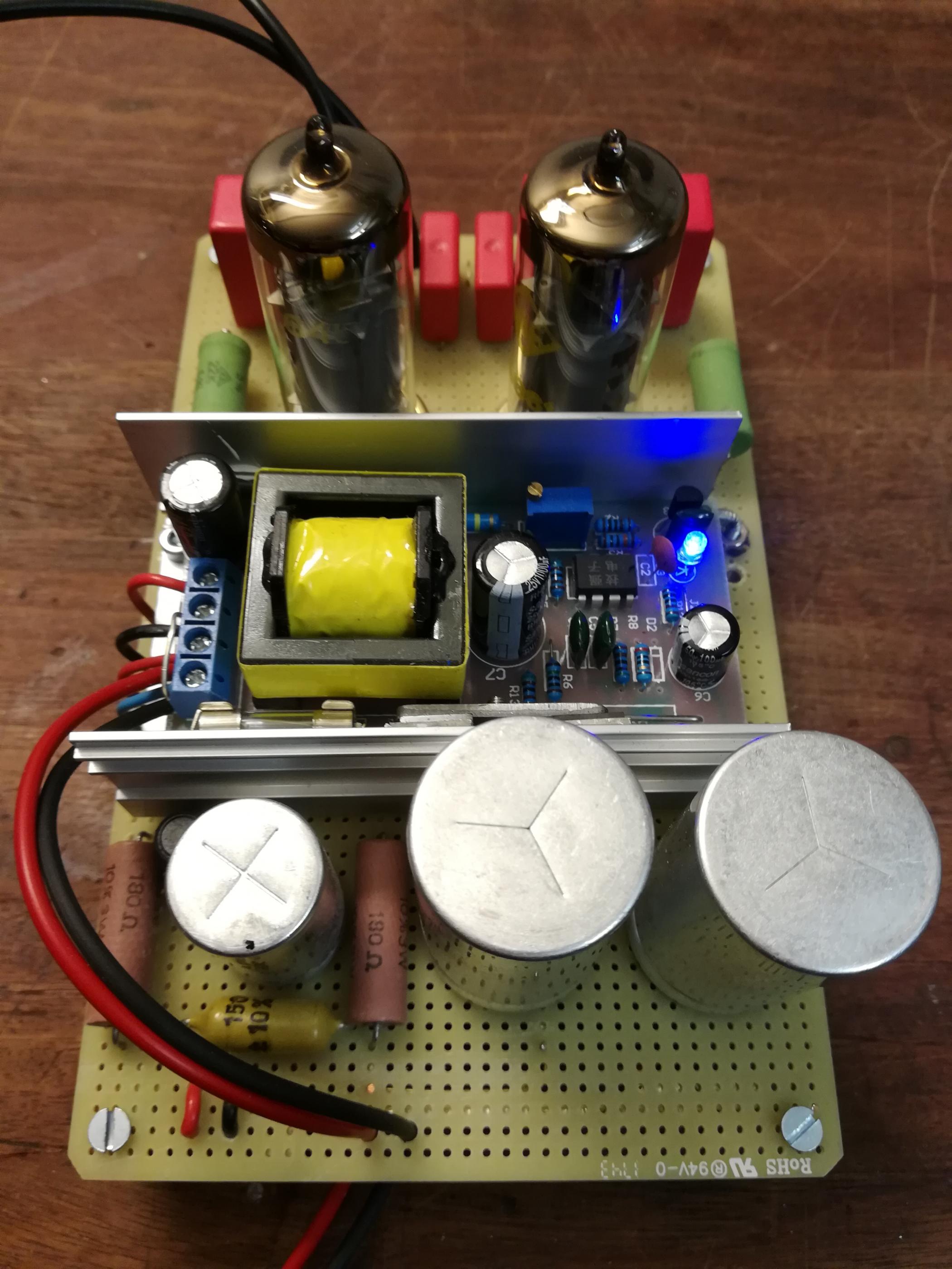

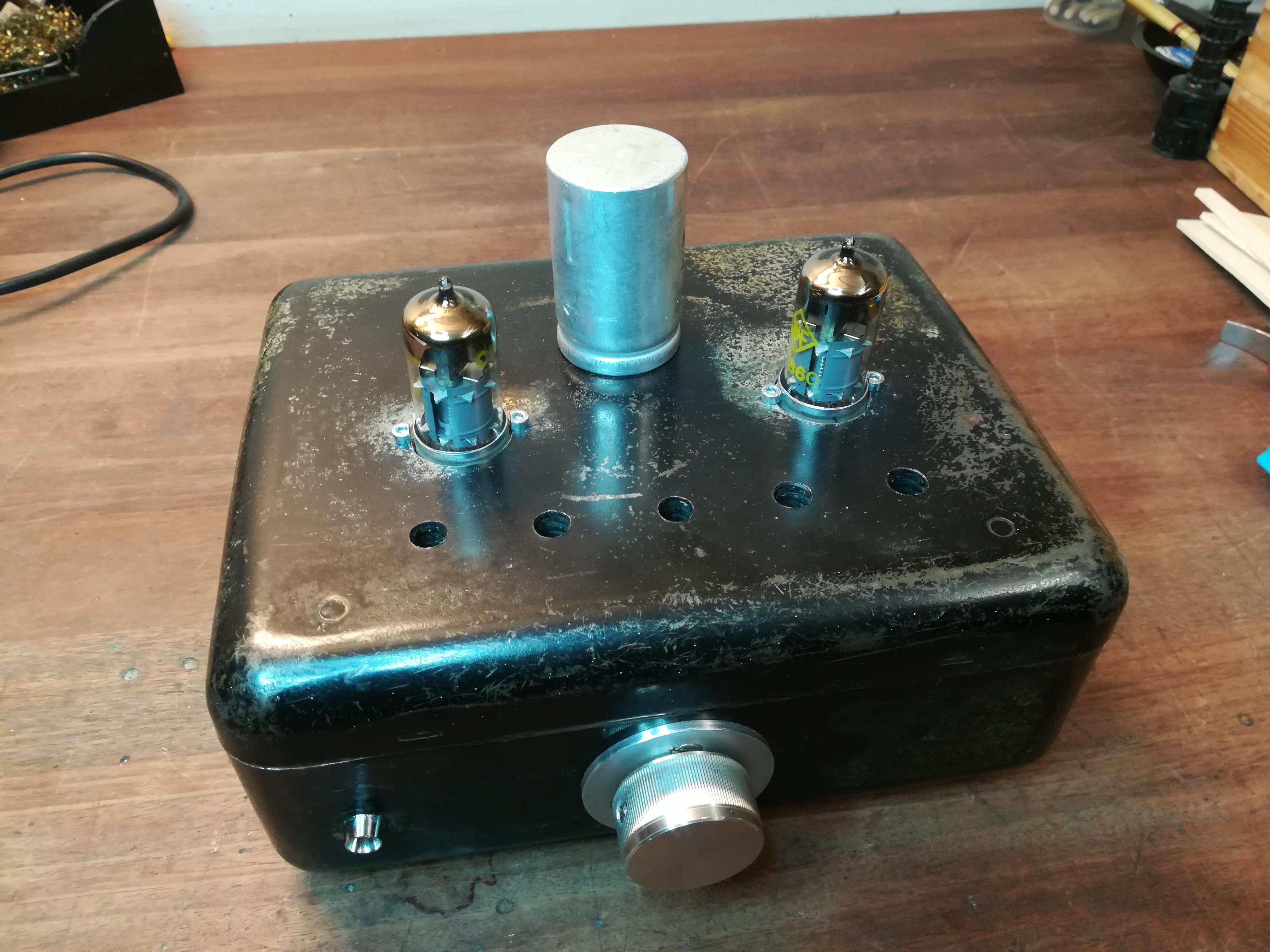

3 Preamps for Mofo
About a year ago i started looking into alternativ preamps for Mofo
Requirement was a voltage gain of 30x.
After a year of trying and building i kept the following three
First one is Andrea Ciuffolis preamp for his power follower.
A very nice preamp and you can buy the complete circuit boards (pre and power amp!). They are cheap and of excellent quality. Details can be found on
the Power Folllower.
Second preamp uses a IF860 tube (or IL861) directly coupled to a mosfet follower
The tube heaters are directly fed by the Mofo powersupply
B+ is generated by a hvflyback generator
Number three uses the same tubes without buffer
The power supply uses a chinese hvflyback for B+
Below are some pictures of the build and schematic
Details and measurements are in the next post as attachment

I have the power follower 2019 tube frontend boards, but will try something a little simpler first with 30db gain.

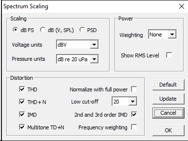

Please add on Arta software the THD display
Thank you for your proposal and the hint regarding THD. I am not very familiar with ARTA i rather use REW. Sorry for having forgotten THD.
But it is not very important here since we just have a look at what we get from different preamps that work under the same conditions.

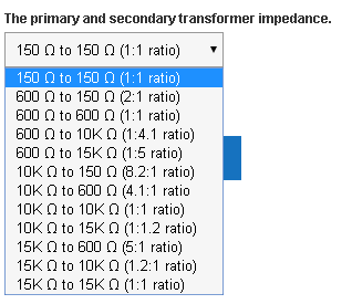

for xformer - having Bal in for your needs , SE out for MoFo ........ primary needs to have CT , so upper end of primary is (say) positive end , lower end of primary is negative end , CT goes to gnd
of course , one can skip CT , but it's easier this way ......
M2's original xformer is 600:15K (nominally) , resulting in (15K/600)^-2 voltage ratio , which is 5V/V = smidge bellow 14db
if that's too much for your needs, go to Edcor's and choose lower ratio ...... but!
see enclosed ;
whatever you choose , driven in right way or rotated and driven "backwards" , sole adequate one with lower gain is 600:10K (nominally) , giving 4V/V , aroundish 12db
for instance , if you wish 6db , 2V/V - you can theoreticaly use 600:150 (nominally) , rotated so driven at "150"side ...... but there will be probably lack of inductance that way , taking in account transposed Rin of Mofo .......... on the other hand , maybe that's doable, simply because you don't need low end ....... so , maybe that one is worth trying , if 6db is goal , even if on first look it was not adequate 🙂
you'll need separate buffer for each input leg , meaning separate buffer for positive and separate buffer for negative side of primary
