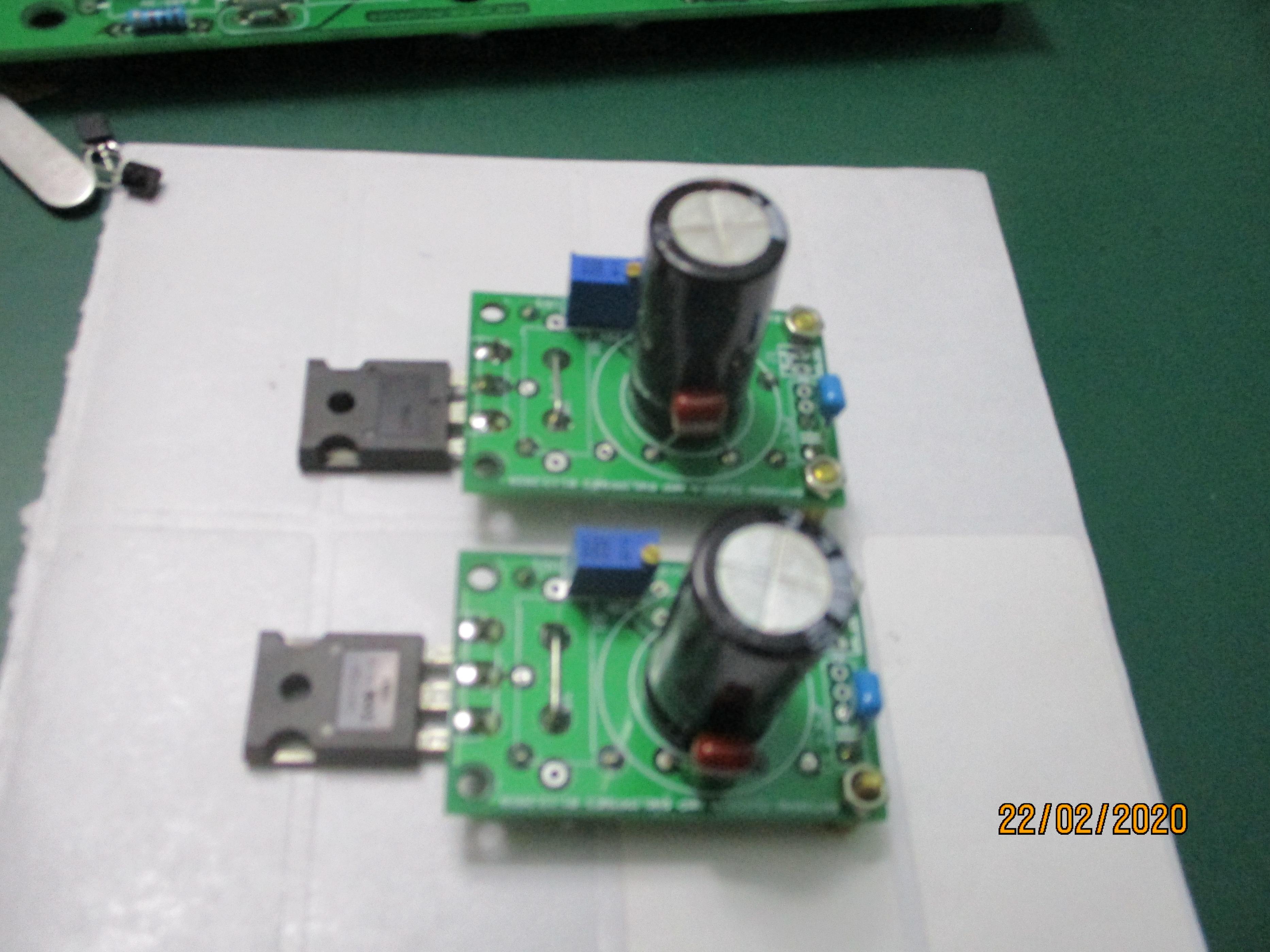

do you have protective zener for gate ?
it is shown in parts list but not on schematic ...... and I believe it's put on pcb for that exact purpose
in short - zener from 7V5 to 15V , cathode to gate , anode to source , will prevent gate to fly too far from source and cause BigBadaBooom
damn... didn't see that zener exist :D
it's all good now, i put the zener and everything is normal. :up:
thanks ZM :cheers:
anyway this zener does affect the sound, i like without it. :violin:
but no choice when using big transformer, must be installed.

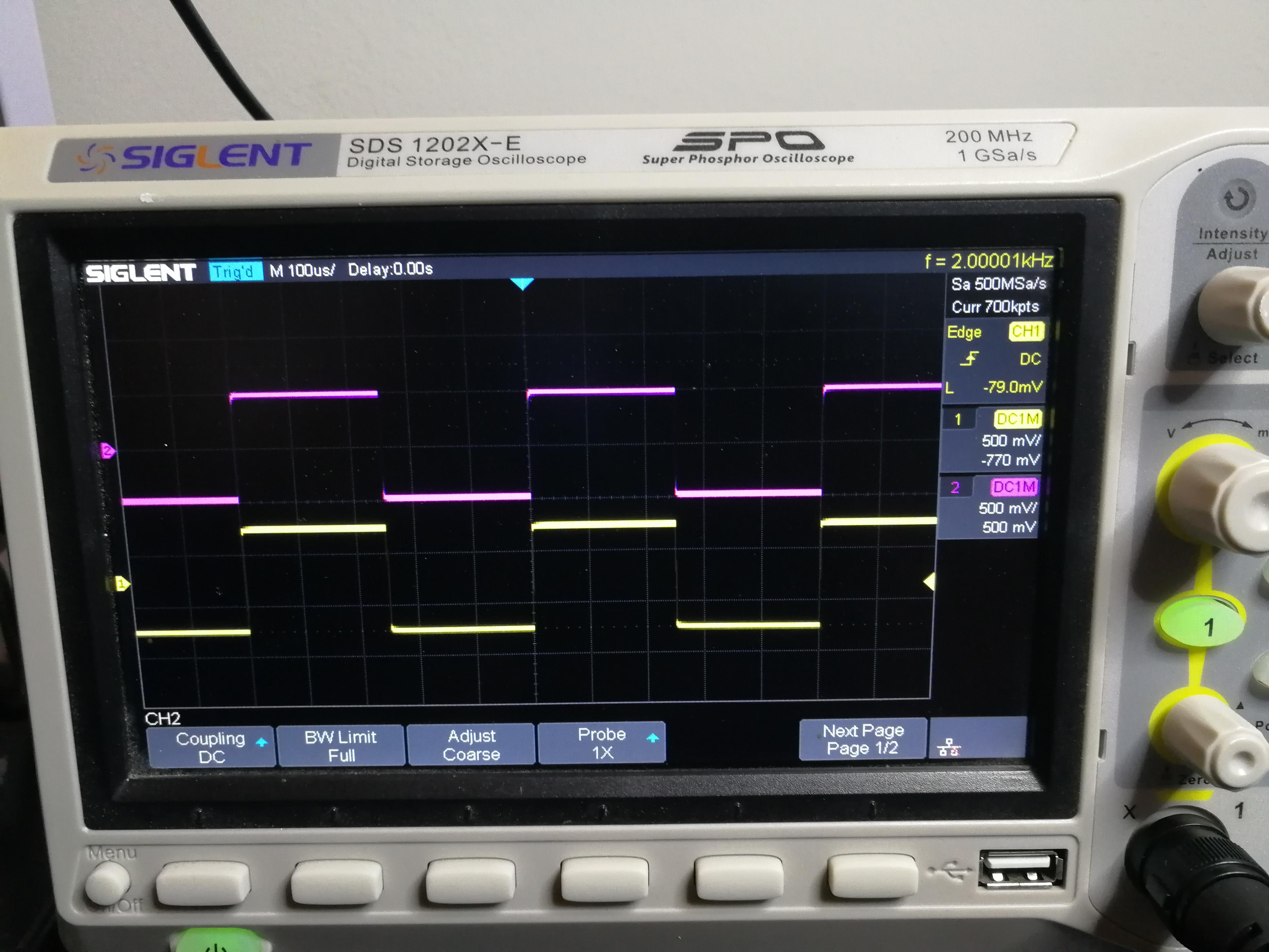

I’m currently collecting parts to build the MoFo and I wonder if it’s worthy to go for more high end chokes? I mean, is it audible when using for instance a Lundahl choke instead of the Hammond?
This is the measure I took on Sunday on my big MoFo, with the "cheap" Hammond 193V. I really don't think a more expensive choke is required. 😉
2k and 20k square waves on 8 ohm resistive load.
