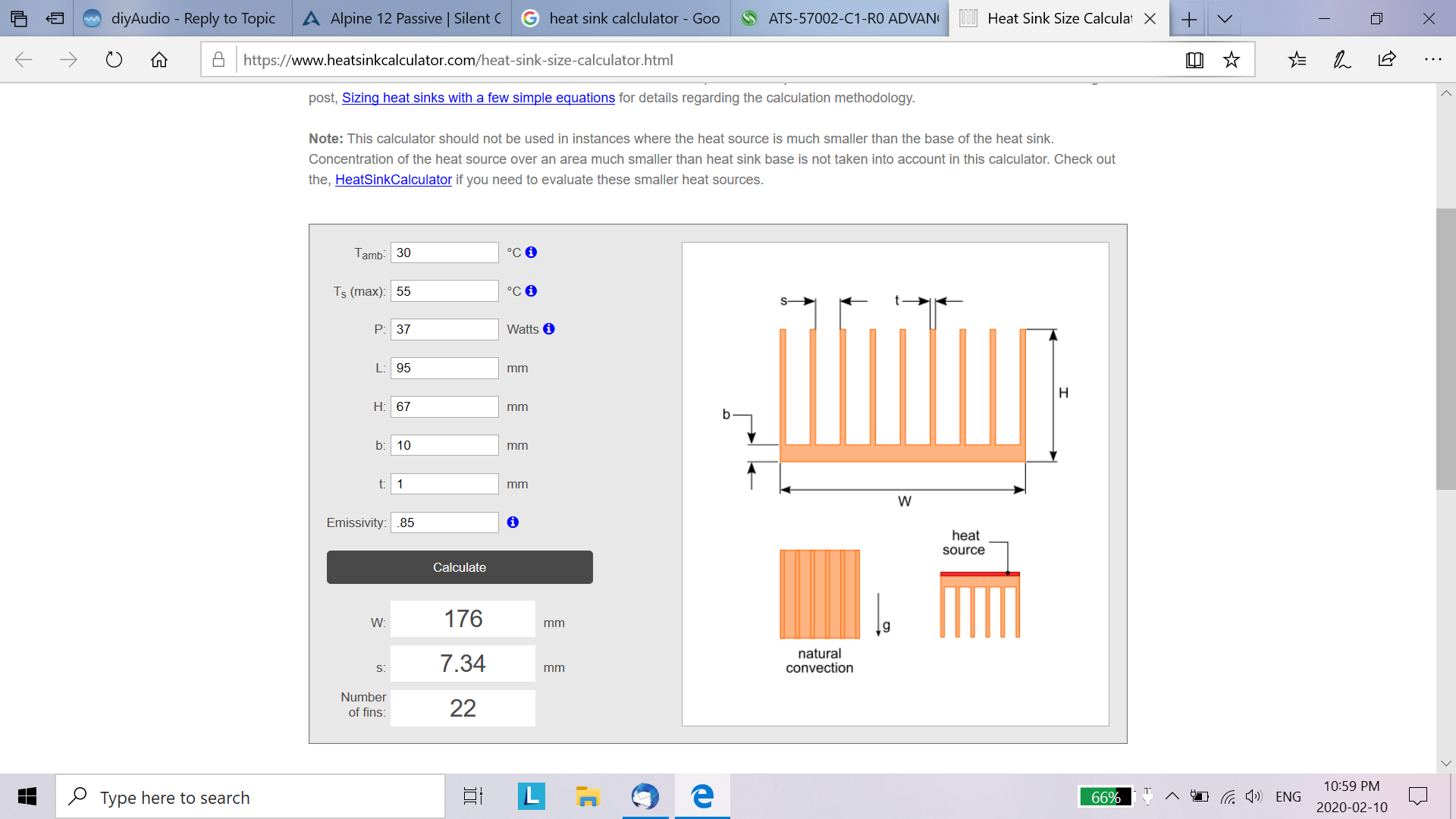

Here is something I found:
Heat Sink Size Calculator
The calculator is non-conservative in that it assumes the device being cooled covers the heat sink 100 percent, which is not the case with the mosfet.
I entered the information that I could find and estimated others, and it estimates a size of 95mm x 176mm, and also requires fin clear spacing of 7.34mm to facilitate air flow. The cpu cooler doesn't meet these dimensional requirements.
As you said, it was cheap.🙂

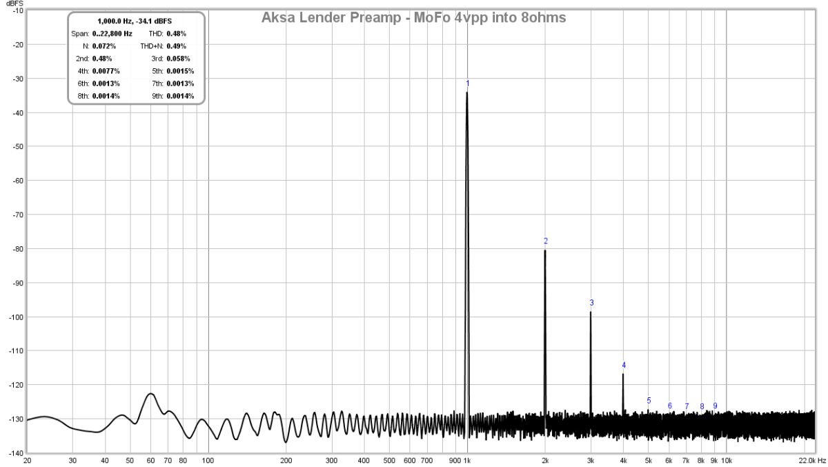

4Vpp into 8ohms:
646587d1511048208-build-mofo-aksa-lender-pre-mofo-4vpp-8ohms-fft-png
