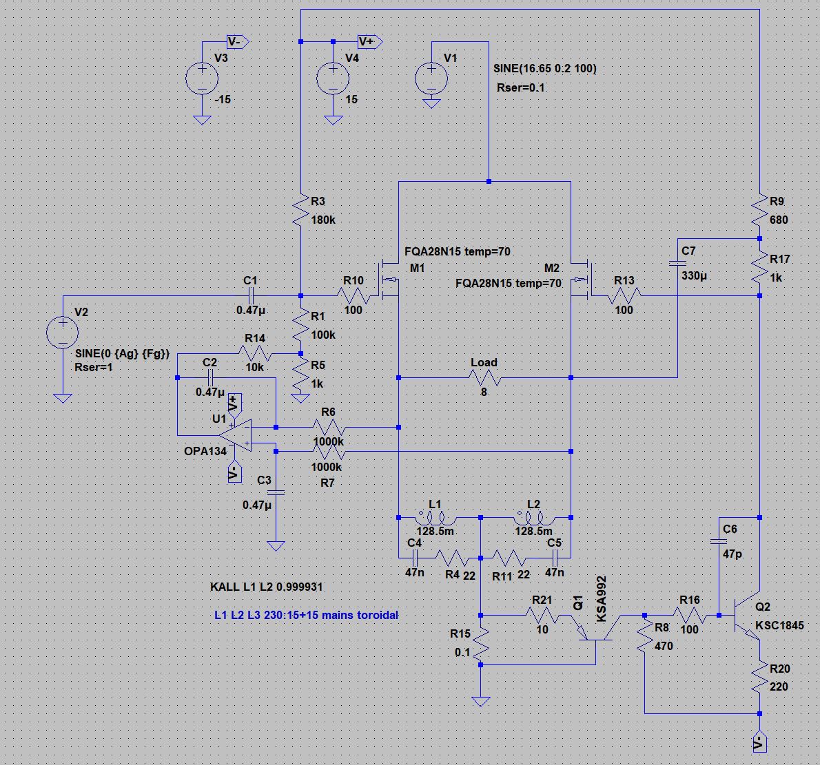

I have been thinking about a balanced version like that described by Ralph G, with the advantage of no output caps and being able to use the centre tapped secondary of a standard mains toroid for the inductors. But with a balanced version the distortion profile changes (even order harmonics tend to cancel) perhaps explaining Ralph G's comments above. I plan to try the following circuit. A CCS at the bottom (Q1) tries to keep the combined current of the two halves constant. The input signal drives the left hand side and the CCS drives the right hand side via Q2 with the help of bootstrapping. The distortion profile remains the same as the non balanced version with no cancelling of even order harmonics. I've added an offset servo that works to keep zero differential voltage across the load.
Obviously this is a strictly class A amp. The simulation works well, but I haven't built it yet. I plan to breadboard it sometime over the next few months after I've finished my current project.

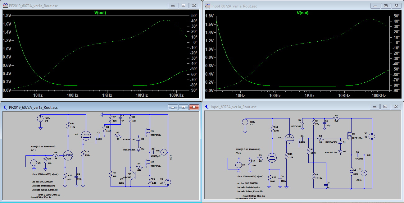

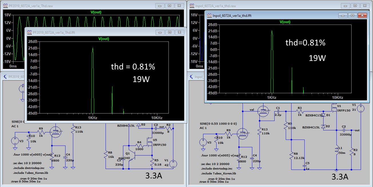

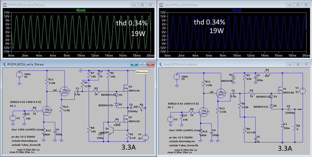

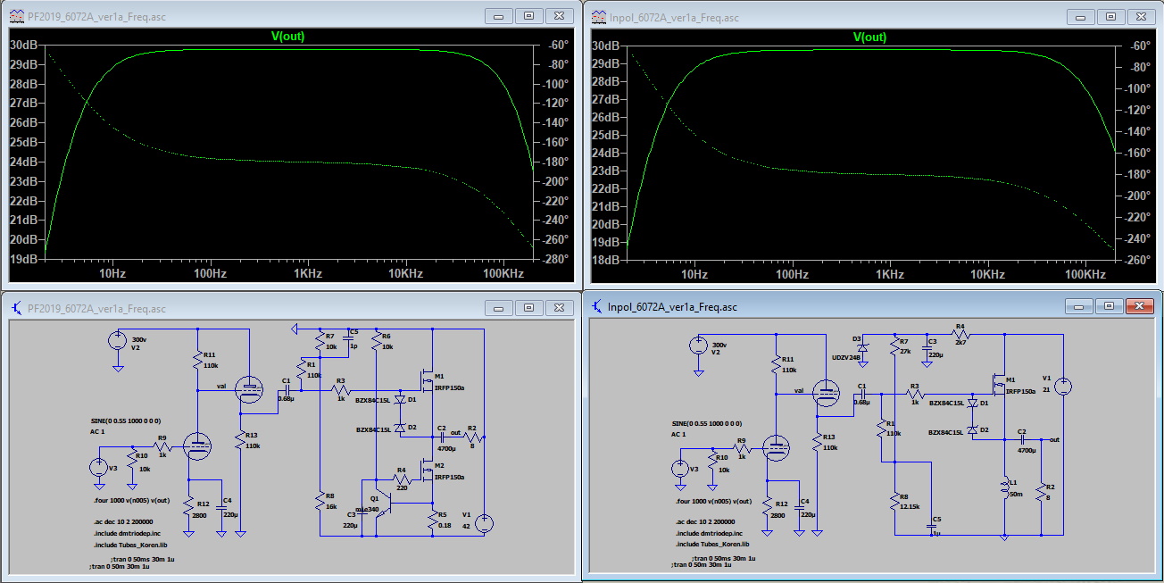

Here some simulations to compare my Power Follower to the MoFo / Inpol amplifier also using cheap choke with 50mH Rdc=0.7ohm.
The main problem could be the capacitance parasite of the inductance.
MoFo is very near to PF but more efficiency, half power supply voltage so less power to dissipate.

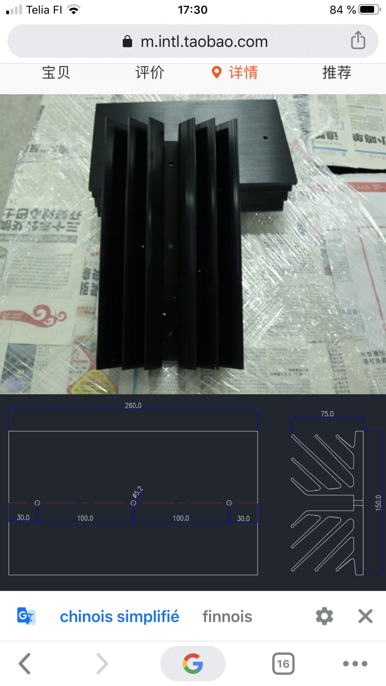

Not really thinking much, I built my MoFo monoblocks with a 'wide' heatsink having what should have been plenty of thermal dissipation on paper, but since then my MoFos have stopped working twice. I built original MoFos, biased at 1A. I don't have an IR thermometer, so I don't know exactly what temperature they were at, but I am suspecting that the heat doesn't travel 'middle-to-sides' nearly as well as 'bottom-to-top'.
For my next MoFo , I will be looking to get sinks more like what you show, with a significant 'chimney effect'.
Having said that, it's possible my MoFos are failing for a completely different reason; perhaps the no-name power bricks I am now looking to replace.
