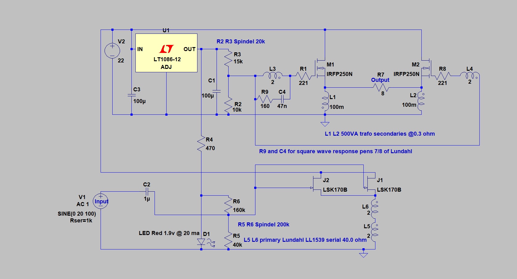

Maybe I'm hijacking this tread a bit. But I'm looking for some advice. Two years ago I've build a 159ZC based MoFo. Running with some big IXYS part @ 2.2 amps. This has been my daily amplifier (my bloody expensive KT88 triode amp has moved to the basement). 😀
Of course I always want to "improve" things. And as mentioned several times in this tread (also by me): balancing seems a nice way to dump the output capacitors (pages 38 and 201 have some discussions on this).
A few months ago I found a "crashed" DIY amp. It had some huge heatsinks, 12 OPA627's, 12 FQA48N20's, 7 toroids and a lot of other stuff. All for 50 bucks. 2 of these toroids restarted my balanced MoFo quest. A few weeks later I found 6 nice Lundahl transfomers, including 2 LL1539 (these are big, high DBU transfomers).
The components used for my new amp are: FQA48N20 as Mosfet. 2SK170 as input Jfets (I have quit a lot of these). The mentioned LL1539 are used as input transformers. And the output "chokes" are the salvaged 500 VA toroids (2 *40 VAC output used as choke). The resistance is around 0.15 ohm per secondary. And I'm running it at 1 amp per Mosfet (but you can run close to zero amps: this coupled choke runs nicely Class B). Max output is currently around 25 Watts at 8 ohm and 35 at 4 ohm (and even a bit more at 2 ohm). Output impedance (measured) is depending on the idle current. With the 1 amp it is around 0.7 ohm. The Mosfets are matched, so no need for a DC balancing (one channel has a DC offset of 7 mv, the other channel 2 mv). 😎
The 2SK170's are running at their IDSS. In this case 22 ma for the pair. This 22 ma is also the limit of these Lundahls: they are not intended to be used with DC current: running more of these Jfets in parallel will generate distortion because of saturation. And running these Lundahls with less current will limit the low frequency response (the LL1539 needs a low impedance). I tried using the primaries in parallel, but then you need even more current.
After thinking, simulating, building, thinking, simulating and building, I came up with this amp. This version is working nicely. The bass is really good. More pressure compared to the original MoFo (lower damping or higher current?). The soundstage is big and there is absolutely no fatigue.
But: the original MoFo has a better "imaging". Every instrument has air around it. This is a really, really nice feature of this amp. Addicting. And there is more sparkle. I cannot measure this (the balanced version goes also really high). But the original MoFo is a bit brighter.
My "new and improved" balanced MoFo doesn't do this. At least: not that good. Yes, it has more bass. And it is a bit less fatiguing (might be caused by the brightness) . But I really miss this pin point accuracy. Once you have heard this absolute 3D imaging, you miss it when it is gone.
What could be the reason for this? And is there a solution? The 2SK170 are original and used as intended (I know they can swing up to 44 volts, but they survive). The output choke is of course not a real choke, but I wouldn't expect difference in the 3D imaging (only in bass). So my guess is: the Lundahls are the limiting factor. They are not the most expensive ones (not cheap either). Would replacing them with higher grade transformers help? I don't know what sound difference there is between transformer grades.
I like my current Tube 6N6P SRPP preamp. Not balanced. But I don't intend to change this one. I can also try to replace the Lundahl with some other phase splitter, but this splitter must be able to handle a lot of voltage (without influencing the quality).
Does anyone have some advice (or opinions)? 😕

at first half of first morning coffee , so not even forst of my two brain cells is awake ....
anyway , check Zeus amp thread(s) , Susan Parker's
if you want to alter THD spectra (slightly) consider shunting (slightly) one of modulating secondaries..... simply resistor in parallel
It is a lot of text. So coffee might be needed.
My Title says "Balanced MoFo Zeus like". I think I know Susan Parkers website by heard..... Although my version is not copy-paste. She uses the output toroids also as transformer (so both primary and secondary). And she uses a small toroid as input transformer (for her Toroid version at least).
Interesting remark btw: you think that this "pin-point-accuracy" might have something to do with the THD spectrum? Didn't think of that. I'm shunting one of the secondaries already with a RC combination for a decent square wave response. Without this you will get a big overshoot. And shunting both secondaries will make it worse, in stead of better. I first listened to the amp without this RC, and it sounded a bit "sharp" (don't know if this is correct English). But the original fine tuning was done mono.
