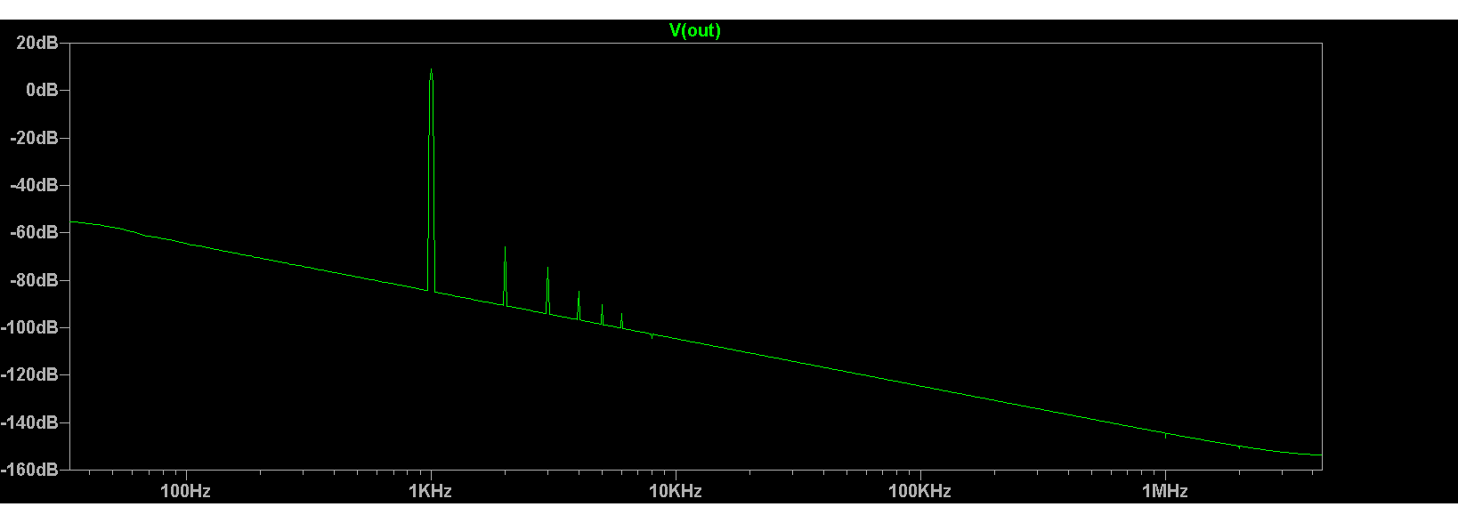

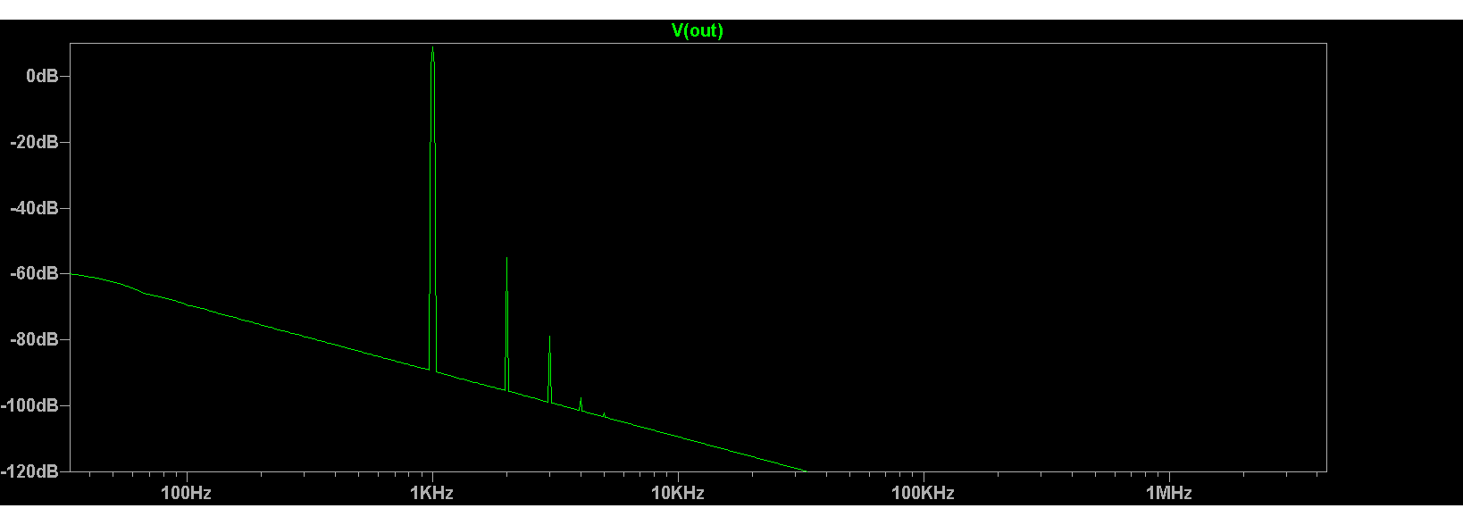

Playing with a spice Mofo model.With a 50k resistor between mosfet drain and gate gives a nice even staircase of decreasing harmonics about 10db per decade.A regular Mofo spice model does not have as even a distribution.Anyone have any comments?
Plain Mofo left window,Mofo with 50k right window.Playing with a spice Mofo model.With a 50k resistor between mosfet drain and gate gives a nice even staircase of decreasing harmonics about 10db per decade.A regular Mofo spice model does not have as even a distribution.Anyone have any comments?

If I recall correctly, Nelson Pass' writings indicated that "some 2nd harmonic was pleasing", but that higher order harmonics were not so much so. The article "Build a Class-A Amplifier" ( Audio, February 1977) claims the resulting amp has second- and third-order harmonics, but that higher order were undetectable.
If this is true, why would one want to encourage higher-order harmonics?
Even more importantly, will my old ears actually hear the difference? I guess I won't know without building it.

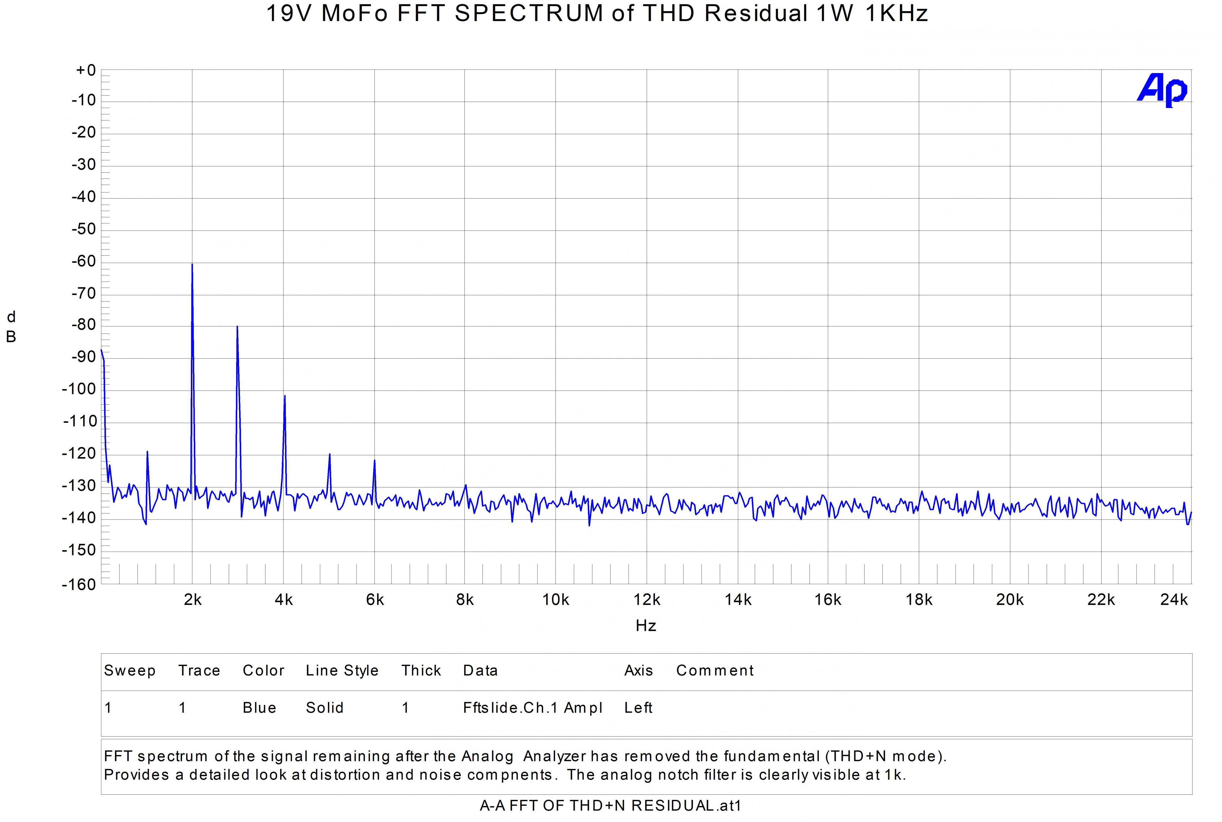

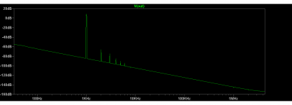

Here's the real word spectrum of a 19V channel:
The real deal,20db per decade.Thanks for the info!

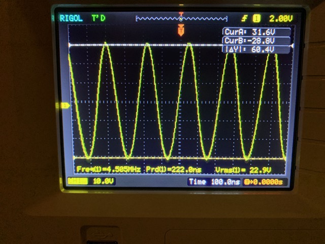

Built up a quick MoFo, seemed to work well, was reacting properly in the DC realm, listened to it for a while, VERY nice. With scope on it while looking for PSU noises found that it was oscillating quite nicely at 4.5 Mhz. (Scope shot is from inputs shorted!) Eventually this smoked a gatestopper and made the listening room smell bad... 🙄

besides increasing gate stopper slightly , you can try putting some tiny bugger cap from G to D
start with 100p , end when you cure it , check highs
or , before everything else , you can shunt bias pot wiper to gnd , say with 1uF solid
