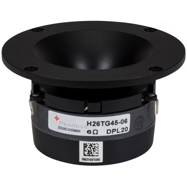

Not yelling, I don't know why the picture is huge. I'm OK either way if anyone can get the wave-guide. How costly are they? How much work to cut the box for one? The look of the speaker may be important. If we find more than three people who want to build it, we can maybe ask. This tweeter is not pretty, but I have a pair. Limited use so far. I believe Wolf_teeth has heard these before, and could comment on performance. I've mostly just used one in a center channel, but I plan to build some mains with them.
I would cross them at 3k for this project, but currently they are crossed at 2k in my center channel.
I think a wave-guide tweeter is a viable option if it comes that way from the manufacturer. It may even be necessary if you are trying to make a a high efficiency three way.
I wouldn't mind a waveguide tweeter either. SB26STWGC, Morel CAT328 or the H26TG are good options for me. If I had to I would do a 3D printed WG. The 3D printed WG I purchased for a GRS PT6822 was not aesthetically to my liking (rough). Just my preference, not a game stopper.
I like Morels! Never tried that one, but I think it would be awesome.
The H26 measures really well, and is pretty sensitive.
I might add, I have the Dayton ND25FW waveguide tweeter for a two way project. I don't think it is up to monkey box standards as distortion goes up near 100dB. Nice for the price though ($13).
