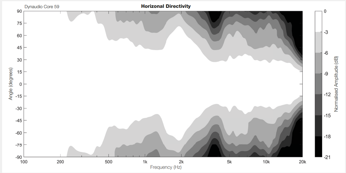

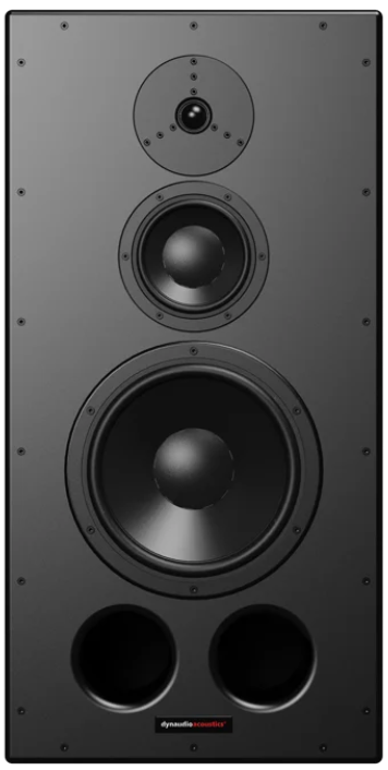

I'm not surprised that some speakers with variable directivity can still sound very pleasant. IMHO this is part of the circle of confusion that still continues. There's just no ITU or IEC standard for directivity in studio monitors or main monitors. Today you can buy big expensive* Dynaudio (or Yamaha) monitors for your big (or project) studio that doesn't not conform to any directivity standard.

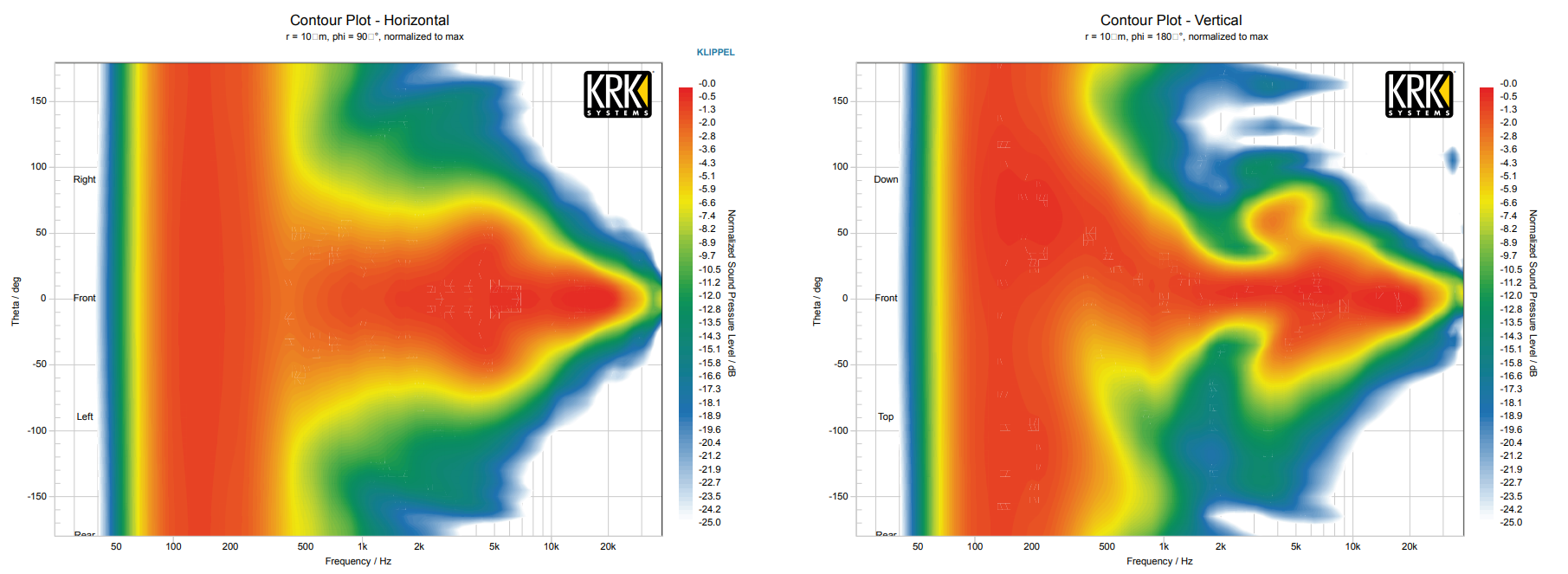

Meanwhile you can get more information on directivity from KRK than ATC.

* M series C3 Mk2

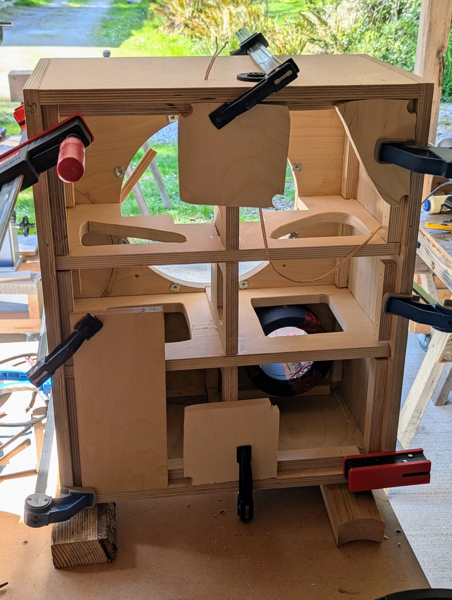

In post #1,162 I mention potential cabinet size* - A little bigger that the JBL L100 at 27 (H) x 16.5 (W) x 15 (D) provides 3.0cf gross and 2.70 cf after midrange enclosure and bracing. But there is uncertainty about the T/S parameters of the Peerless 830669 so I'm not going to finalize the size and build a cabinet until I actually have a pair in hand. And THAT is the current hold up.
* I do plan on updating the first post with design goals and links to some of the decision points, but I'm just way behind on some other stuff.
One thing I want to make progress on after May 10th, even if the Peerless woofers aren't available yet, is the midrange enclosure (I'll take T/S measurements and post them) and bracing strategy.
And also, a discussion on whether to offset the tweeter and midrange. I think with the wide baffle, we pretty much have too, but I'd like to have a discussion of the pros and cons as I think that would be useful in general and not specific to this project.

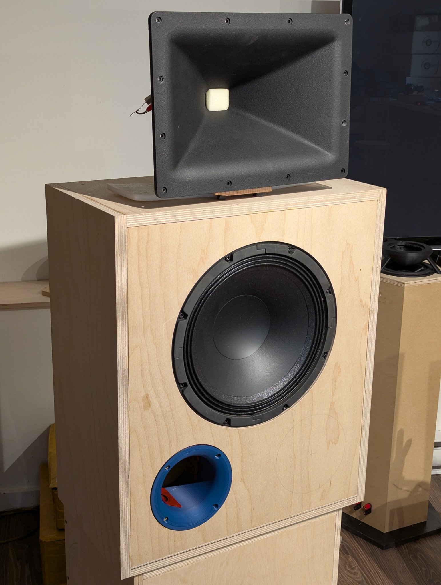

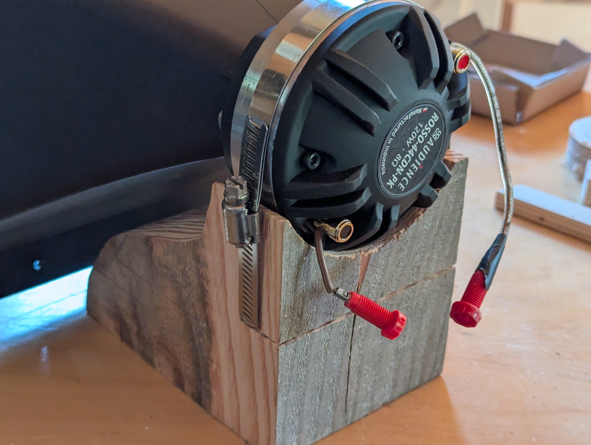

FWIW, I just completed a 2-way "budget" monkey-box shaped/inspired system for a local project. This discussion was helpful to sort out & eliminate various options. (But if this post seems too OT, I'm sure mods will sort it out...)
My need was for 40~20kHz JBL-ish speakers with neutral voicing that could play quite loudly, adaptable to different rooms/settings, and not expensive.
I opted for 2-way with miniDSP for the DSP/PEQ flexibility & SB Audience pro drivers, including ROSSO-44CDN-PK CD with 600Hz B52 PHRN 10x14" 90x60 horns (long discontinued, AFAIK). Total driver parts retailed just under CA$1000. CA$370 for 2x4HD, $140 for a 4x8 sheet of 3/4" Chinese BB (quite nice). So altogether ~CA$1500 + taxes.
Early days yet, measurements not sorted out or completed...

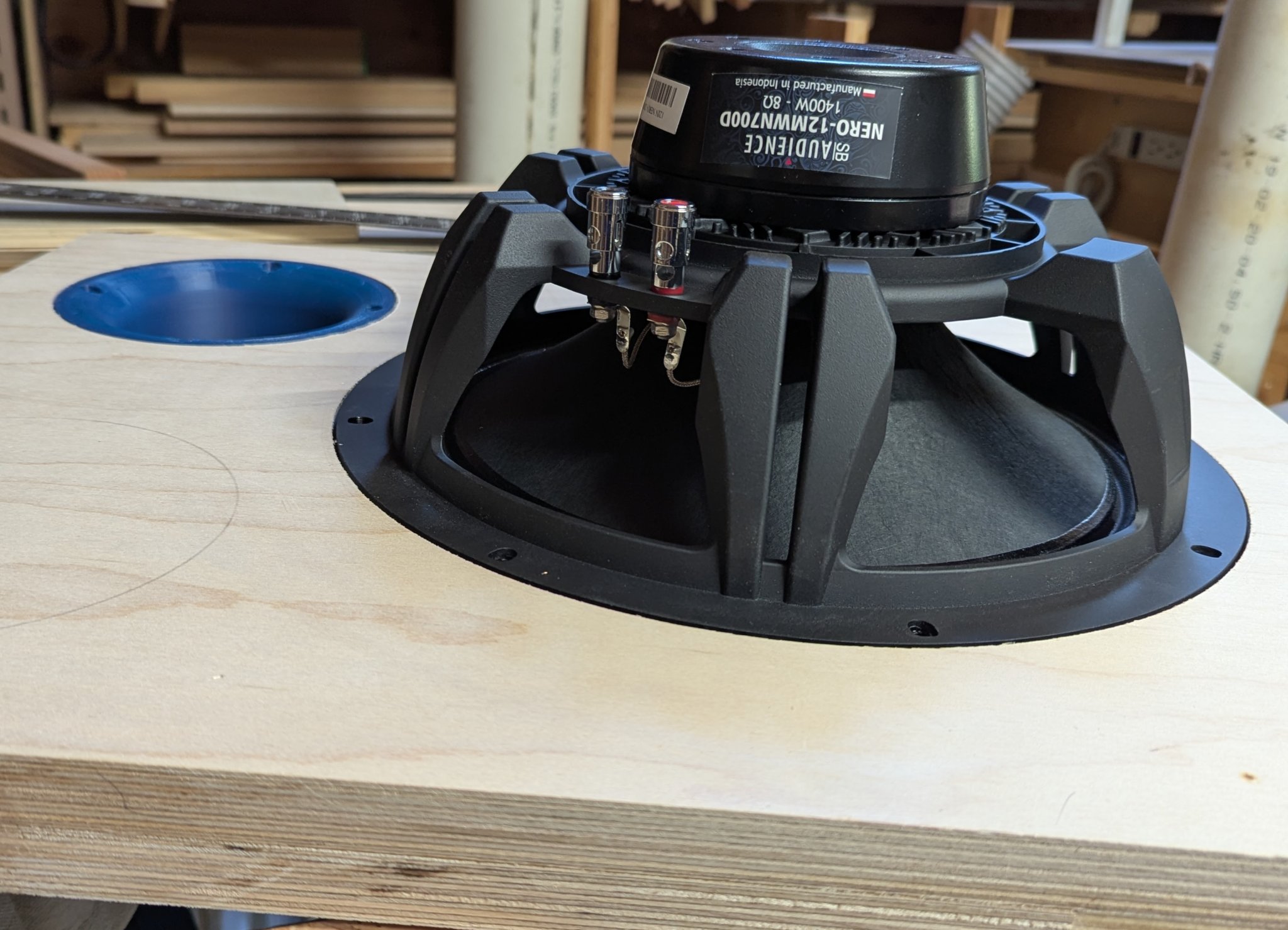

SB Audience Nero-12MWN700D 12" mid-bass driver was originally going to go in a 1.6 cf box, but the WinISD sims looked better in a 2cf (60 liter) 44Hz port box, and the end users liked the bigger baffle face, so... I can report this Nero woofer has good bass extension & snap down to just below 40Hz and smooth response up to just past 1khz. With +10 dB shelf at 80hz, Q=1, I didn't expect the quality of bass I'm getting. Steep LR8 filter at 30Hz to stop any low frequency overload with the modest 7.3mm Xmax -- tho damage doesn't hit till 18mm. With 150W/ch class-D, the speakers play very loudly without complaint; doesn't mind the bass boost at all. I'm crossing at 800Hz where the woofer directivity is barely narrowing. The horn/CD has no trouble down to 800Hz, no audible increase in distortion/harshness to well over 100 dB SPL. (Mind you, it's 109 dB/W sensitivity, and there's an L-pad to drop it down ~12 dB)
Thumbs up in an audition with end users yesterday. Even my wife says they sounds good. 😎
I'm pleased; they sound better than I expected them to.
There's a move afoot to apply JBL blue to the baffle + clearcoat the rest.
