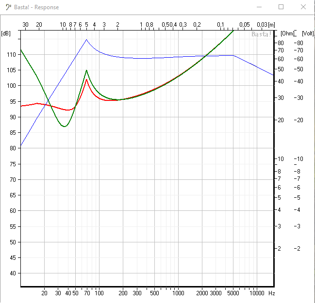

This is the 830669 in 2,2cft with the specs from the Peerless website. Black is ordinary 2nd order, red is with 940uF (2x470uF) in series with the woofer. I accounted for a slight series resistance.
What can be observed is that the -3dB point shifts downwards about 5Hz and the 1,5dB hump of the rather highish Qtc goes down to reference level. Not that spectacular, but not totally irrelevant either.
Next to a bit of low extension, an effective subsonic protection can be had. Red curve is normal box, green is with series cap. While it dips a bit in the 30Hz region (only one and some dBV), you gain a lot in subsonic region. Plus, hefty bonus coming: you gain effective DC-protection of the woofer. As we all know, parties come with amps burning and deceasing. Et voilà, no woofer breakdown on amp failure.
Just my 2 ct. Oh yeah, blue curve is max SPL half space at 1m, driver operating in linear region. Not bad for the money.

High pass filtering a bass driver works quite well and can make a problematic construction sound deeper and tighter. There is no audible disadvantage compared to a "regular" closed box, the lowered response is followed by a steep decline, protecting the woofer cone from useless movement.
German speaker manufacturer HECO used it in their top of the line "DC" models. Invented was the principle from car audio installers that had limited volume and still wanted deep bass.
There is one catch: Simulating the capacitor value only gives you a first idea of the value needed. The capacitor size you really need should be adjusted by measuring the finished speaker for its response. Otherwise you will not find the best bass extention. Usually your simulation will be +-200uF off.
Next, large caps around 1000uF get expensive if you use overpriced audio grade stuff. You can instead use two identical polar electrolytics in series, connecting both positive ends and get a bipolar cap of half the capacity and the same peak voltage. So two 1000uF 50V caps give one bipolar 5000uF of 50V peak.
It is good practice to use some film foil caps to bypass the electrolytic, in parallel the ad to the resulting capacity.
Last, you can not get this effect in the same way from equalizing. The capacitor enabeles the driver to draw more current below the resonance frequency. Quite a complex process. Equalizing needs to push it with higher voltage the amp may not have.

Very true. But two bipolar electrolytes 63V DC, which is more than enough, considering this woofer that will run out of juice at about 35V AC, won't set you back that much, about € 16. No need for bypasses, you just take the ESR into account of the crossover (and we're talking about 'woofers' here eh?).Next, large caps around 1000uF get expensive if you use overpriced audio grade stuff.

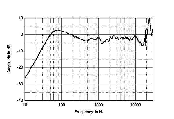

https://www.stereophile.com/content/klh-model-five-loudspeaker-measurements
2000/pair in USA 2021 woofer is 10" sealed box
Rising bass in nearfield tells that baffle step compensation is applied

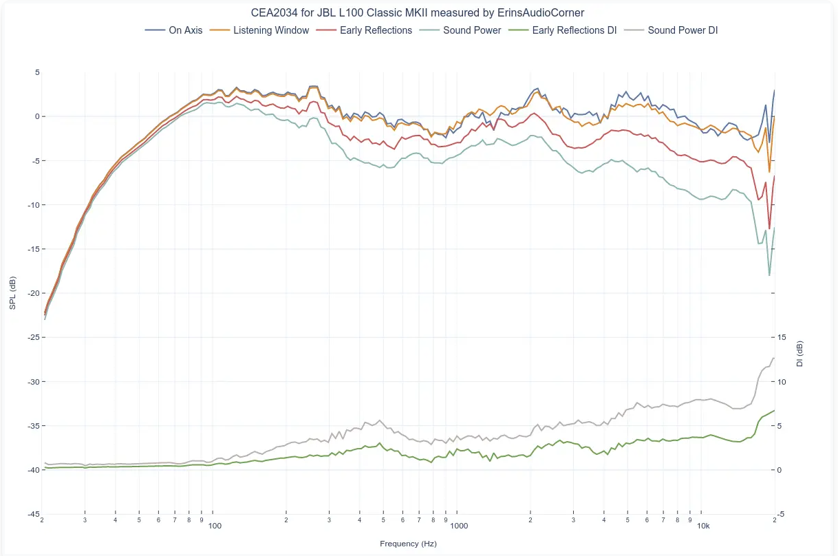

@bikinpunk 's measurement of the L100 Classic MKII taken from his Near Field Scanner has been uploaded to spinorama.org
TLDR?
JBL specs- Sensitivity 90 dB, Impedance 4 Ohm, Size Width 399mm, Height 636mm, Depth 371mm, Weight 26.7kg (59lbs)
Measured as-
TLDR?
Measured as-
- Sensitivity: 90.7dB (avg. 100Hz-1kHz for 2.83V measured at 1m).
- -3dB (-6db) point is at 50.5Hz (38.8Hz)
- Horizontal directivity for +/-6dB is (-60.0°, 50.0°) between 1kHz and 10kHz.
- Vertical directivity for +/-6dBis (-10.0°, 30.0°) between 1kHz and 10kHz.
- Tonality (Preference) Score is 4.81 and would be 6.76 with a perfect subwoofer
