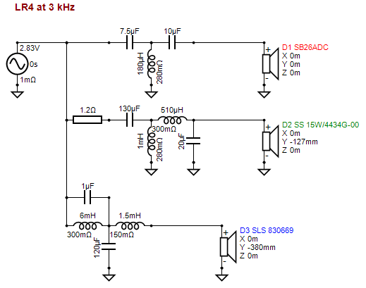

Here is a simulation with actual tweeter and midrange measurements but traced woofer. This is about as simple a xo as possible, in about 30 minutes. LR4 at 3 kHz. I would think when we get to rigorous xo design, matching the midrange and tweeter (without a waveguide) is not going to be a significant constraint on getting a good sounding and good measuring speaker.

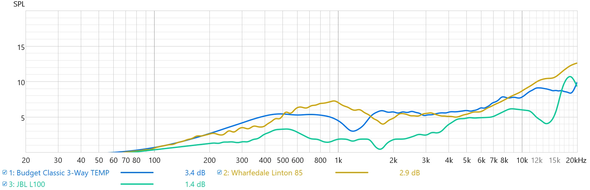

To put that into comparison to the Wharfedale Linton 85 (8 inch woofer, no waveguide on tweeter) and JBL L100 (12 inch woofer, waveguided tweeter), both of which are reported to sound good...
I don't know at this point, I am not familiar with the details of the JBL.

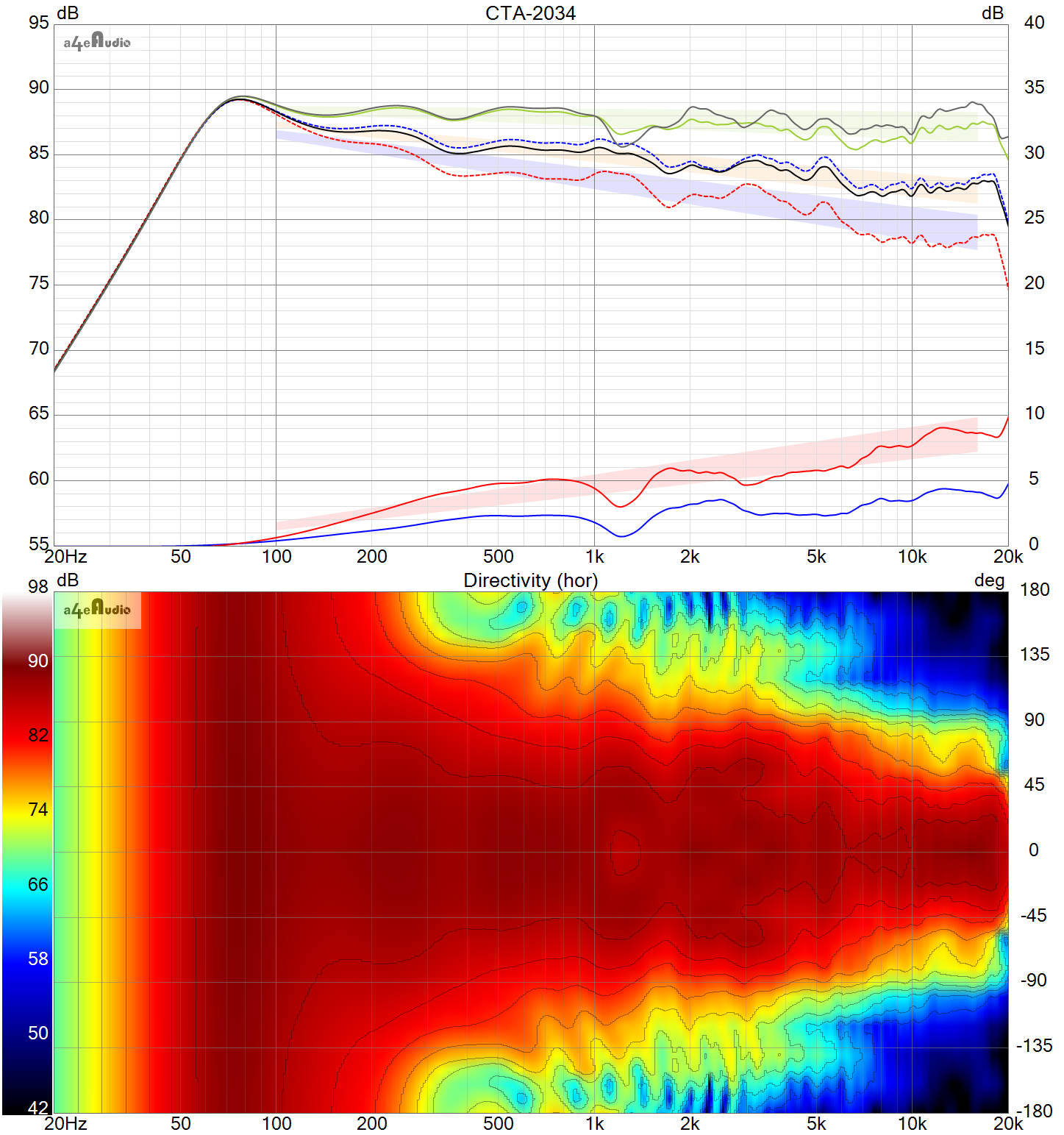

I just wanted to make the point that getting "good enough" directivity doesn't seem like it will be particularly difficult, even without a waveguided tweeter. Note for the Project DI, (1) everything below 400Hz or so is inaccurate as it is just simulated in VituixCAD, and (2) the dip at 1.4 kHz is from the baffle step diffraction (more clearly seen in the SPL graph of post #1,142) and we can alleviate that by offsetting the midrange (if we want and further xo tweaks. I also used LR4 crossovers for simplicity but I am sure we will explore different topologies ) and different xo details.
I actually find the comparison to the Wharfedale Linton more interesting. There is a clear directivity mismatch between 1 kHz and 2 kHz that people who pay a lot of attention to DI like to point out, and would claim that this speaker must sound bad (even though they have never heard it). Yet this speaker is widely accepted to sound very good.
