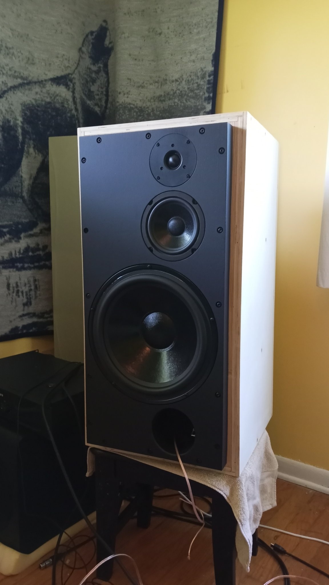

Here are mine
Woofer Faital12PR300
Mid Faital M5N8
Tweeter Beyma CP 21f
Crossover 2nd order
After 9 iterations they sound very well, particullary when used with tube amps.
