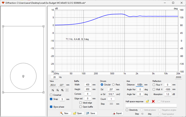

Peerless Datasheet / Dibirama - blue ovl
Closed box 70L full stuffed
Qtc = 0.75, F3 = 48Hz / Qtc = 0.77, F3 = 45Hz (Dibirama)
Baffle 40x65, W coordinates 20, 16cm from bottom

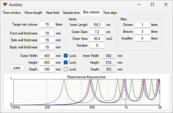

Box dimensions including 8L for mid enclosure, braces, etc.
