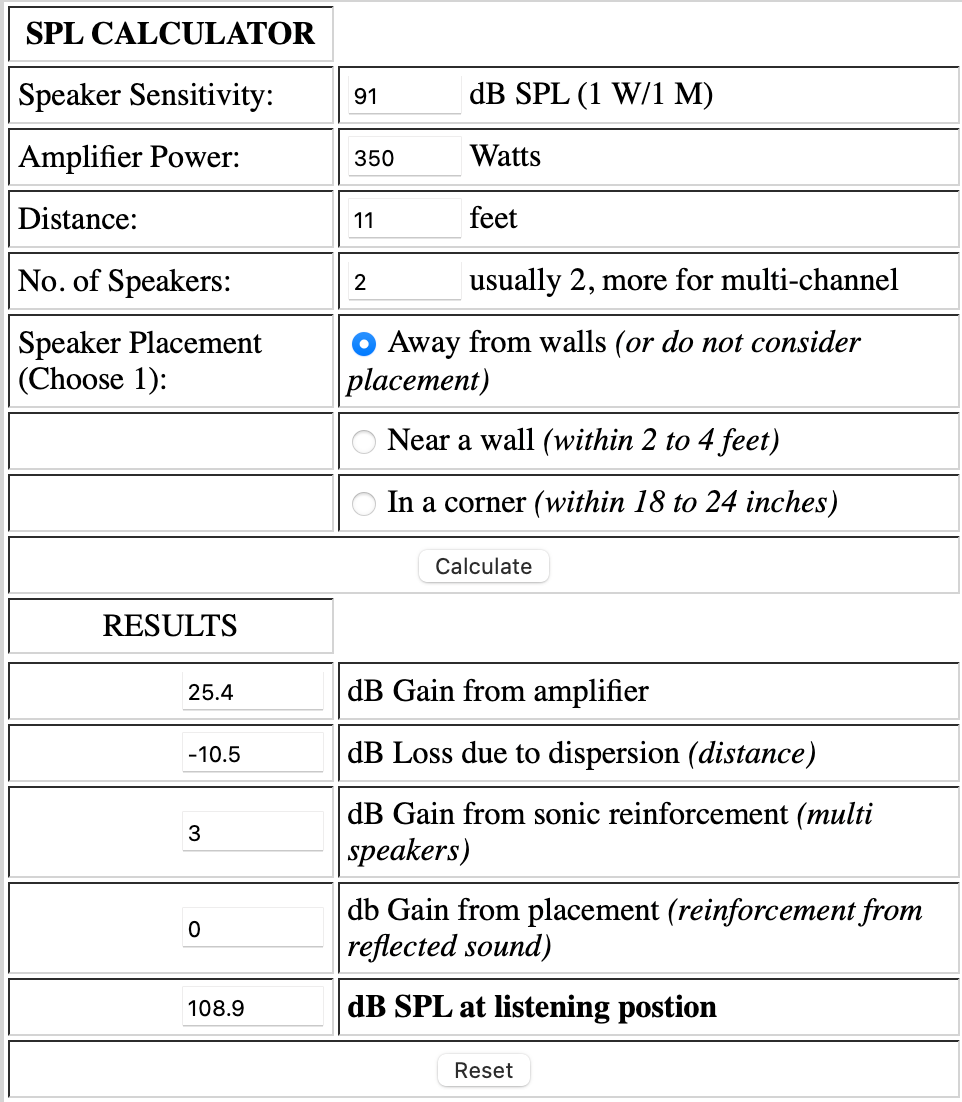

The question between 10” and 12”, BR or sealed could be answered by a question about SPL @ 40Hz and the Vd needed to get there, the room size and listening distance.
The difficulty then, without some experience, it's hard to calibrate. I mean, is 100dB enough? 105dB? 110dB? What is THX/Atmos reference levels and do I want that at home? etc.
When I designed my last 3 way, I was too focused ensuring my sensitivity, after baffle step compensation, was enough to match my midrange and tweeter.
But I did not pay enough attention to maximum SPL.
Big mistake. Only after I finished it, I realised it was far more capable than I would ever use. This made me go back and have a closer look to see where I had gone wrong:

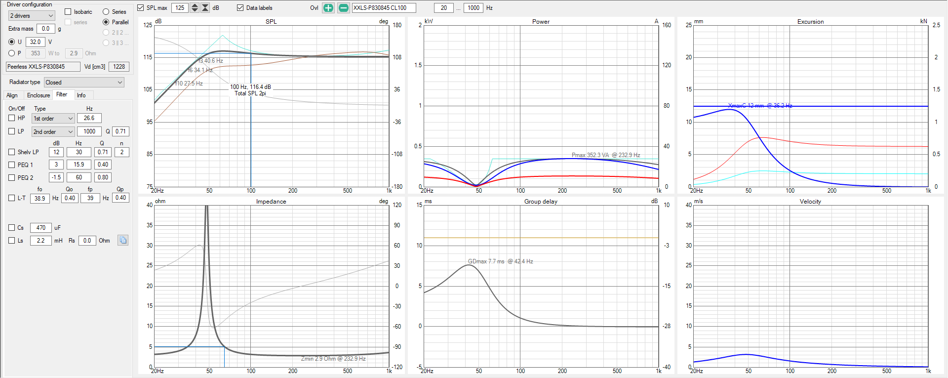

I used a pair of 12" P830845 XXLS in a sealed box of 100L, which, within x-max AND power handling^ >115 dB/m from 40Hz upwards.
Wait. What?
100 hours !with a continuous signal?
Reference: Power testing according to IEC 60268-5 is a 100 hour power testing with a continuous weight pink noise signal
This is a 2pi model, similar to what you'd get from winISD.
Simulation from VituixCAD2:
How does that equate to my room and listening position?
Of course I took out the SPL meter and verified it- yes, 109dB at my listening position may be nice to simulate nightclub levels, the 95% of the time I'm at 85-90dB. On the rare occasion at the family is absent and I want to listen loud, it's only 100dB.

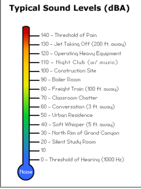

This is far more than necessary, and in the long term likely to hearing broad-band (all frequencies) hearing loss:
"OSHA allows 8 hours of exposure to 90 dBA but only 2 hours of exposure to 100 dBA sound levels. NIOSH would recommend limiting the 8 hour exposure to less than 85 dBA. At 100 dBA, NIOSH recommends less than 15 minutes of exposure per day."
This is real thing and in my field, is the number one cause of broad-band (all frequencies) hearing loss, and not just high frequencies (age-related)
