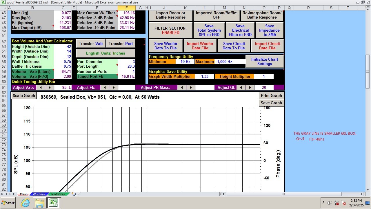

I think the 12" Peerless might be a good choice. Here's a sim at 50w input. Two box sizes are in the graph. Both are smaller than the absolute ideal, but any builder can increase the box size by adding depth. The f3 is between 43hz, and 48hz. Any size in between would fall between the two lines.1. 40-20,000 Hz +/- 3dB on axis.

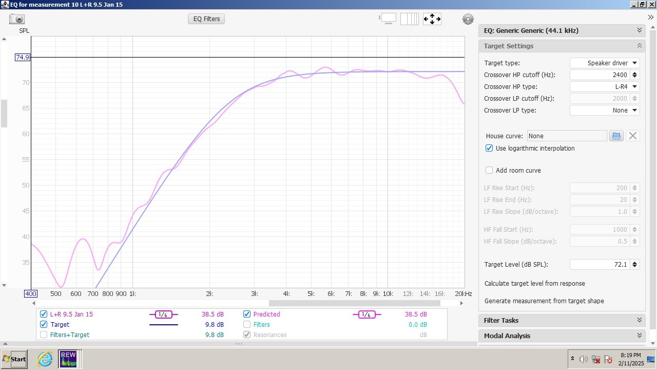

Quoting myself here. This is a screenshot of a tweeter measurement with a REW target overlay. Anyone could measure any tweeter on the same baffle, and filter it to a target. This tweeter could be matched to your mid, and someone else's woofer. So one person might use a $20 Dayton, and another might want a $100 Morel. Shouldn't matter, other than small diffraction differences.Frankenstein design option. (Semi crazy idea. )
This might work. I could for example mount a teeter, and mid on a 13" x 30" baffle, or wider, and actually make an 85dB filter with a 400hz high-pass for an 85dB speaker sensitivity.
Someone else could do something similar with a woofer.

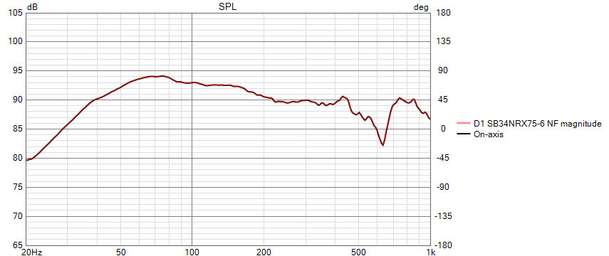

Here is the actual measured response in a 70 liter sealed box 14.5 x 14.5 x 30.5 inch (368 x 368 x 775 mm).
Near Field. The measurement becomes invalid above 430 Hz due to the size of the diaphragm. You can see the cancellation null between 500 - 700 Hz. This is not real, it is an artifact of the near field measurement process.

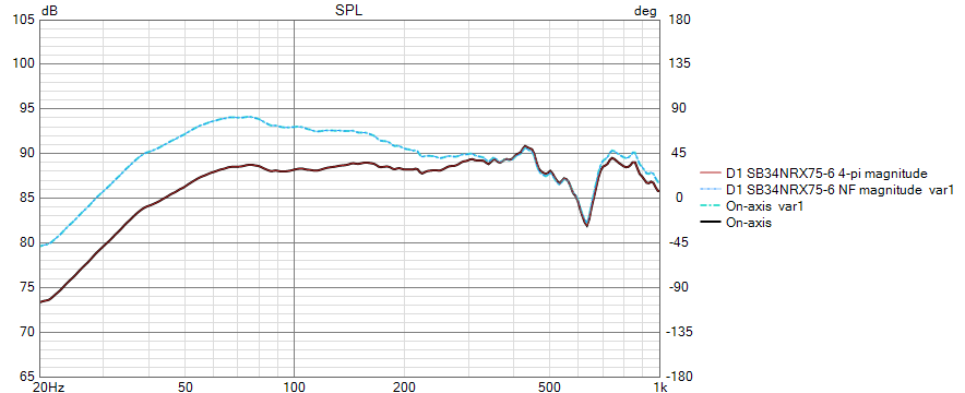

Here is the adjustment to 4-pi anechoic, using my baffle size/shape
One interesting thing about this driver is that it requires little or no baffle step correction.
