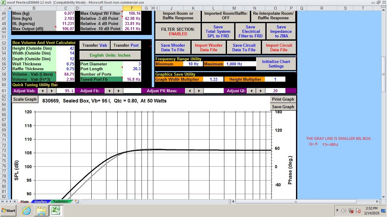

The Peerless is really only suitable for sealed, but another woofer might work ported in the same volume. It's easy to increase volume by increasing the depth. Here's sealed only, Gray line is smaller box.

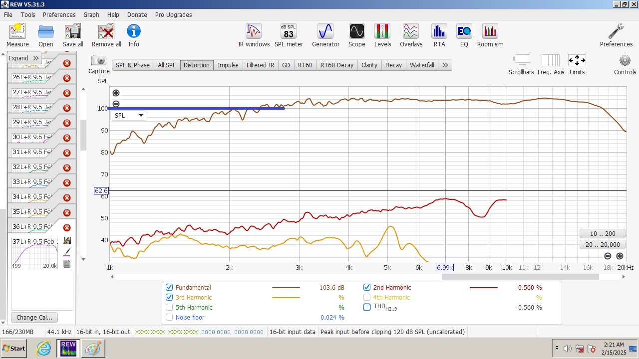

Here's the H26 for a comparison.I might add, I have the Dayton ND25FW waveguide tweeter for a two way project. I don't think it is up to monkey box standards as distortion goes up near 100dB. Nice for the price though ($13).

Vb = 95l?
Vb = 95l -- That is too big, imo. What's the smaller box size?See post #108.

Smaller box is 60L. There's a note on the right side. Box Q is .9 at that size.Vb = 95l?

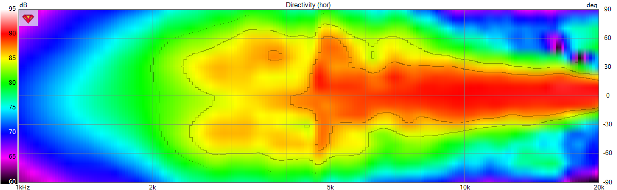

I discovered this in my small directivity study:
Here's the ring radiator XT25BG60 on a 8x10" baffle. Note smooth response above 7KHz.
There is a yellow bulge about 5KHz which I feel is a baffle effect (yet to verify). You should also see asymmetry, since in this cabinet the tweeter was offset 10mm from the centre line.
Here is the DX25BG60- the dome version of this tweeter, in the same cabinet, again with LR2 3KHz filter-

If you don’t want to use a waveguide, but want some directivity control, the Ring Radiators appear to have it in the top 2 octaves (exhibit A)
I wonder if this is one of the reasons for the OSMC's smooth even treble response- it also uses (Scan-Speak) Ring Radiator R2904/7000

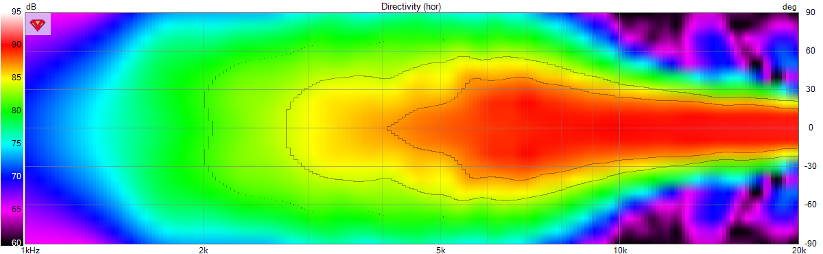

B)
Notice the bulge around 10KHz:

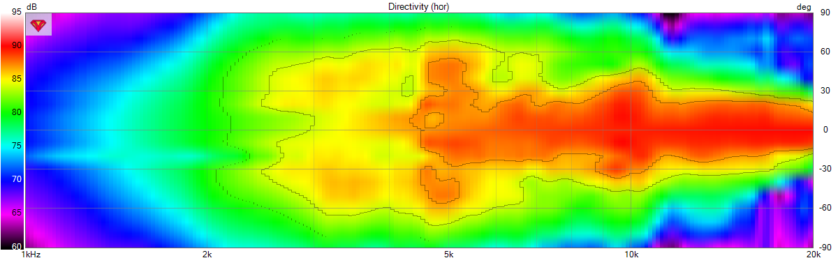

And finally- the XT25BG60 in a waveguide, the WG148R waveguide, filter for acoustic LR2 3KHz:

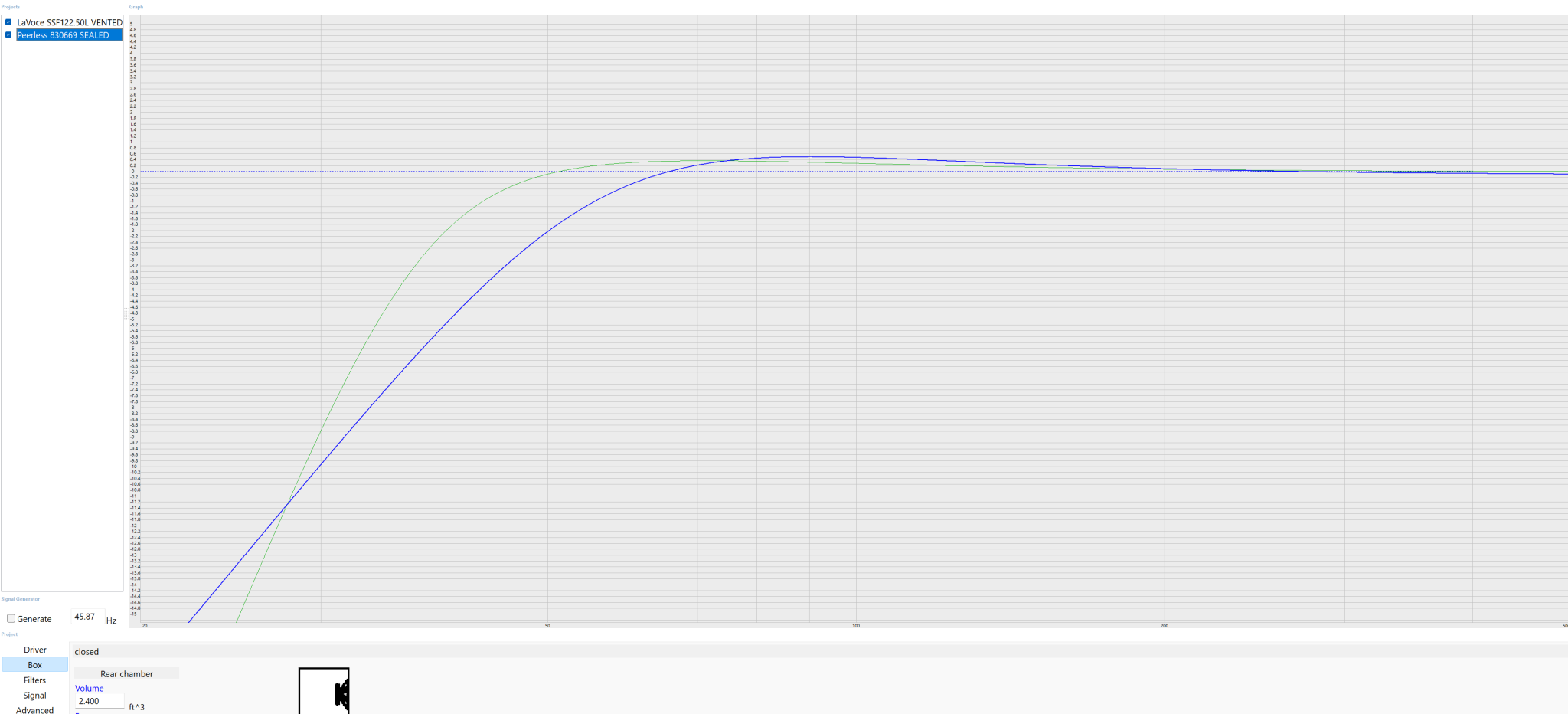

Here is the Peerless SLS 830669 SEALED and the LaVoce SSF122.50L VENTED both in the same 2.40cf (68L) box.
They would be fine in 2.0cf for what we are trying to achieve.
Peerless F3/F6/F10 = 46/38/30 Hz
LaVoce F3/F6/F10 = 38/33/29 Hz
Max SPL 110dB vs 117dB - which isn't' all that fair because the LaVoce can handle 4 times the power.
