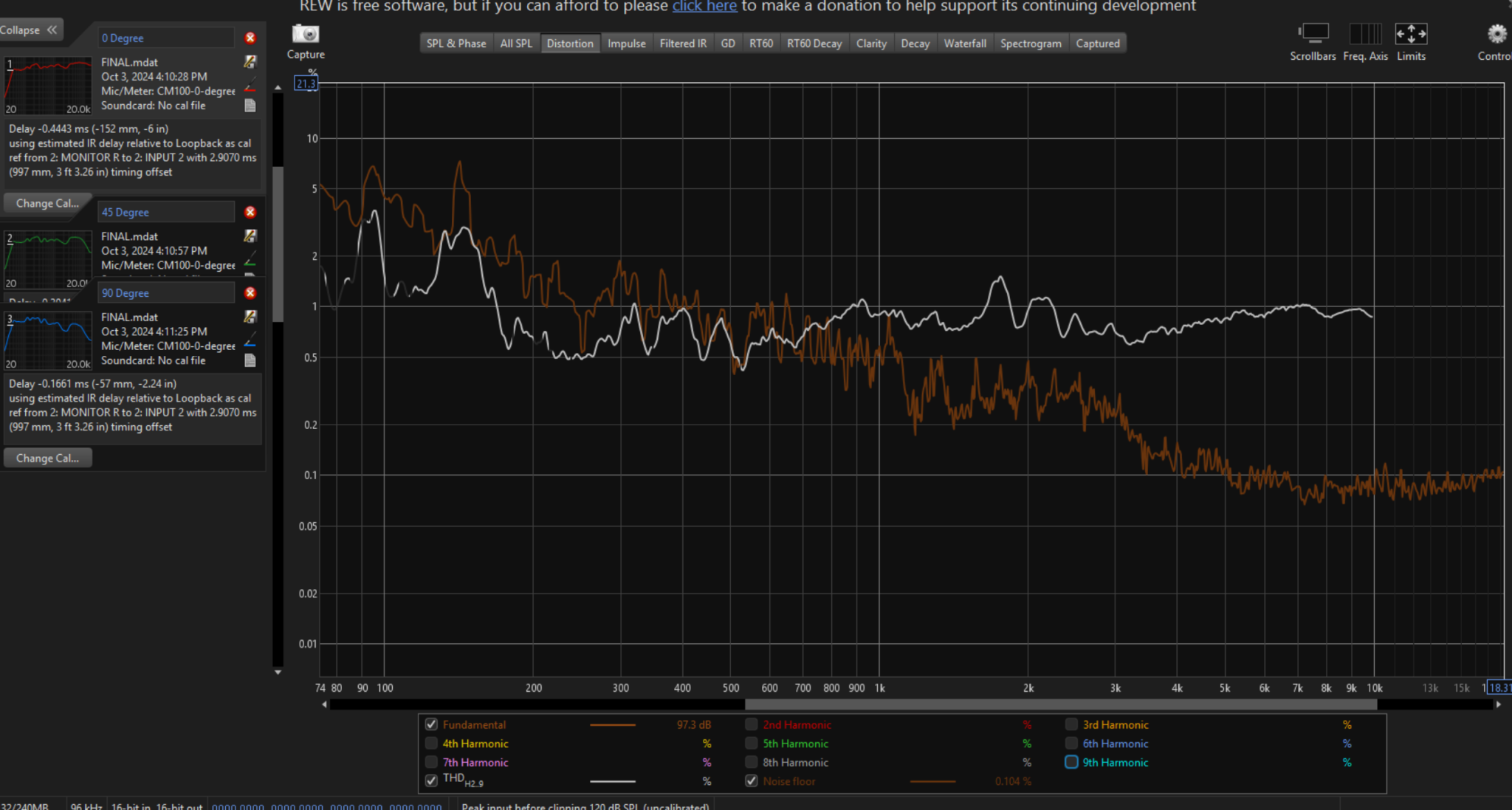

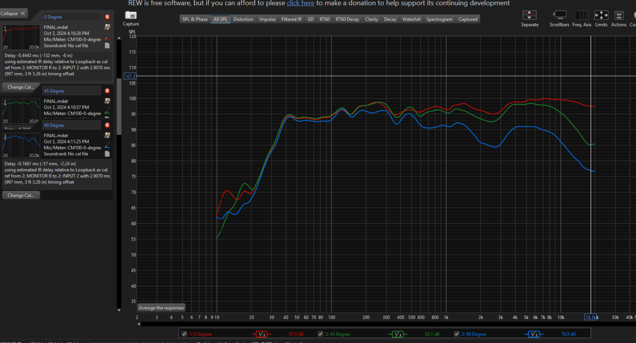

The cheapest thing I ever made was for the lake house. Not so simple series 2 way, second order XO. Silver Flute 6.5 and Peerless Tweeter DX20BF00-04
The entire thing cost me about $150. 90 DB sensitivity. Not a single resistor in the XO. I feel like you could make another version of this for very little extra if you used the silver flute 5.5 and some kind of GRS large diameter woofer.
I believe this answers your last question (I know it was a joke) of whether or not you can have a cheap 2 way cover the entire spectrum and play loud. And play off axis with very little drop off. Blue line there is 90 degree of axis.

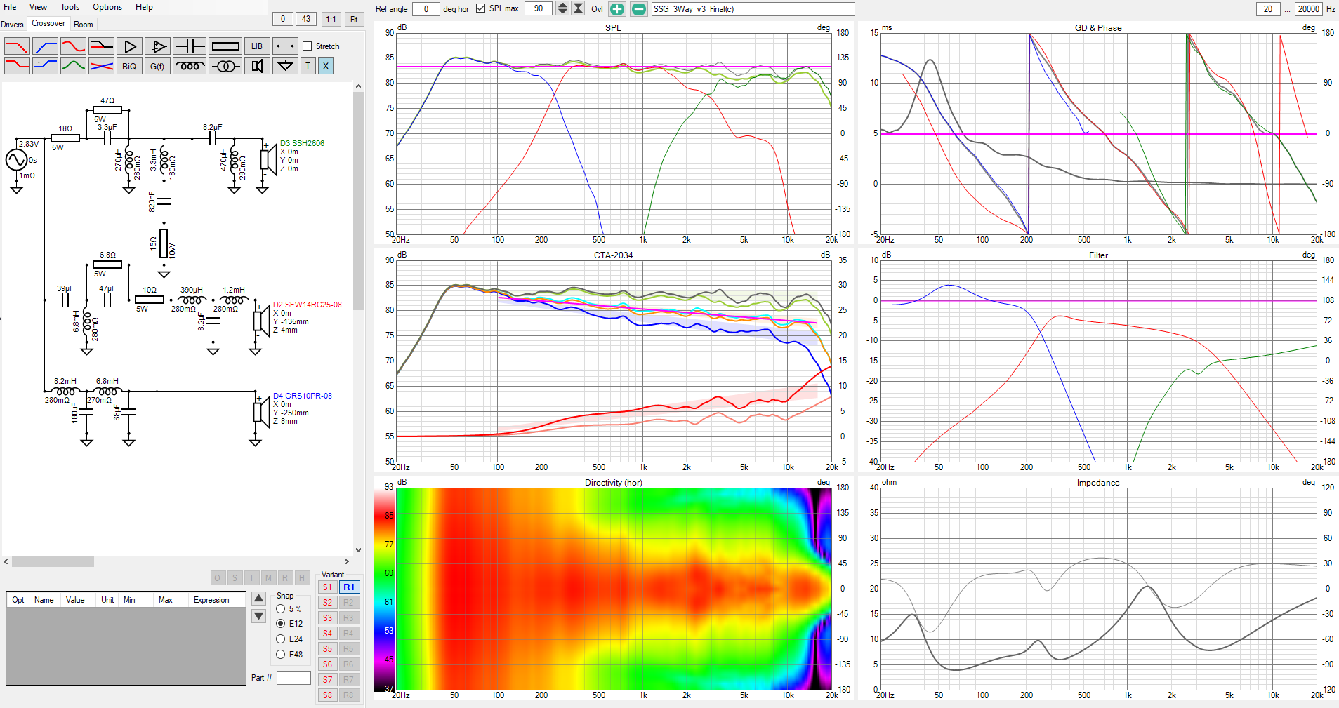

Give us some details. Driver costs? X-over cost? F3?This is an inexpensive, sealed, 42L, classic monkey coffin, speaker I've been contemplating. Unfortunately the crossover got away from me and ... well ... it stopped being inexpensive.
A classic monkey coffin is a big box, that is the definition of it, a big box with a big woofer on a wide baffle, a small mid and a dome tweeter. The classic monkey coffin, the JBL L100 is 39x37x64cm, that is about 71L netto with 18mm wood (the wood is thinner actually, so more volume) and 91.8L brutto. those are official specs.
That woofer is not suited, 3mm xmax means no bass on decent volume for such a woofer. And the qts is way to high to work in a box, this is suited for OB use and nothing else.
For me around 40Hz F3 is a reasonable goal, a good balance of sensitivity and bass extension. Size, I am open to options as long as it is smaller that the PAP open baffle I made some years ago (dual 15" woofers). That kinda dominated the room a bit.

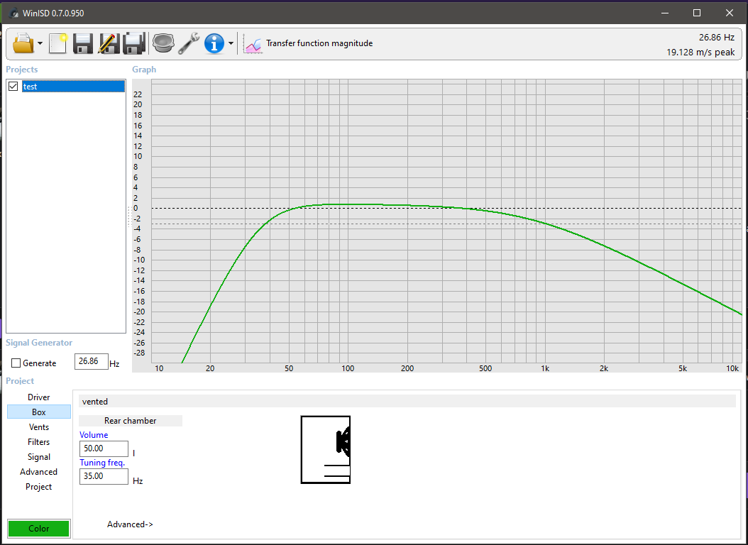

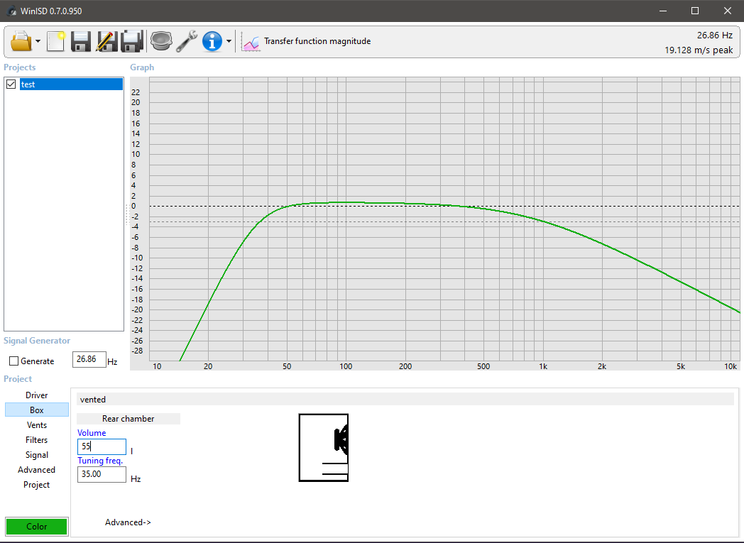

The Faital 10FE330 in a 55L cabinet sims like this.
So i guess (with chamber for mid and wood (18mm) and bracing and so) we end up with about 85L brutto cabinet, what could be arround 40x34x63cm (raw estimation). that is more or less the size of a classic monkey coffin speaker. You can cross it higher than this sim tells you in reality. I've heared this driver in a 2 way crossed at 1.3kHz also and it still worked well. Max volume is louder than you want in your house...
