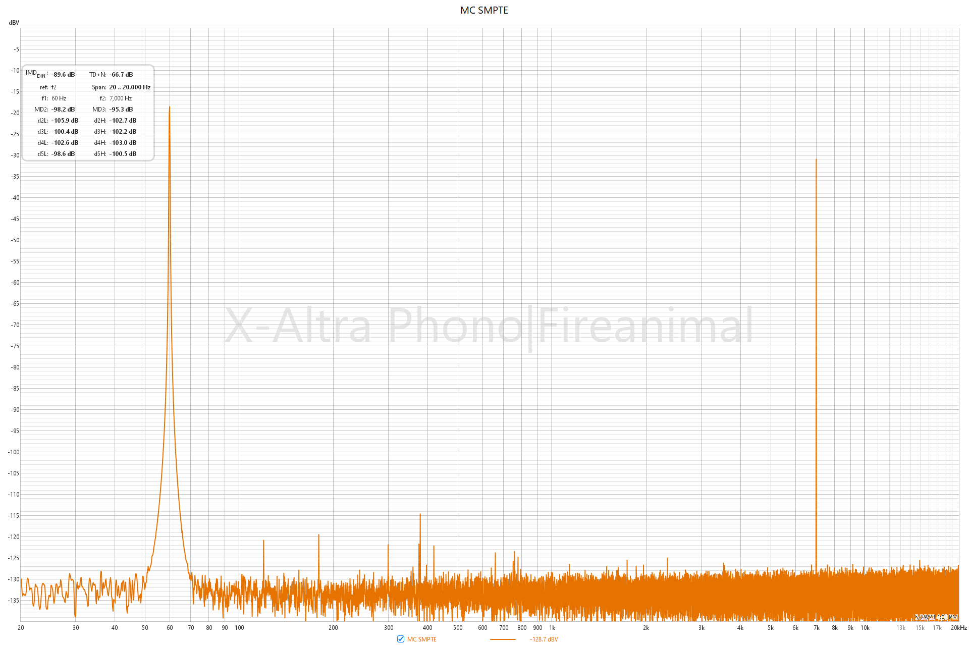

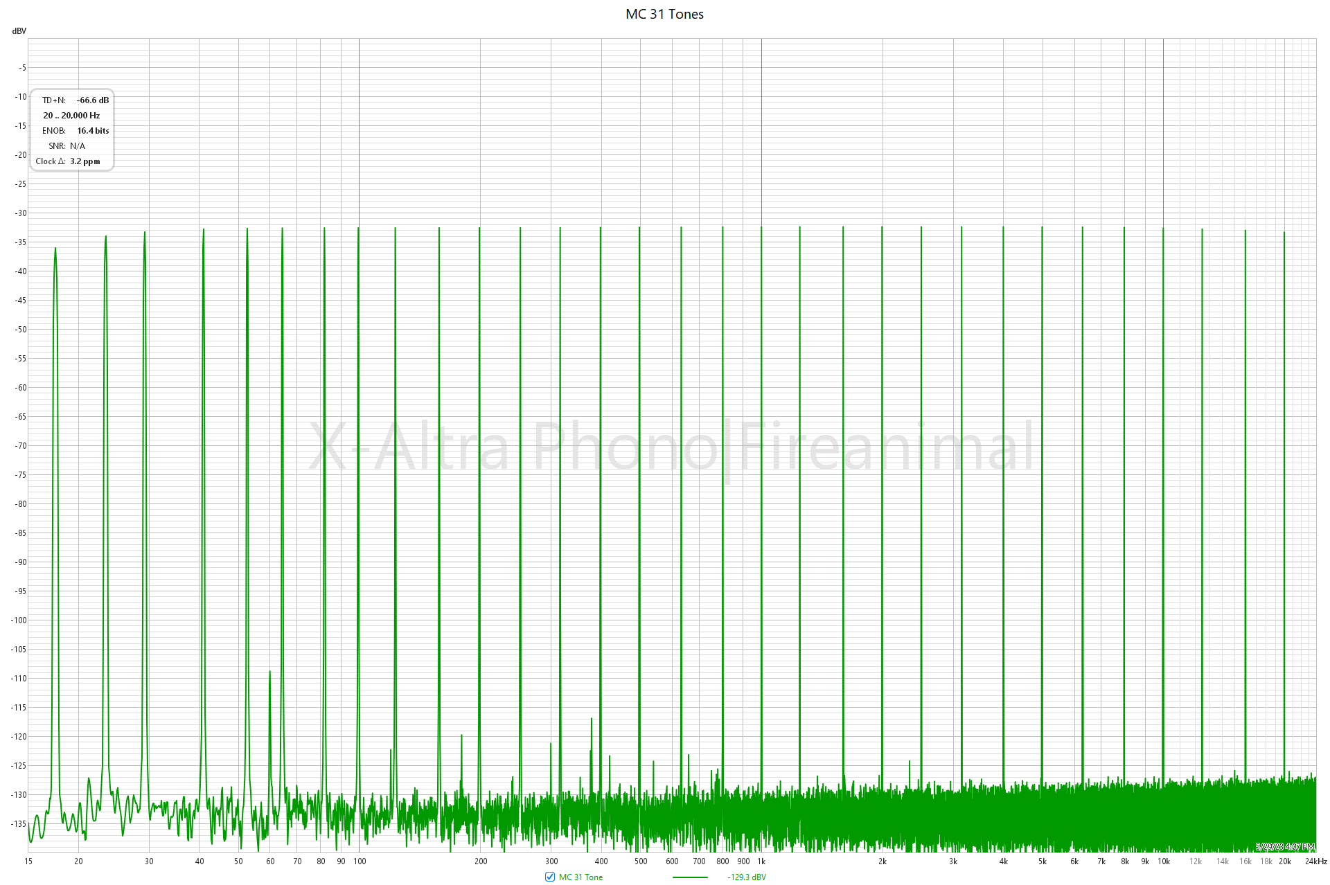

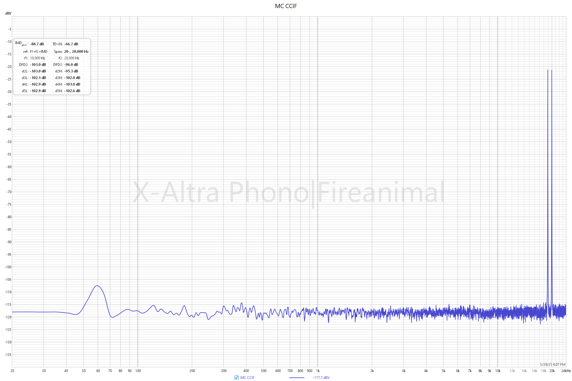

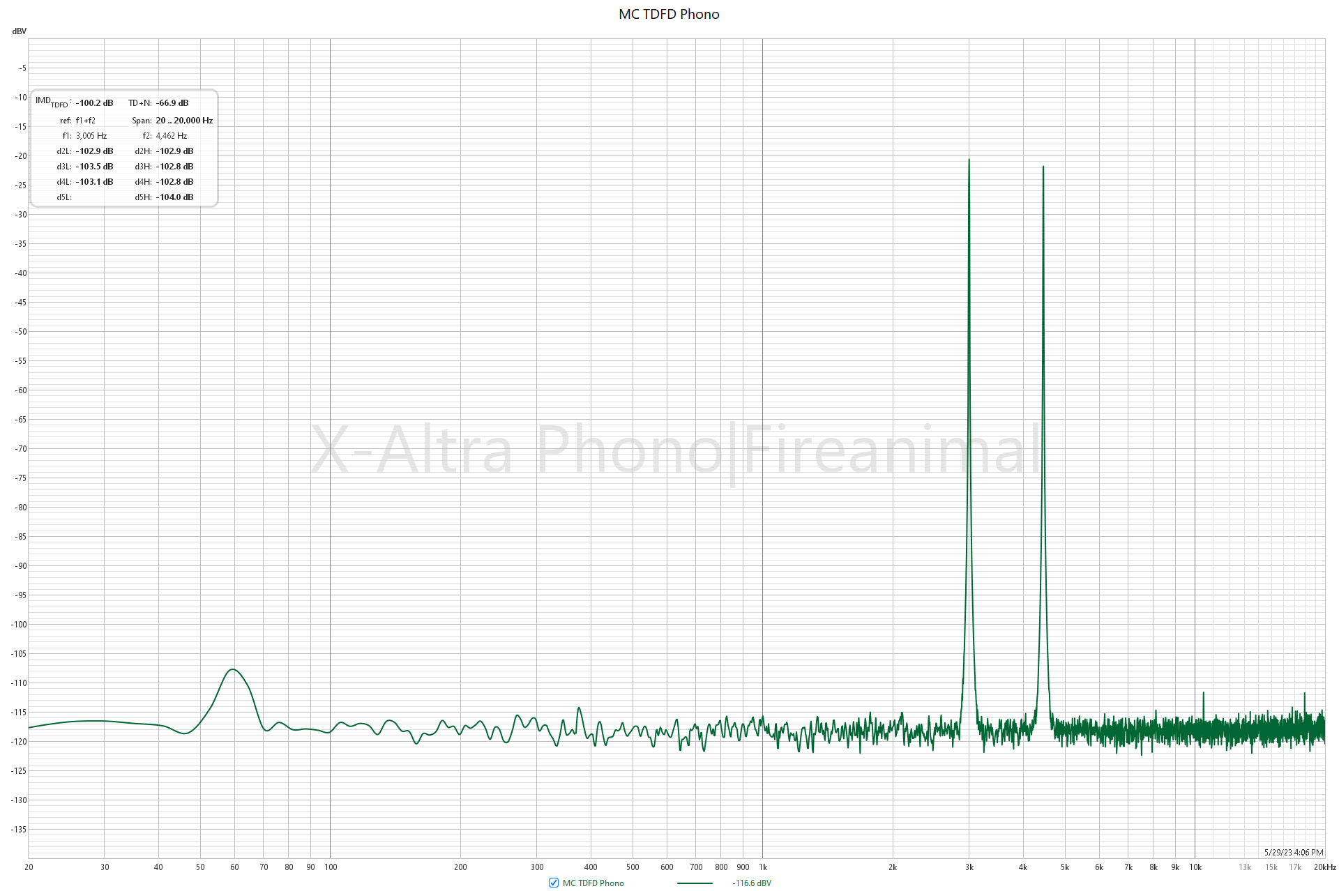

For completeness, I replaced the BC550C/560C with ZTX851/951 on the 2nd preamp. MC Input SNR matches exactly with the 1st unit. I also took a few multitone measurements.

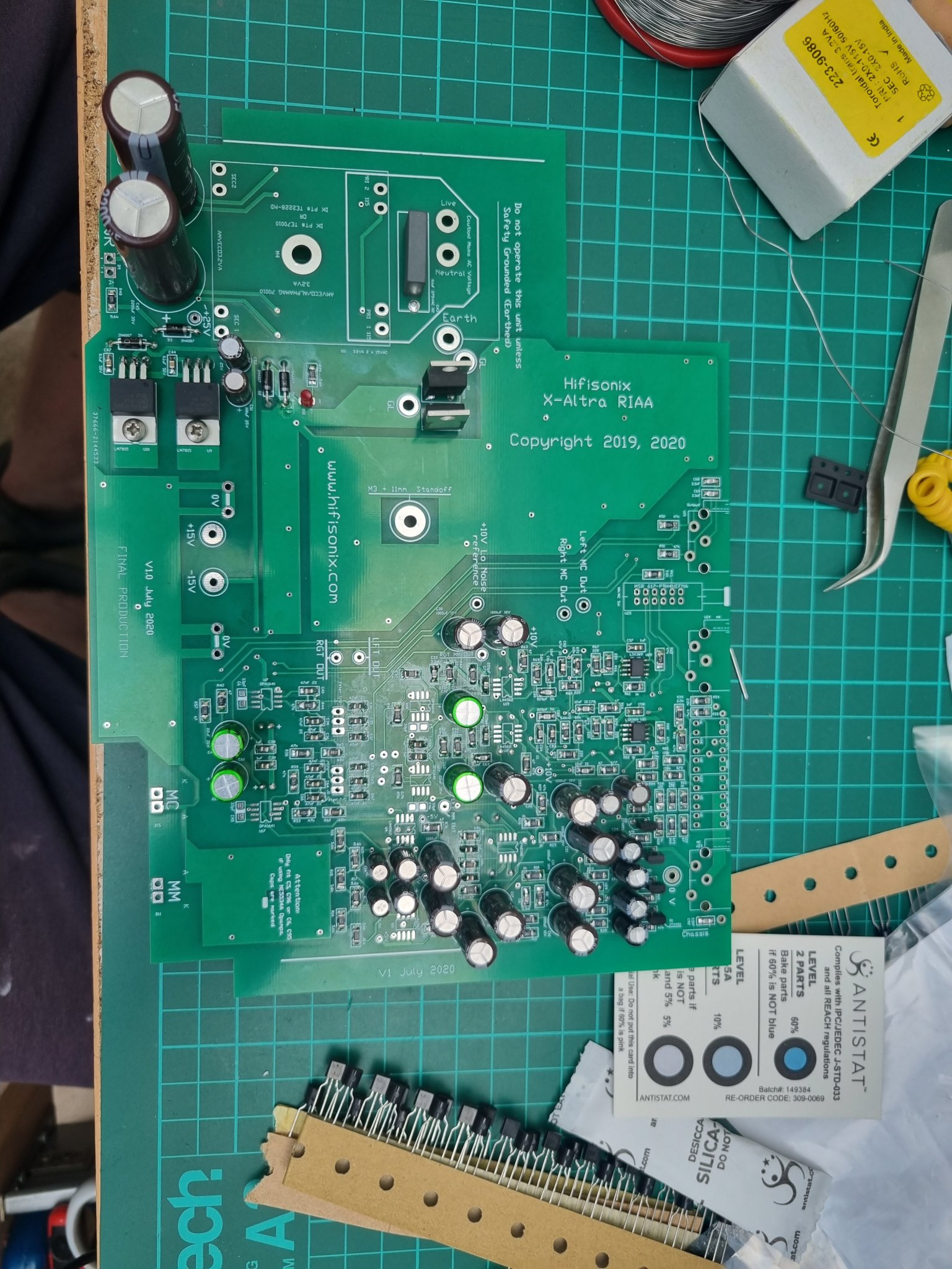

Thanks Andrew, im building this one for my Dad and want to collect all the parts before more go oos. There are a couple of parts that are unavailable at the moment, could you recommend a any replacements? See below.
GRM2195C1H123FA01D for C78,C81,C84,C87
WP424SRDT for D10,D11.D12
And does anyone know if ZTX851STZ is the same as ZTX851

Chris, I used 12 way through hole piano DIP switches from RS but it seems they are now only available as SMD (https://uk.rs-online.com/web/p/dip-sip-switches/1774325?gb=s)
Here is a Mouser equivalent https://www.mouser.co.uk/datasheet/2/626/grhls01225_1-2289385.pdf and the associated part number page is https://www.mouser.co.uk/ProductDetail/Grayhill/76PSB12ST?qs=ls7QRyWmRk6duToY3C%2BZ0w== and Mouser part# 706-76PSB12ST
(Note that the incorrect product picture is shown on the Mouser product page)
Do no use stacked 4 and 6 way switches unless they specify the overall dimensions as being the same as a complete 12 way switch - I got caught out by that on an earlier build.

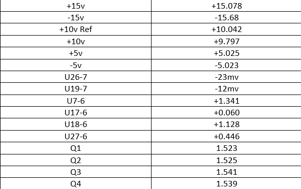

Switched this on for first voltage check today and they seem OK to me apart from the raw 10v is there a mistake in the assembly instructions? Line 13 says check 25v next to C45 for 25v +/-3 volts and check 10v next to C56 for 10v+/- 30mv should the 10v check read next to C46 check for 10v +/- 3v?

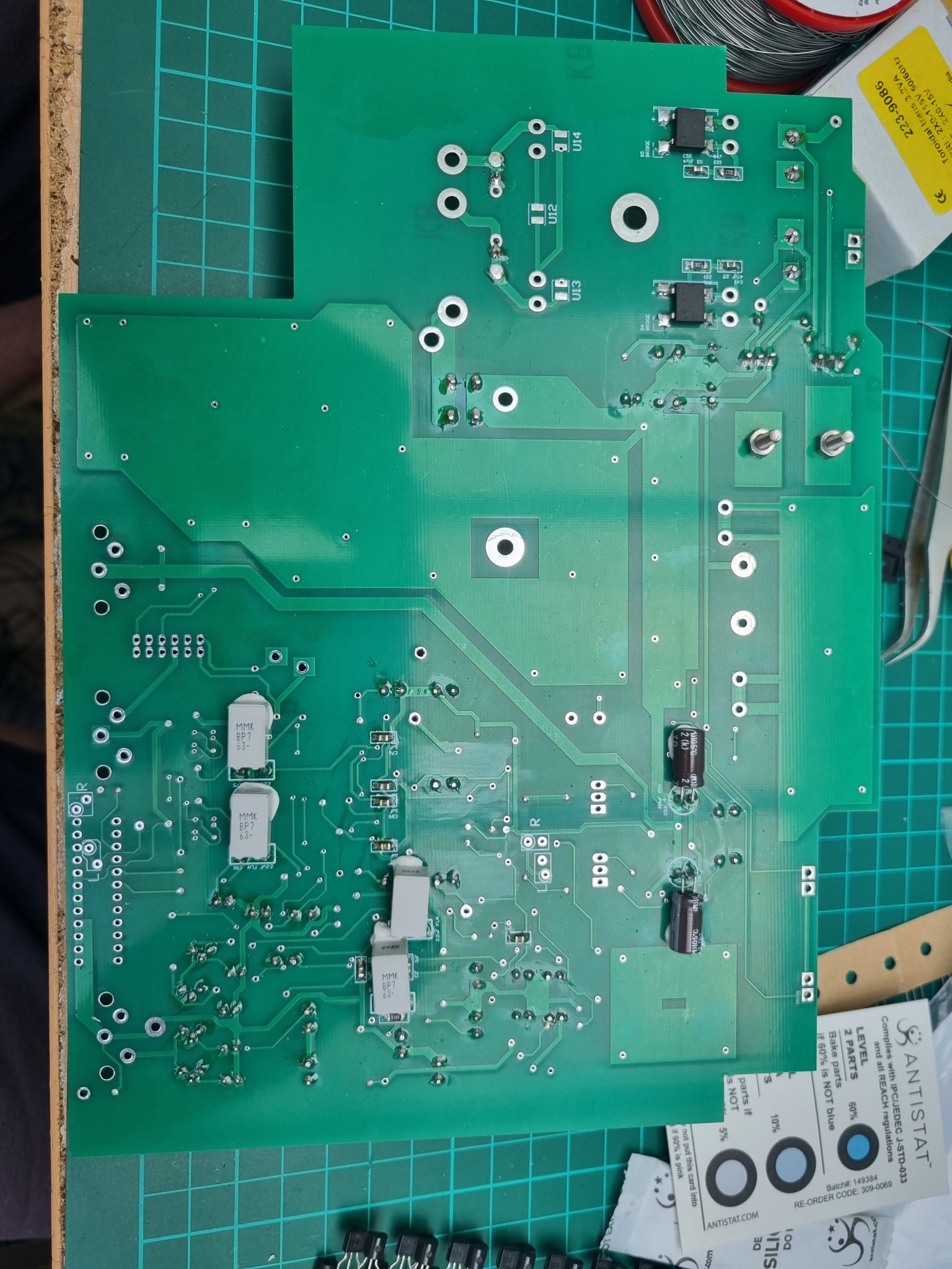

For the PCB to power inlet, I just soldred the connections. Use good quality well insulated wire and cable tie the live and neutral wires together to keep the loop area small from the inlet to the PCB as small as possible. Make sure the mains wire is kept to the left (looking from the front) and well away from the right hand side of the PCB.

Chris,
Important note: if the preamp is picking up noise, the readings will be all over the place. For your measurements, leave the MC input OPEN and SHORT the MM inputs right at the input connector. This will ensure the preamp willbe quiet enough for good DC readings.
The U27 and U18 pin 6 voltages look very high. They should be a few mV (not more than c. 20-25mV) on pin 6. U7 pin 6 also very high. These voltages look like U7 and U17 pin 7 should be 5-10mV max.
I assume the voltages you are quoting for Q1-Q4 are the collector voltages wrt 0V - if so, they are correct. The +10V, +-5V readings are all correct.
Don't forget to check the MC input offset as follows: measure the voltage across the input connector (ie between the input socket ring and centre connector) with U28 and U29 open. You will get 10's of mV of offset. Then flash U28 and U289 closed and remeasure - you should get 0.00mV
Thanks Andrew,
Without shorting the MM inputs as I don't have the phono's installed yet measuring noting the voltages down properly this time, they are as follows
U27 Pin 6 is 3mv
U18 Pin 6 is 3.1mv
U7 - Pin 6 is 1.3mv
U17 - Pin 6 is 0.060mv
Measuring the MC input from socket ground to both inputs I get around 3mv Q1-4 are matched.
Voltage across R61- R82 is around 5.2v I am using the Jfe Opamps I think I read this is acceptable?
How do these measurements stack up?
