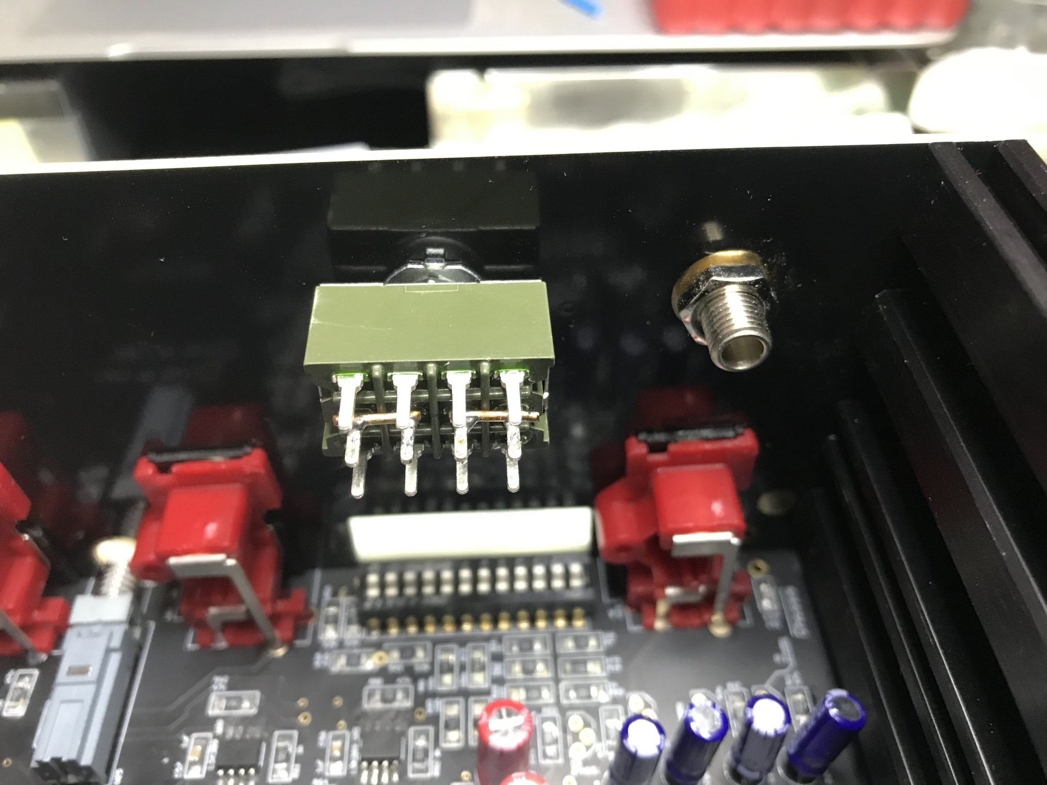

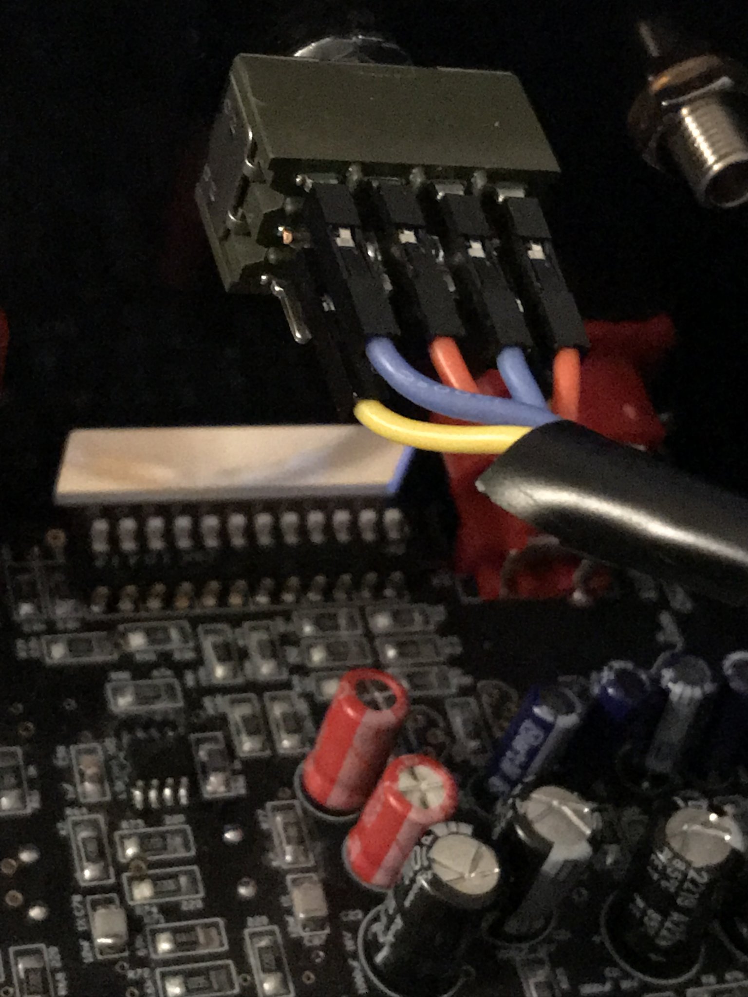

Great idea with the push on terminals. So much cleaner than my hand wiring and soldering.... I thought I had extra 851 and 951s, if I ever find them they are yours.Finished mine today, and I am pretty proud! I had an issue with the left channel not giving any sound, and then retraced the path and reflowed wherever there seemed to be a missing connection. I used pretty rigid and thick wire for the power supply, so some shaping was required. I had some cat5 cable, but also, some hook up wire from a previous project, so I used some connecting headers, sot it remains practical.
It sounds great! Barely any ground hum (pot turned to max!).
