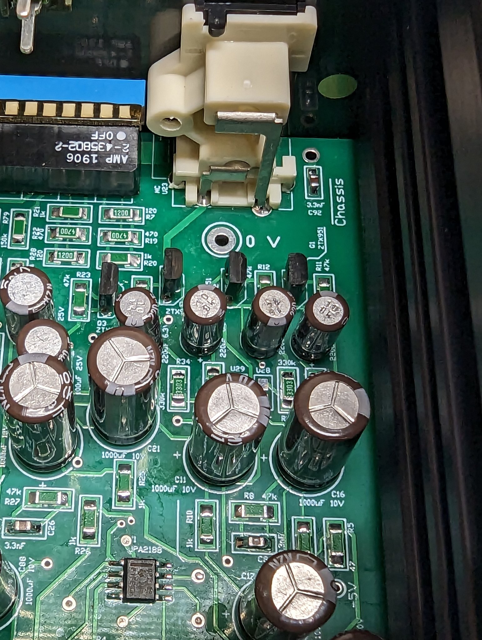

The input impedance of the MC stage is affected by the base impedance of the two input transistors. For noise reasons you want that to be as low as possible hence the 220uF. If you have a low ESR cap, then I would use it.
That makes perfect sense and I understand what you mean now, you went with a 220uF cap as the ESR is lower, and the ESRThe input impedance of the MC stage is affected by the base impedance of the two input transistors. For noise reasons you want that to be as low as possible hence the 220uF. If you have a low ESR cap, then I would use it.

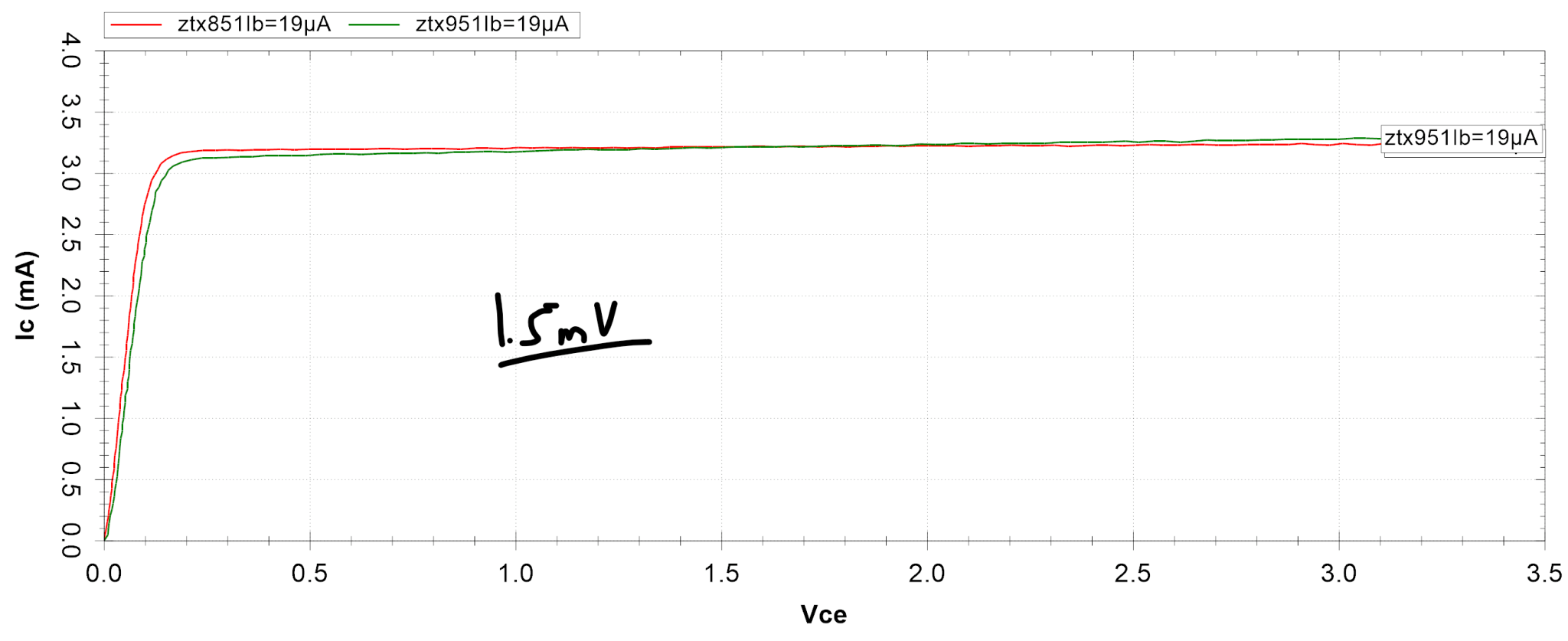

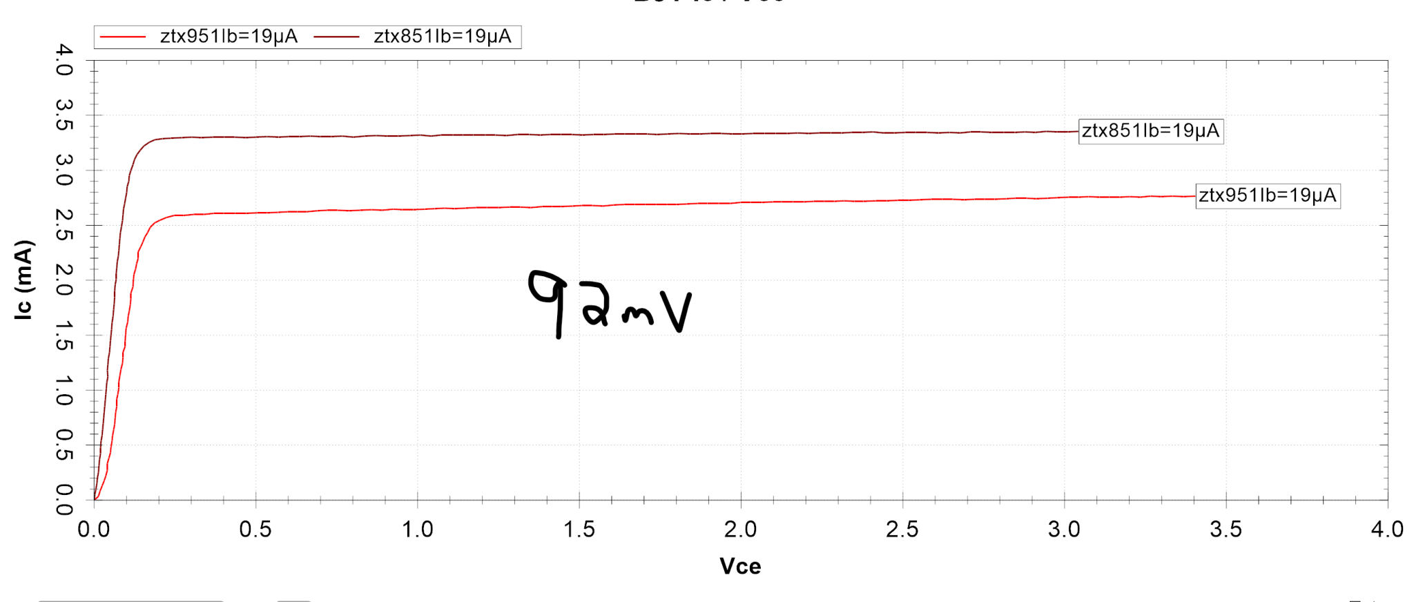

Resistors are correct and I replaced the caps, offsets are the same as before. Can a bad HFE match on the transistors be a cause of this? The other one I built I used BC550C/BC560C and it was perfect. ThanksAlso, check the associated bias resistors R23 and R24.
Swapped out the transistors for that channel with BC327-40/BC337-40 to test and now the offset is at 12mV, looks like too much of a mismatch with the other ones ( 30hfe difference ).

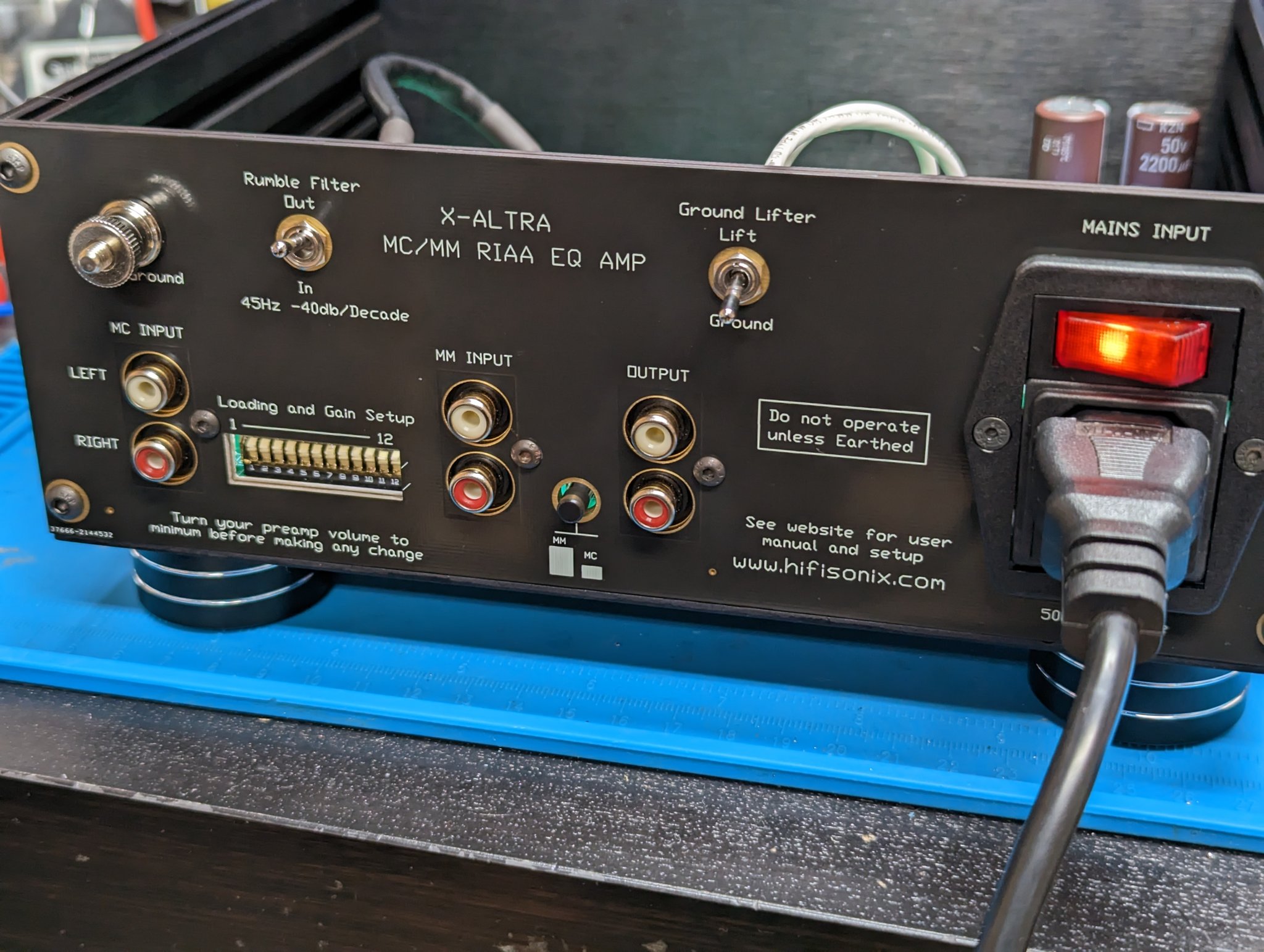

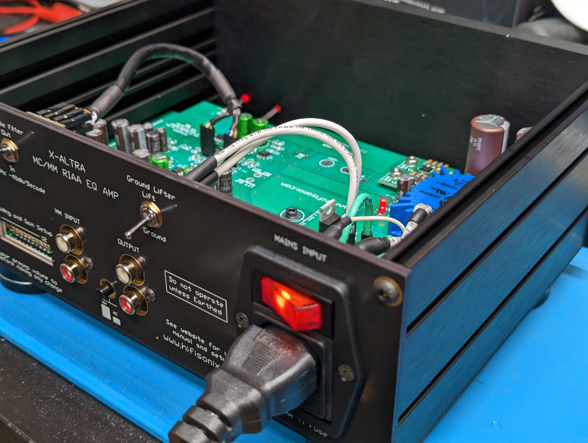

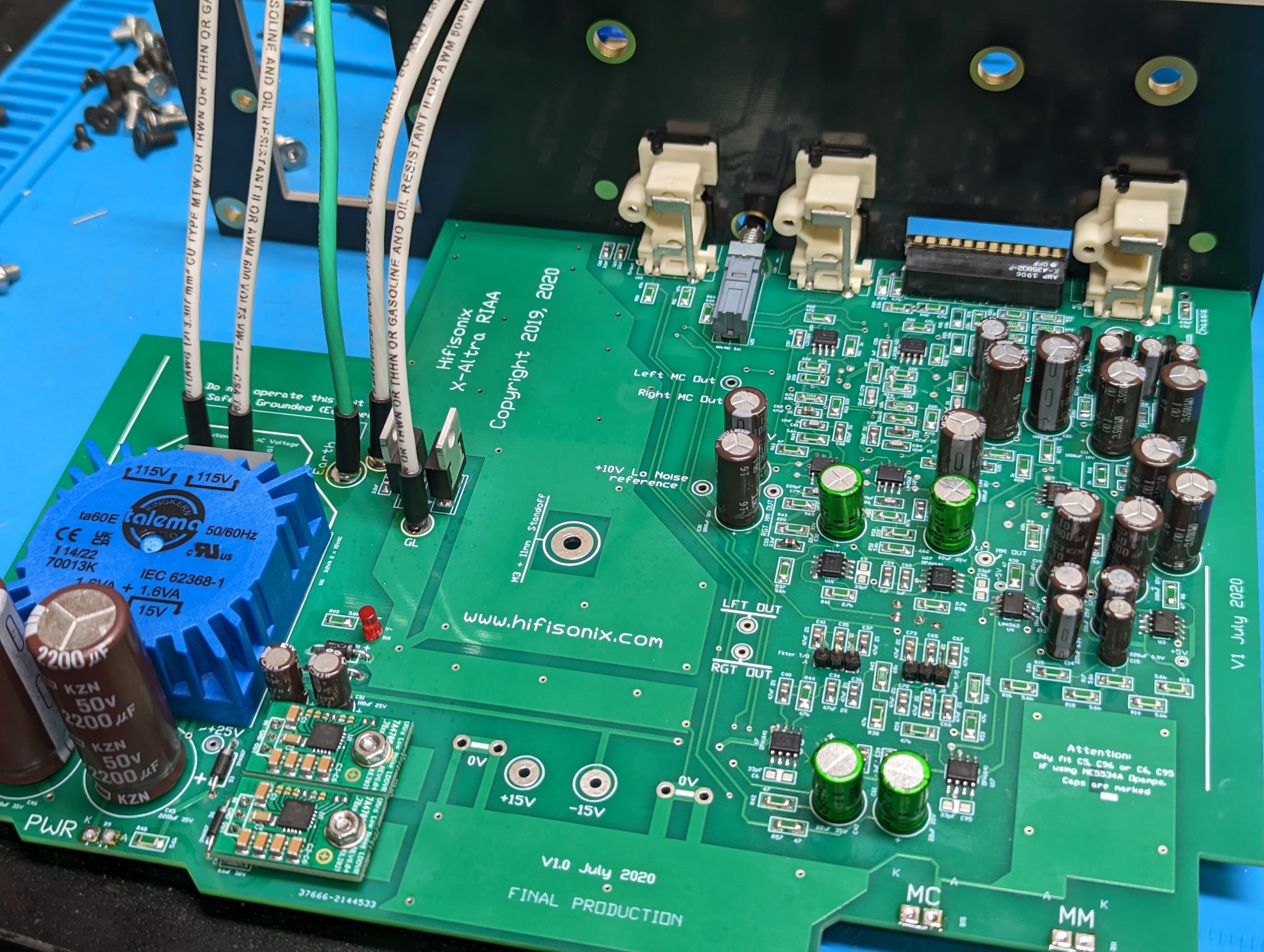

Also Black sharpie works great for the PCB edges on the rear panel so they match the housing too.

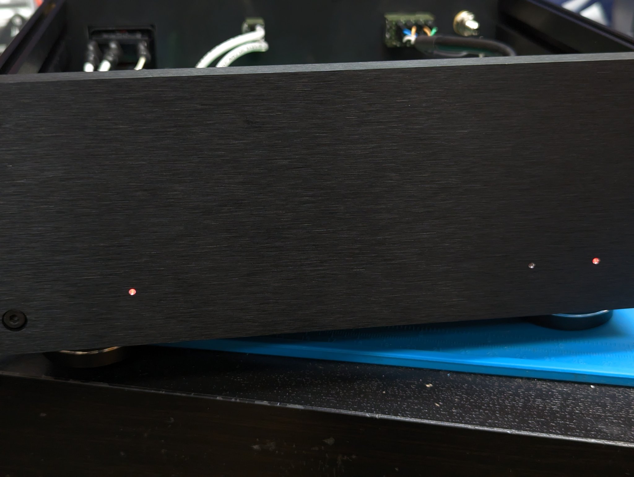

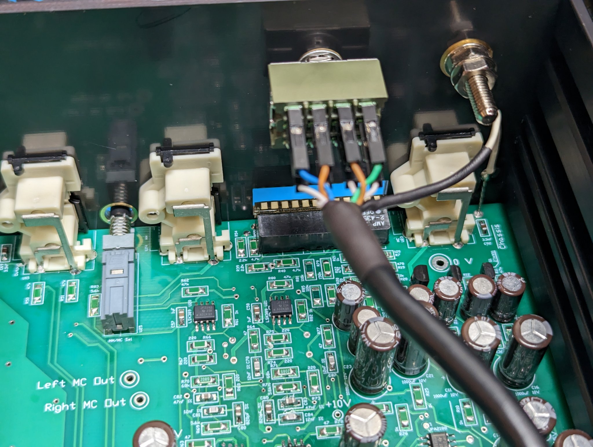

What I did for the LED's was I only drilled a 1.5mm hole through, then drilled the LED pilot leaving about 2mm of material to the front. Just gives a nice light glow to indicate its on 👍

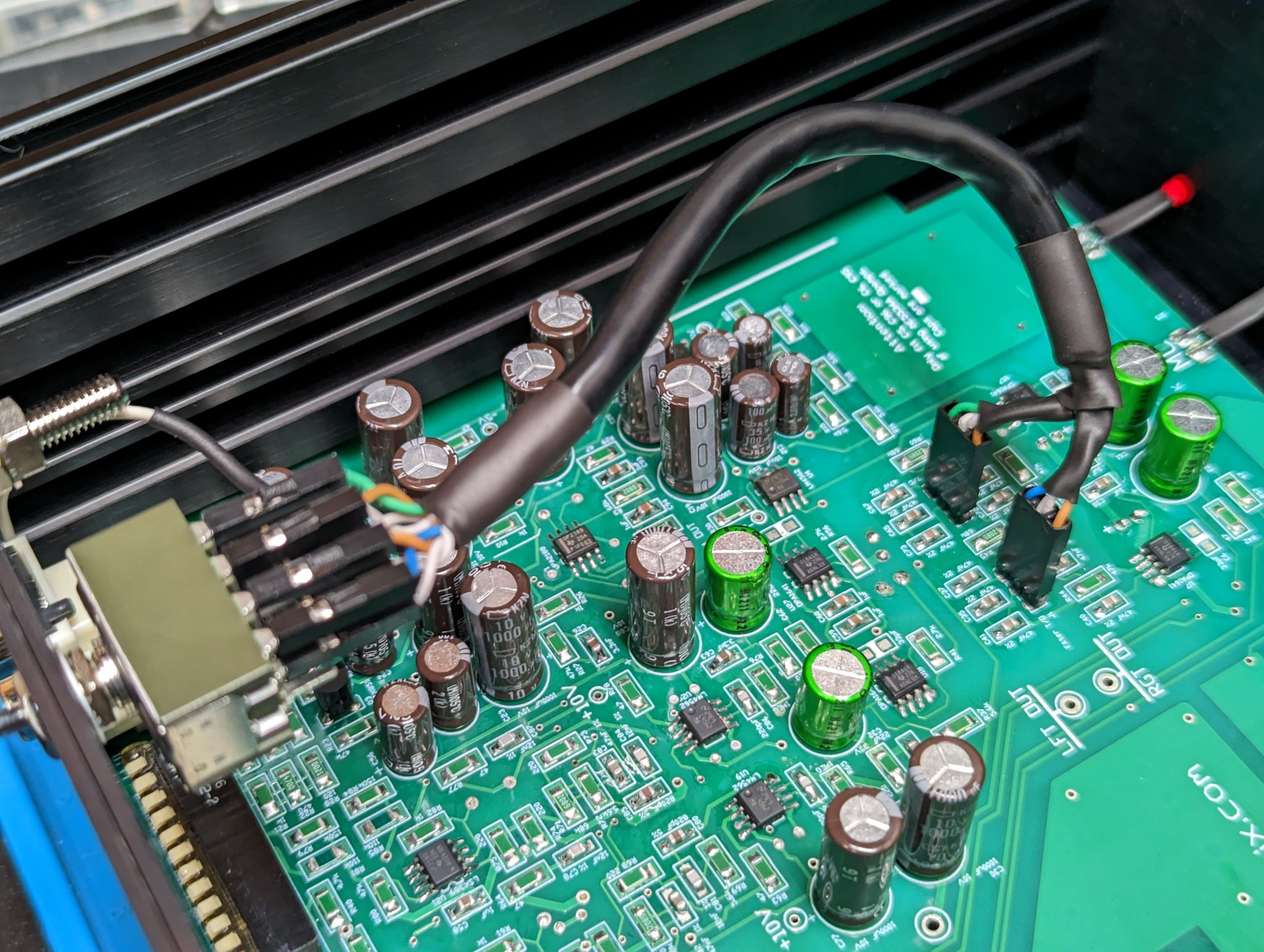

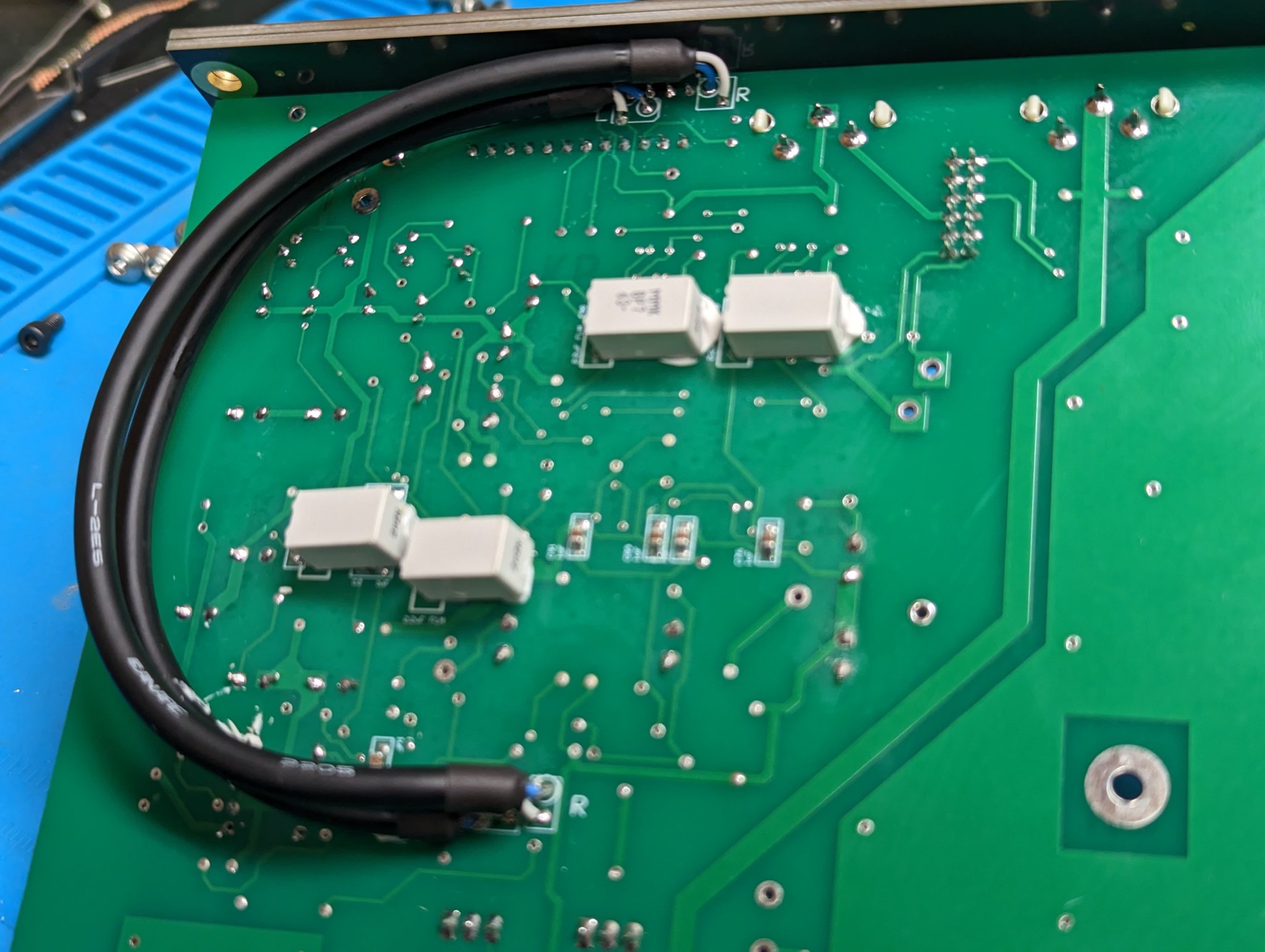

I used CAT6a stranded and shielded for the filter switch wiring, and then grounded the shield at the back panel end.

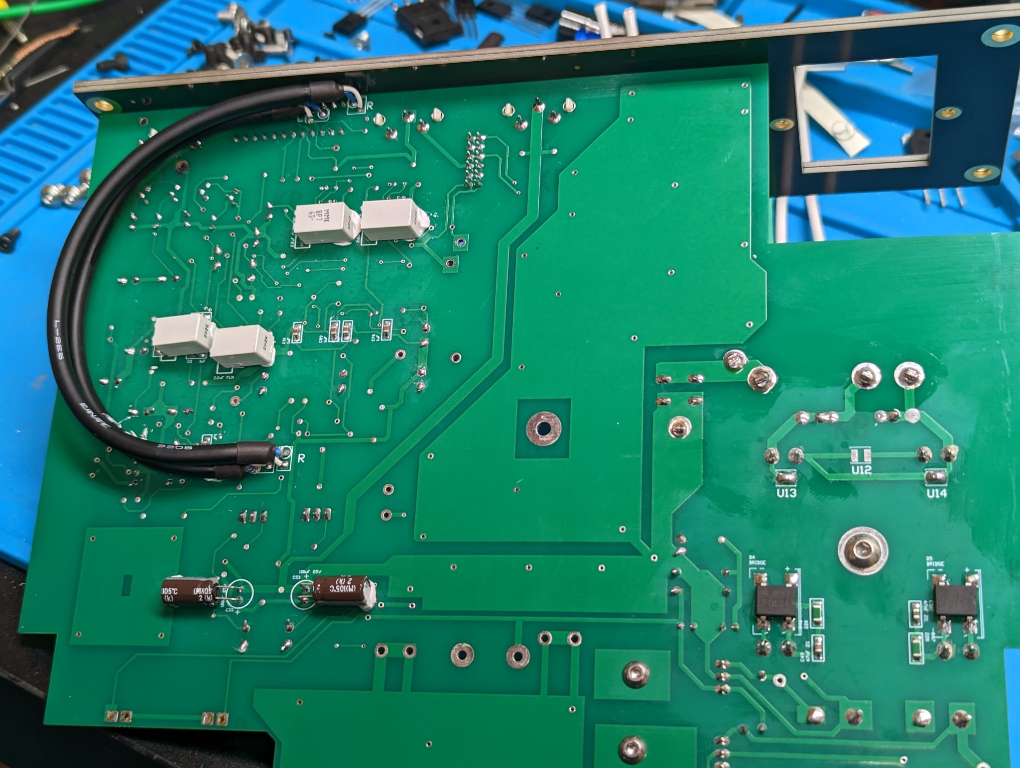

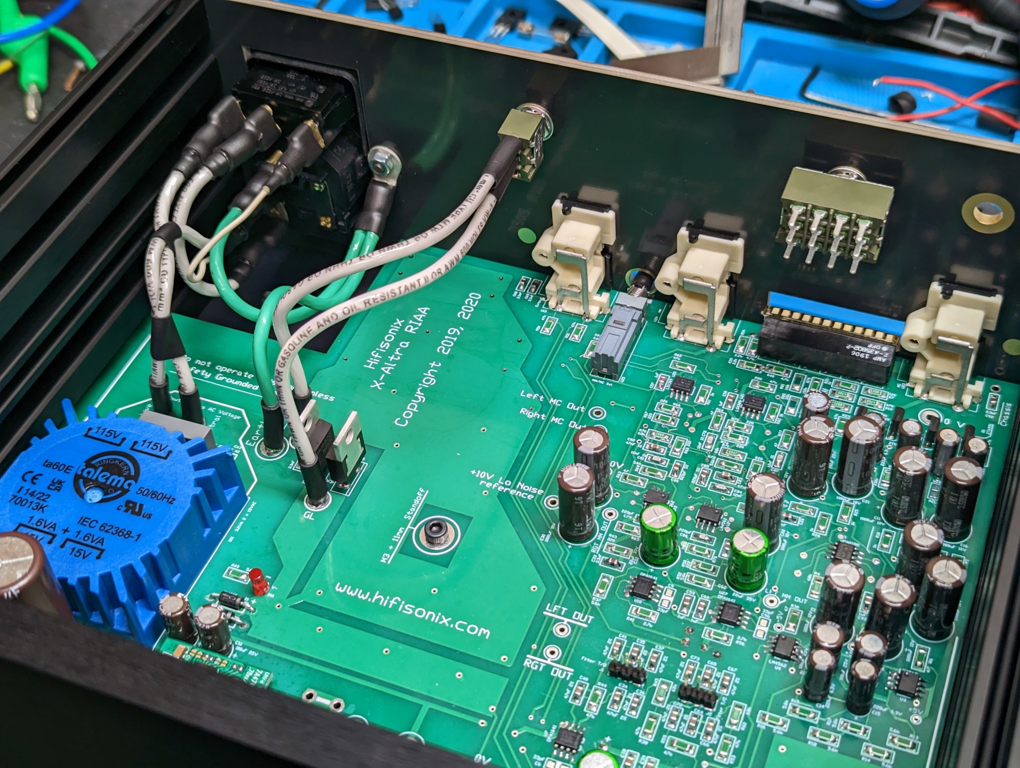

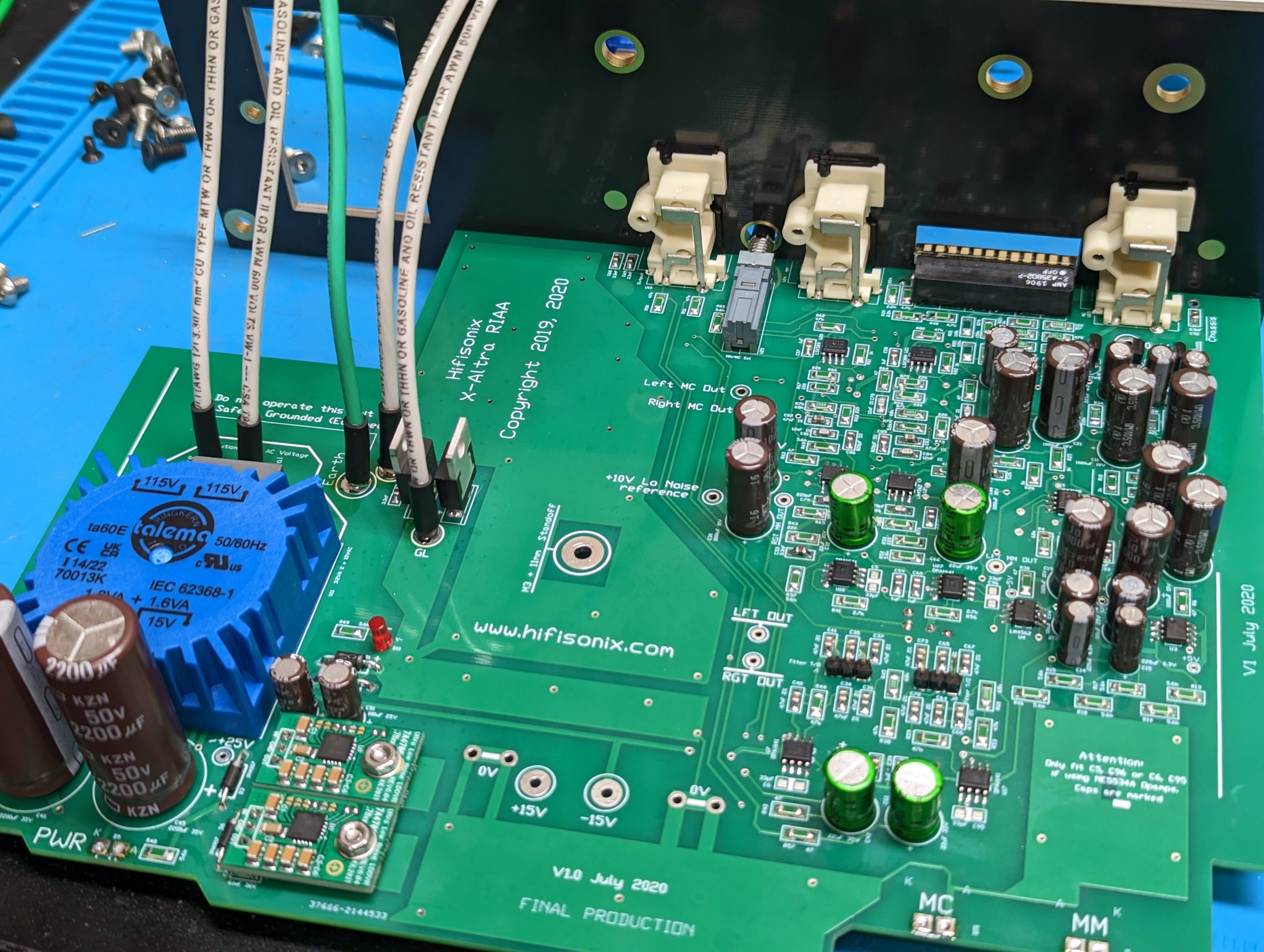

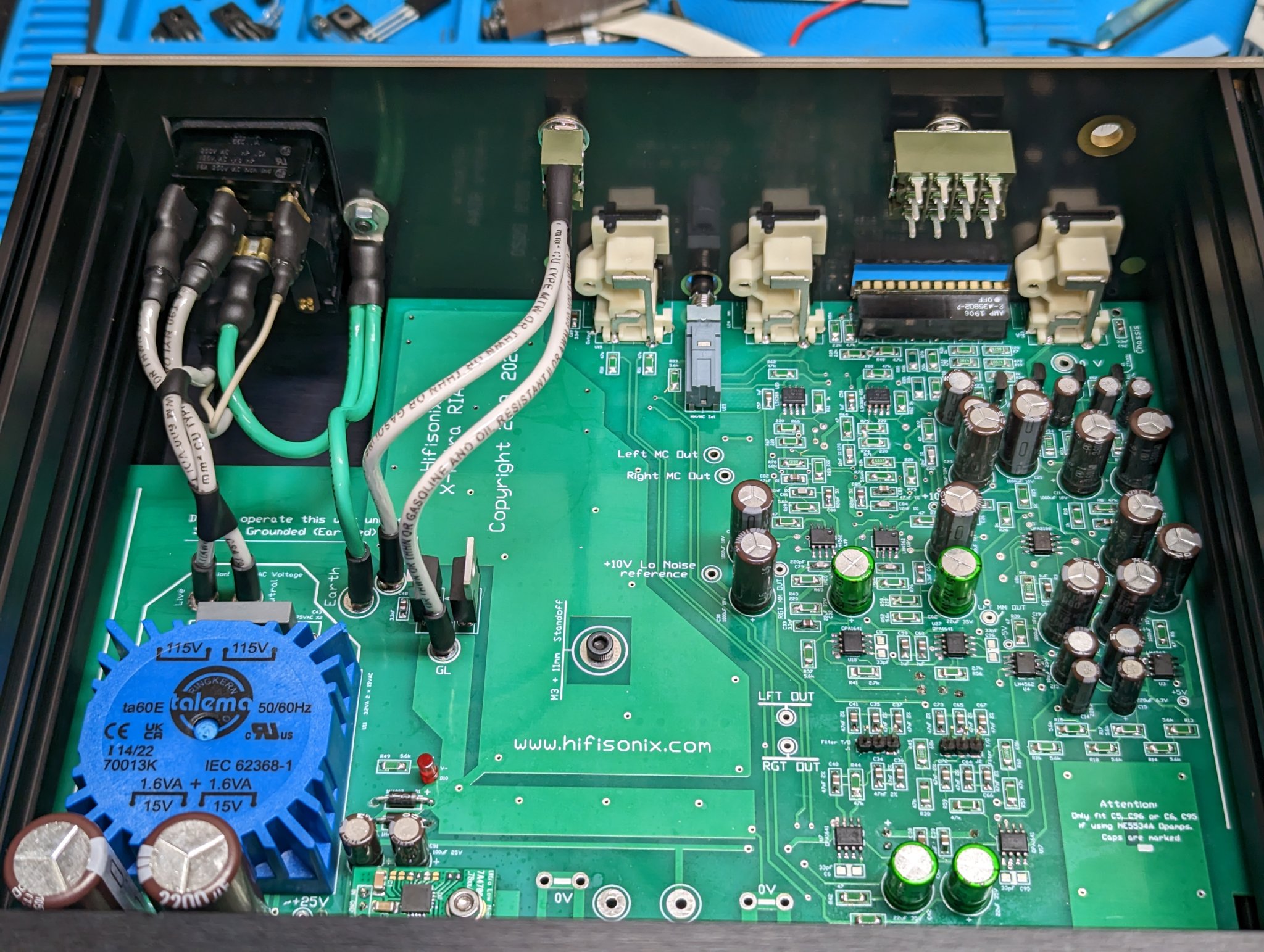

Build Pics attached.

ok - looks like you have a large Vbe and a large hFE difference between the N and P devices on that channel. I any case, the servo will remove this. I will suggest for future builders that they use the closest matched N & P pairs together in each channel to minimize any potential initial offset.
Have you flashed U28 and U29 closed and checked that the input offset goes to 0.00mV? You have to measure right at the input connector because there is a small DC voltage drops across the ground that will affect the reading.
Fantastic looking PCB build 👍

Couple updates. I replaced right channel transistors now with a matched pair of ZTX951/851 and the resulting offset is 1.5mV. Attached are both pairs curve traced for comparison. It was the mismatch causing that issue.
I also decided to order a handful of different caps to measure out of curiosity for C9,C10,C24,C25. I will post the ones of most interest. 2.5mm X 6.3mm caps fit with no issue. ESR was taken at 120Hz

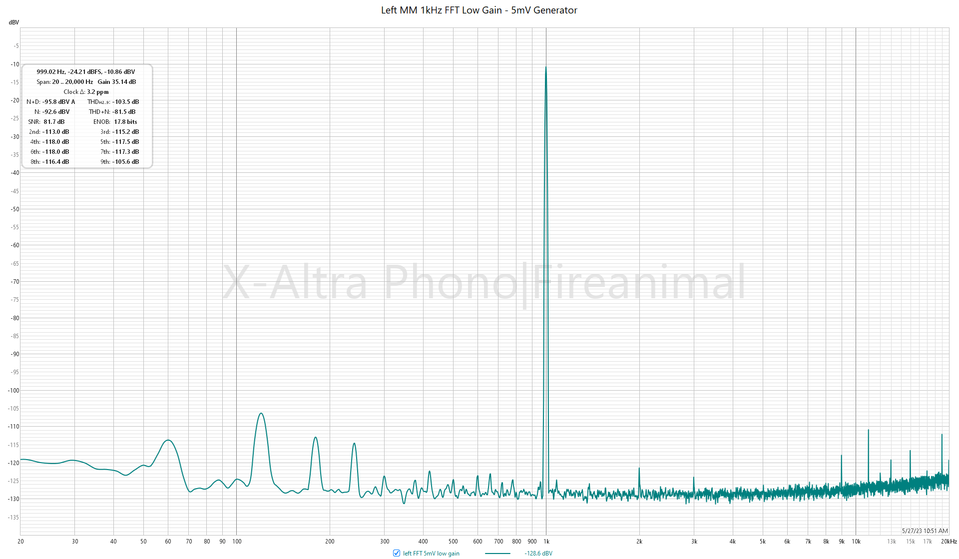

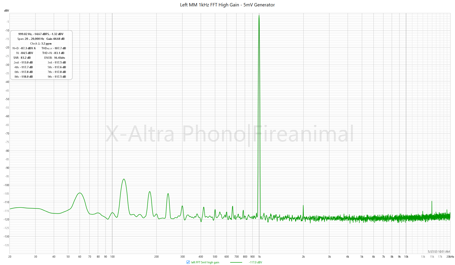

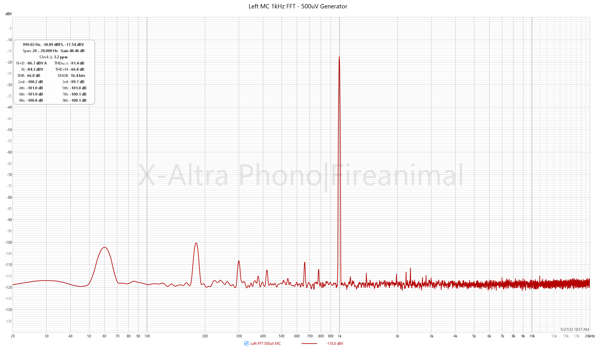

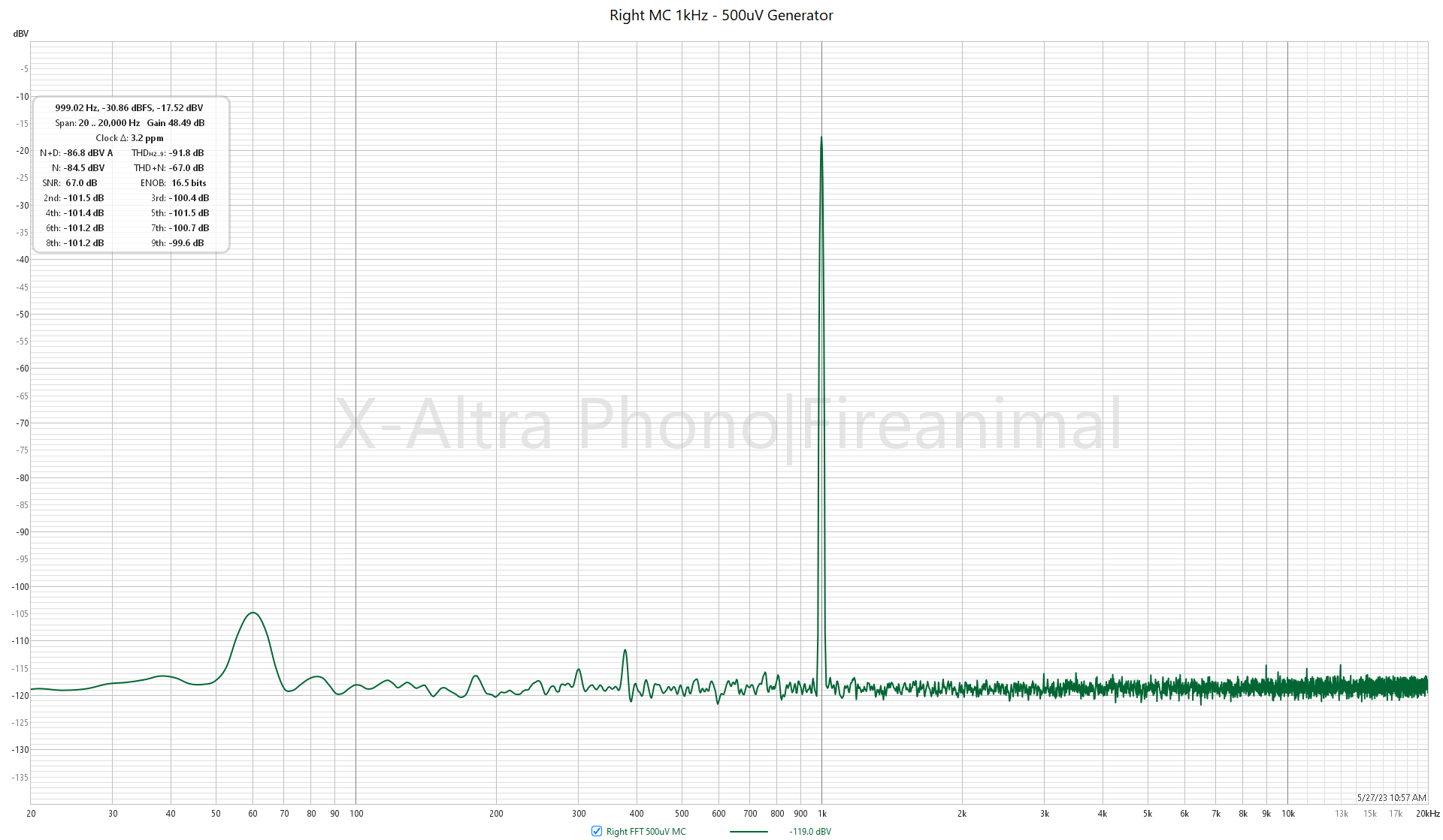

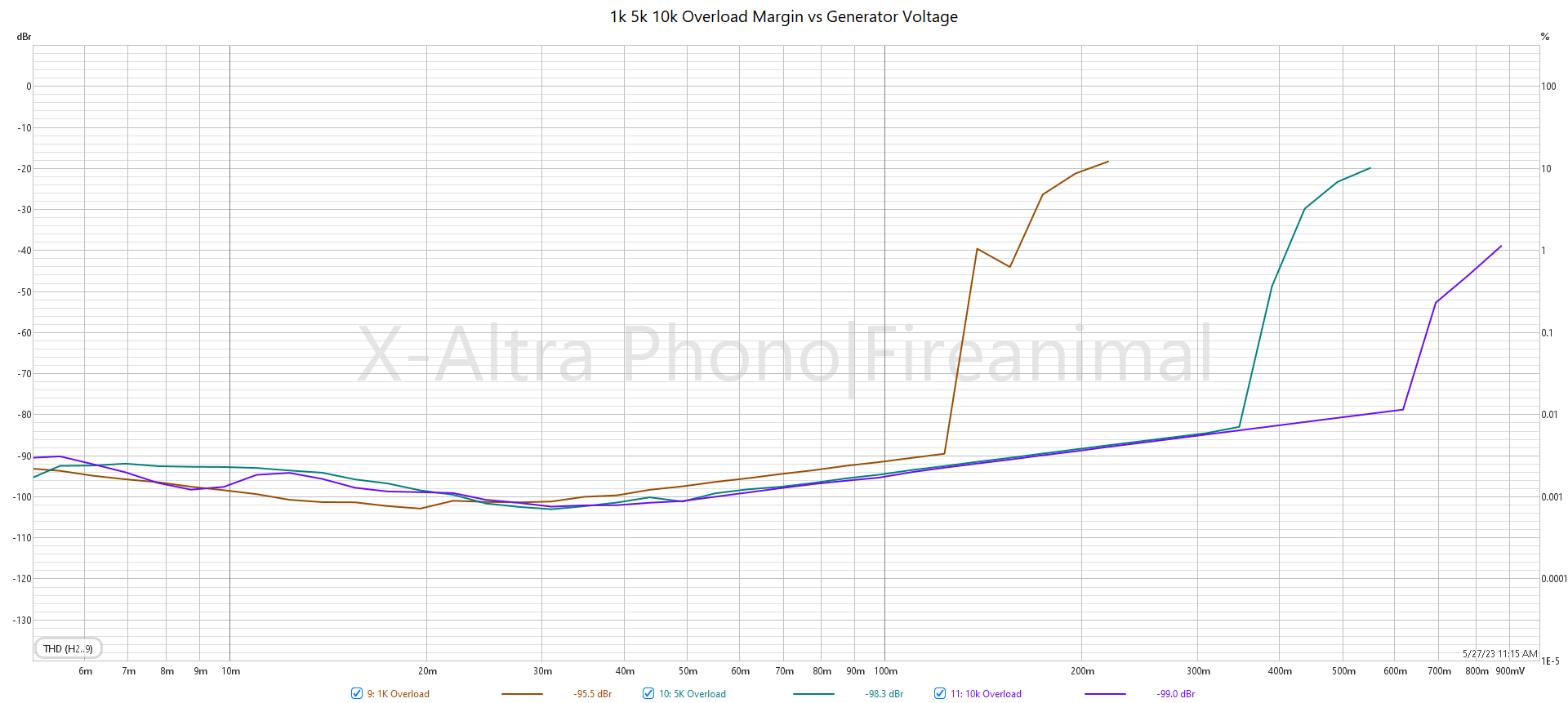

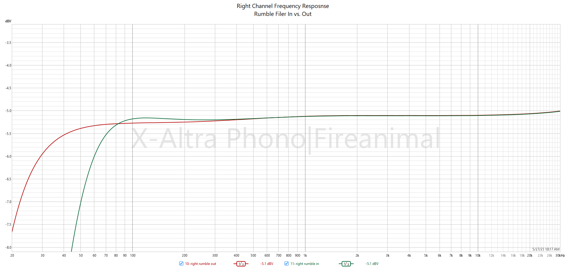

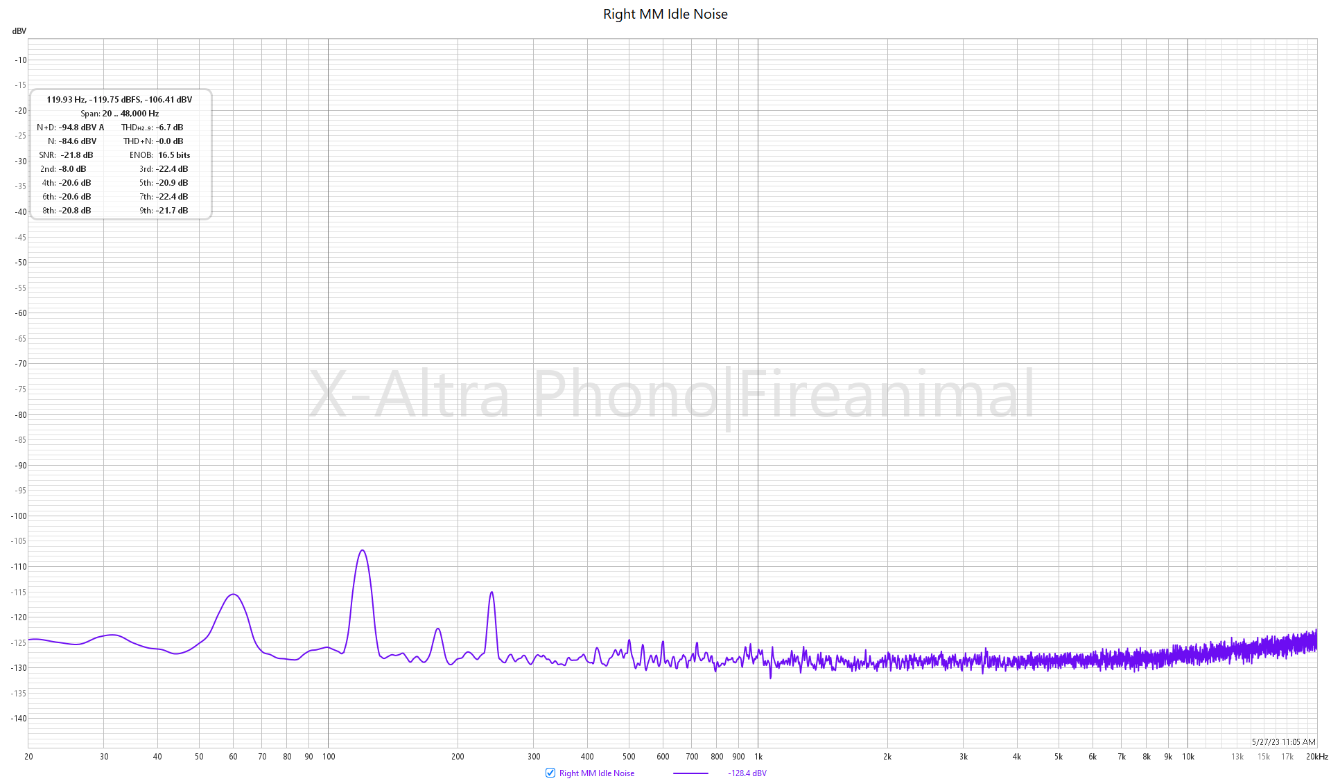

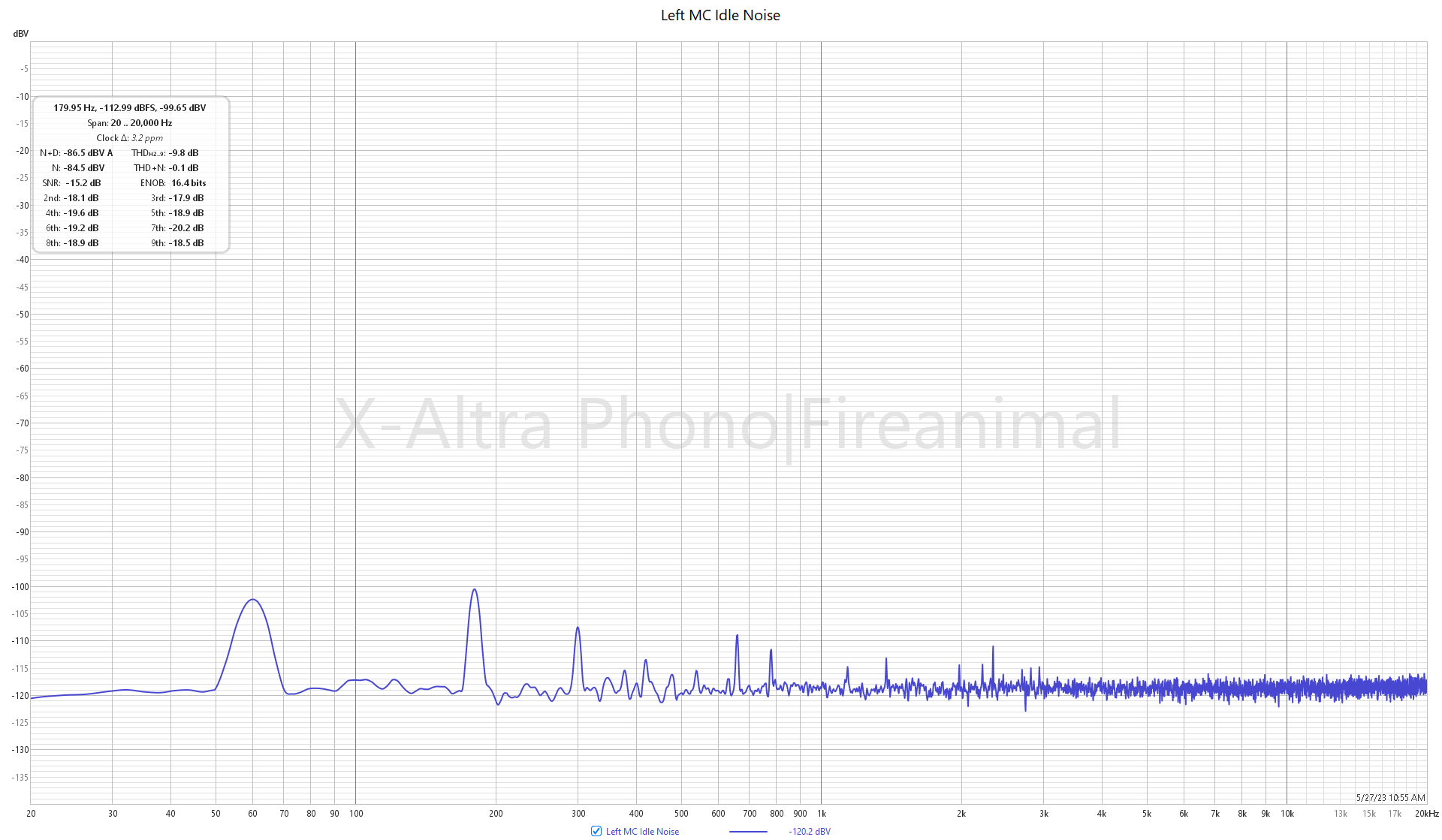

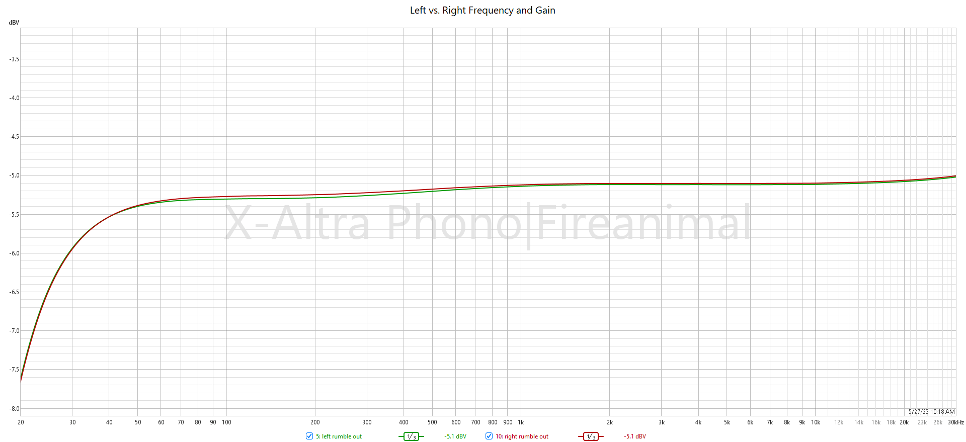

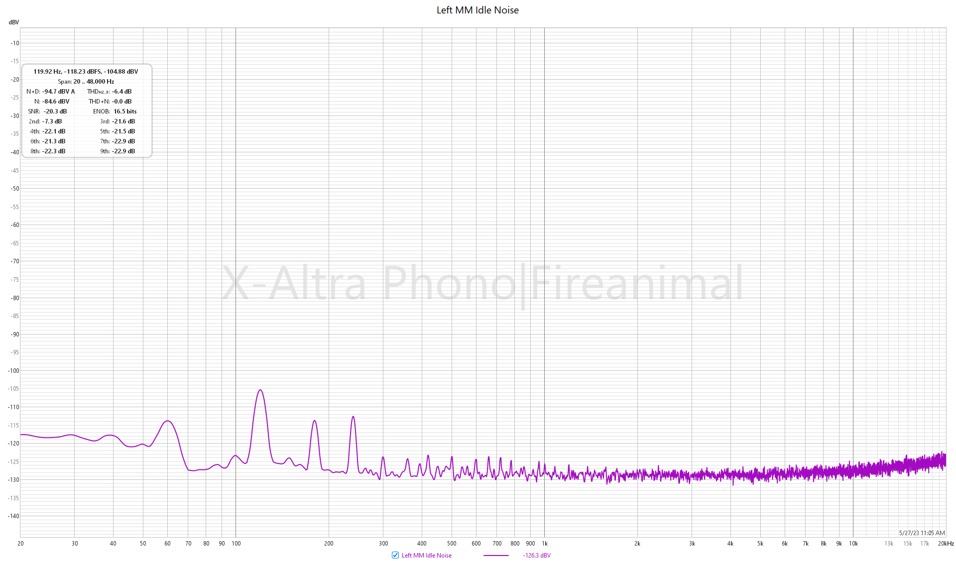

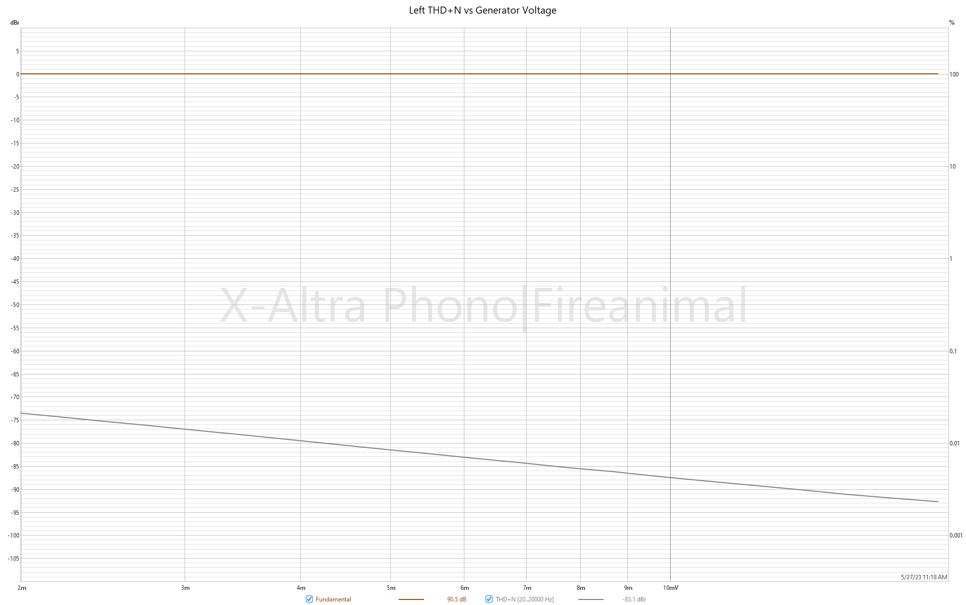

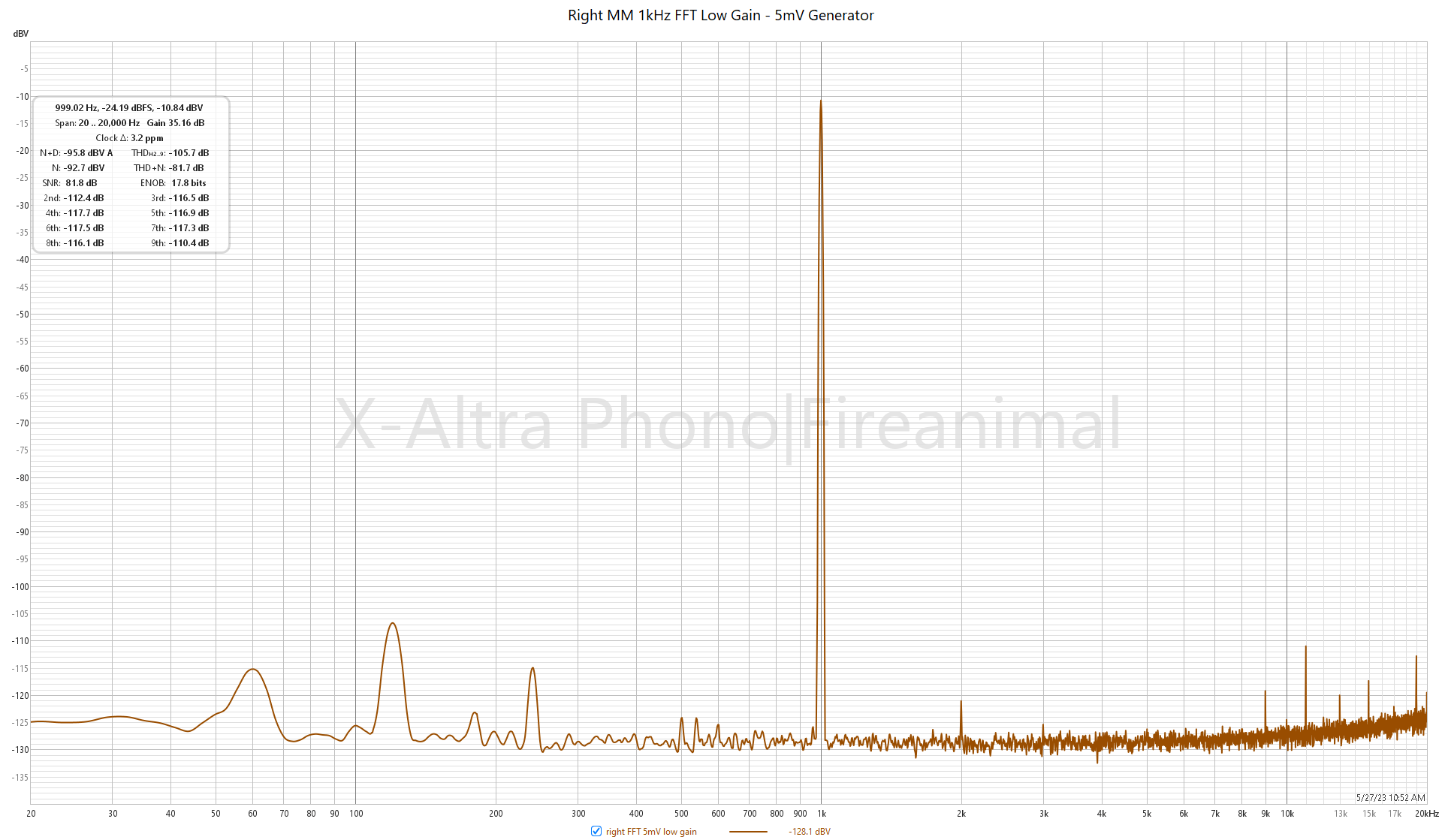

Finally got some time to get around to measuring the X-Altra phono preamp, before I get it hooked up in my system for a listen. If anything looks out of place there is a good chance it might be me, this is really the first time running measurements on a phono preamp. @Bonsai if you see anything suspicious please let me know. From what I can tell, it meets and exceeds published specs.
Right Channel suffers from less main induced noise and hum, which could just be my wiring layout, but overall it is very clean.
Almost a mirror image between channels with a mismatch of around 0.04dB @ 200Hz, and amazing RIAA conformance.
I just want to say thanks to @Bonsai for creating such an amazing phono preamp and sharing it with the DIY community!
First up is the idle noise floor of the measurement chain in loopback

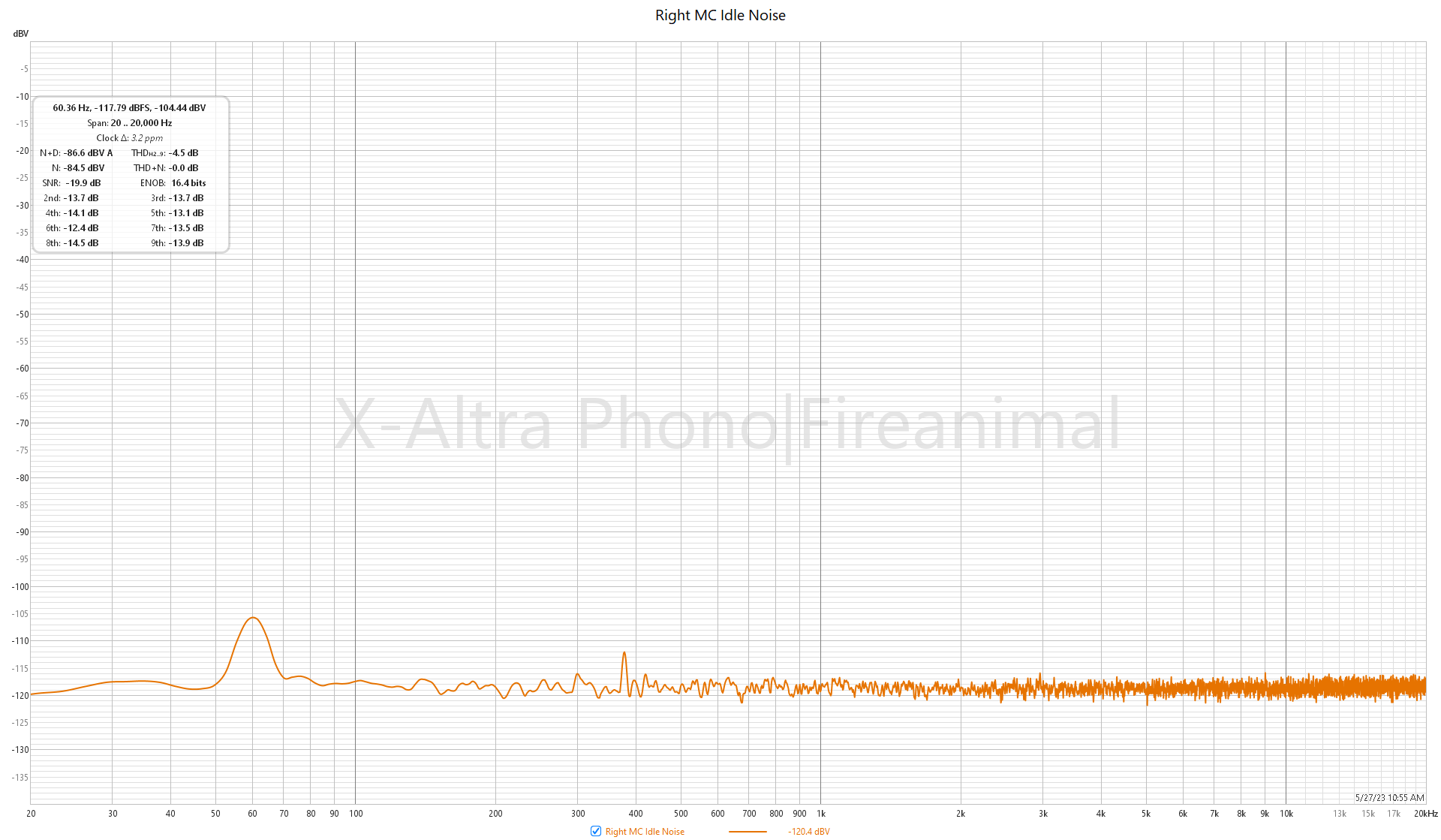

Noise Floor of Left and Right Channels MC and MM inputs

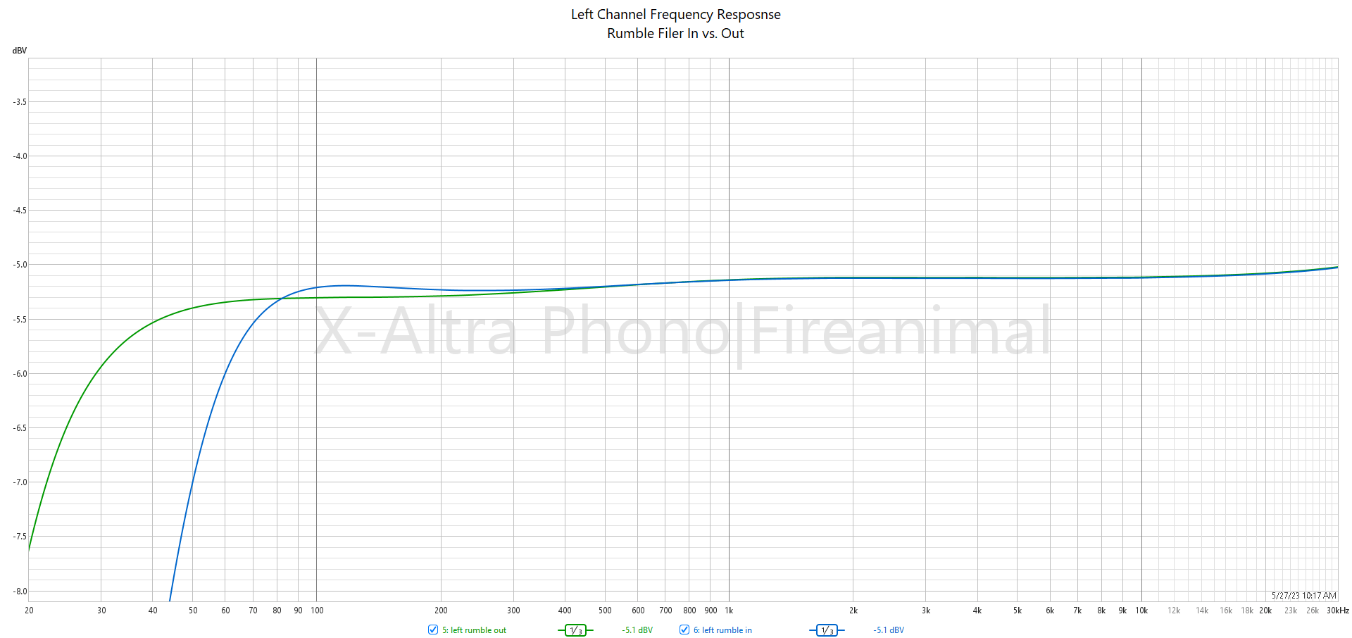

Left and Right Channel Frequency Sweeps
1 kHz FFT's MC / MM

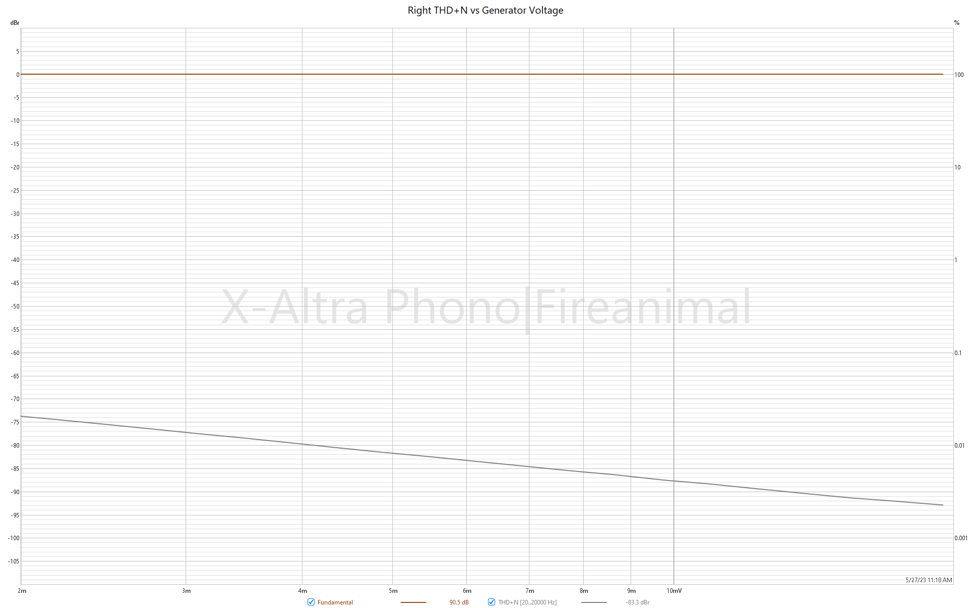

1 kHz THD+N vs Generator Level
Overload Margin
Thanks for doing these measurements Andy - good to have an independent set to compare against. I am out of town until mid-next week but will take a look at them then
