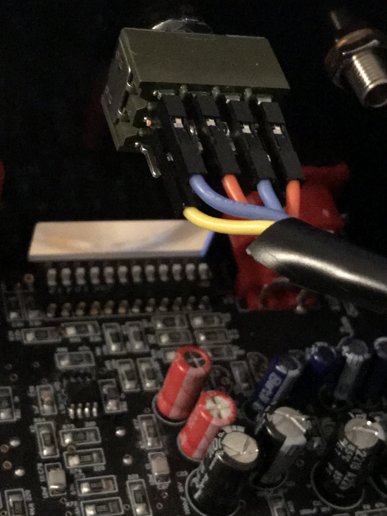

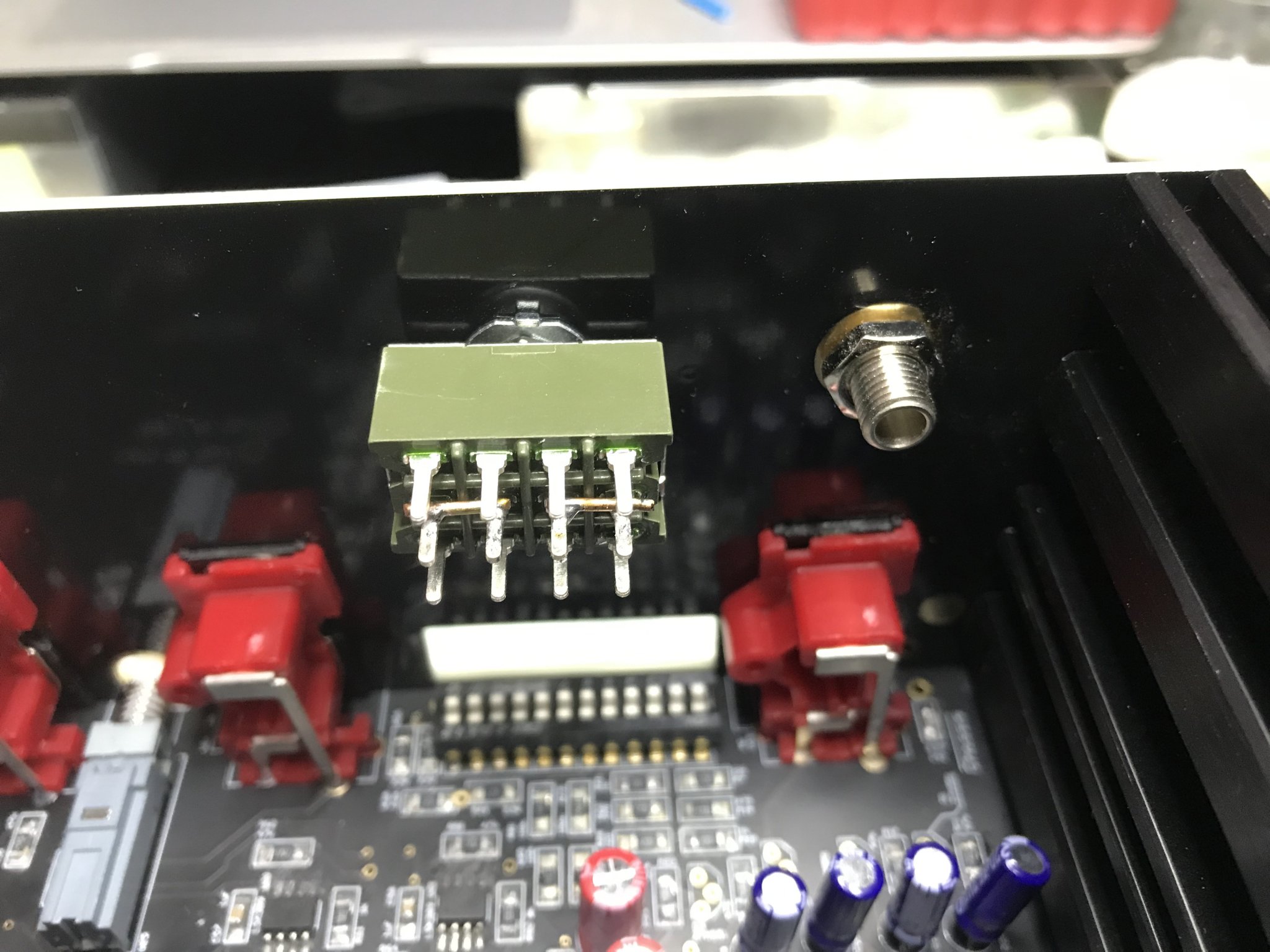

Finished mine today, and I am pretty proud! I had an issue with the left channel not giving any sound, and then retraced the path and reflowed wherever there seemed to be a missing connection. I used pretty rigid and thick wire for the power supply, so some shaping was required. I had some cat5 cable, but also, some hook up wire from a previous project, so I used some connecting headers, sot it remains practical.
It sounds great! Barely any ground hum (pot turned to max!).
Thank you everyone for the pictures, and especially Bonsai for this awesome device: I heard stuff I never did from my previous tube preamp!
