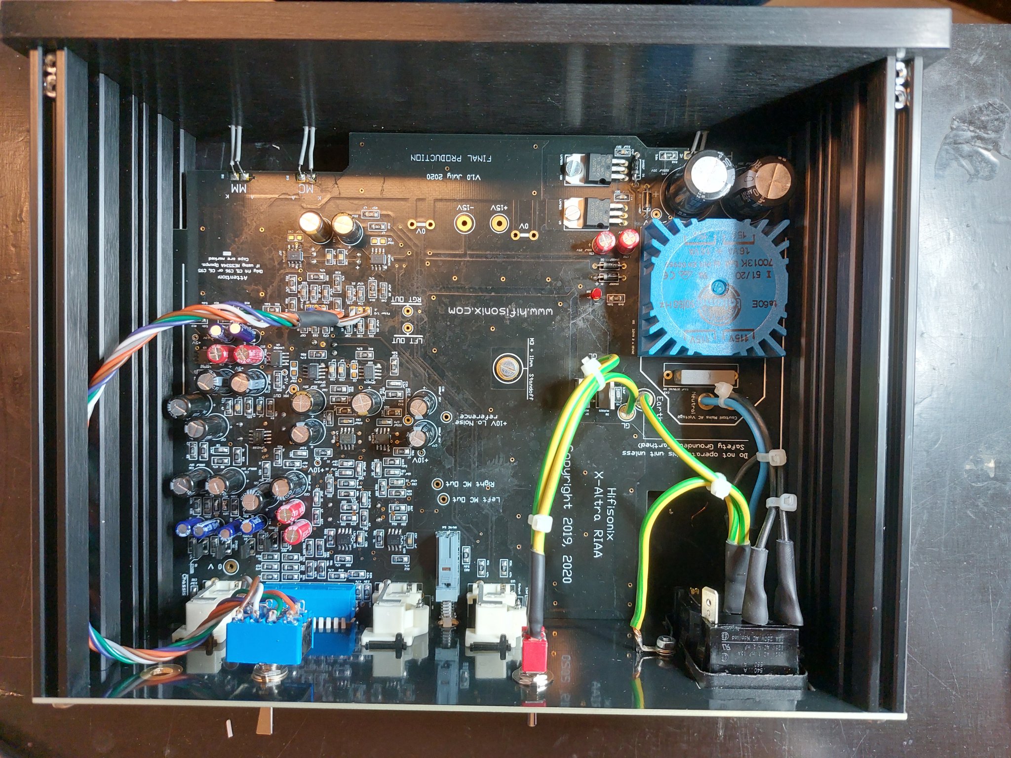

That's nice to hear. My meter doesn't measure down to uV's, but since everything seem to be ok I actually tried it for the first time today. And I must say it sounds better than anything I heard before (both commercial and DIY). So quiet too. Listened to it with a Ortofon Quintet black MC with loading impedance set to 74 ohms and system gain to 0 dB (cartridge output should be about 60uA if I done the math correct).
Thanks for a very kit and your excellent support. This has been a challenging project, and by far the most fun to build.

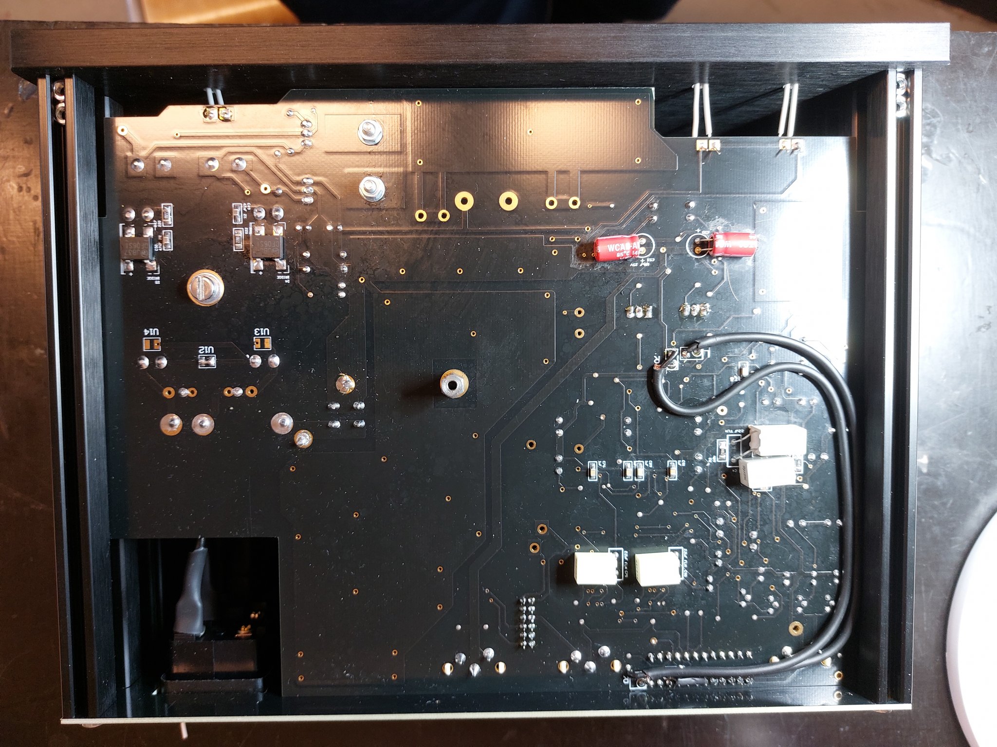

Attached some pics of my build. The only thing I regret is using the red caps from Wurth instead of Panasonic, couldn't find the right ones at first. Don't like to recap and risk damaging the board just beacues the may fail in the future. So time will tell the quality of Wurth caps I geuss.

Nice Build!
Thanks for your kind comments - I appreciate it. I’m very pleased you like it! It will probably settle down and really start to sound good in a week or so. I leave mine on permanently- it only draws about 2 W off the mains.
I think the Wurth caps will be good - German quality!
Well you deserve it. Looking forward to se how it performs after some time, leaving it on from now.
