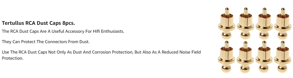

Important note: if the preamp is picking up noise, the readings will be all over the place. For your measurements, leave the MC input OPEN and SHORT the MM inputs right at the input connector. This will ensure the preamp willbe quiet enough for good DC readings.
For shorting plugs what you you recommend? Shorting with just wire or a 470 ohm resistor between signal I put and ground in the plug
There's no ambiguity about the word "SHORT". You want to prevent the internal load resistor from putting its Johnson noise on the signal, 0 ohms is good for that! Keep the wire short as possible so it won't pick up much RF too...
For MM, short the inputs, but for MC leave them open or, connect a 47 Ohm resistor across the inputs under the connector. If you dont want to use a short wire, you can use shorting plugs like this from Amazon
https://www.amazon.co.uk/Tertullus-...ords=RCA+shorting+plugs&qid=1688571113&sr=8-3
Reason is on MC, because its a current input common base circuit, if you short them the gain will be very high (gain is dependent upon cart resistance).
