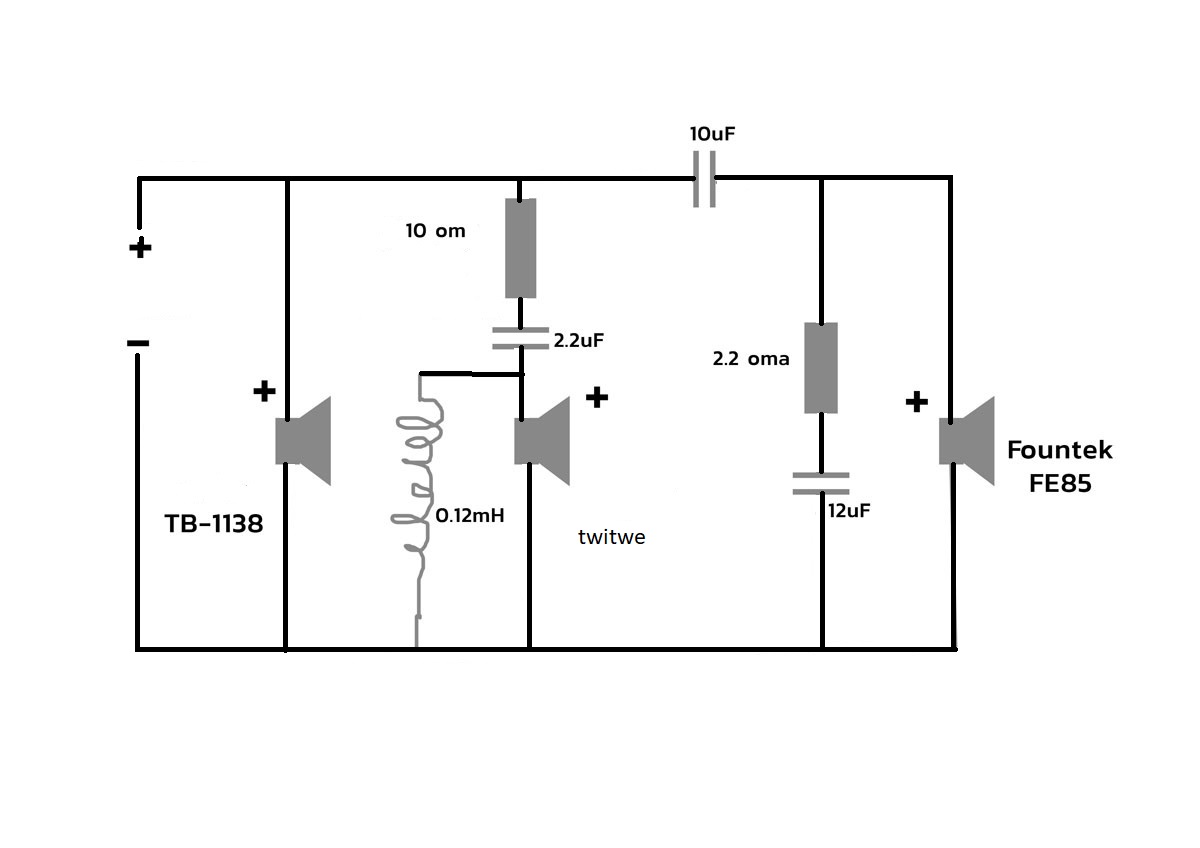

Ciao Ginetto,
I’m attempting to build a W5SE clone and have bought all the drivers but stuck with the crossover, not knowing what’s in there and the crossover frequency. Do you have further insight to this?
Hi ! you can find a schematic in the 1st page of this thread. I am attaching it

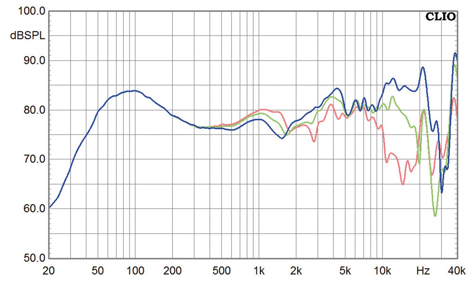

It would be nice to see some measurements, and xover scheme.. I saw measurements for original speaker which are disgusting..
Hi sorry but i think you are exaggerating ... disgusting is too big of a word 😱 i see +/-5dB from 40 to 20kHz ... not bad at all
Maybe the average 80dB sensitivity is not exciting ...
Yes I saw the crossover schematic but not sure if that was the actual one that Boenicke is using for the W5SE.
I’ve tried to seek clarity on this but so far have not been successful.
Have seen some pictures on Hifi magazine showing only part of the crossover, and I can only tell there was one Obliggato cap, a couple of Mundorf MKP, and an air-core 0.12mH inductor.
At the same time, I read in earlier posts that the crossover have little (if any) effect on the sound.
I will still try to use the crossover shown on the schematic with cheaper components first. It would cost me a whole lot to use what Boenicke uses (which is top-class).
Hi, Yes I saw the crossover schematic but not sure if that was the actual one that Boenicke is using for the W5SE.
Hi ! me too. I have just seen it.

Hi sorry but i think you are exaggerating ... disgusting is too big of a word 😱 i see +/-5dB from 40 to 20kHz ... not bad at all....
If +/-5dB is "not bad at all", then what is ?
There is 10dB difference from 100Hz to 500Hz and back up at 4kHz (and i'll be nice and will not analyse that mayhem over 10kHz)
When you get to +/-2dB you can call that acceptable and everything from +/-1.5dB and lower is considdered good.
And i'm not saying that this isn't a fun speaker to listen, but so is JBL pill - both can be fun in certain cicumstances but are not anywhere near hifi.
Hi ! 😀 yes not flat for sure. But there was another case mentioned in the web of a speaker with this kind of irregularity that was well received anyway and someone was noticing its low distortion. Distortion is an aspect less discussed than freq response. Could it be that we are more tolerant to response irregularity than distortion ?
But what i find intriguing is the concept that allows for a very narrow front baffle. It looks elegant.
even after proper EQ ? it is a very compact speaker that looks just perfect for nearfield listenings

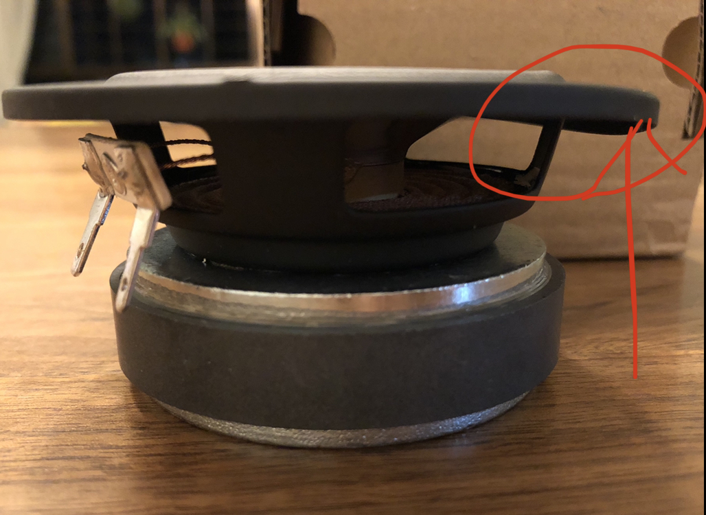

Just collected the speaker enclosures today from the carpentry workshop, I thought I am all set to start putting things together but...................
Just noticed the aluminium bracket of BOTH the FE85 I bought are bent, menaing they will not stay flat. I am still wondering how can I "straighten" them without damaging the drivers. I should have inspected them when they arrived a few weeks back.

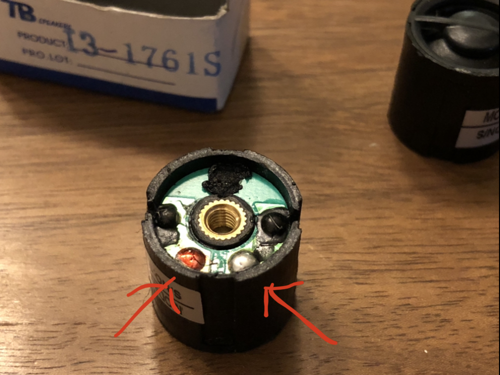

Then looking at the tiny Tang Band 13-1761S tweeters for the rear, they have now lag for the cable but just two tiny dots, anyone can advise how best I should connect the cable securely?
attachment.php
Many thanks

Thans Dave,
Managed to somehow bring them back in the right shape (well almost) with the help of 2 pieces of wood and some force with my bare hands on the kitchen top.
The cones and cushions are still intact, measured the drivers and they both measures approx 7.3ohm each so I supposed they are fine.
Still need to figure out how am I going to secure cables to the tweeters.

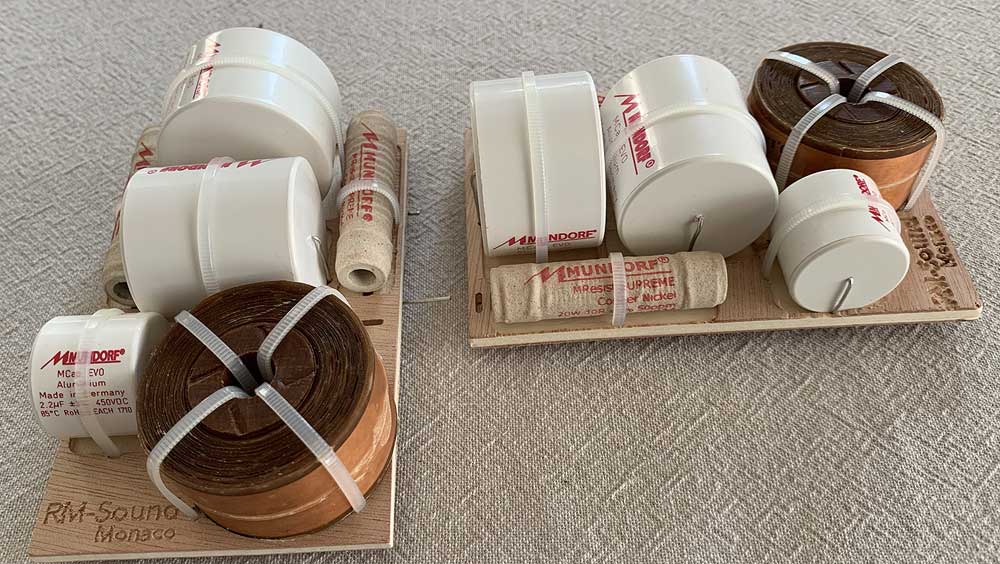

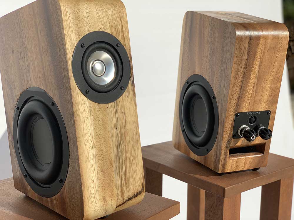

Current situation:
Hello Everyone,
I've finally assembled my pair of W5SE clone, and have listened to them over last few days.
They sounded fine to my ears mostly except that the bass around 60-100Hz is quite prominent, this could be due to the room acoustics and my refrigerator has been producing an annoying hum around 65Hz since day one I bought it. I'll have a listen to the speakers again over the weekend with my refrigerator turned off.
One thing I have not and cannot do is a frequency response test. As an amature I am only equipped with a few simple hand tools and soldering iron.
Can anyone suggest a method which I can do a simple frequency response test (don't have to be the most accurate one) with say a smart phone / computer app?
I see some videos on YouTube and the test involve placing the mic very very closed to the driver. However I don't know how this can be applied to these W5 clones as they have the front firing mid drivers, side firing woofers and rear firing tweeters. Hence I thought placing the mic (using my phone) at my usual listening position would be most practical?
Anyways, these clones are using Fountek FE85, TB W5-1138SMF, and TB 13-1761S.
