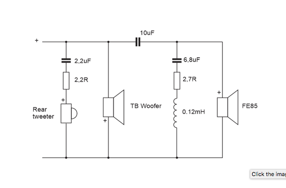

I found in a forum a kind of "reverse engineering" drawing of a crossover of an W5SE and so I took that one because it was the most complete one I could found. So I thought I will go for that one (see attached).
The Obligato gold premium 2.2 uF you mentioned is there also listed but I thought I could eventually stay with the one from Mundorf (same capacity) because the Obligato was a bit rare to find.
May I ask you if you could have a quick look on the drawing if this would be a good starting point? Maybe with that I could start and then see how they may sound on my streamer.

Your crossover is quite similar to the version Entonis presents on page 1 of this thread. However, there are two problems IMO:
  • Woofer and midrange are both wired in positive polarity. This leads to a broad dip in the frequency response around 700 Hz.
  • The RC branch in the midrange section results in a low impedance at high frequencies of less than 3 ohms.
Therefore I rather would favorite the version shown in portreathbeach's thread (Can someone explain the series notch filter please):

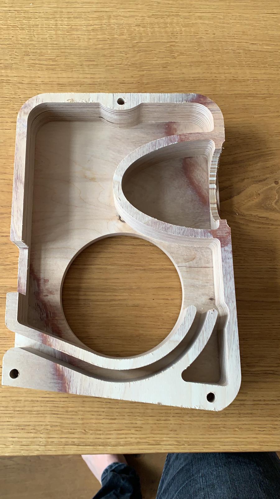

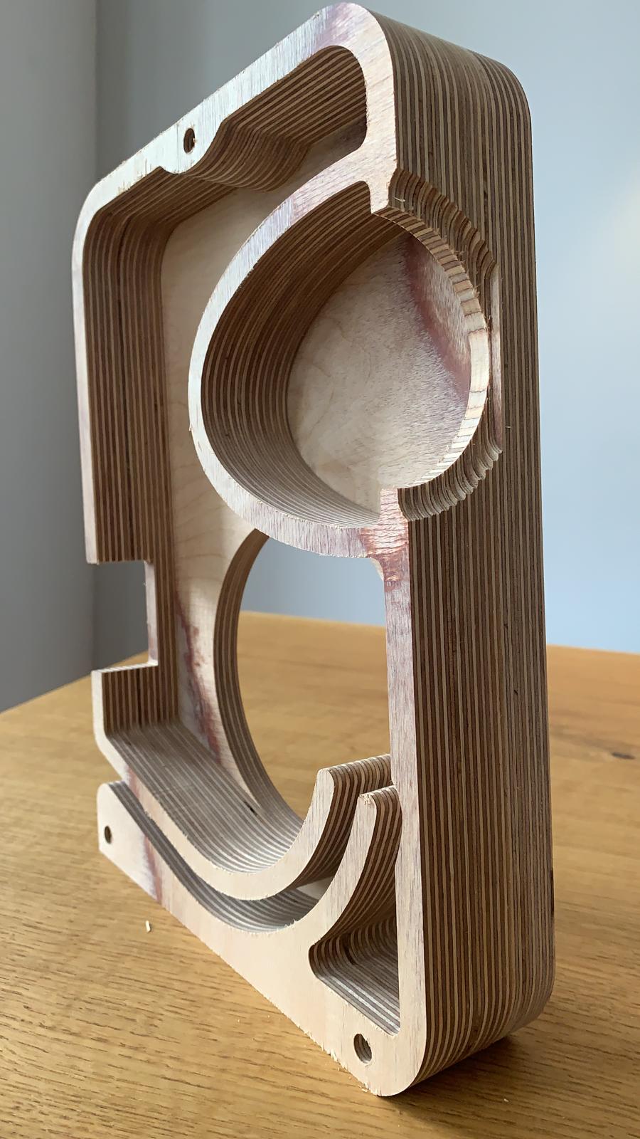

Please find attached some images of the 1st prototype I did with a friend of mine who has a CNC Machine. We did the 1st version out of 3 x 21 mm Multiplex (birch). My plan is to have the final version (if everything works fine with the crossover, etc.) made of solid wood like oak, ash or walnut.... lets see.
Can anyone tell me how thick the cover rings are for the bass speaker and the full range driver and what diameters you used? I know this is more of a visual thing but if so I would fit them as well. It should also look good in the living room later 🙂

CNC File
All the best
Great job StramerDIY! I have the opportunity to get a CNC mill in our FabLab, but have no idea about Fusion360 or similar. Do you share the file you developed for the case by any chance?
