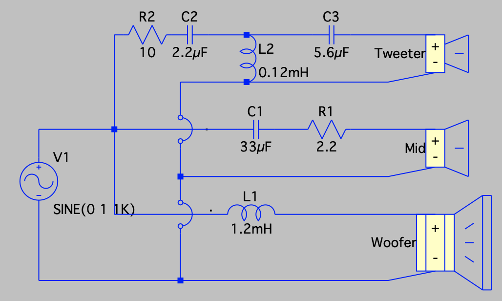

The problem is that if you change the Fullrange, the crossover as built will no longer work. The crossover is one of the most important parts to make this speaker. The sound of this speaker is very good. I too have been looking for an alternative, but the other fullrange also other parameters.Hi

This is my clone:

Speakers are printed painted and work great. This is my crossover. I tried to copy the original crossover.
check the Fostex FF85WK which is a closest in terms of dimensions and it's a great full-range driver in terms of TS and how it sounds.Hi
