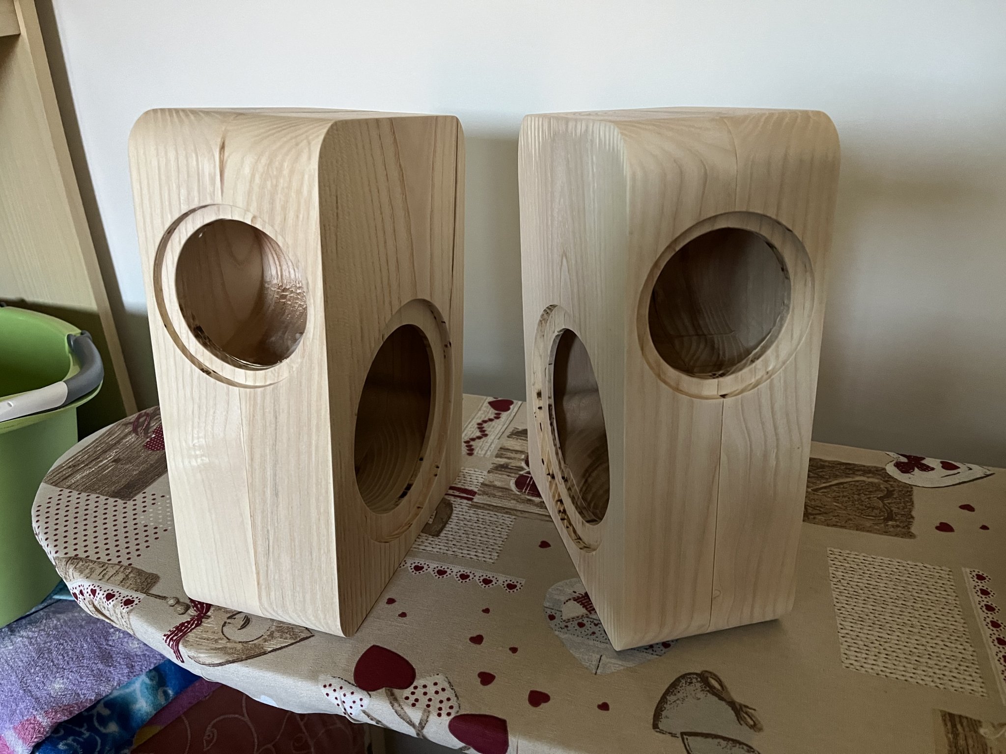

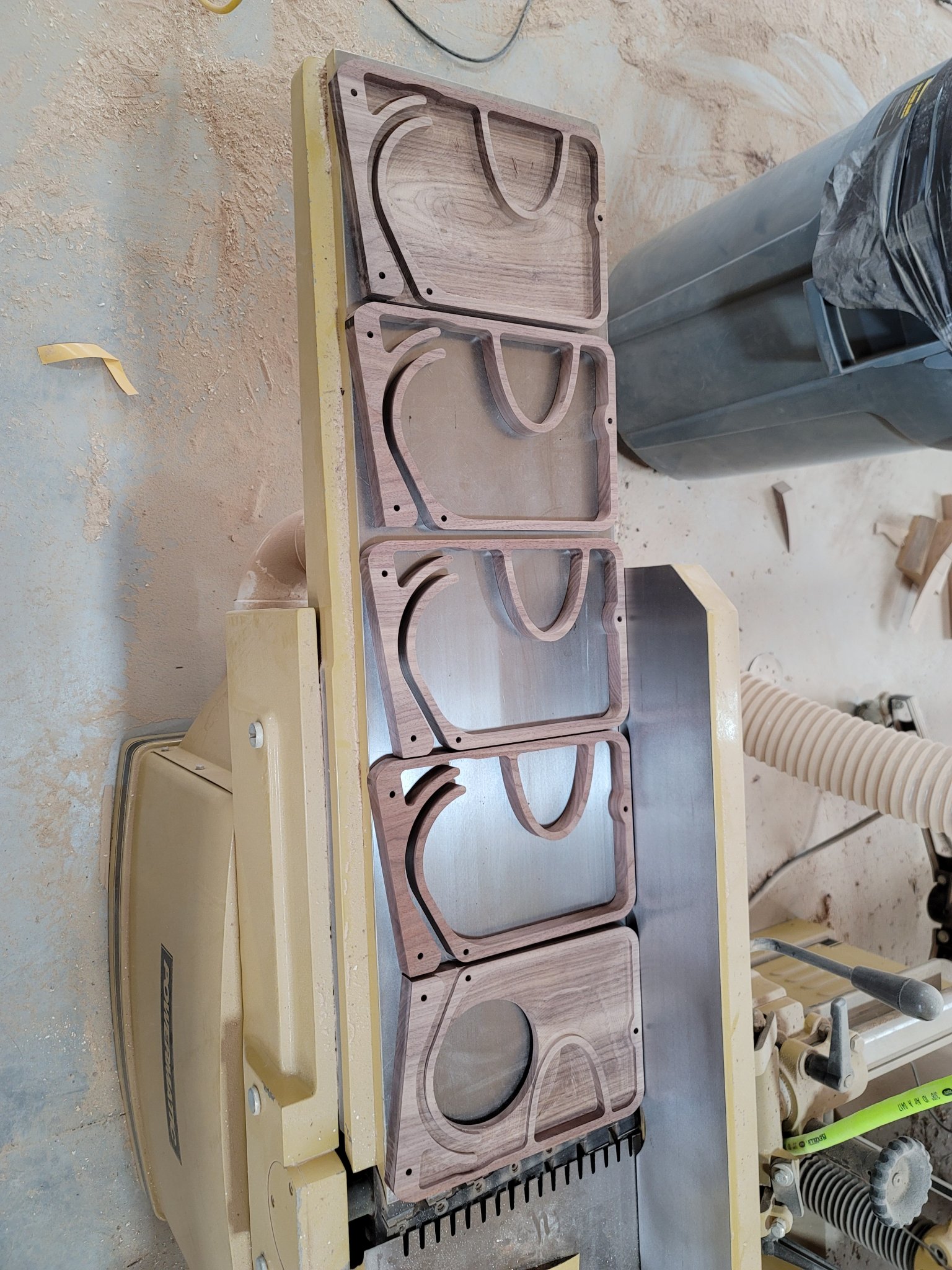

Since we have design studio and 2 CNC machine (for other purpose) I tried to do it something similar, but way is more than complicate since need to make holes on 3 different side s
No meter, if not counting our time, material, drivers, crossover and rest is almost 20 percent of price of W5SE
After I test it, sound is more than awesome
Here is couple pict from production process
BTW my workmates is also make pair for him, and we order material for one pair for our office 🙂

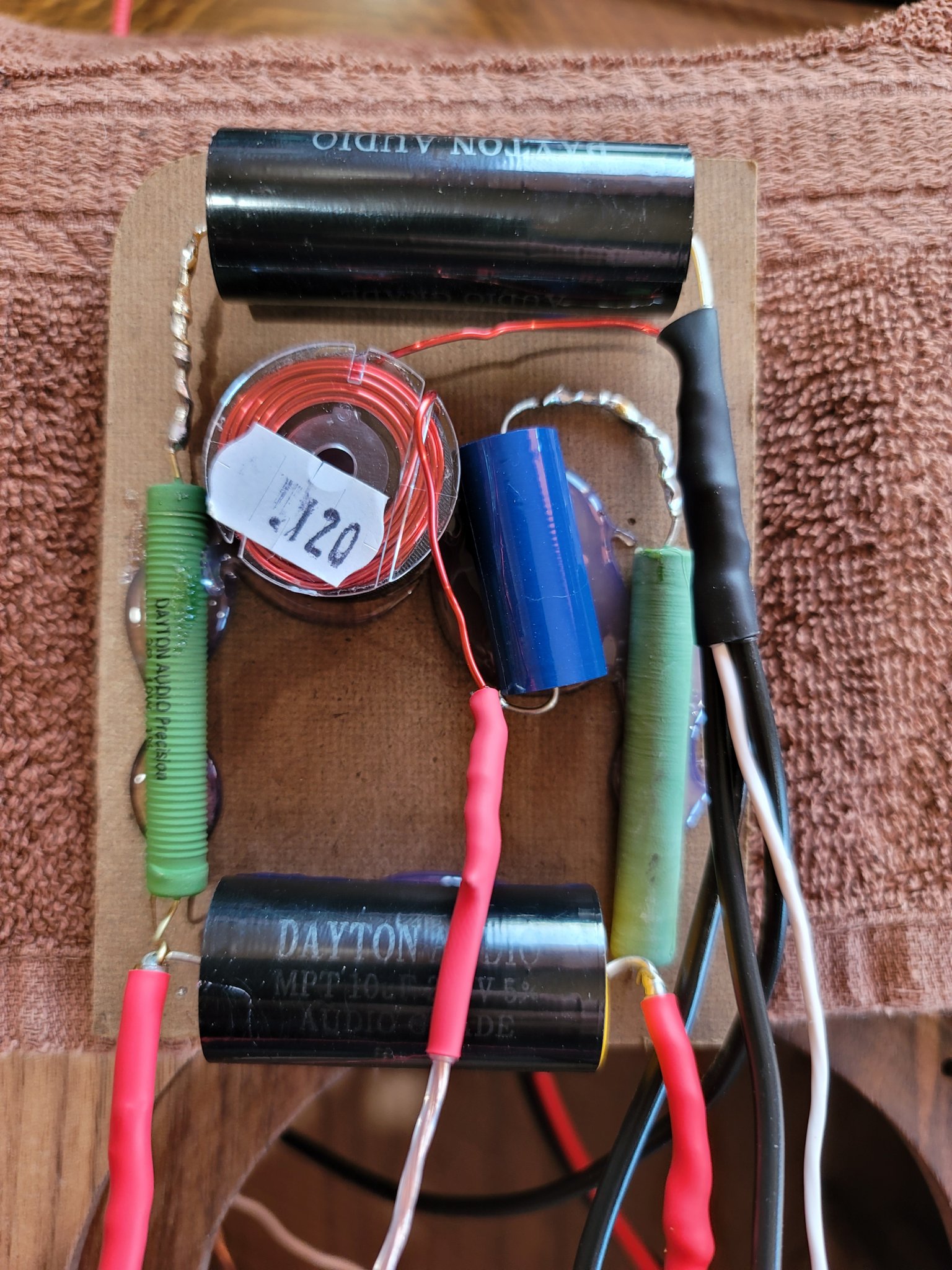

What I dont get is that the resistor and the cap in line with the Fountek (2 ohm , 12 uf) - according to the theory - dont have any influence on the sound? I never ever saw something like this.

Bandpass for the Fountek fullranger? I think according to the description from boenicke it is not limited in hights, runs open to the end. It has only one high pass Filter? (10uf)?Hello Stramer,
Not sure if I can answer your question directly here...............
I basically use the crossover schematic shared by Etonis on post #6 of this thread. The components I use are
For the FE85's band pass:
Obbligato gold premium 10uF
Panasonic EZP-E 12uF
Mills MRA12 2.2ohm
For the tweeter high pass:
Obbligato gold premium 2.2uF
Mills MRA12 10ohm
Mundorf foil inductor 0.12uH
No crossover for the woofer...
Do note that I lack the technical training so I am not able to tell you what are the crossover frequencies.
I first tried listen to them without crossover and without the rear tweeter, the highs were just "incomplete". Then I install the tweeter with the high pass filter, but without band pass for the FE85, the highs were ok but somehow I just cannot listen to them for too long before getting a headache :-(
Finally I connect the band pass for FE85s and they sounded so much more pleasant to listen to.
Unfortunately I believe I have problems with my room acoustics, and that my refrigerator in my small little apartment is humming at around 65~80Hz, the low frequency somehow resonated too much and was rather unbearable. So I finally sealed the tunnel port and now they are lovely to listen to, the bass are very sufficient and full in my apartment and they are fast and punchy too.

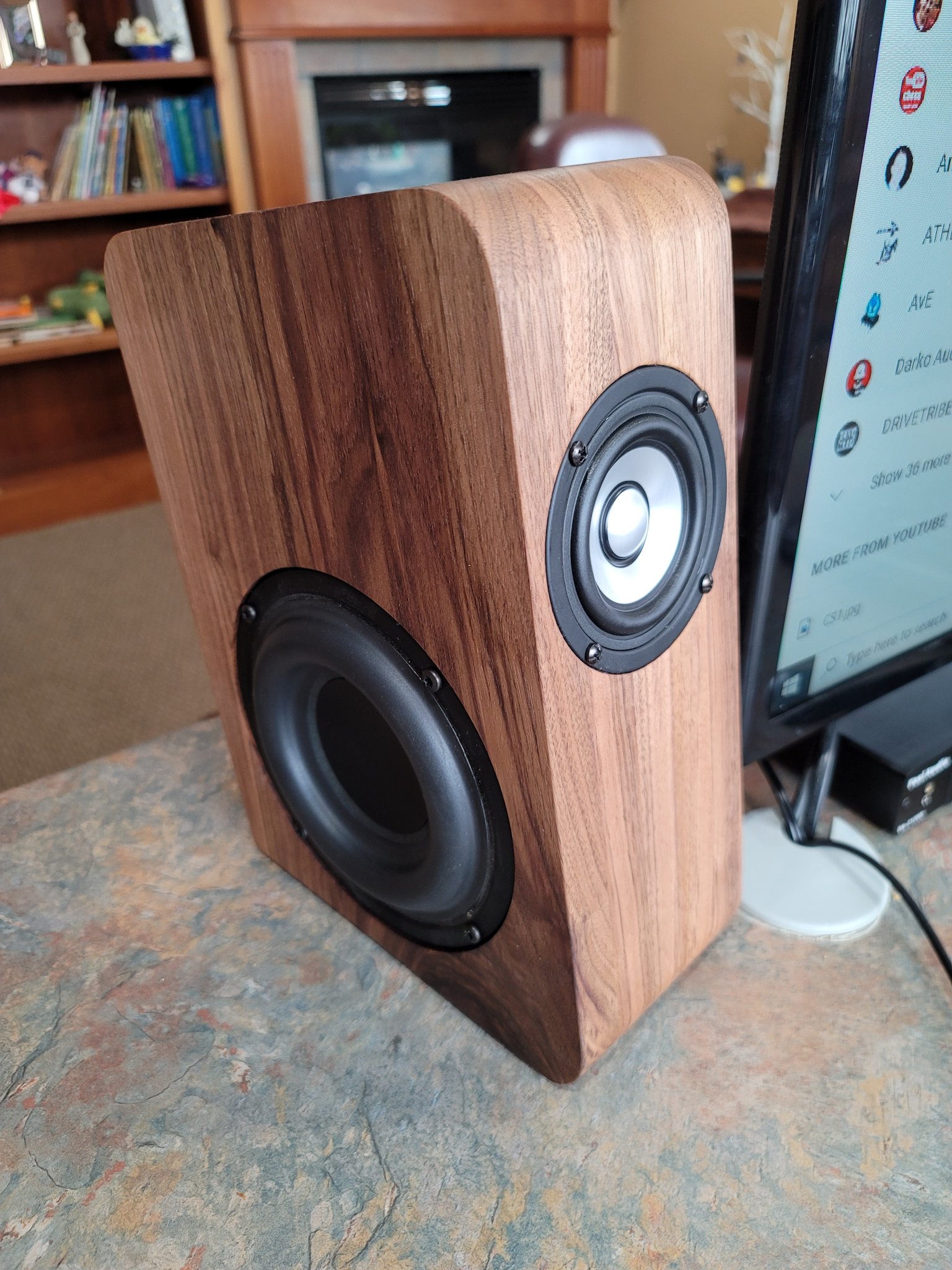

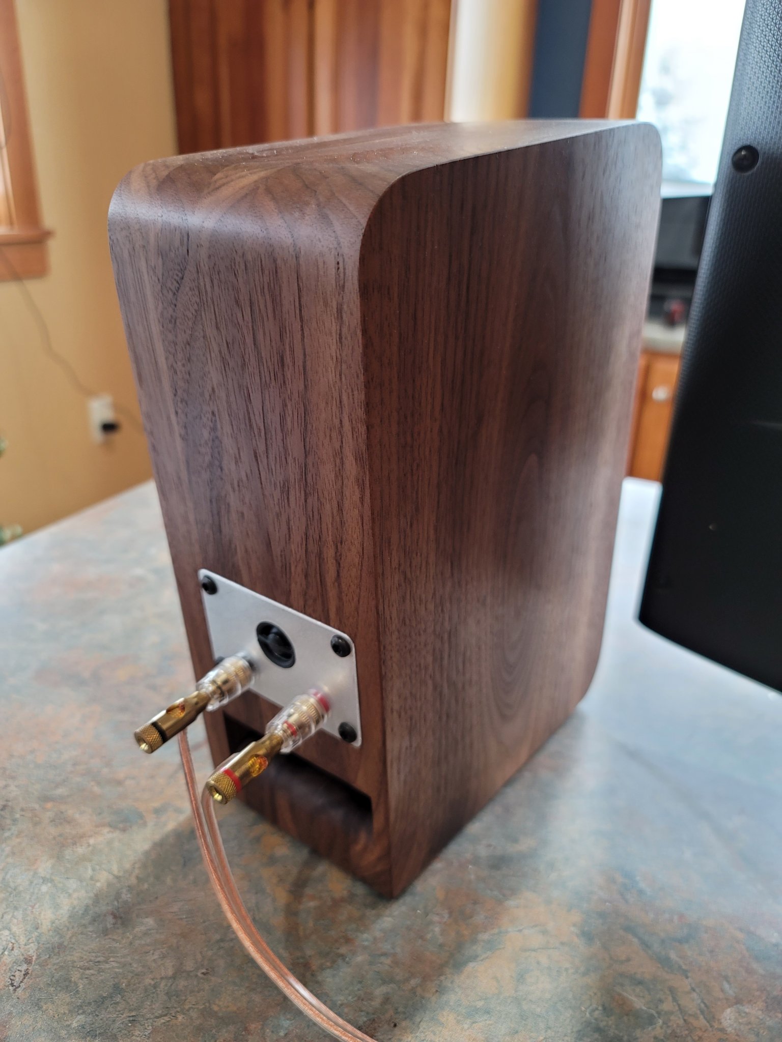

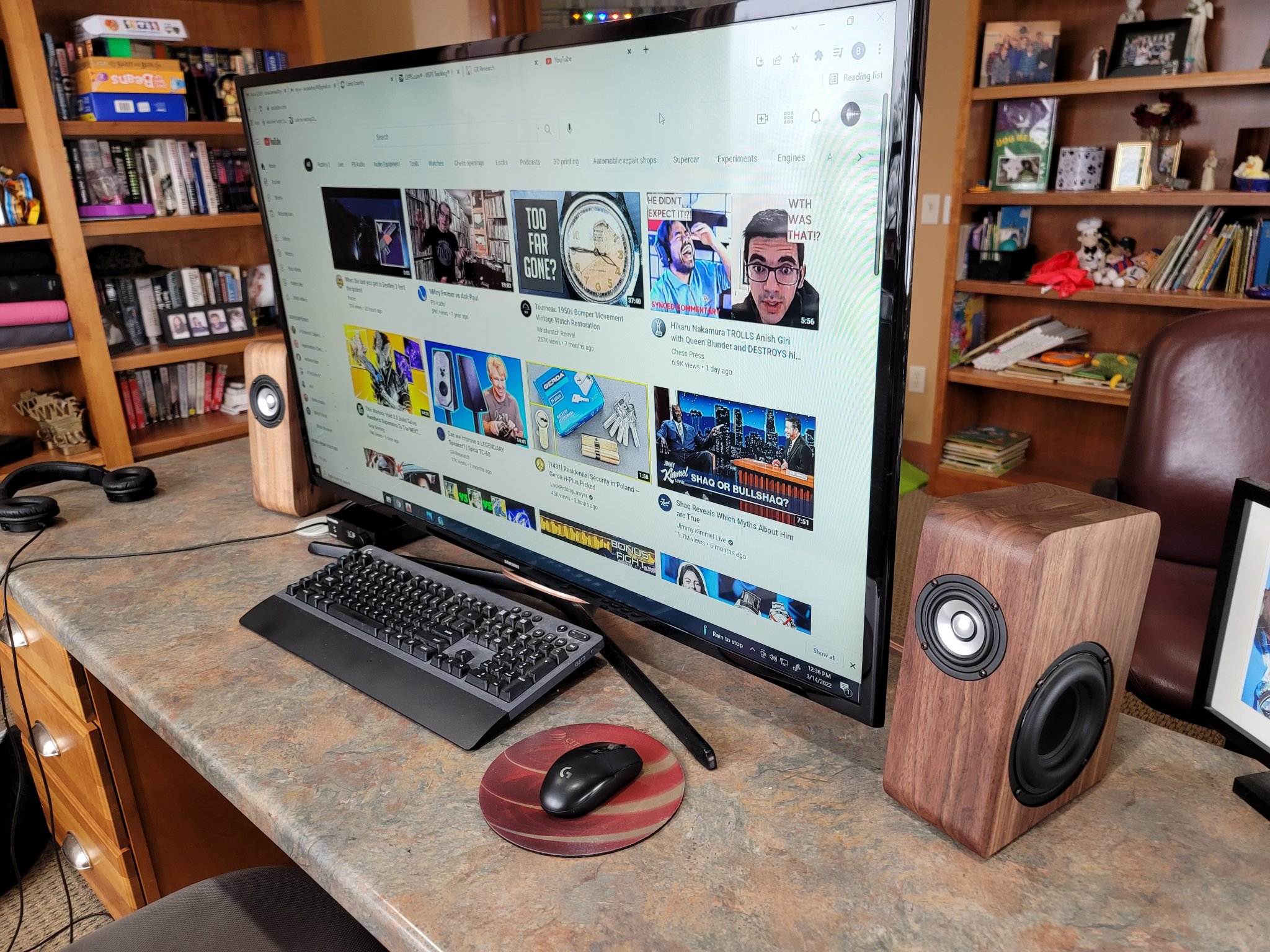

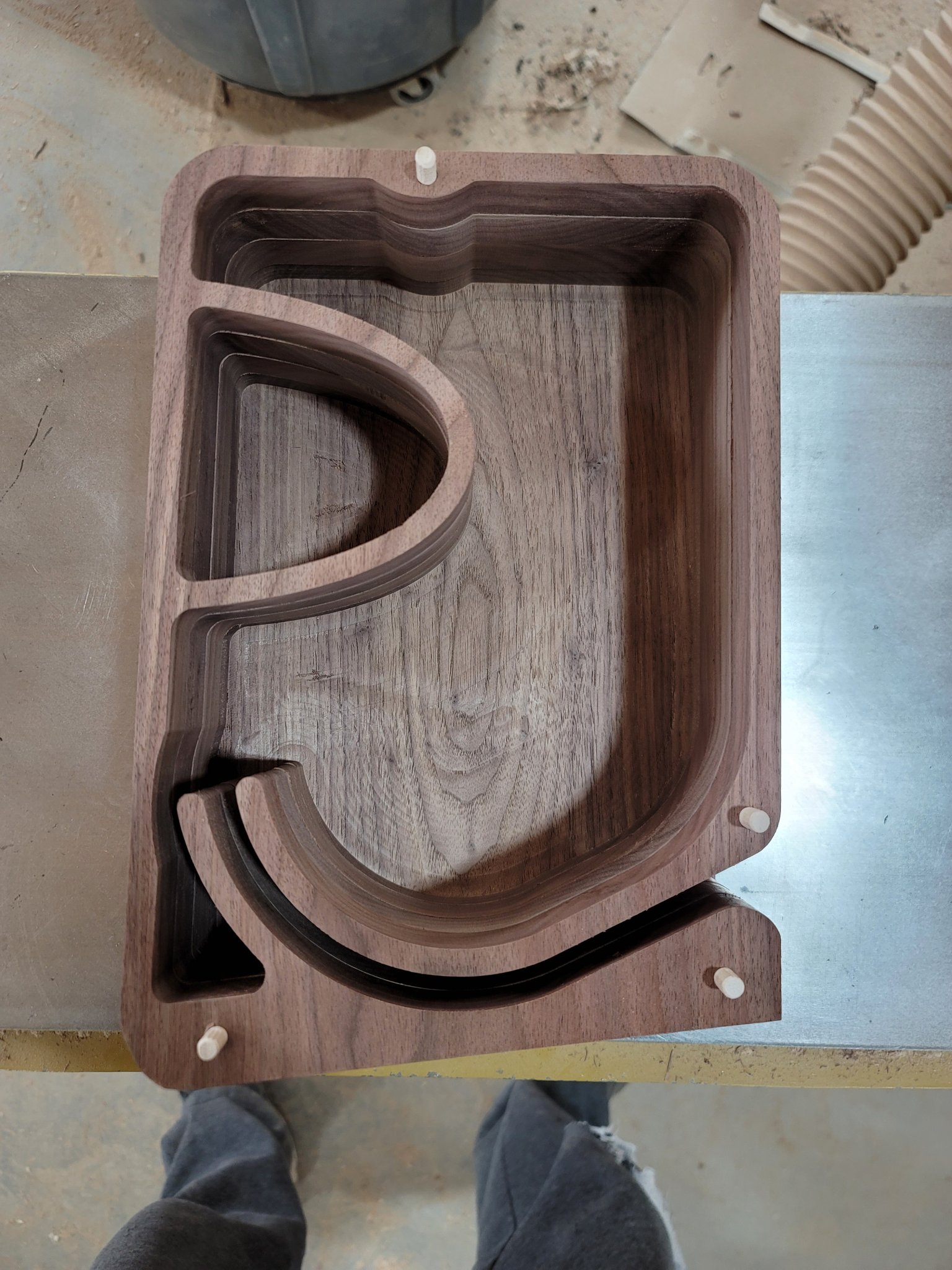

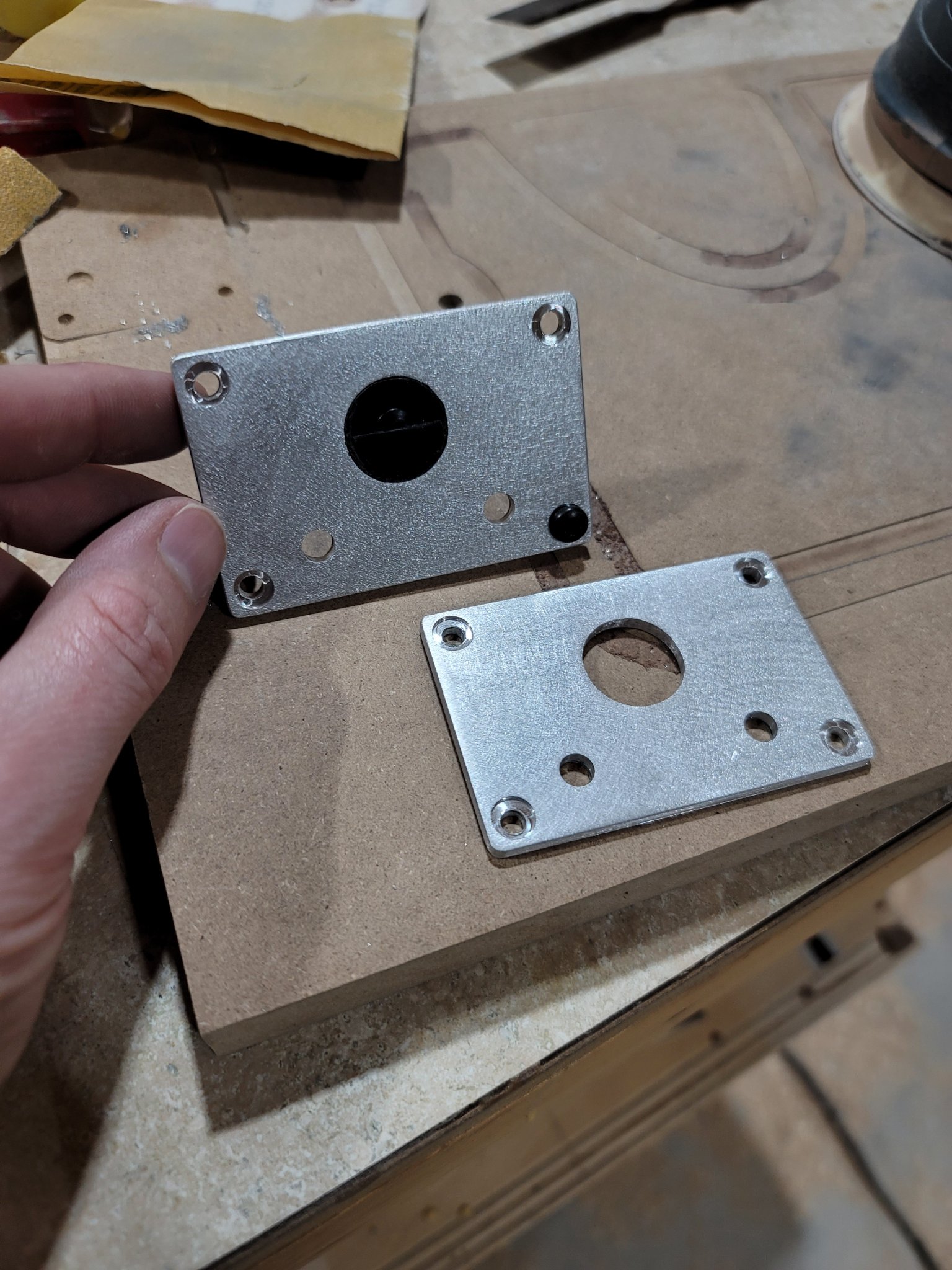

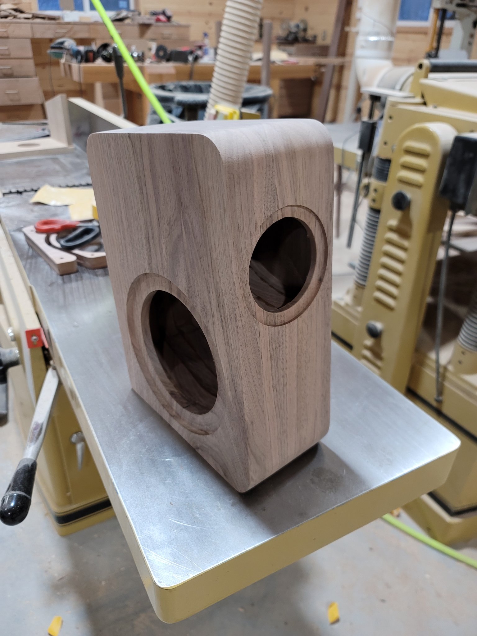

I built a pair of Boenicke W5 clones out of walnut. I downloaded the fusion 360 file from this thread, then made my 2D drawings in Autocad to actually import into Vectric Aspire to do the toolpaths. I used the Tang Band woofer with the crossover mentioned on the first page. I machined the back aluminum binding post/tweeter plates on my CNC as well.
- Boenicke W5 clone
