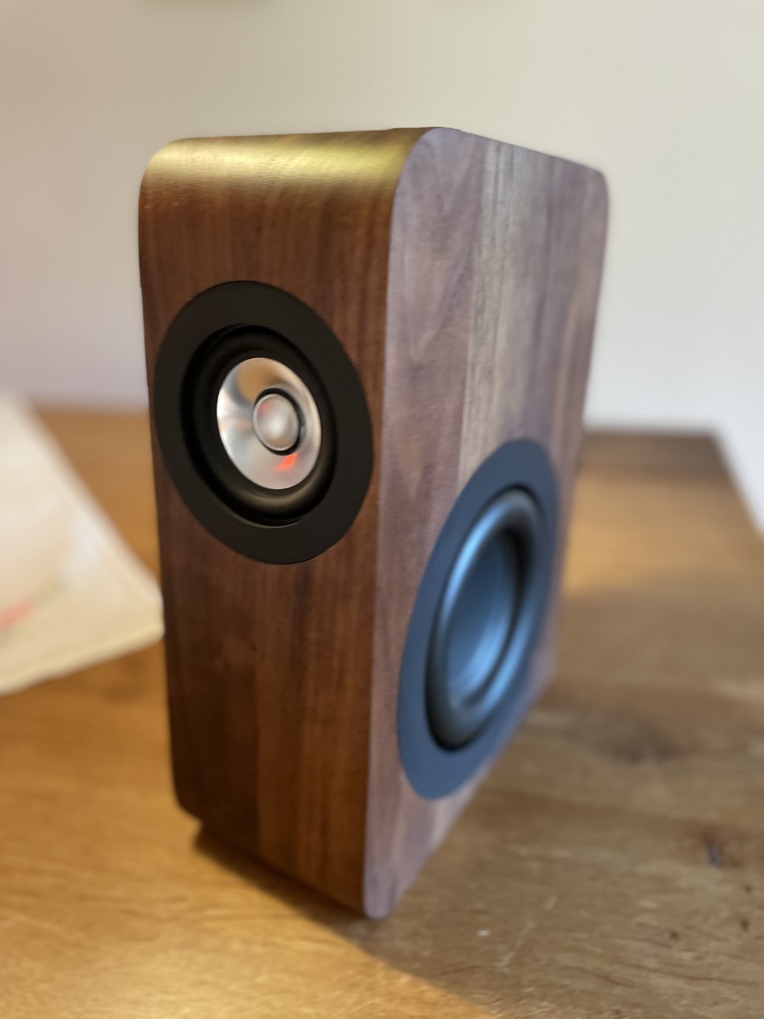

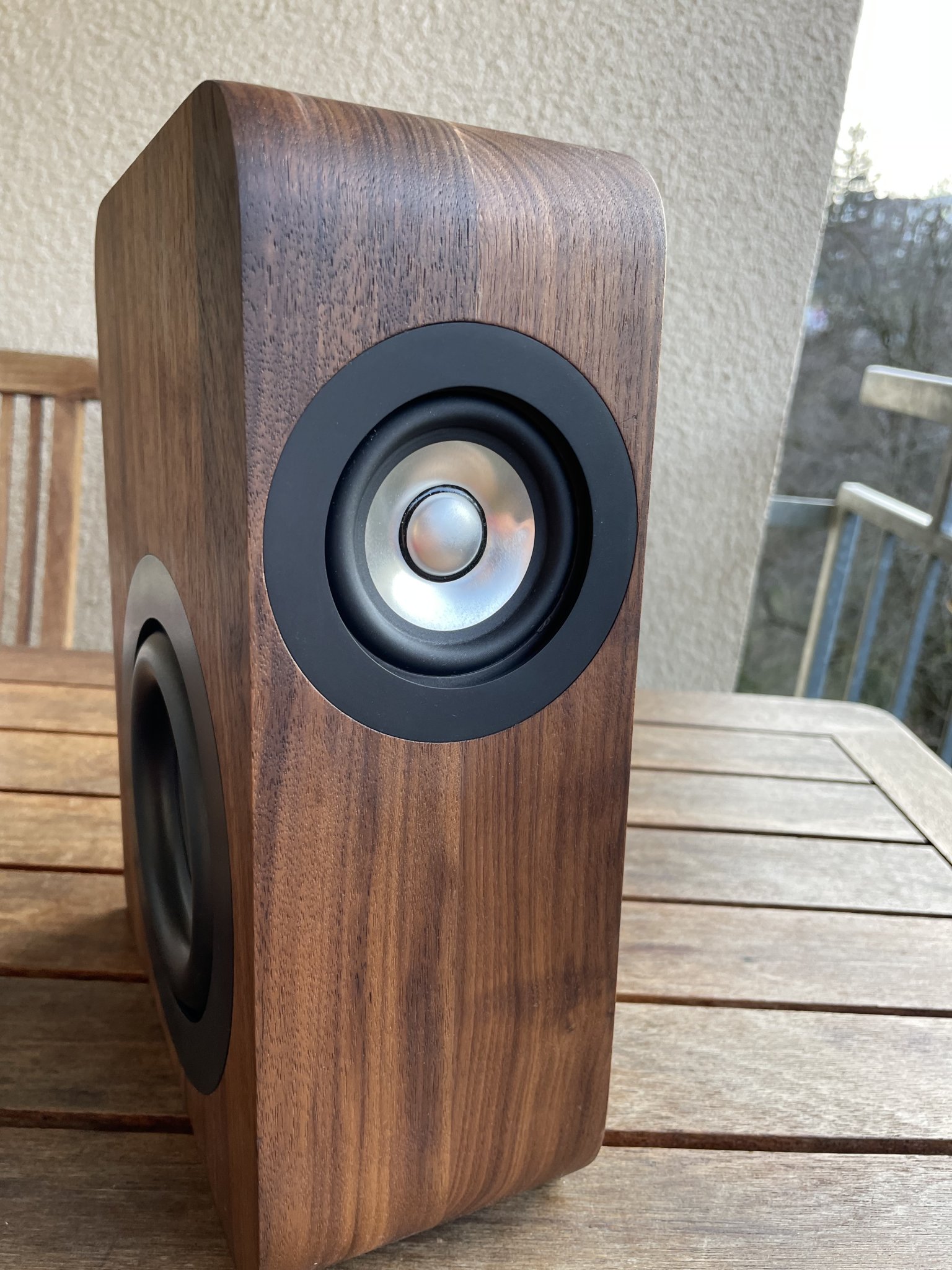

Finally I finished my Version of the W5 in walnut…. It took me really a while until finished them and collecting all parts together (drivers, metal rings, crossover etc).
To me they look really amazing and I‘m happy with the sound.
Thanks also for the hints and answers I got here…
Attached some images of the final version.

Thanks for your compliments🙂
The crossover scheme is the one I asked in one of my previous posts in this thread … just jump some pages back
Because of the huge effort and time I didn’t care to go for the cheapest components for the crossover / binding posts . Finally I took the Jantzen Aluminium Cap and some Mundorf capacitors and resistors…
Rings:
They are 2 mm thick
They were simple metal rings that I polished in a workshop with glass pearls. A friend of mine then did the painting with his airbrush gun..
Before painting I used some primer.

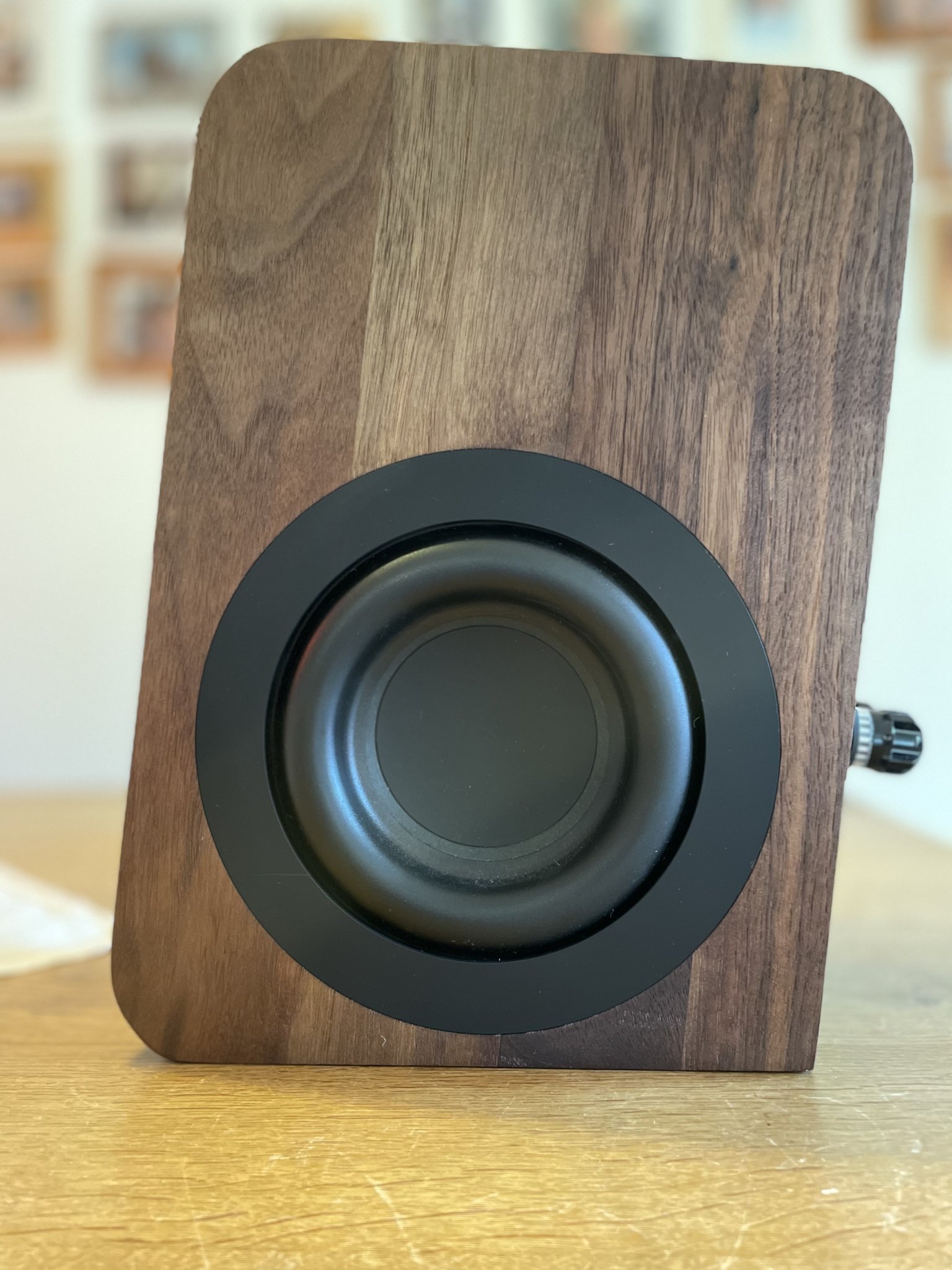

The ring of the bass driver sits very tight in the wood (no glue ore 3M tape necessary). The 4 screws are hidden behind the driver.
The front ring is the same 2mm thick and also hiding the screws behind. That’s why the front driver is a bid set back and not plan like the original. But I love the clean look 🙂
Back plate / binding poste plate:
3 mm thick stainless steel that I polished (no painting)

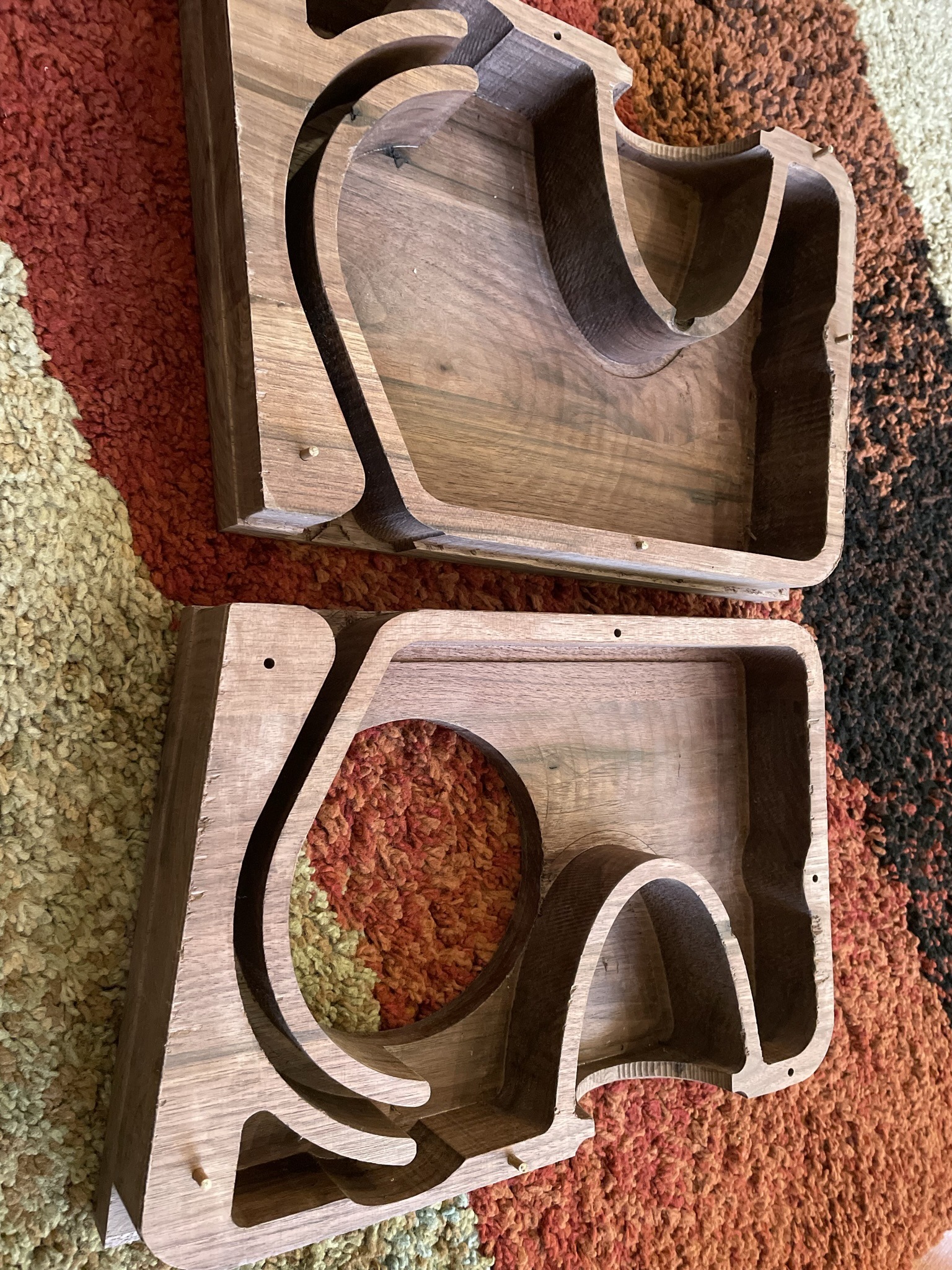

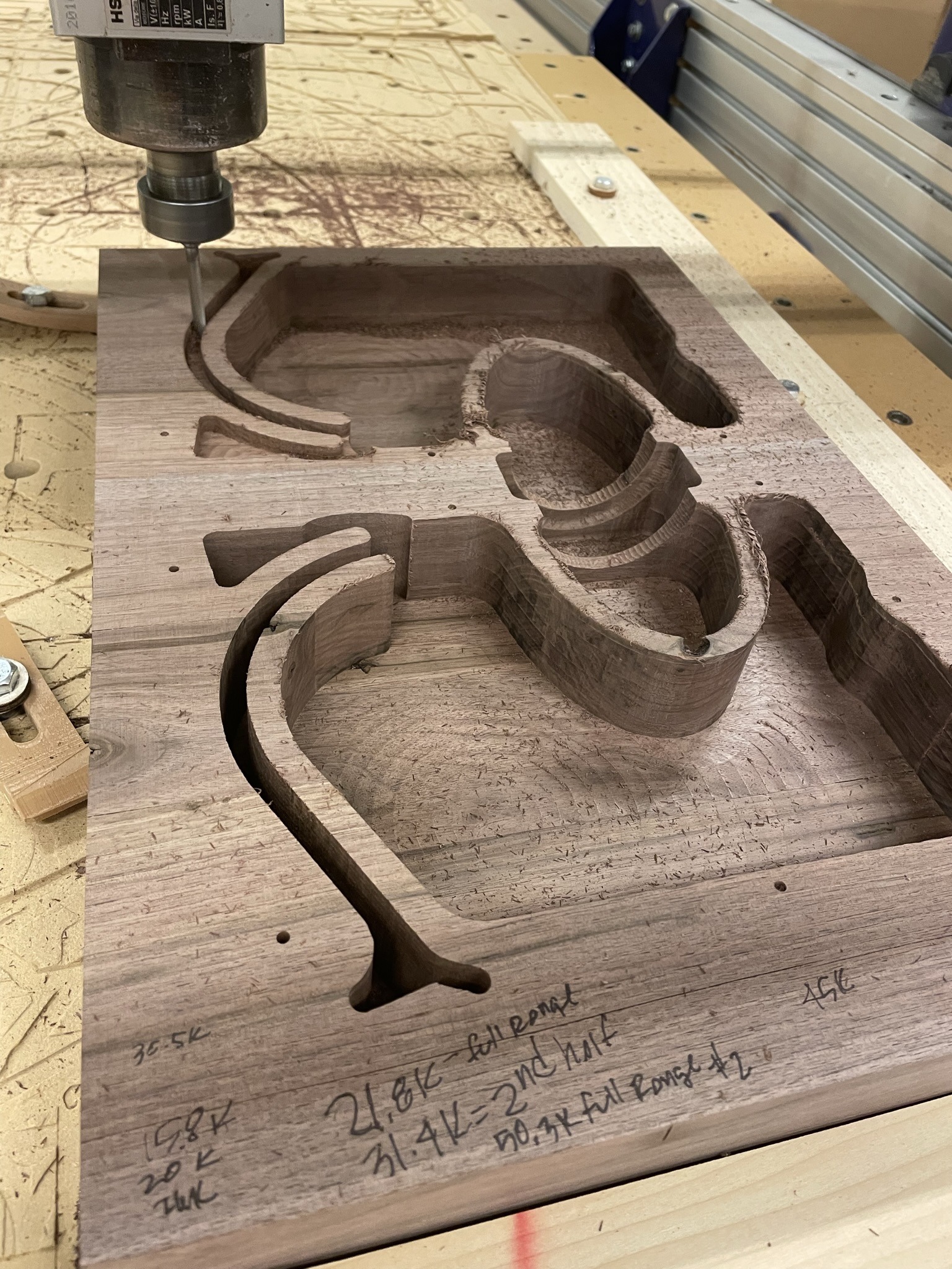

I built a pair of Boenicke W5 clones out of walnut. I downloaded the fusion 360 file from this thread, then made my 2D drawings in Autocad to actually import into Vectric Aspire to do the toolpaths. I used the Tang Band woofer with the crossover mentioned on the first page. I machined the back aluminum binding post/tweeter plates on my CNC as well.
